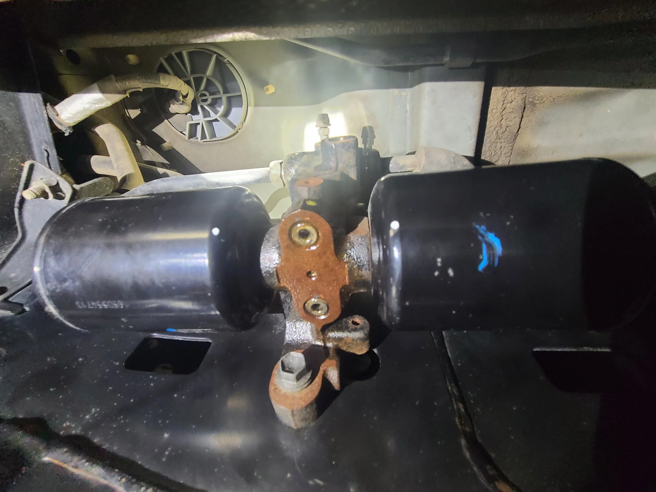

Well, I'll add my experience to this thread, with my 2013 4Runner Trail.
I had to do an entire lift kit swap, due to rust breaking UCA's, coils. Had a shop install a Dobinsons setup and Treaty Oak KDSS spacer kit. Well, they never opened the valves to free flow the system.

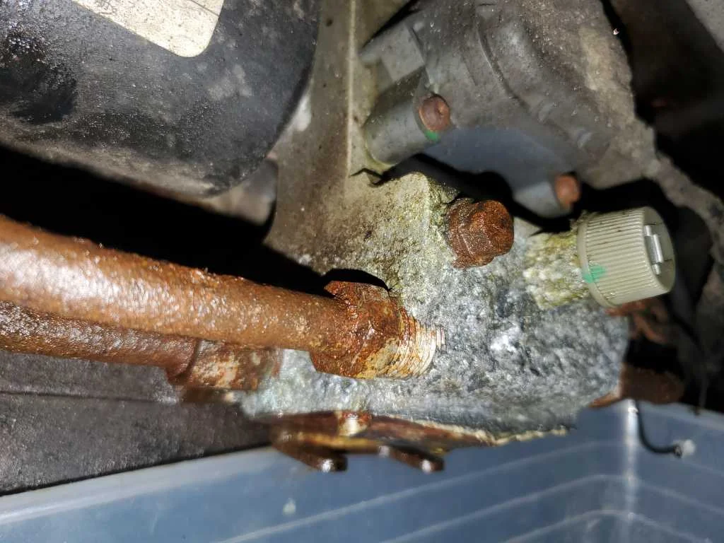

I get home and see fluid dripping from the accumulator. After a few days spraying the s*** out of the cover plate bolts, I gave up and drilled them out. I expected the worst and that's what I saw.
Aluminum has corroded from dirt and salt sitting on it, despite my spraying that area with water over several years.
I'm waiting on a new part to arrive from Japan ($593). My hope is to spray the lines, remove the fluid from the drain valve, remove the lines, carefully, and install the new part. Then I need to find a dealer to recharge it.

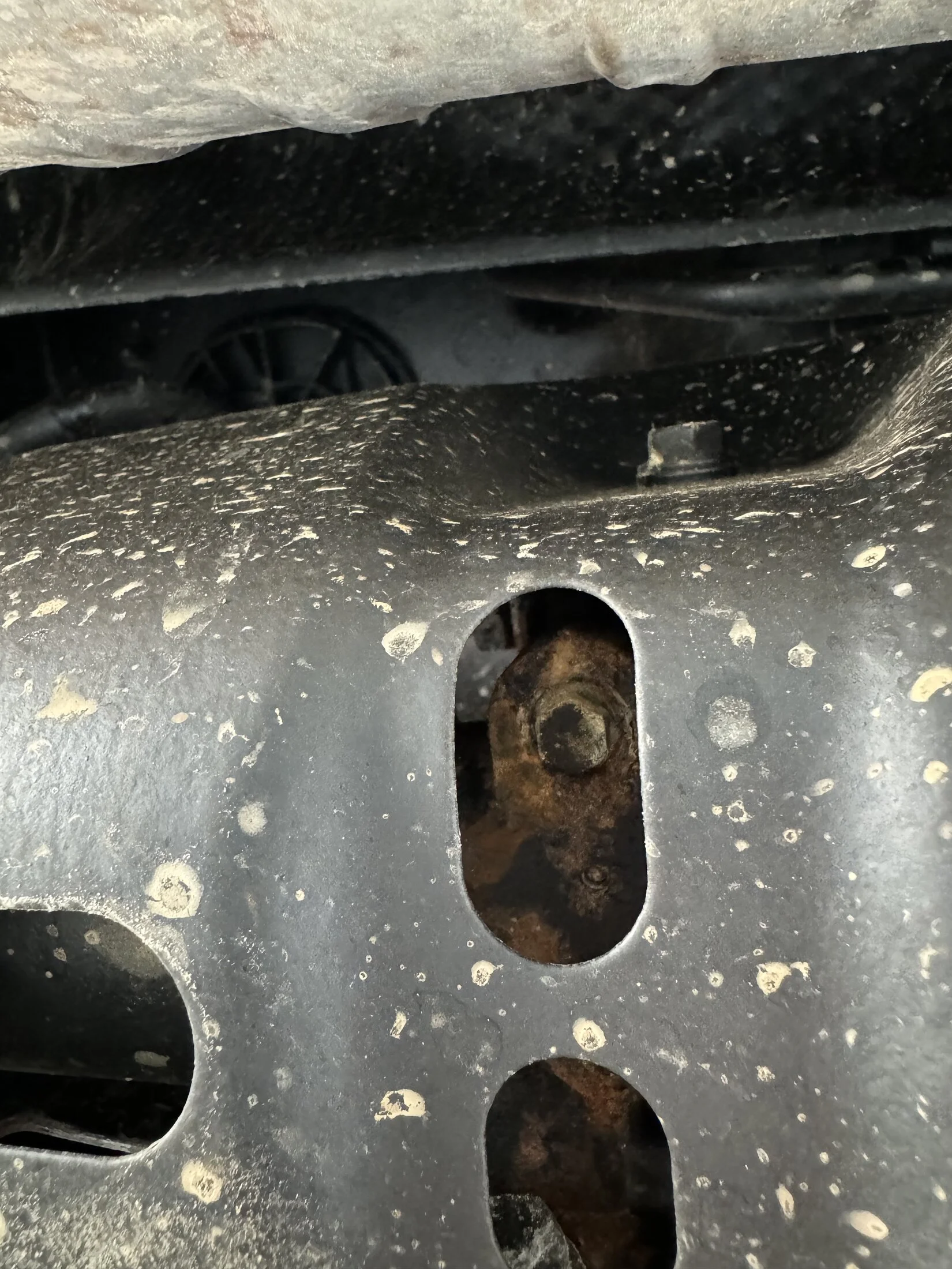

Any chance someone is in the NJ area that could help me clean the KDSS valve on my ‘21 LC?
I’m mechanically challenged and will probably mess it up somehow if I try doing it myself. Looks like a decent amount of rust is already forming there.

You can do this yourself without messing it up! Get a small wire brush with an extra tip like these:
Use it to clean the surface rust off both valves and then spray them completely with Fluid Film. They’ll be fine if you repeat the Fluid Film every year.

I think that’s overkill, but yes it would work fine. If you get small wire brushes you can clean off the hex head valve screws without removing the cover. And there really isn’t a need to open the valves before cleaning and spraying. The oily stuff will get far enough into the threads to save them from being rust-welded in there. In fact, I think on a ‘21, you probably don’t even need to clean off the rust if you use lots of Fluid Film.

I would definitely remove the cover. See my post further up about my 4Runner. I'd spray the area for years, thinking it got rid of all the dirt and salt; nope, it built up and corroded the aluminum block to the point of having to replace the entire accumulator.
I had to drill out my bolts.
Then get all the dirt off, scrape off the rust, spray the valve bolts with Liquid Wrench, back them out two turns and back in.
Finally, get some good marine grease and cover everything with it. Or, spray it with Fluid Film or PB Blaster - lots of it. A yearly treatment is good.

Given the option I would definitely open the valves (NO MORE THAN 3 TURNS) to make sure the applied grease/rust protectant gets pulled into the first few threads. Since you already have a little rust there is a risk that it migrates up the threads into the more sensitive parts of the shutter valves.
I would also wire brush the bolts before loosening to get any scale off them and make sure the socket doesn't slip at all.
When you tighten the bolts again, they do not need to be super tight. Technically the spec is 9ft-lbf, though I doubt you have a torque wrench in that range.
