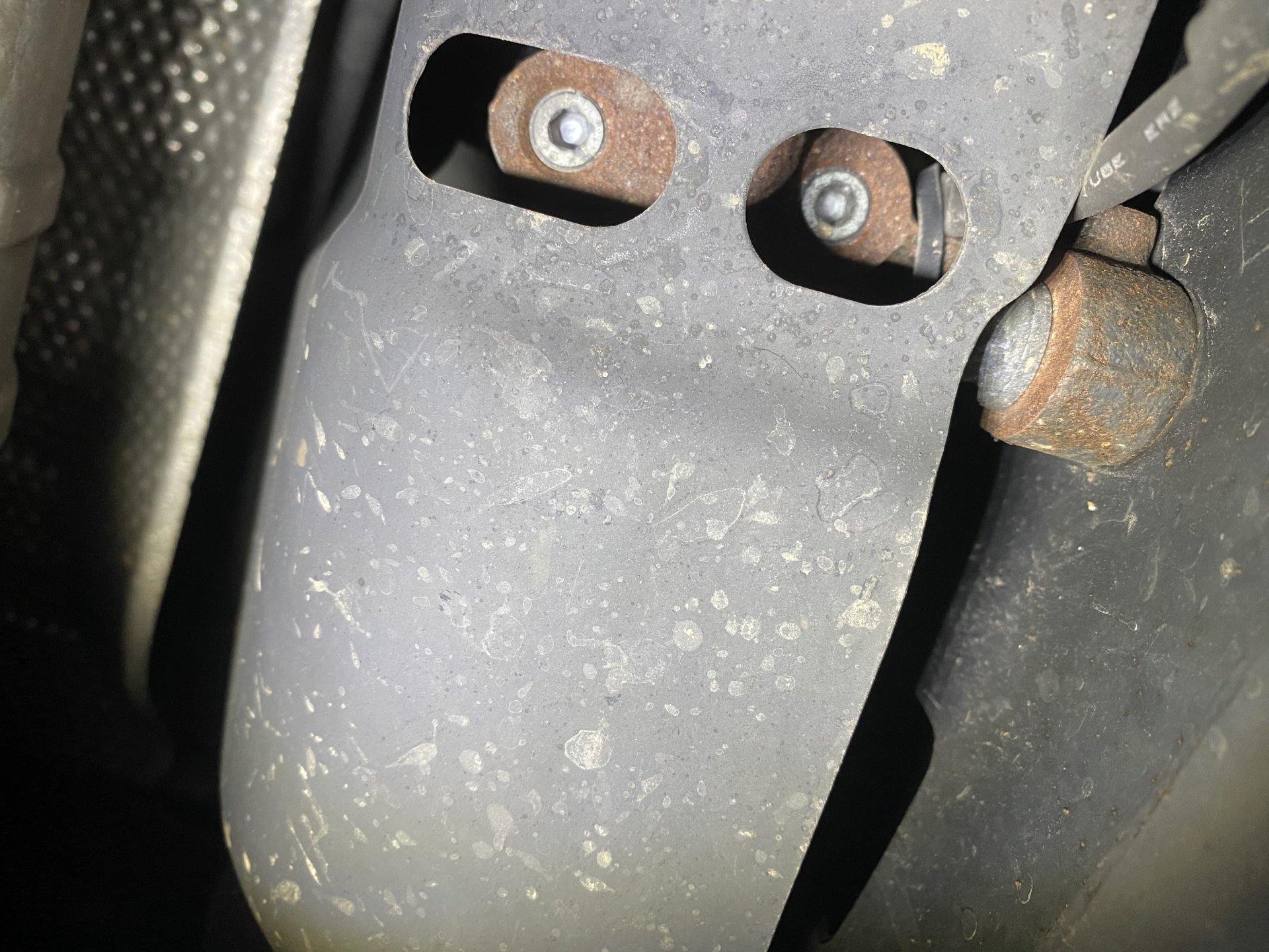

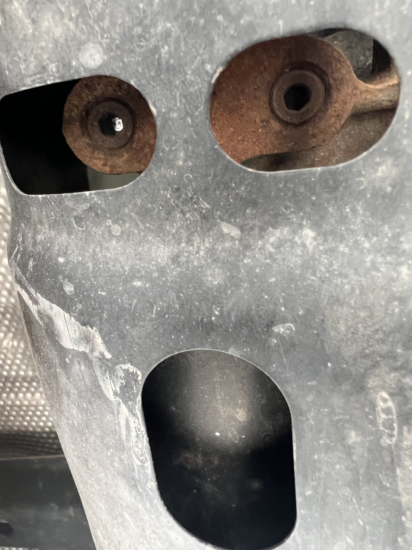

I would think the shield around the KDSS valve should keep much of the sand/salt from blasting any grease or corrosion inhibitor off of it. Though the shield itself rusting can be an issue too.. maybe take that off and get it powder coated or POR15 to keep it in good shape protecting the valve itself.

I understand that but I can’t see aerosolized salt water taking a thick layer of marine grease off of there is a protective shield in place preventing direct spray.

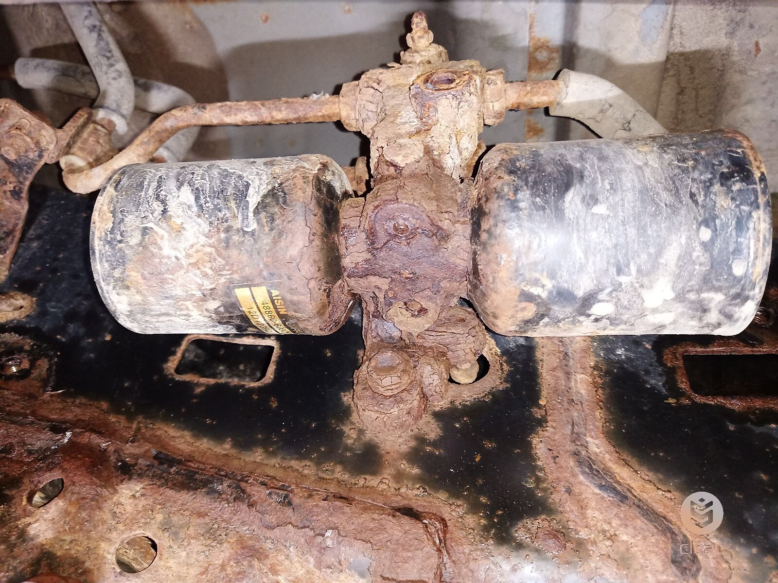

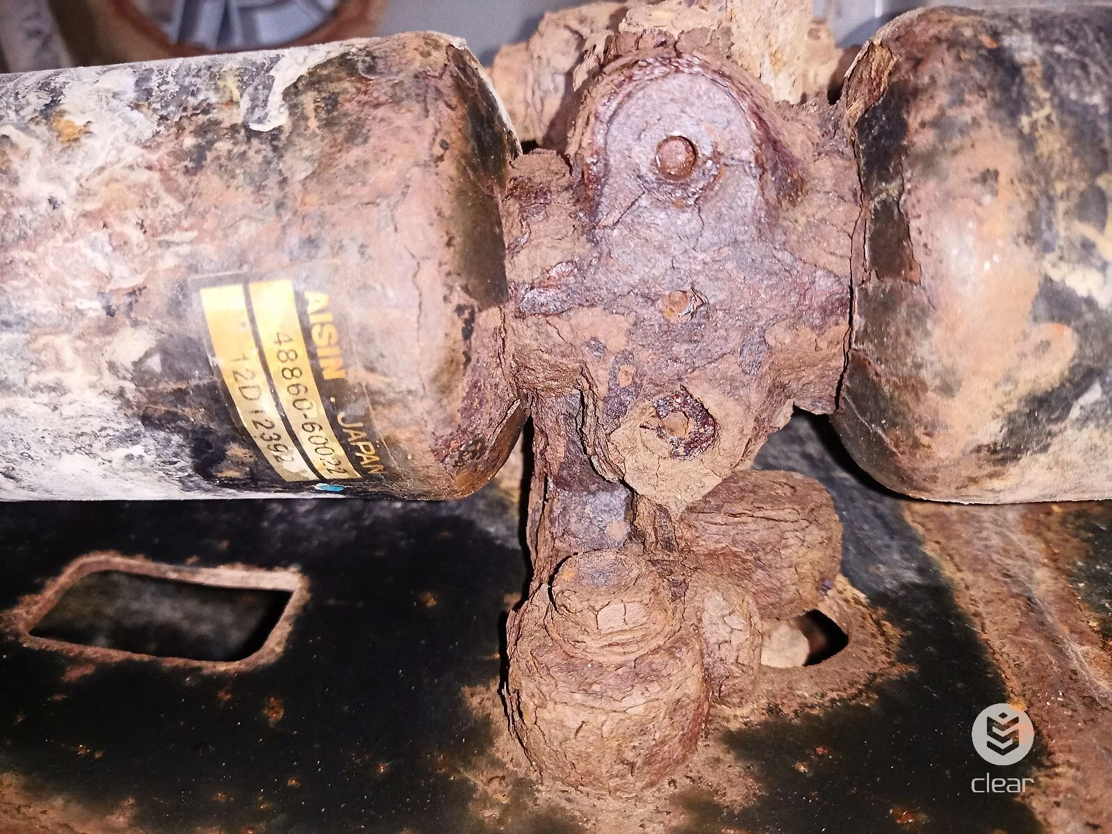

Outside of the valve body? There are a couple cases of people with severely rusted valves having a sudden lean without any leaks. Even having cut a valve in half I’m not quite sure what the mechanism would be when that happened. Plus the obvious balance screw issue.

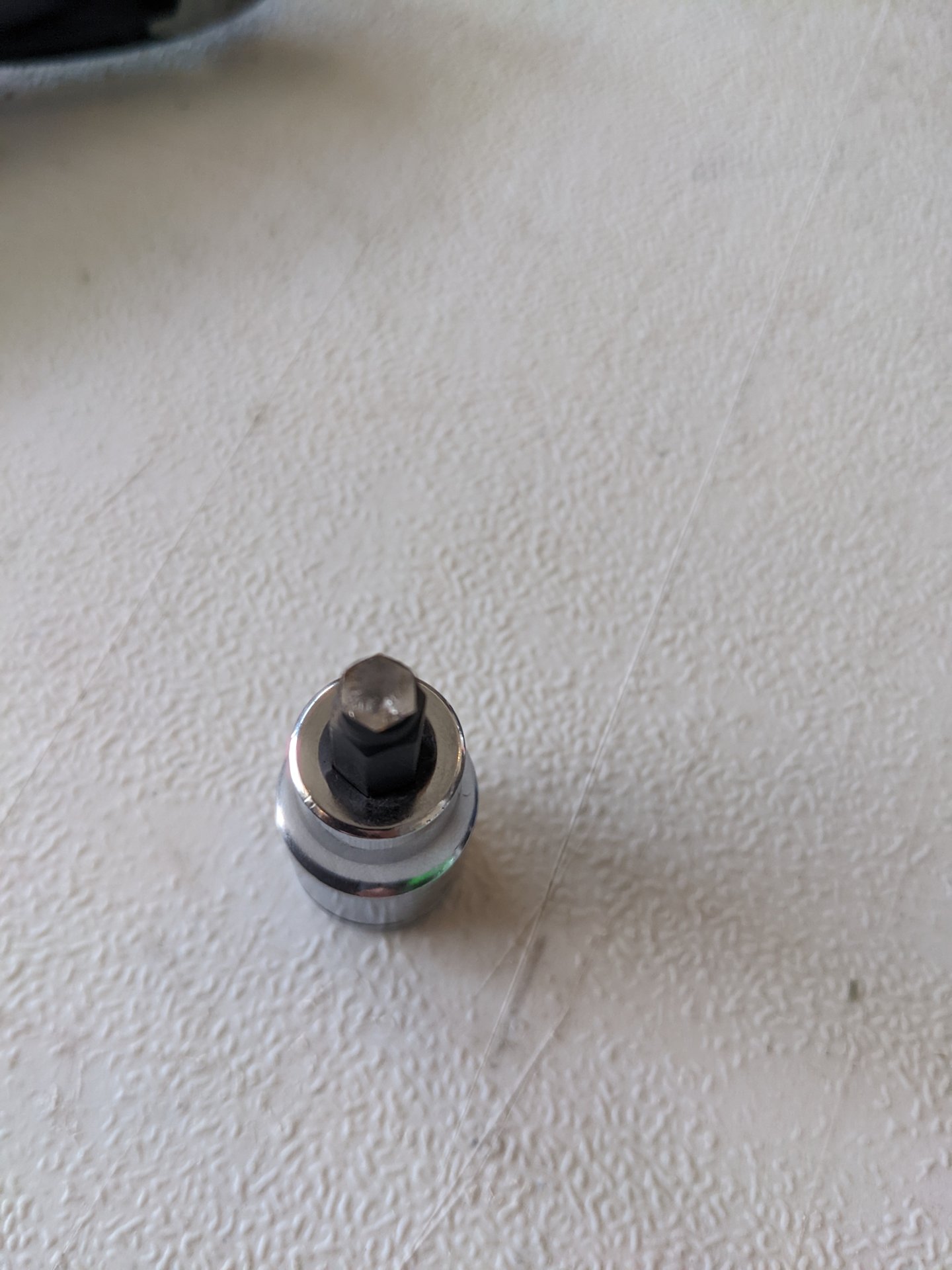

Well I'm kinda hosed here. There's probably a solution out there but at this point I'm pretty dejected. Was going to work on my suspension over the weekend and the KDSS valve and nuts are seized up pretty tight. I was able to knock one of them loose and the other one was so stuck that my 5mm allen key broke and is stuck inside. I was applying steady pressure with it on a pretty bar but not too forceful. Could have been that it was seized in tight or perhaps a s***ty 5mm allen socket. Either way this sucks. The vehicle apparently was from TX, moved to Canada for two years, and then to Tennessee. Pretty horrible what 2 winters in Canada will do to a car. Before really working on the two KDSS nuts I sprayed it with rust penetrant overnight and wire brushed it as much as I could.

It's not so much that the KDSS valve screw is stuck. Bigger issue at this point is that the 5mm allen socket snapped and broke and is stuck in the hex screw. Now I gotta figure how to get the broken socket out which is lodged in there pretty tight and there isn't much to grab on to.
See if you can find a 6 point socket that will fit the remains of the Allen wrench and turn it clockwise (tighten) with enough force to break the broken tool free. Then take the @bloc advice.
There is enough sticking out that hammering on it side to side should loosen things. Just try to avoid any really big hits on the corner of the valve.
Yes a 5mm combo wrench could help but is probably tough to find. I’d work on that as described above.

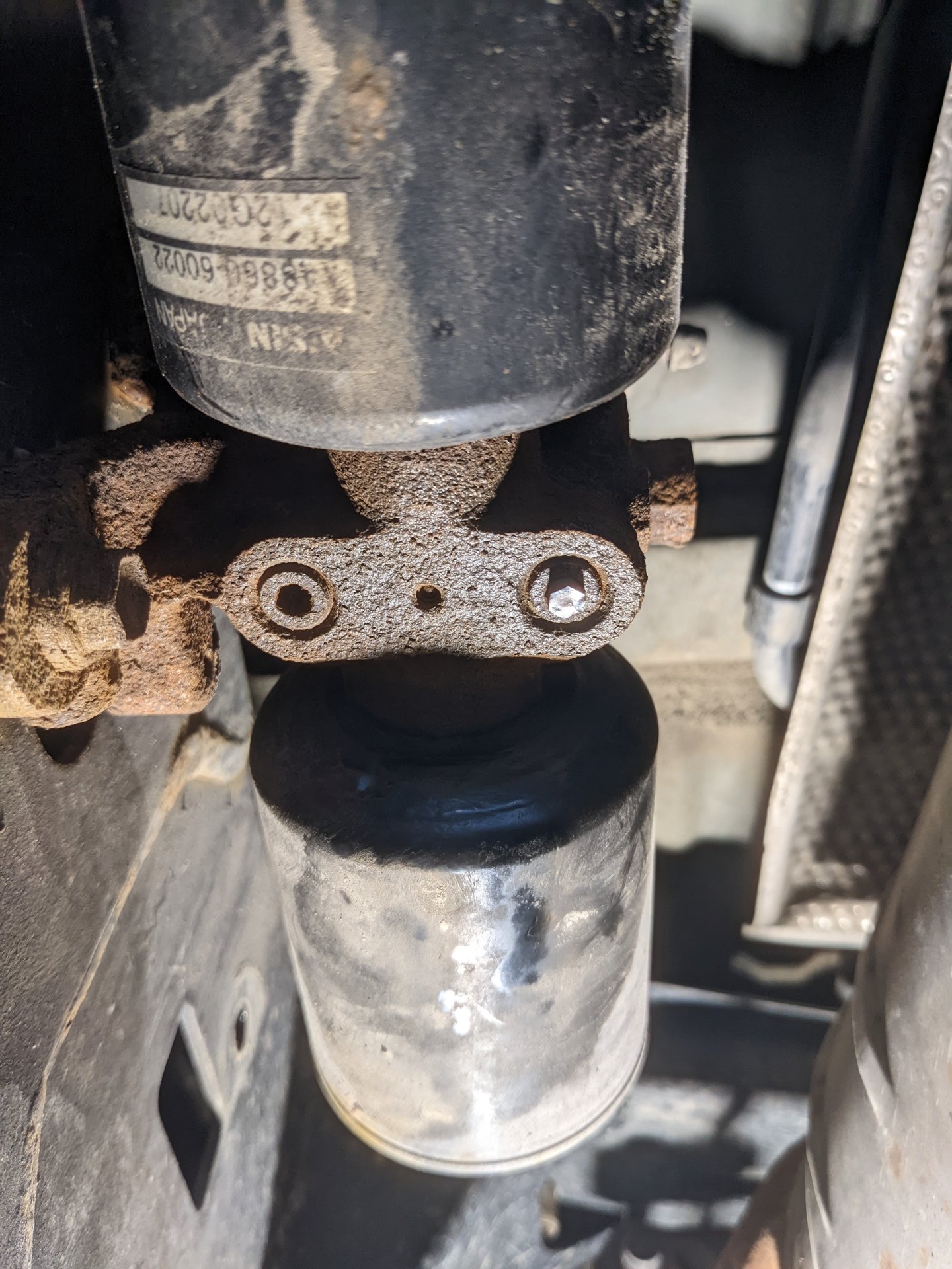

Peekaboo. I’ll be brushing this, PB blasting and trying to turn soon. 🤞
Also will order some LPS3
That doesn’t look bad at all. If it opens (likely) put a dab of anti-seize on the threads when you close it, then slather the whole area with marine grease. 6 winters in Chicago and mine still looks and works like nearly new just recoating with marine grease once per year
