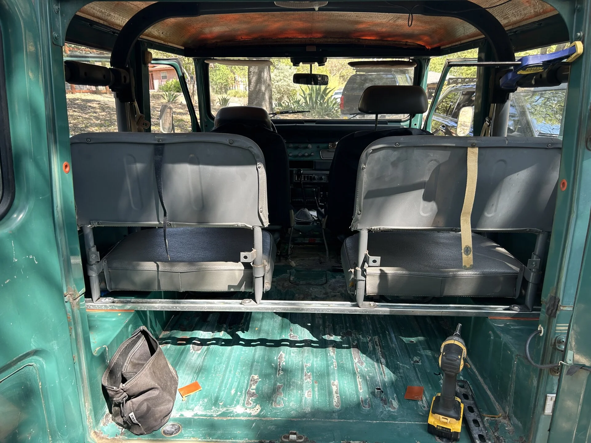

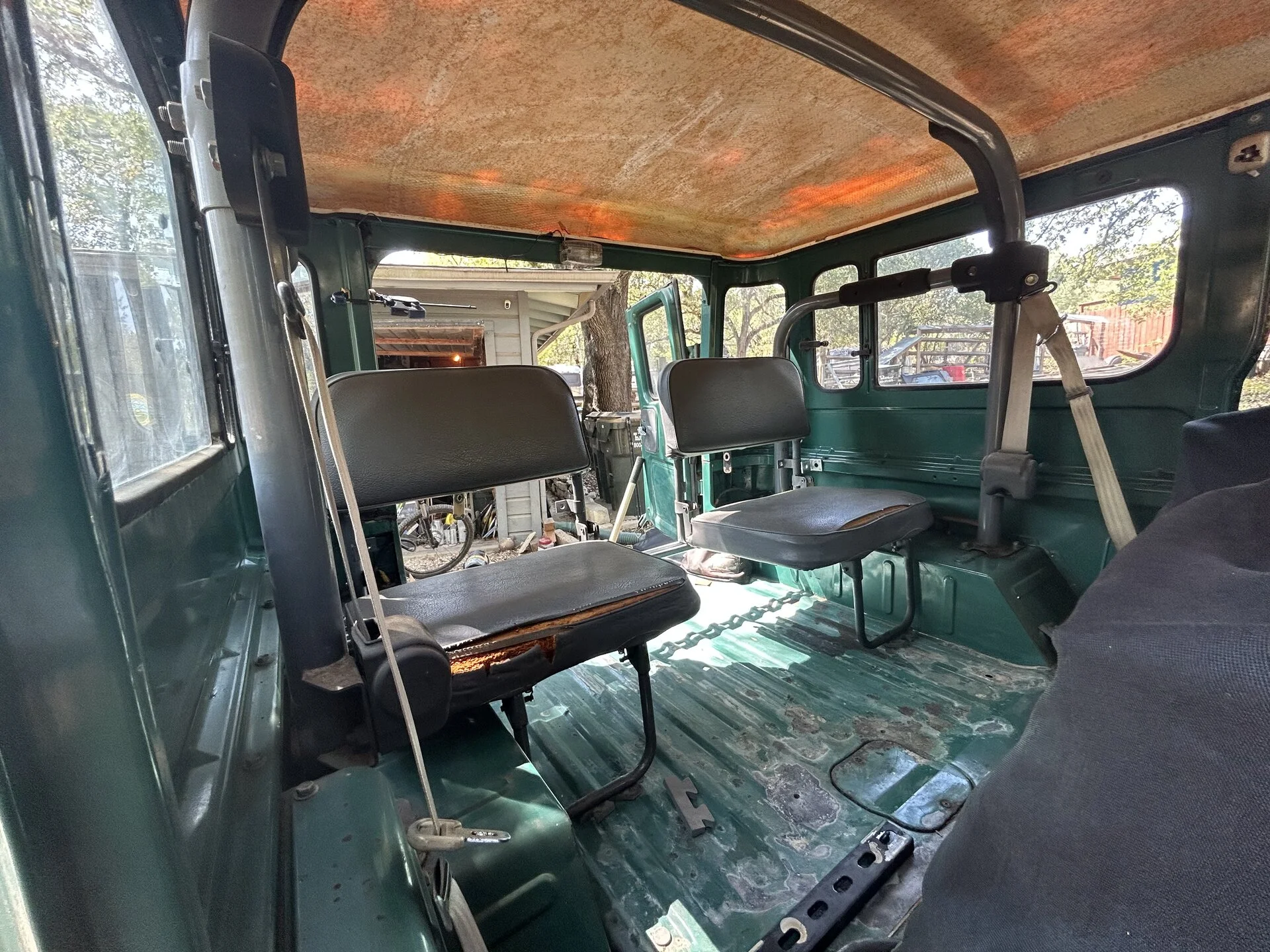

My thoughts and approach here is that there are currently only 4 small bolts holding these seats in and that is considered “fine”. If I apply structural steel along with gussets and heftier bolts, I feel I’d be ahead of the game as far as the seats go. Also, the passengers (my children most often) would be secured by the seat belts, which would be secured to the roll bar and tub and not the seats. So the seats are really only for sitting. Even 1x2” 1/8” wall tube is stronger than the tub I would think. However, it would all still be anchored to the tub so…
Be that as it may, I am rethinking things to anchor under the roll bar, however, that starts me down the rabbit hole of fabrication that I thought I might be avoiding.
All in all, I like the idea of using the factory seats in a different manner without major modifications to the body or seats. That’s the fun I guess.
I do appreciate your help, really. I wasn’t yelling, I was capitalizing to reiterate my point.

I welcome your suggestions and input, for instance, what size tubing would you recommend in this instance? Surely we can agree that the seatbelts are the deciding factor in safety, right?

Besides the small unistrut I see only two bolts being used on the bottom of the seat. Neither of the factory locations at the top are bolted to anything. Originally seat bolts to the wheel well and the heavy boxed section at the at the top of the tub. Any type of front impact wouldn't be surprised to have the unistrut flex forward and the fold down leg to fold up. I'm careless and I get hurt figured that's on me. Someone else getting hurt because of my carelessness is completely different.
I'm at an age I would agree. Now small kids I think need to be protected until they are old enough to make those decisions for themselves. My kids are in their late thirties early forties now. When they were young by the time we had a third child the oldest was just about to get out of a child's seat. I never had three in the Bronco seat I had in my 68 FJ40. Seat was secured to the floor with grade eight bolts and heavy fender washers. Had a large piece of angle iron bolted thru the floor into the frame on each. Seat belts were bolted to the angle iron. Took my kid safety seriously.
It’s literally just a mock-up.
Just a test to see if the seating works and I’ll move on from there.

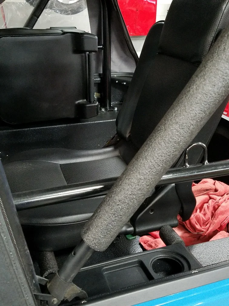

Ian I had a friend use the rear seat from an old Scout, I think he still has the 40 with the forward facing rear seat. IIRC it tumbles forward behind the front buckets when not used. Let me know if you want to see some pics.
@DangerNoodle used Rover seats to do something similar. Maybe find it in his build thread for ideas.
I like them, not the most comfortable, but way better over the stock postion for long wheeling. Shorter people like them more as well.
Next one I'm doing is getting streched about 12" and a full floor pan removal and 4 full bucket seats lol.
Messing around trying to figure out how best to install a Bestop fold and tumble rear seat and I get this idea. Surely someone has done this?
The Bestop sits too low and I’m looking at 5 holes to drill into the tub. This route would use all factory holes where the jump seats mount and would only need one hole for the seat belts between seats.
Just a mockup currently… looking for thoughts or ridicule.

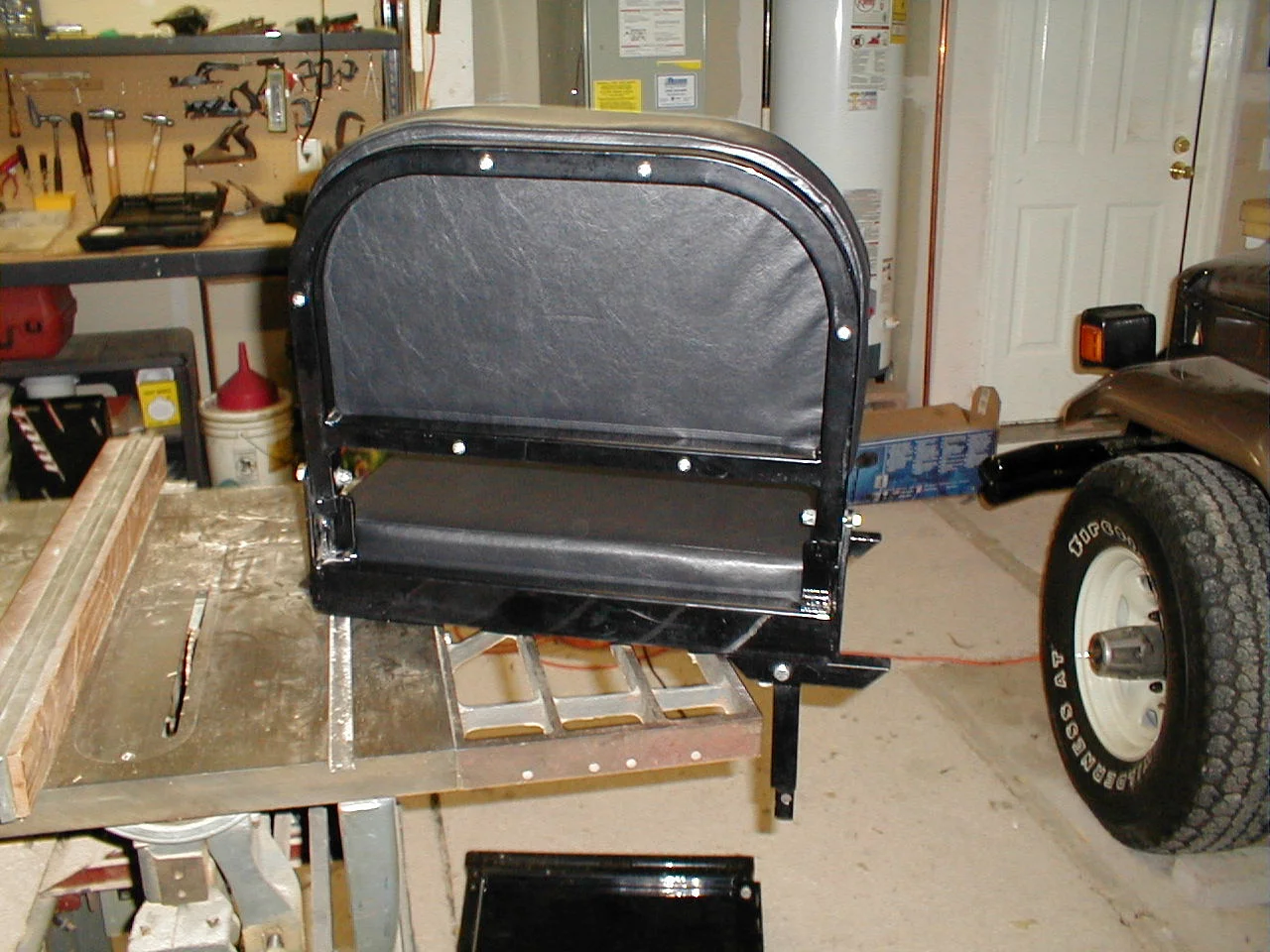

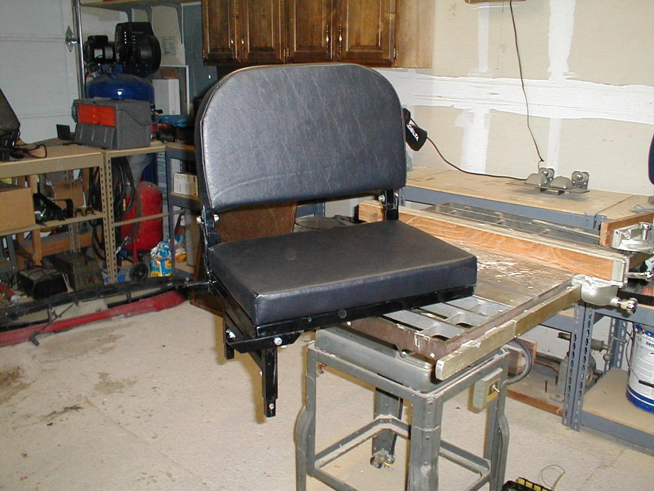

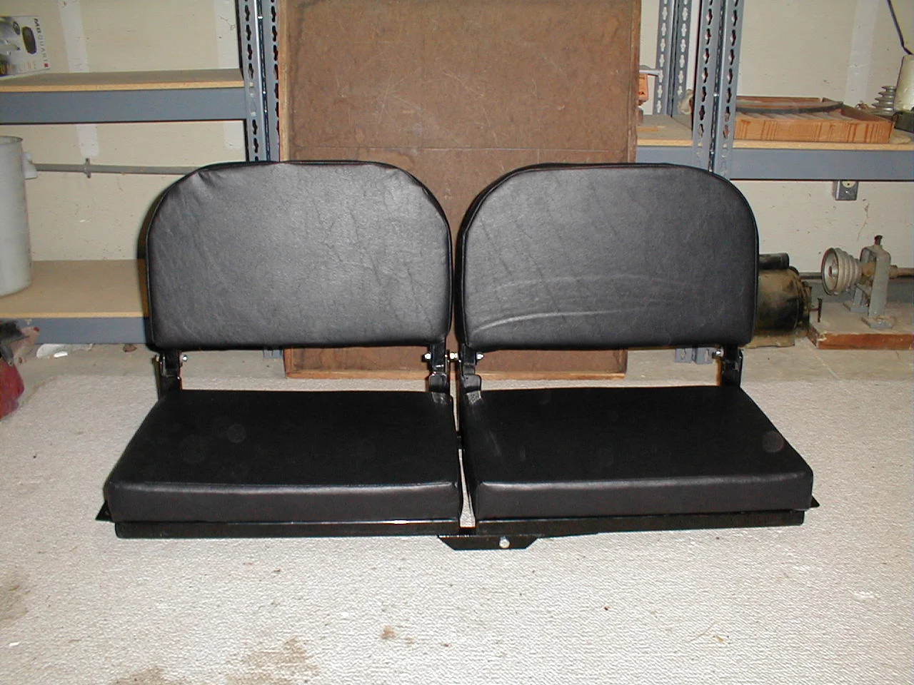

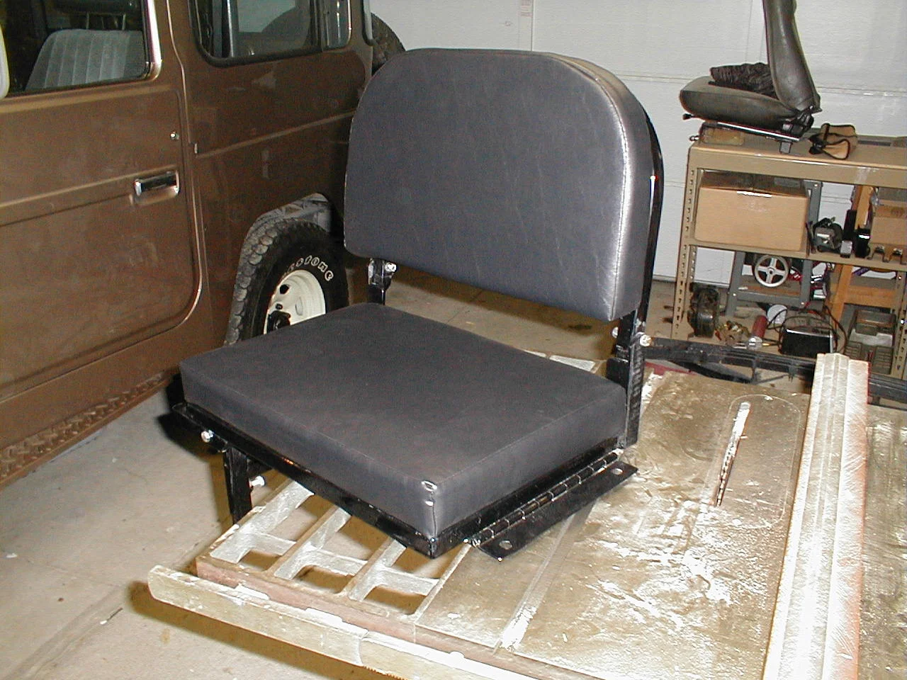

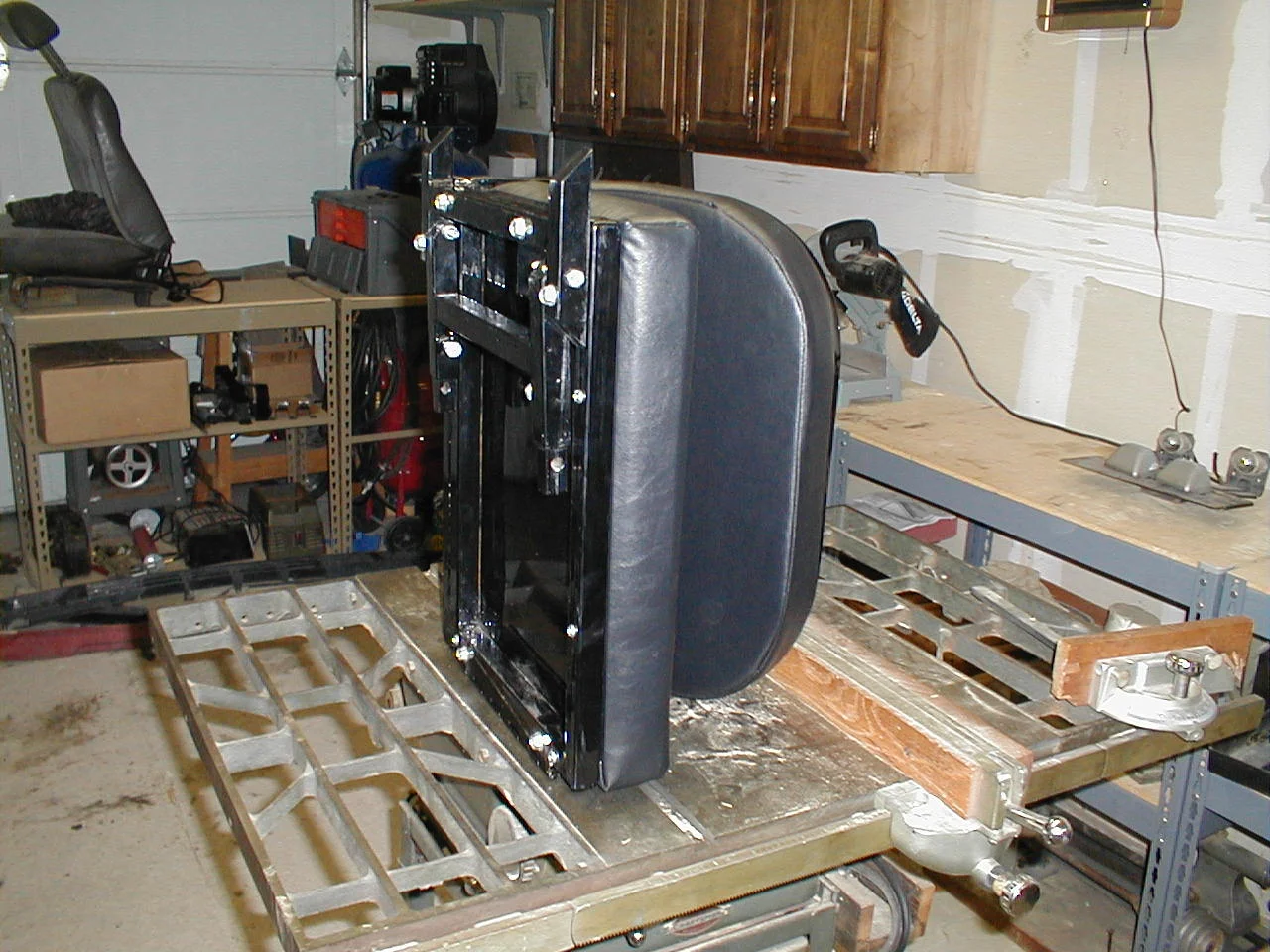

These are mine
Pics of the seats I mentioned. I never ended up using these and sold them. They bolt to the edge of the rear wheel wells and fold down. One seat has a leg that folds down, the other seat rests on the one with the leg. They were really heavy wall tube. Unfortunately I do not have any pics of these sitting in the back of a 40.

Bottom line: If you put a couple of big guys in these seats and go for it over a bumpy road, would they stay there? No it would bend. That shouldn't happen at all.
In a crash you'll see a much greater load and it could be in any direction.
Yes, in the 70s the focus was on seat belt mountings and the seat was just there to sit on.
Modern seats shouldn't fold up underneath you in a crash in any direction.
You could add a second strut across under the front of the seats which would prevent the leg issue. Increasing the size of the box to say thin wall 2x2 should make the base fairly secure (if its fastened to something solid and with appropriate reinforcement). The seat back is still another story though but maybe you could add a third strut for arguments sake but now it's becoming a circus.
Access to the seats is another issue. They're climbing over these struts? Worse with one at the front and top too. Is that the entry/ escape plan?
I like the configuration but I'd retain access to the back door and that means welding up something a bit smarter, unless you're just chugging around the farm at low speed and want a quick solution.
My kids ride in isofix child seats which clip into seat bases, which in turn clip into modern seats pilfered from a modern car - no seat belts are used to fit them.
The seats are bolted directly through the floor with reinforcement plates.
You have a roll bar - how about getting something welded up onto it to carry those seats properly? Just remember to check what its bolted to.
Alternatively you might find a standard van seat frame on ebay which can be hacked around.
this is great food for thought, thanks for taking the time to post these.
You mention access and escape plan, with the Bestop passengers would have to enter via the small V created by moving the front seats forward. I had my daughter do it when I had the Bestop sitting in there and while doable it wasn’t great.
This configuration was a lot easier to enter through the back, even if they had to step over the bar. In fact, it increased the available exit options by adding rear entry.
