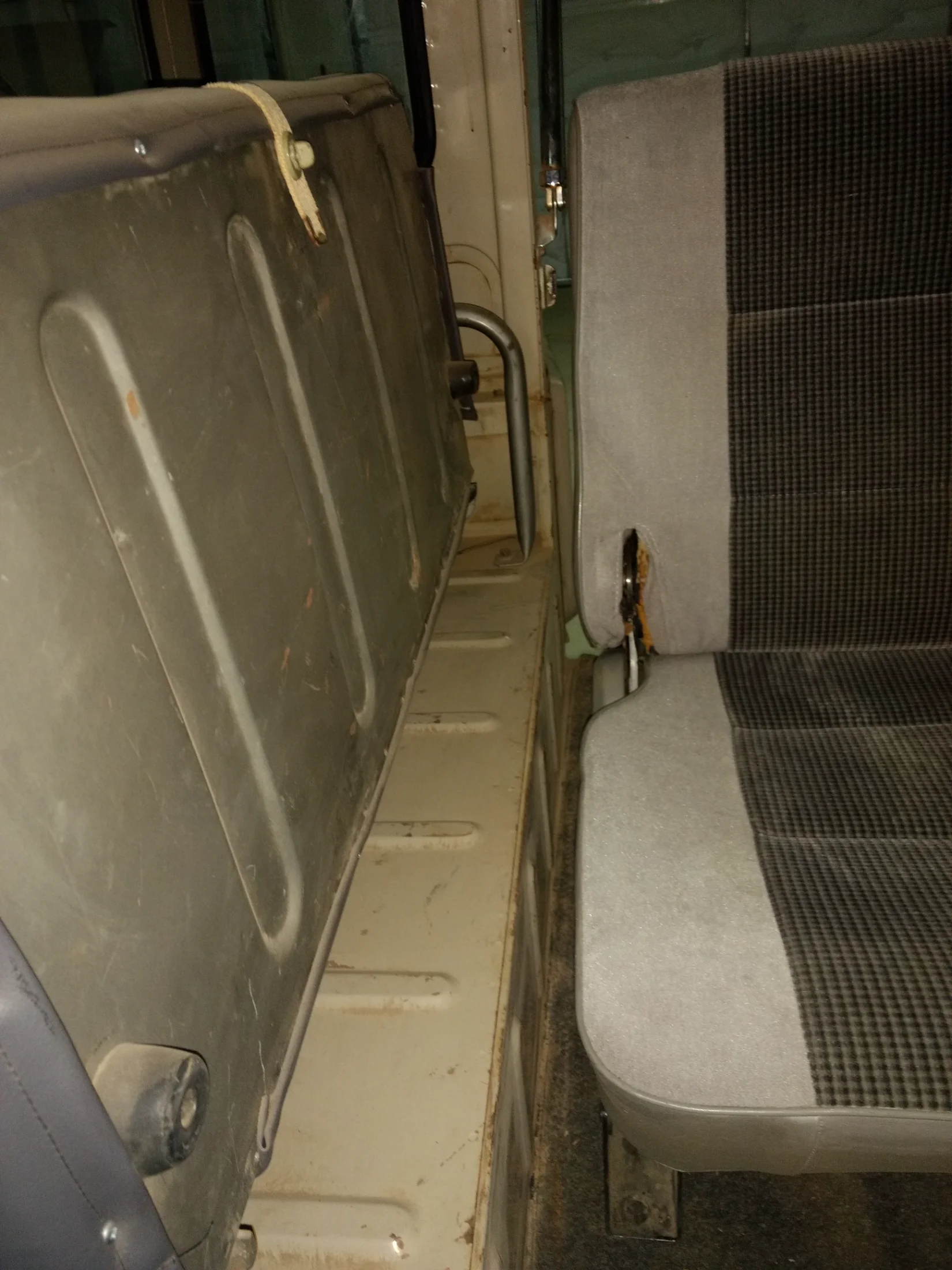

@Living in the Past what seat is that and also how is the bolt under the floor (like close to fuel tank?)

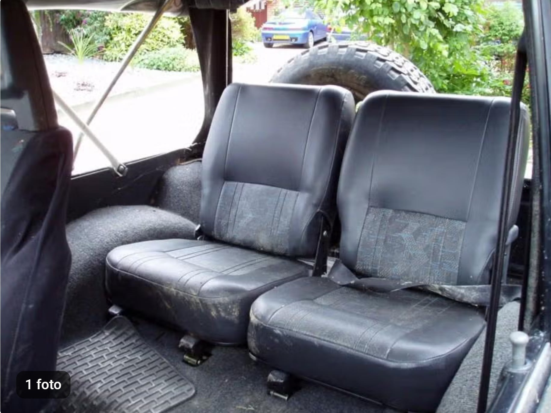

now looking for Suzuki samurai fold seats, depends on price, the volvo seat is a bit to small I think, but it was for free.

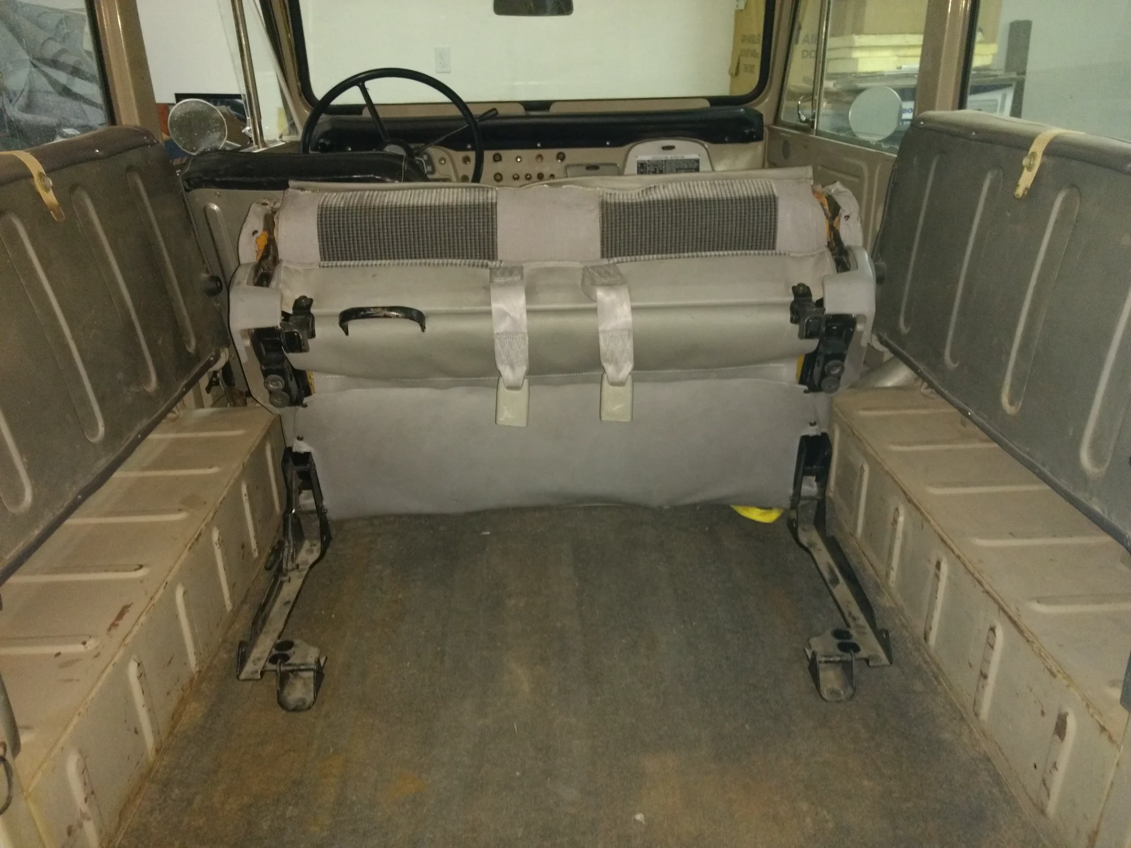

That seat is out of a late 1980s two door Mitsubishi Montero. Probably not easy found today. Found that one along with the front seats. The driver's is a suspension seat. Front seats suited for 9/72-1/79. Earlier would need to remove the under seat tool. Later would be way too high unless you removed the suspension base. Probably been over twenty five years since I bought those seats.
Tried the mitsubishi seat (a few #14 bolts and pull seat out of 2 brackets) but seems not worth it, brackets do not align and fold does not really help to be strong (no mount at head rest level)
seat is also not strong but very light and soft (in the car it has steelplate under it)
steel floor is support of seat.
Found socket #13 !
samurai seat :
