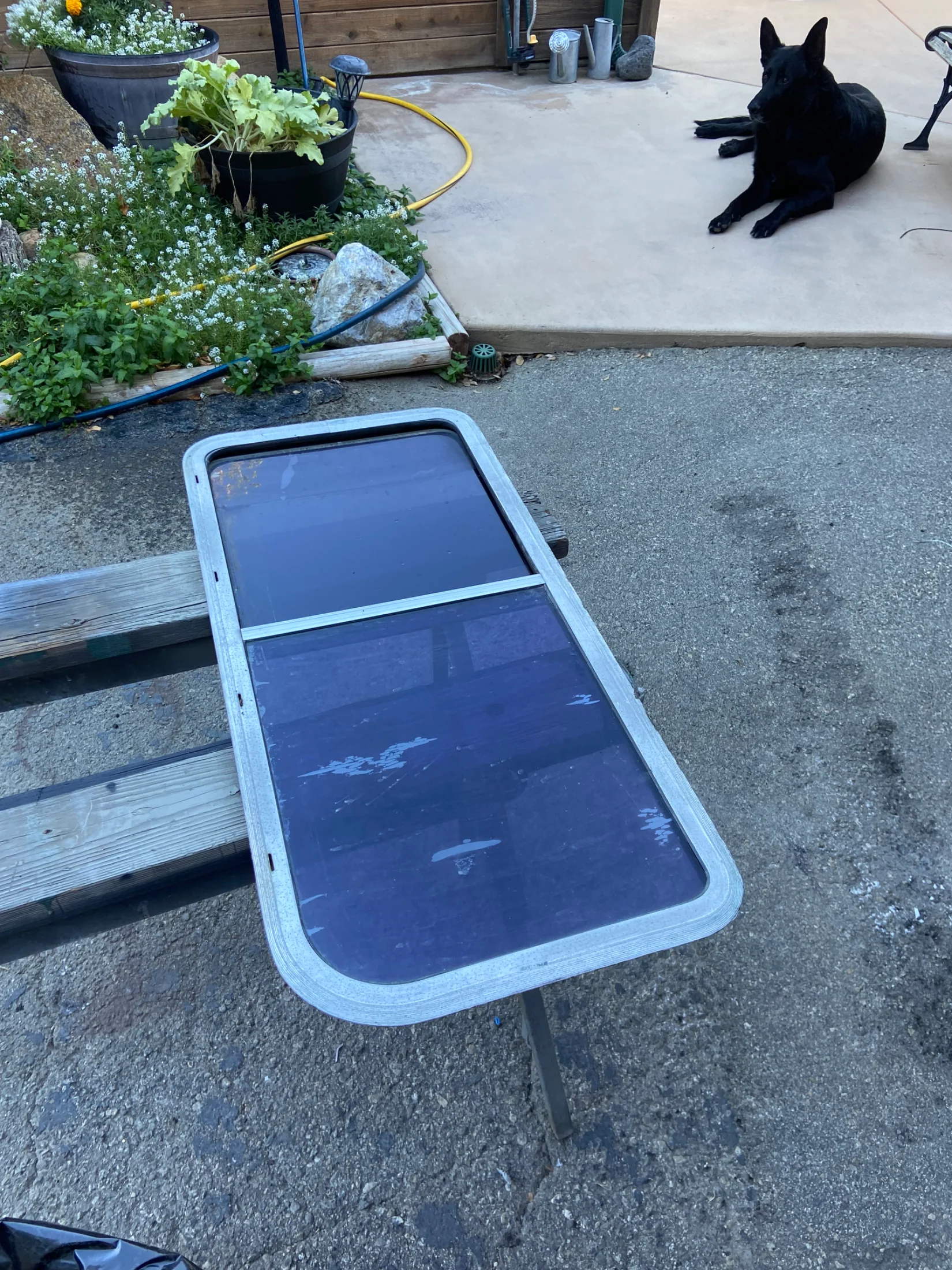

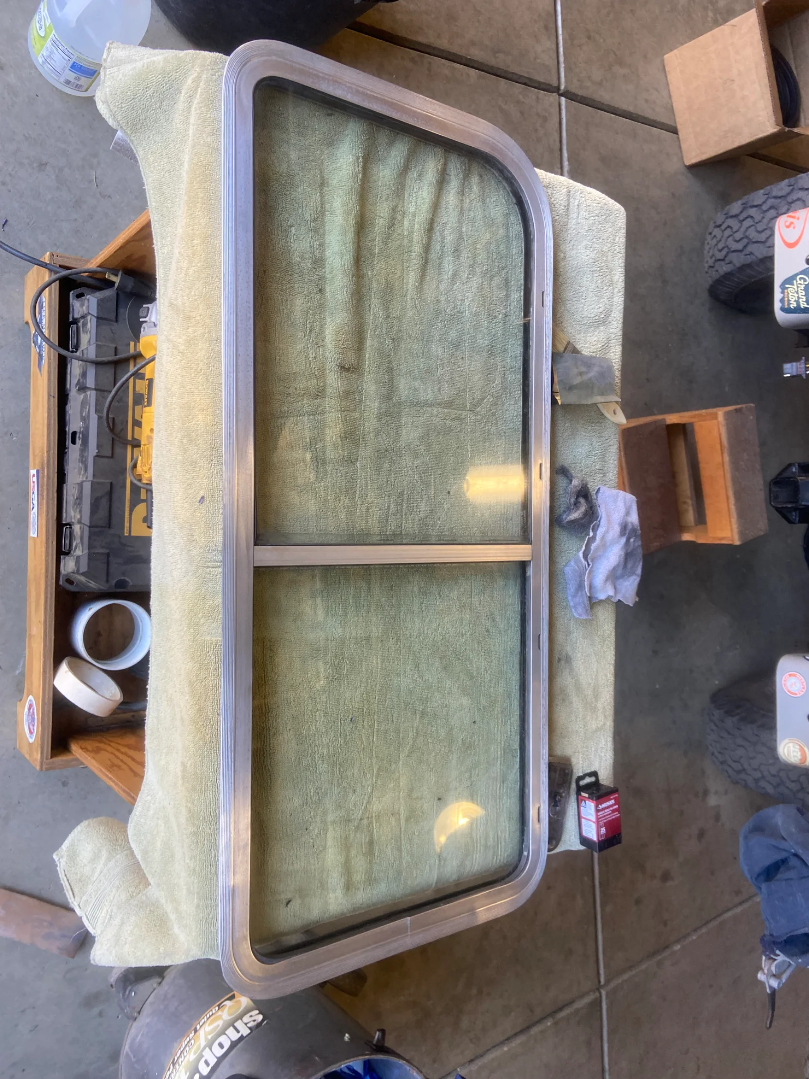

Are those 33” tires and (off topic) is that a SOR sliding window?
Yes on the 33’s and no idea on the window. They did have purple tint on them if that’s any help 😂
I always wondered where they came from.

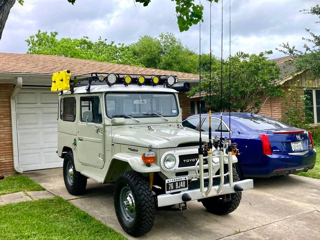

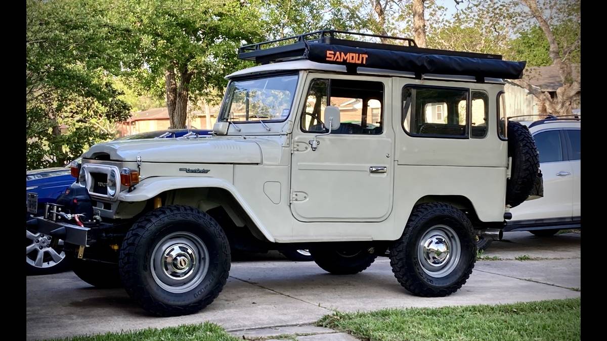

For some reason your pictures didn’t show when I first saw your post. Beautiful BJ40. The weight of the hard top and accessories up top aren’t helping I would guess. Love the fish antennas.
A couple different things…
Whatever was stock doesn’t relate to your rig. Off hand I’d guess it’s an import from Columbia.
North American rigs didn’t come with these.

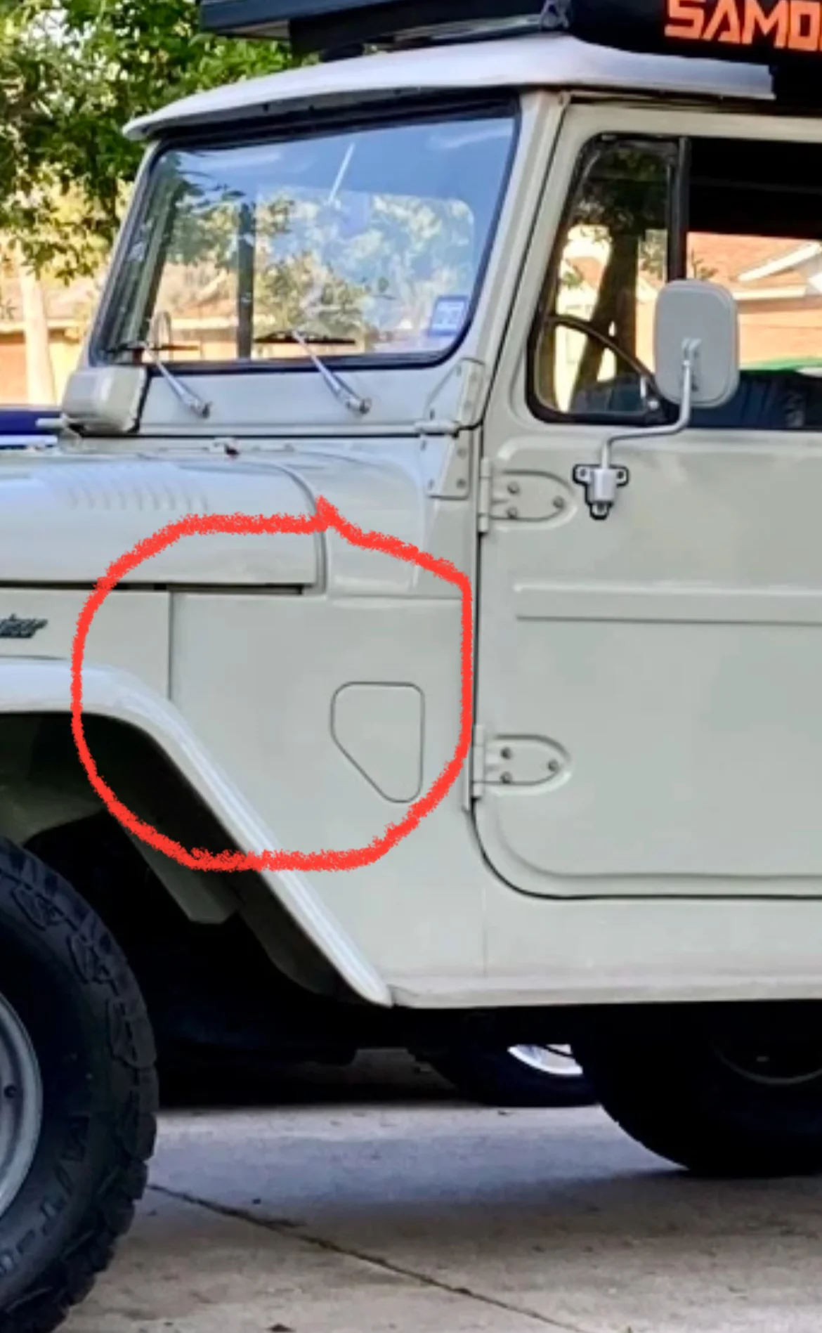

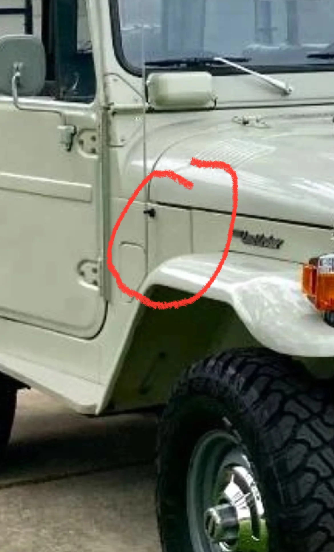

The front turn signals are correct for a ‘76, but

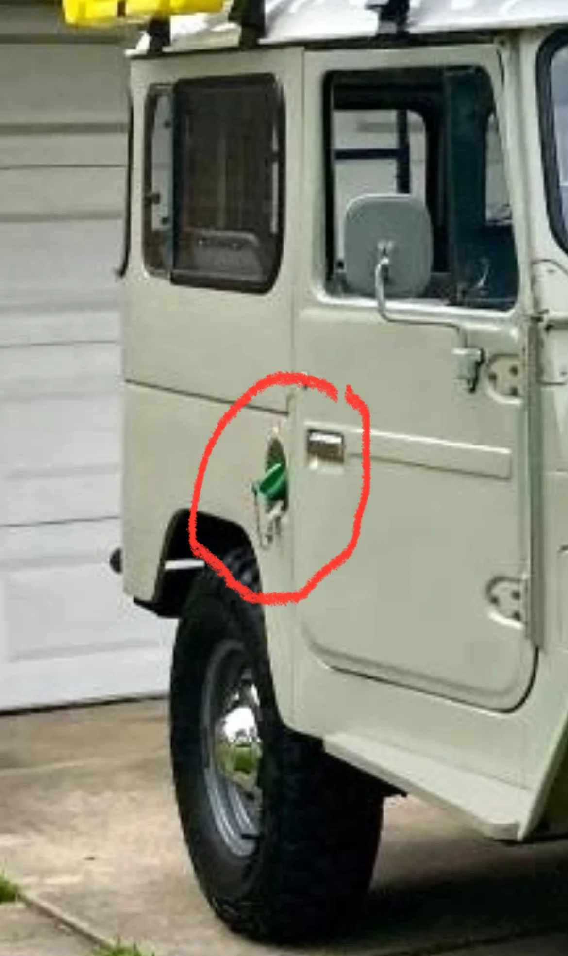

This fuel filler is pre ‘73.
The lack of lovers here also suggests an earlier tub.
Not having them on the passenger side is something I’ve not seen before in a steel bodied Landcruiser.
Off hand I’d suspect your truck is a mix and match of several years parts. The kick out hardtop windows didn’t show up until some point in ’78.
I’m pointing these things out to help you understand what you have. My own 40 has a ‘77 rear axle, ‘76 front, ‘76ish frame, ‘81 hardtop sides, ‘75 hatch, ‘74 windshield, ‘74 doors, ‘74 cowl… etc. it’s good to know what you are working with.
Springs for a ‘76 should work but your frame could be older or possibly newer.
I don’t believe that rear sag was original, but it seems to be a common problem with many different Toyota models as they age. Much as many 40s lean towards the driver’s side… especially if the spare is also mounted on the same side.
In North America they tend to be lower on the left. I don’t know if they lean towards the right in RHD countries. Pre ‘75 would likely be the worst since they have the spare on the right side.

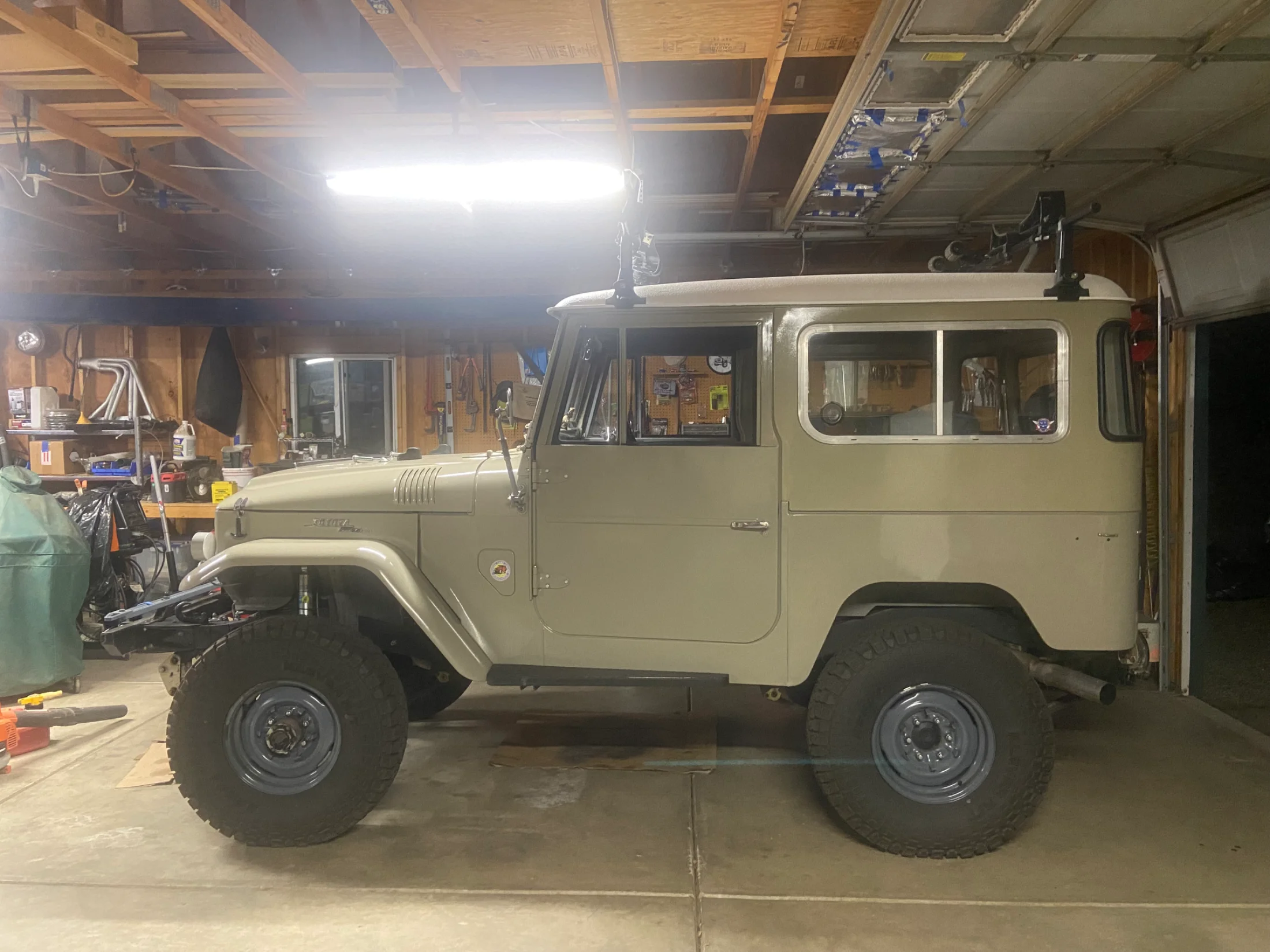

It appears to be a later frame 74+, looking at the silhouette of the rear tail lights thru the rear pass fenderwell. It looks like the 2 windshield hinges are different, one early model on the drivers side and 1 later model on the pass side. What's the frame #?
Good morning, folks. I appreciate all the input and comments. I’m aware that the truck has a pre 76 tub. It has a 4spd tranny and front bench seats. My 40 came from Costa Rica and it was picked up from the port of houston 5 years ago.
The Rack, rod holder and front rubber bumpers are off, giving the truck a fresh US spec look from a far. I’m currently replacing the TREs so I’ve been busy preparing the frame and axle for a nice coat of paint.
The truck is definitely a mut but it’s been very dependable. It has a solid B engine that turns on quicker than a F1 McLaren engine! lol. It runs great on the highway but begins to struggle once I hit 62 mph so I usually just run it around 55 mph.
Anyway, Thanks again for all the comments and advice. I’m seriously looking at adding 2.5” springs snd maybe going with 285/75r16 tires (about 33” tall, 10” wide).

It looks pretty good to me honestly, that's about how mine is. I havent measured but I think the front wheel openings are a little higher on the body than the rear by design-if this is true it contributes to the sagging rear suspension look without there being an actual issue
