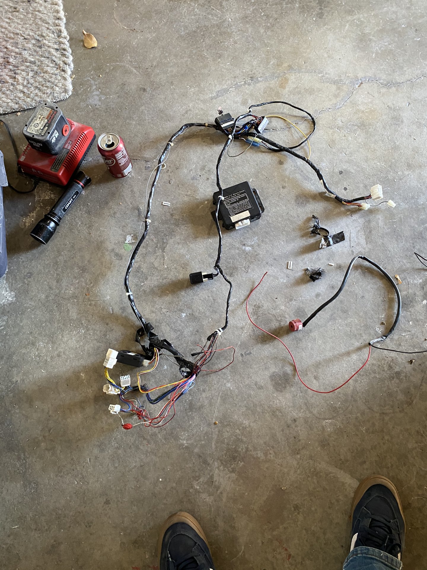

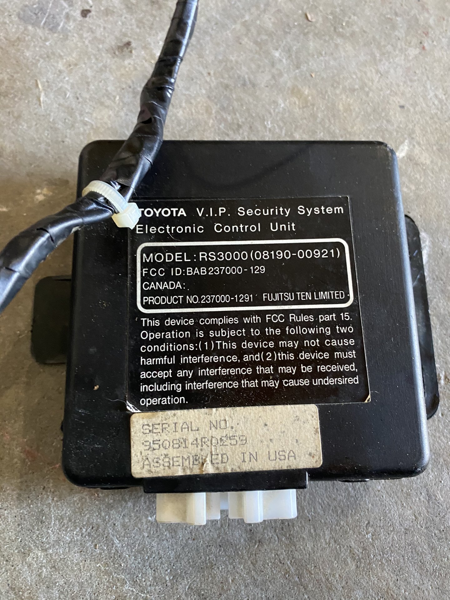

The RS3000 alarm interrupts the logic path between the ignition switch and the NSS with a simple relay closure.

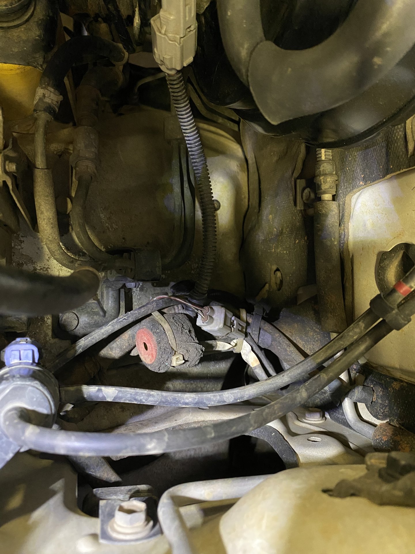

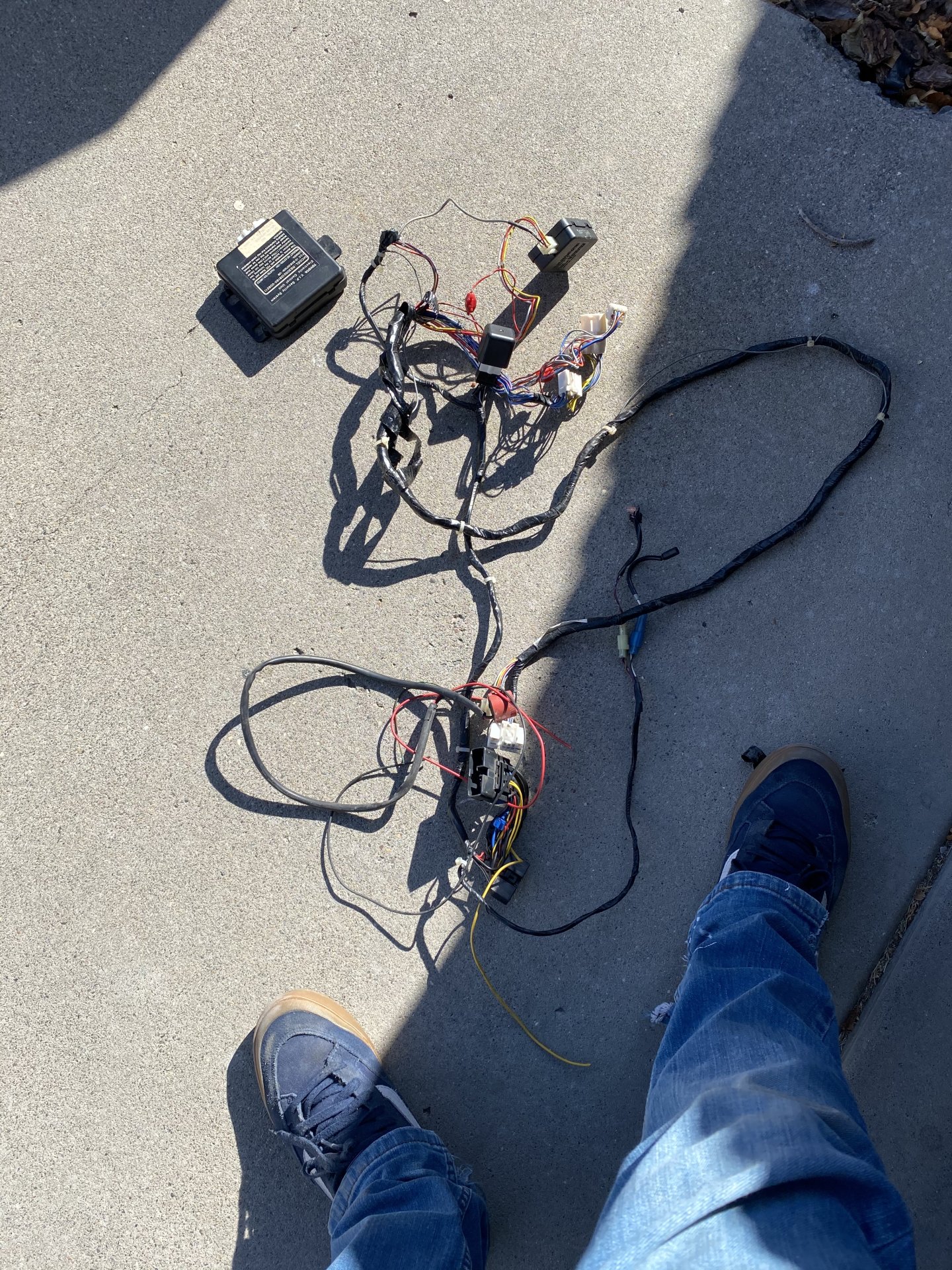

I removed my alarm first thing, there was plugs and splices that had to be removed. First pic is what was under the hood. Then the brain rest was under the seat, in the kick panel and under the dash. Pulled the seat, and lower dash and kick panel out.

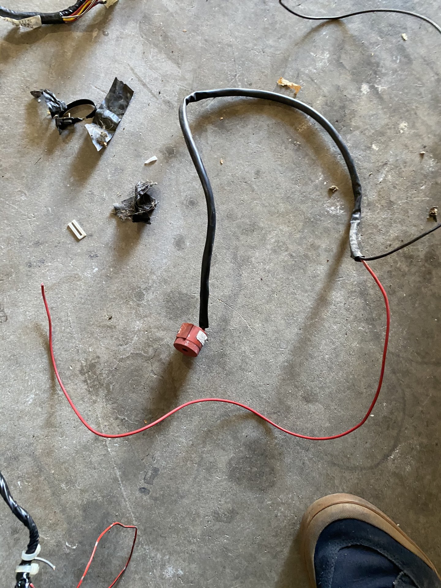

Is this red circular thing part of what you removed for the alarm? I don’t see any wires going through the firewall. I think some of it has been removed already.
The red circular thing looks like a piezoelectric beeper for the alarm. It's not OEM.
I think so too, I looked up the company and saw they made beepers for cars. Took that out too. So far it’s been ripped out for a few hours and hasn’t not started.
