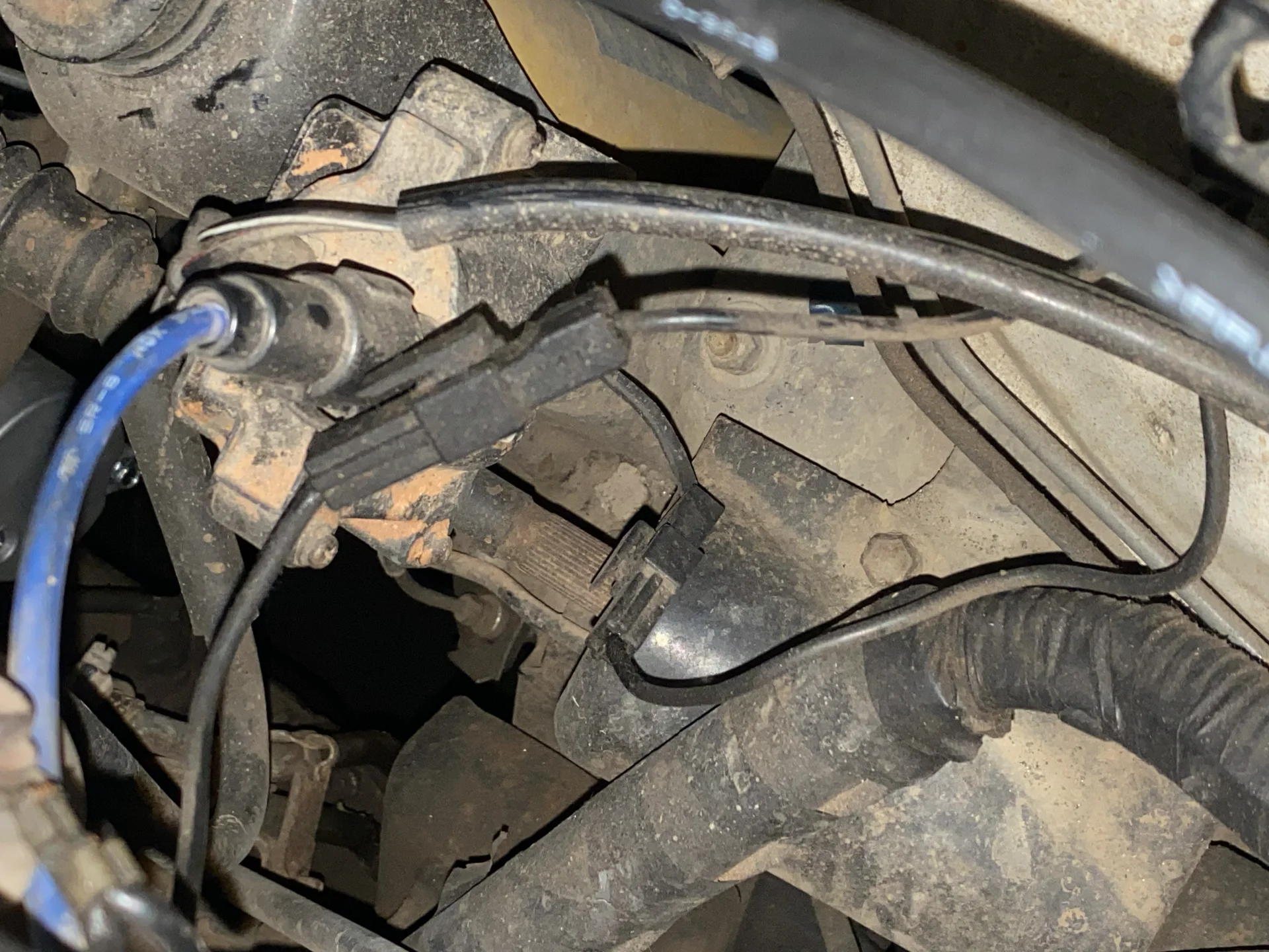

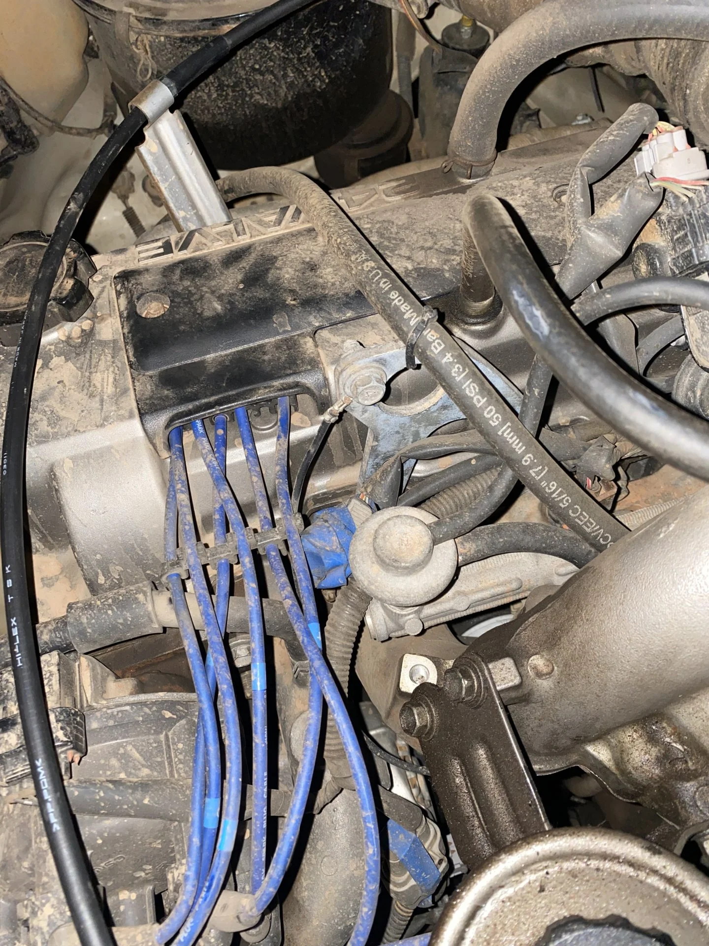

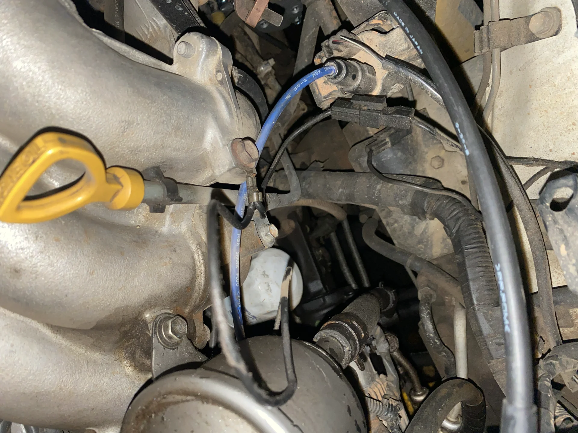

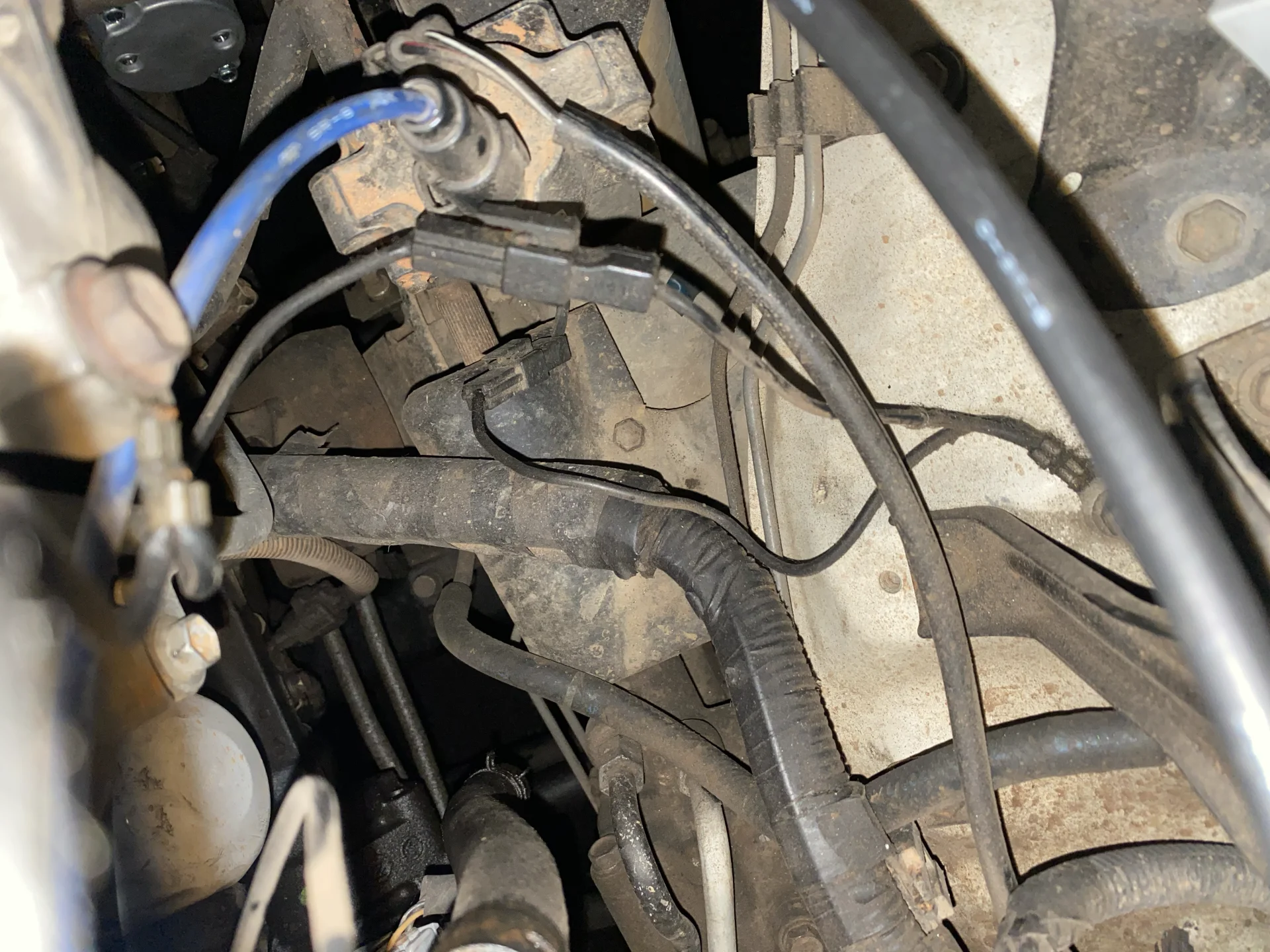

So I went to go check my grounds that I could find off the FSM. Haven't found much but here's what I found. They all look good to me?
