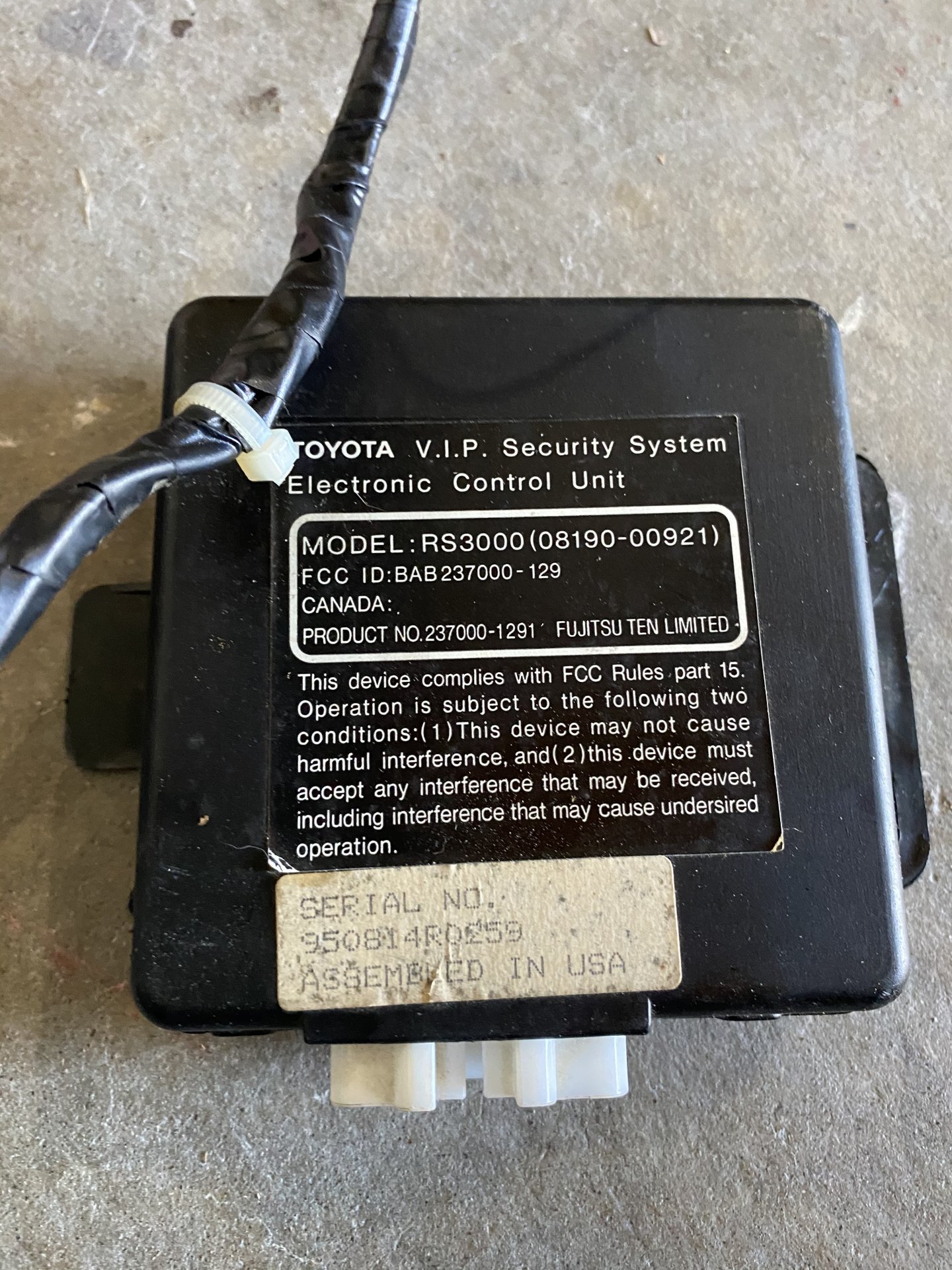

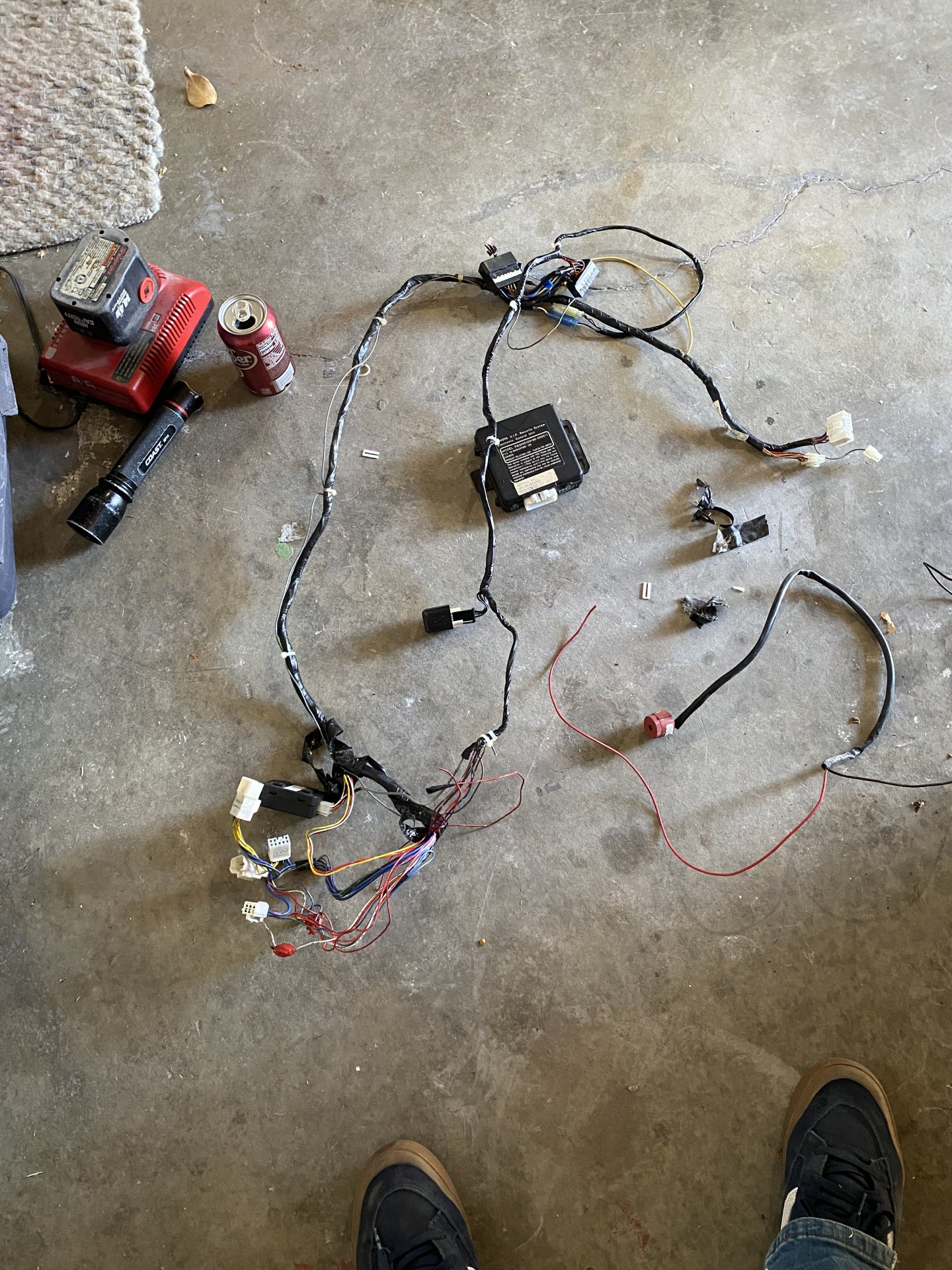

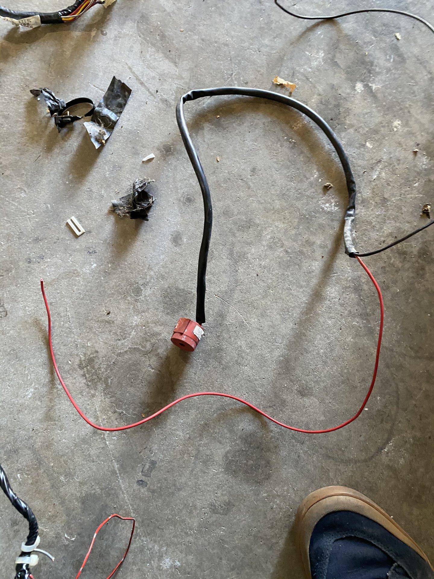

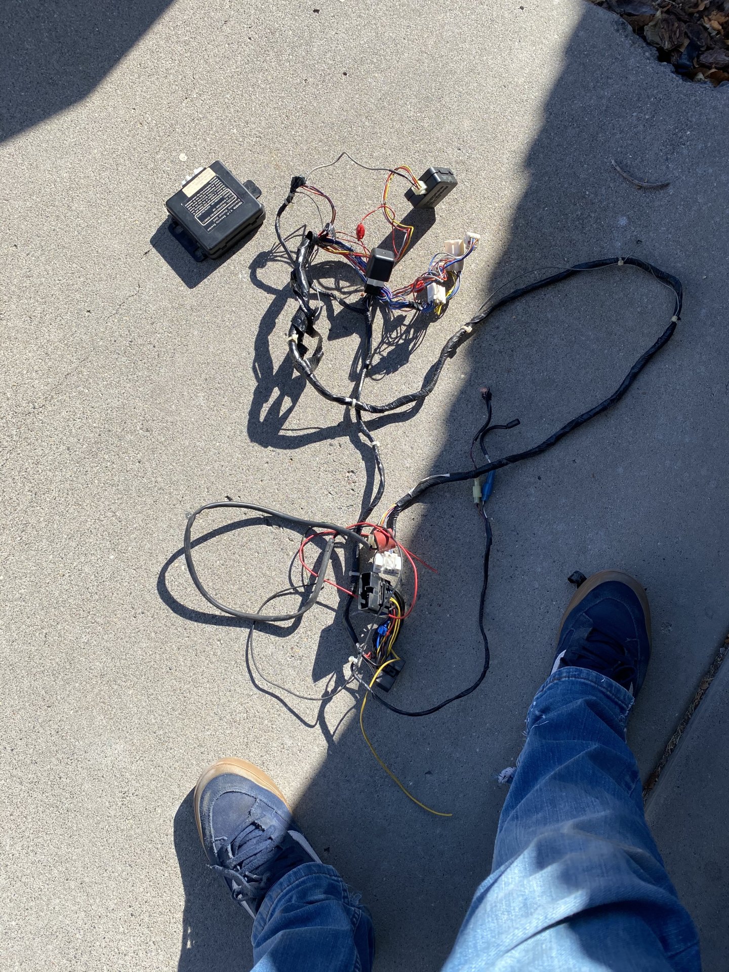

I removed my alarm first thing, there was plugs and splices that had to be removed. First pic is what was under the hood. Then the brain rest was under the seat, in the kick panel and under the dash. Pulled the seat, and lower dash and kick panel out.

Not all of the dealer/port installed (what some call “factory”) alarms are completely plug and play. Be prepared to fix some splices.

Then I would say it's most likely related to the alarm and its ignition-kill relay and/or corrosion on the path between the switch and the starter. The latter is related to what @jonheld said. I *think* that varying degrees of resistance due to corrosion could cause results that range from no starter sound whatsoever to a thunk without cranking.

Personally, I would look for the alarm's kill-relay first. Check for voltage on the input side from the ignition (verifies whether the ignition switch works), and listen/feel for the click of the relay.
If it's like the alarm on my rig was setup, the relay is tucked to behind the middle dash panel, just left of the climate control area, and it taps into a thick wire on the underside of the steering column. Also, if it's like my original alarm, it was installed by buffoons using those awful Scotch-Lock connectors, which resulted in several broken circuits behind the driver's side kick panel.

Yeah one of my next steps it’s to tear out that damn RS3000. I have read a thread of people adding the solenoid, but I’m not interested in doing that. But I am reading about it to get other leads on what the problem could be. Like I didn’t even think to check the Power cable going from the battery to the starter. Didn’t know those could go bad.
The relay for the kill-relay, would that be under the dash by your left knee? That little panel.
As I can tell it’s the RS3000 and doesn’t seem to be touched… I think. Won’t know till I go to pull it out.
