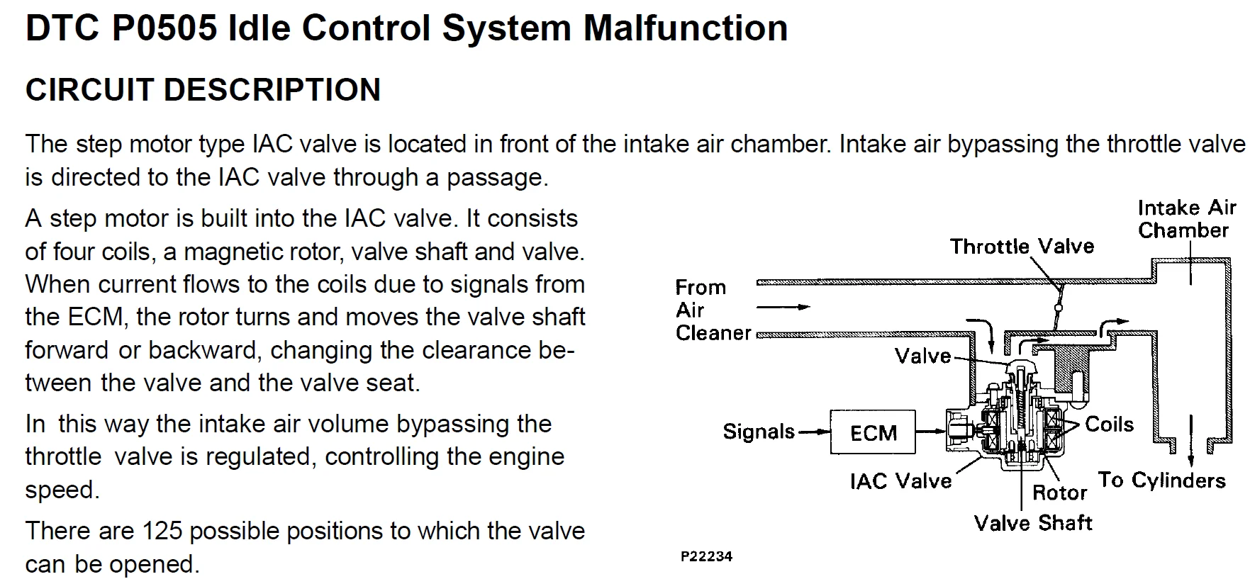

Here's what the IAC circuit looks like:
You may, or may not, get a DTC. I never have on any failed IAC I've replaced.
