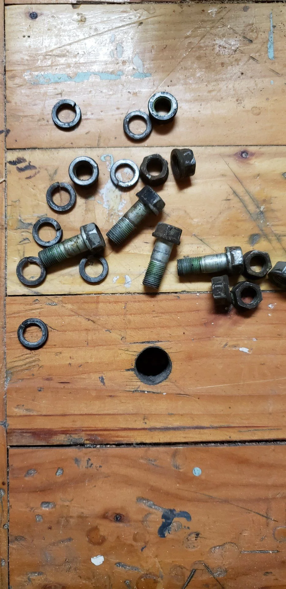

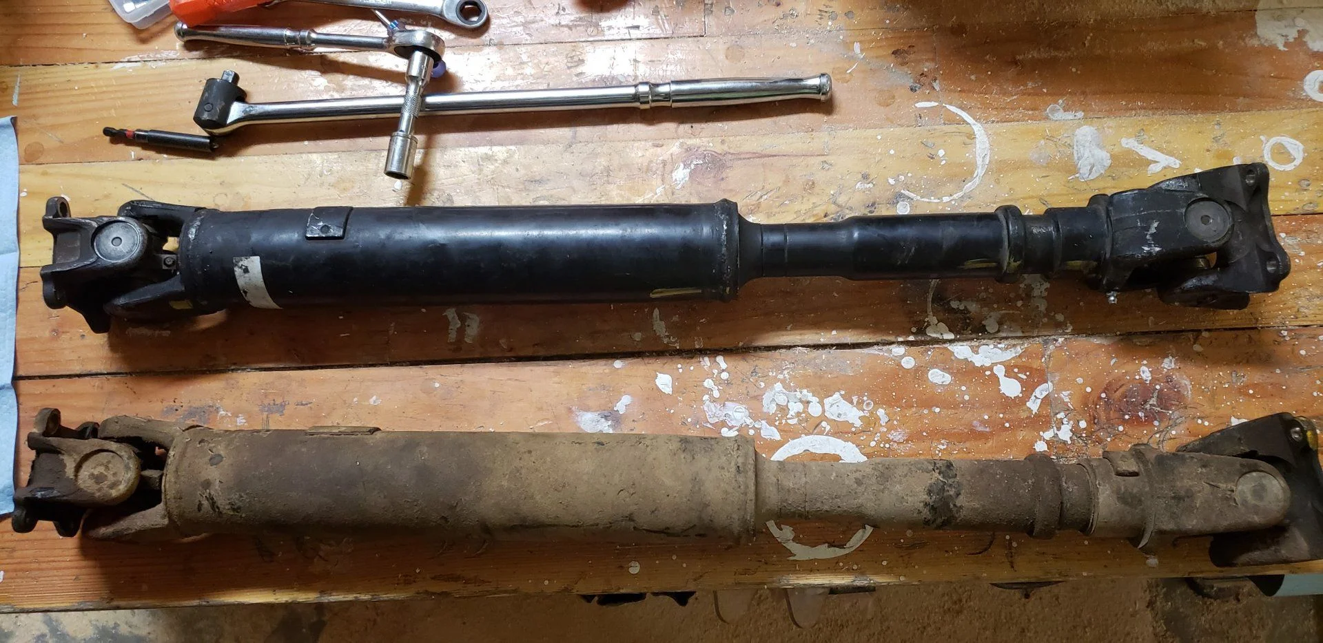

Spent last night pulling my front drive shaft. I have a spare that is dressed with new Toyota U's. Things were pretty rusted and with my luck I could find everything but what I needed - anti-seize and the penetrating oil. So the job included a trip to the autoparts store. Threw the hardware in my new harbor freight parts cleaner which does a pretty good job. Well worth the 5 mins to setup. Going to clean up the threads at the tcase, and she'll have a new front drive shaft.
My LS swap has some noise coming from the rear, so I ordered a new "woody" for the rear. I'll dress that old rear toyota DS with new U's and then move to the grocery getter. I can then clean up the rusted out DS's, dress with new U's and they'll be ready for swap out in the next 300,000 miles. Seriously, how do you tell when a DS needs to be replaced? I thought I was hearing a bit from the drive line, but I can't find any play by hand in the DS. And I had never greased in the 60k I've put on it and I'm guessing the previous owner didn't either.

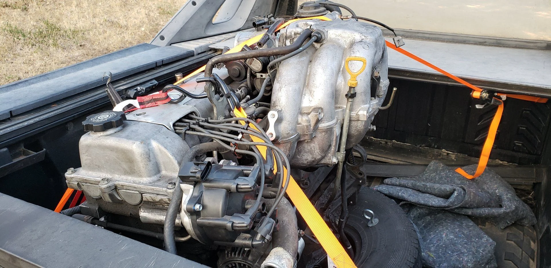

Bought a donor motor the other night. $200 and had a knock with 245k on the odo. Probably spent more than i should, but i figure if i part it out over the next 10 years i should be able to get most of my money back out of it 🤣.

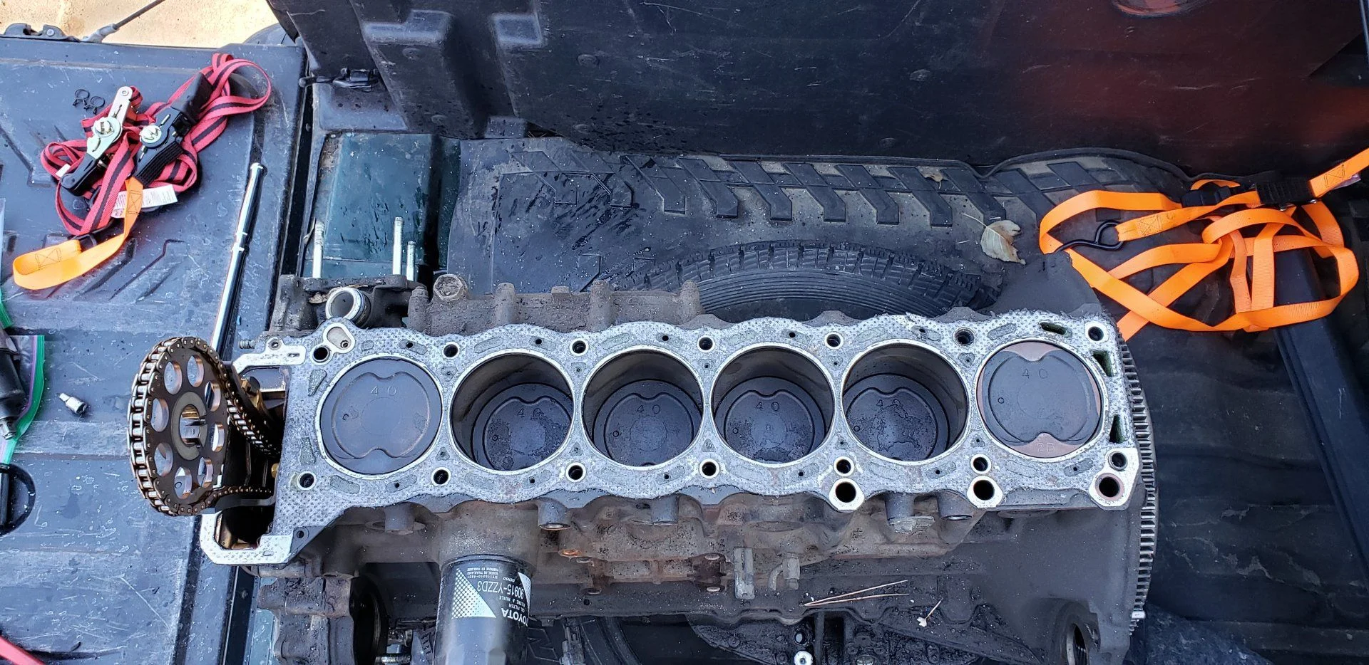

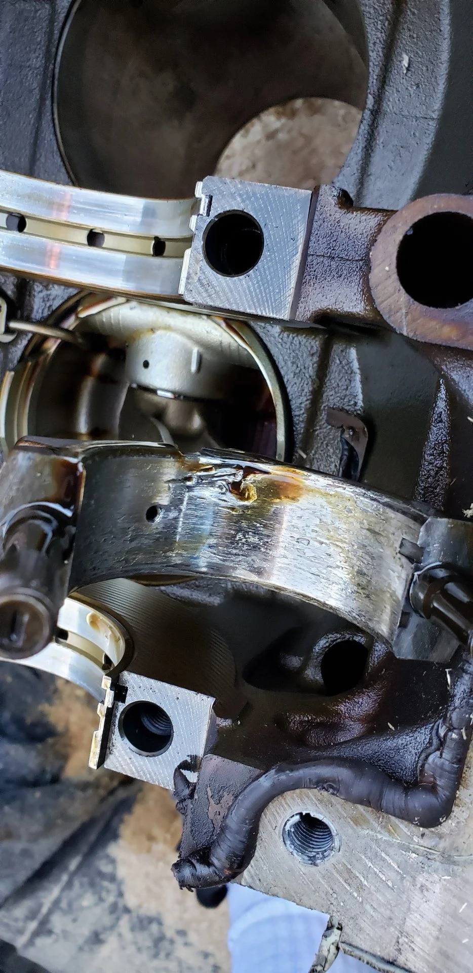

Tore down the motor the last 2 nights. I probably f'd a lot of stuff up, but i got everything out. I've been trying to understand how this rebuilding process goes, so i finally just called the machine shop and they have been really helpful in "holding my hand". I drop off the head, timing chain cover, block, pistons and cam tomorrow. They'll clean it all up and let me know how to proceed from there and will let me order my own parts.
I fear i might need a cam shaft though. I figured out the source of the knock. Any opinions on if this cam might be salvaged?

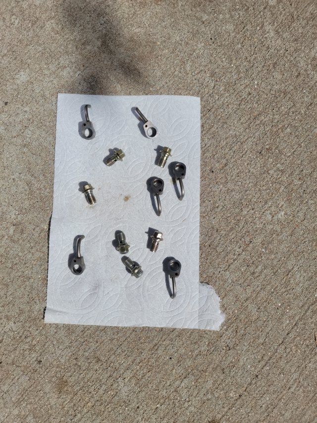

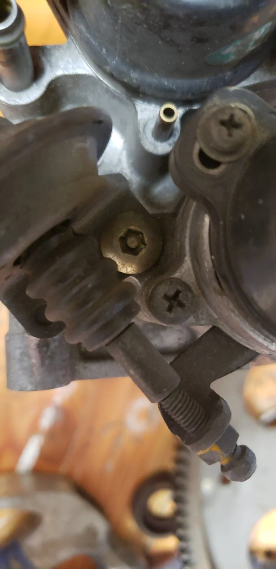

Been in part cleaning hell. Anyone know the size of this antitheft hext key on the side of the throttle body.

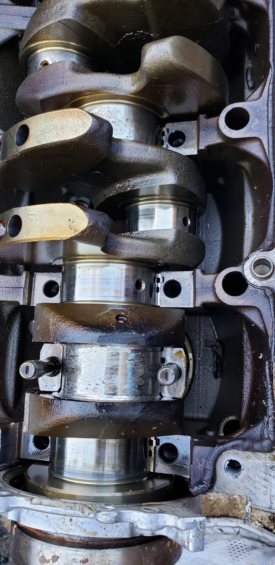

That rod is toast. Pm me your address And I’ll send you a couple good ones from mine from when mine did the same thing. I replaced the engine and have most of my old parts in the garage. Good news is your crank is probably ok but post some pics of it to be sure. I think the bearings have to be specifically matched to the clearance so keep that in mind when rebuilding.
Also, not sure about that screw specifically but if mr T didn’t want you to touch it, you probably shouldn’t touch it. That throttle body is full of really sensitive stuff that you don’t want to move (ask me how I know). If it’s not too late, do not remove the throttle position sensor.
Post 3: actually it looks like your crank is shot too. You are going to need a new engine unfortunately.

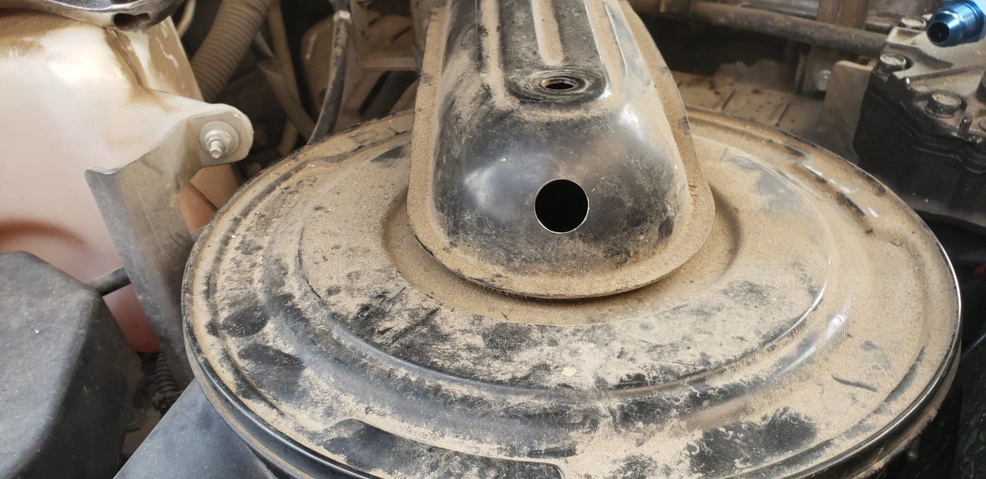

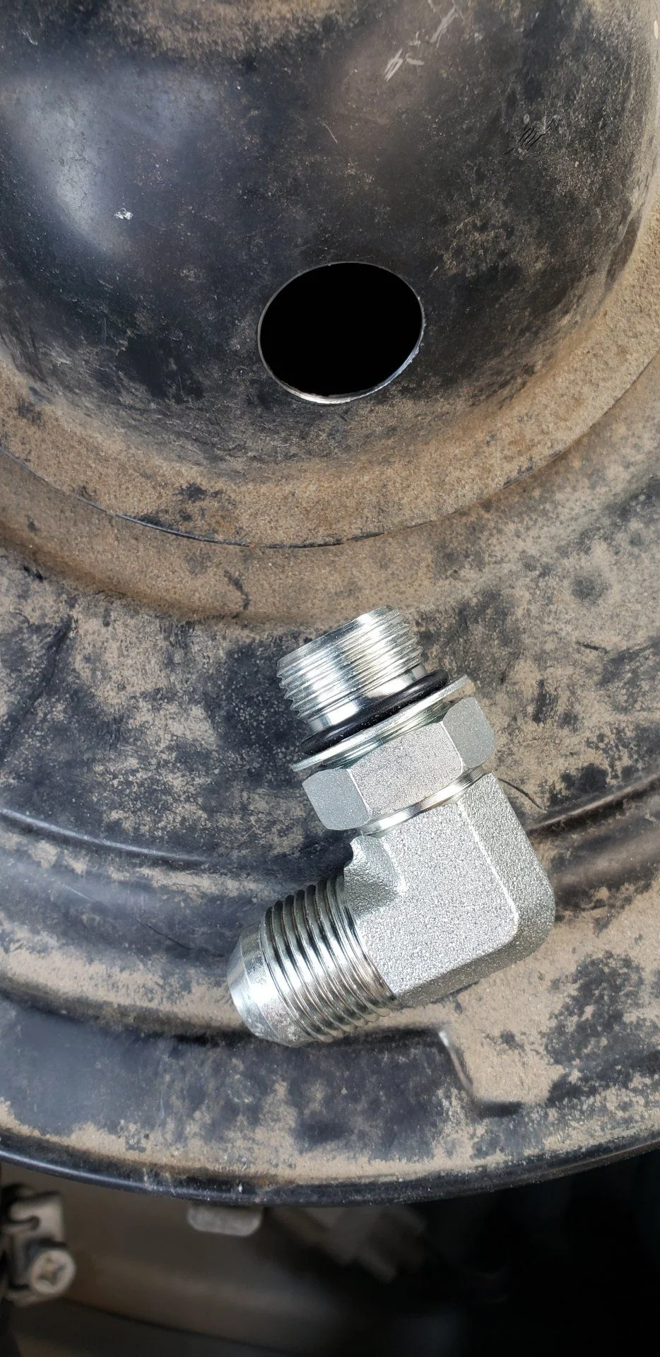

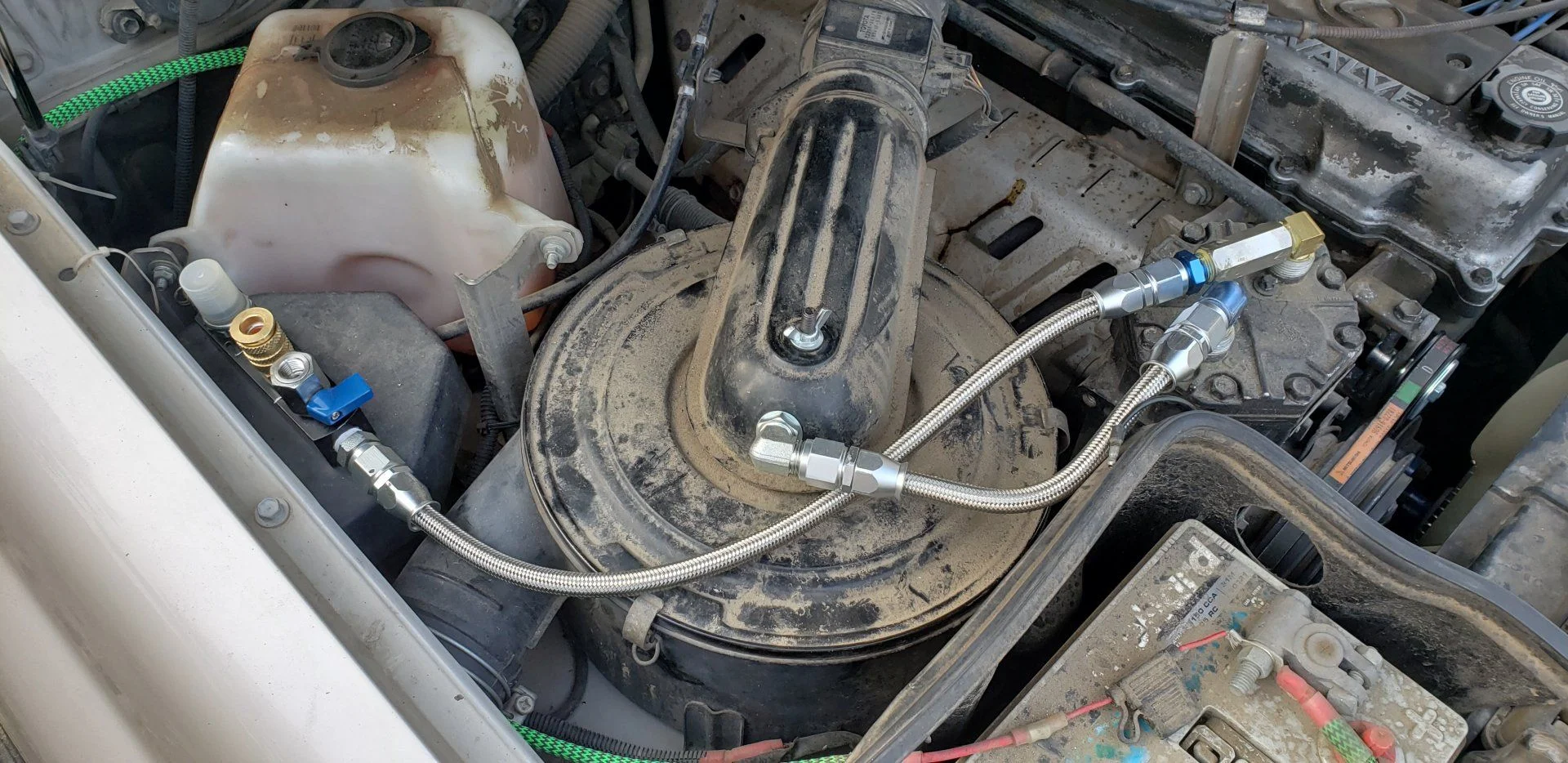

Finally [sort of] got my on board air to work. Finished the hoses which uses aeroquips PTFE hose. I bought an ORB to -8 for like $5 locally and found a locking nylon nut to go on the back inside the air cleaner. I already had the hose and fittings.
I had bought all the rest of the fittings like 4 or 5 years ago when I bought the bracket. But, I got the york for $21 at a local pull and pay!
It airs up a tire which is all I need it to do right now. I am going to super glue to the top of the cruise control actuator....I think. I still need to get it wired, but I can at least air down and have my wife help me air back up. I also tested the pop off, and it works.

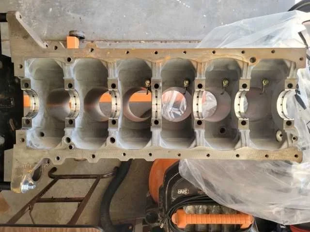

Got the engine back from the machine shop. This is my first time putting an engine together, so all advice is welcome. The machine shop told me, "you can't spend too much time cleaning."
Block was broken down, cleaned with freeze plugs removed, bored to the 1 over pistons, decked w/ timing cover. also, oil pump bushing taken care of.
cylinder head was cleaned, pressure tested, new valve seals, valve and seat grinds, new toyota cams, valve lash adjusted, decked

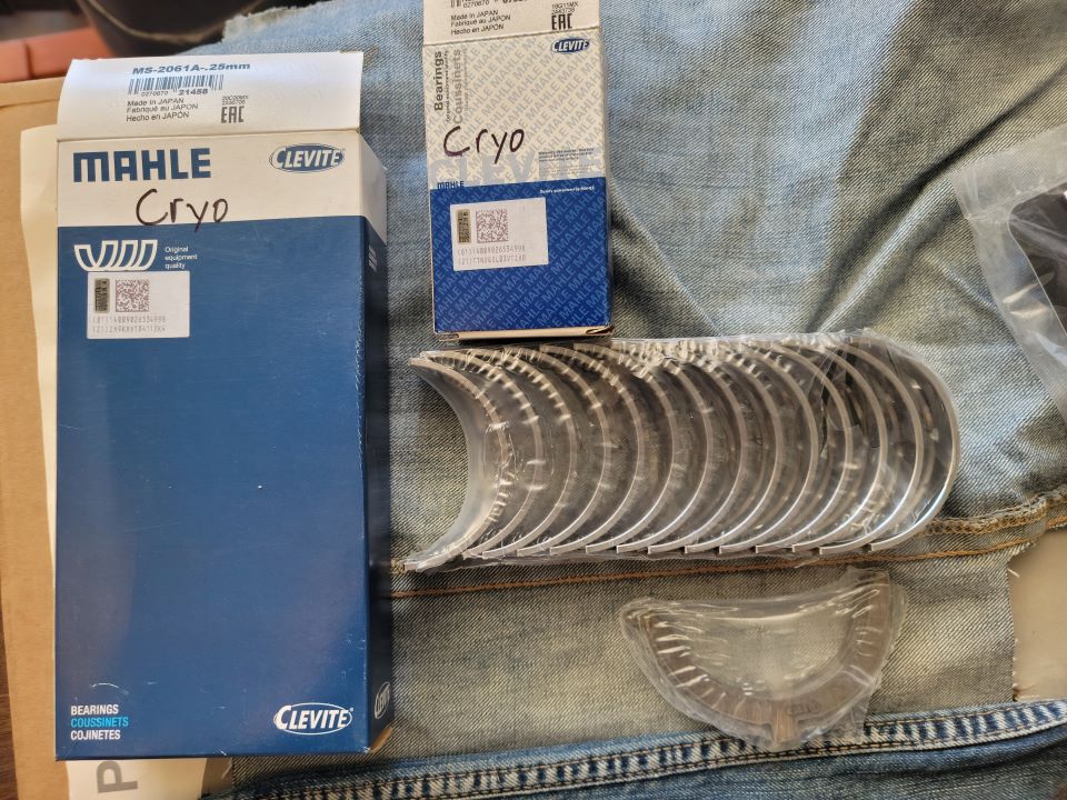

crankshaft was grinded down, I believe .25 u/s. Whatever it was, I had to buy mahle bearings. crank was balanced with pistons and rods, cryo'd piston/pins/rings/rods/bearings/crank

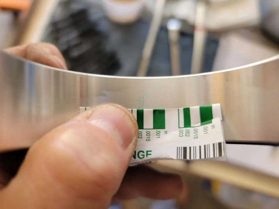

Setup crank, and plastigauged main bearings. came in within spec. cleaned crank and block again. checked thrust, within spec. installed crank per FSM.

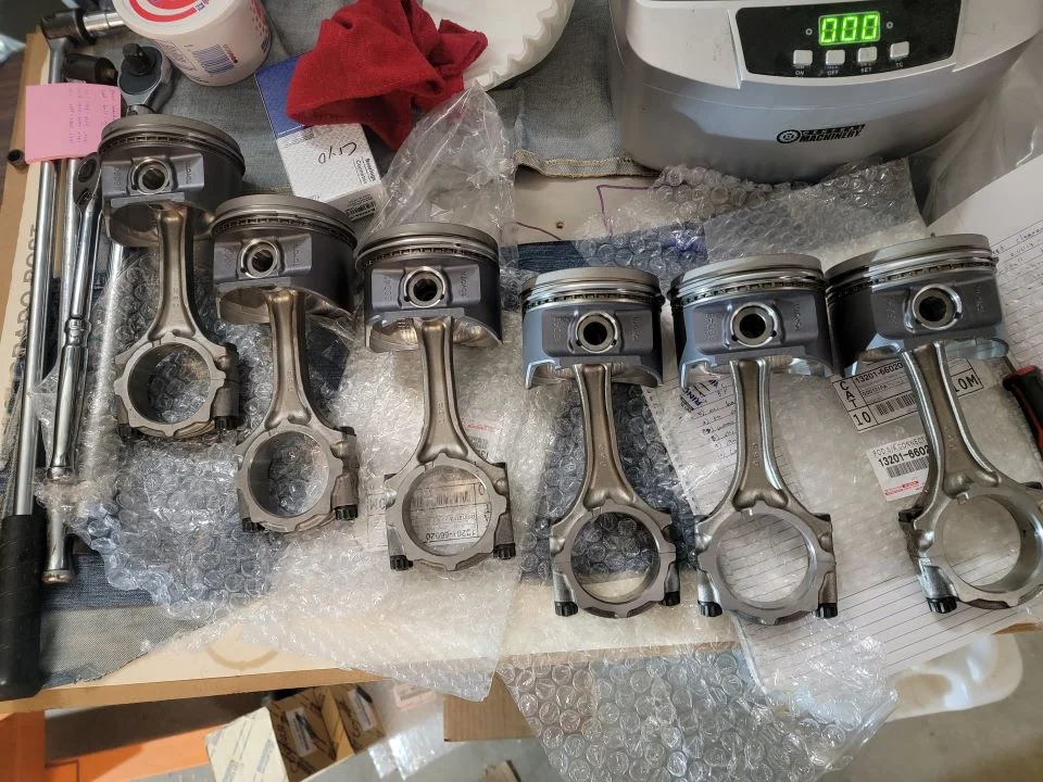

have to head out on a grave shift, but I couldn't sleep this morning. got the pistons installed. checked bearing clearances and thrust. everything checks out. all were in line except for the #6, which had the spun bearing and was the source of the knock. #6 connecting rod bearing is within range, but right on the cusp.

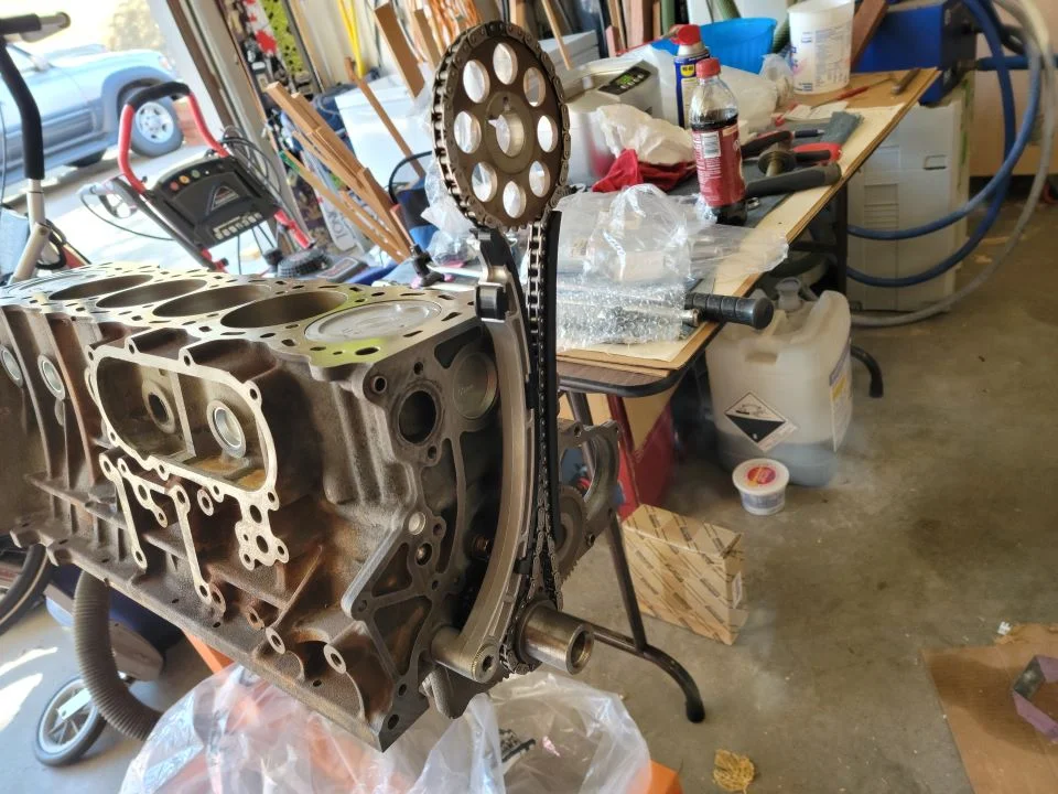

Not much progress this week. Got the oil pans scrubbed and the timing cover on. New chain stuff, harmonic balancer, bolt. I ordered a 300 ft/lb torque wrench, which cost me $16 shipped (thanks Tekton and your 10% back).
