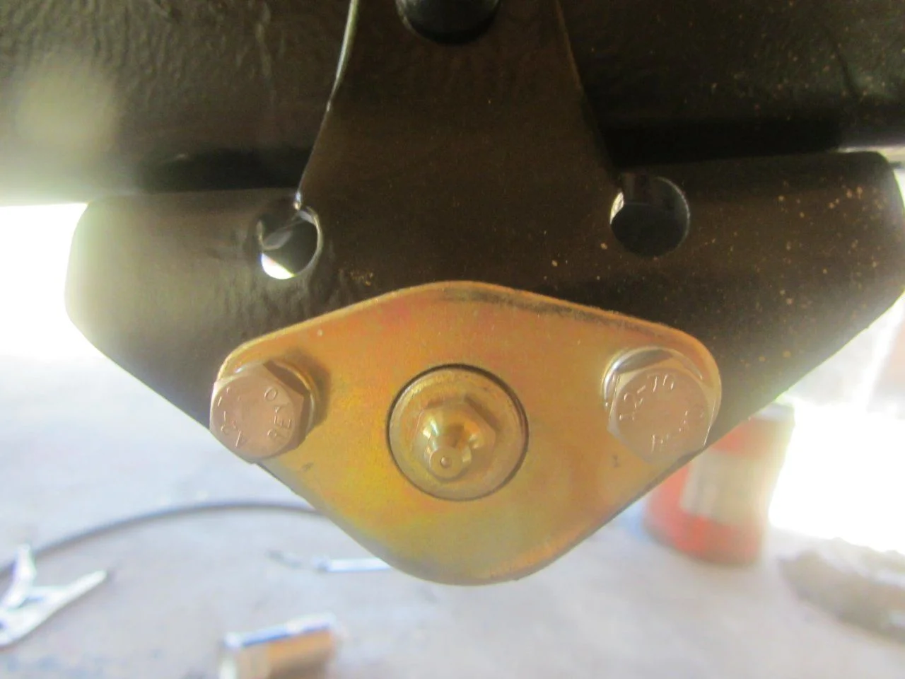

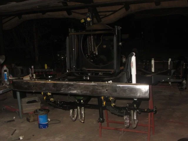

Having got that done, I started to re assemble. The very first thing to go back on the frame was the right hand side step support - 4 bolts. I started off by running a tap through the threads to clear all the paint.
TAP TAP
Then got out all the nice stainless steel bolts, gave each one a shot of copper compound and tightened them up.
Sloooowly but surely, one bolt at a time I went. Not all tightened down properly, but just there ready for the bits as needed when I really start to assemble in anger.
NOW, ISN'T THAT NICE-NICE? ALL CLEAN AND NEW.
Once they go in finally, I will put the torque wrench on each one and mark it with a dot of paint. That way, I reckon I'll know that each and every one is at the correct torque. If it ain't been marked, it ain't been torqued, should also be easy to check that nothing is shaking loose.
By sunset I had just about everything done on the frame that I can do at the moment.

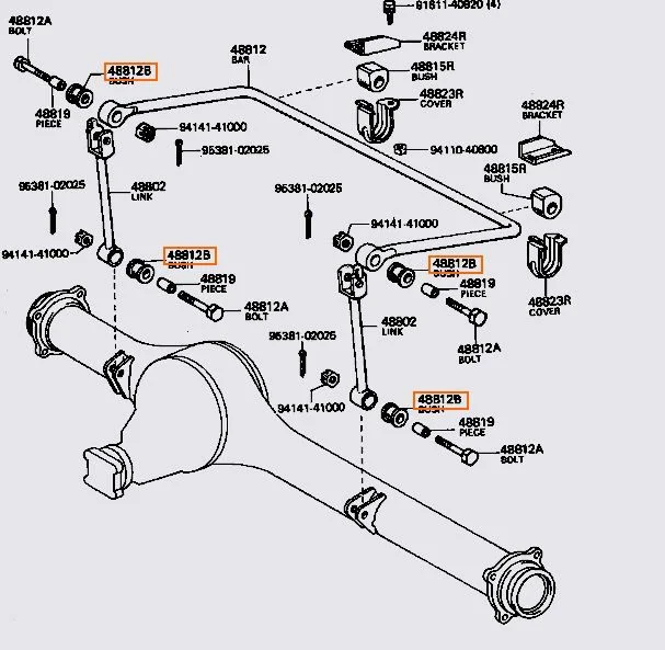

Today's challenge for me has been the rear anti-sway bar. Bought a nice kit with the 4 link bushes, pins, nuts and even split pins which fit perfectly and look good.
The problem arose when it came to the D shaped bushes where the bar connects to the frame. The part number on the diagram I have (see below) is 48815R.
DIAGRAMME (SOURCE UNKNOWN)
What I got in the kit does not fit, not even close.
The pic below is what I got together with my beautifully refurbished bolt-on covers (48823R) on the diagram.
THE CHALLENGE
My sway bar's diameter is 23mm and down to 21 to 21.5mm at the spot where the bush is located.
I've looked all over the internet but it seems that this is not a freely available part. Asking around town this afternoon I was told that the normal practice here is to take them off and throw them away when the rubbers wear out and it starts banging and clanking...
IMHO that may be okay for in the bush, but what if you have a ton on the back at hi-way speeds... well okay, with the H engine 80kph on a down hill?
What do you guys in OZ do? What do the Yankees do? What do the Kiwis do?

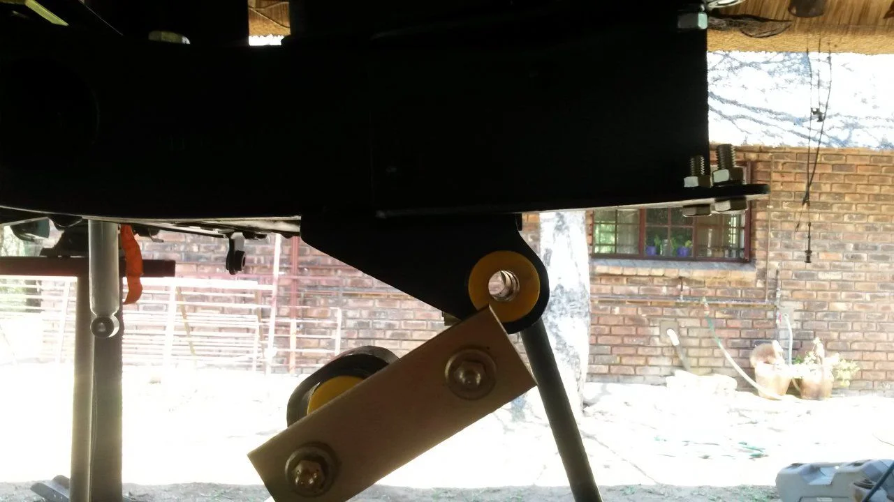

The sway bar is a handy thing my man. But will restrict articulation off road as you're probably aware. If the bush is too small then you're right - it's gonna flop around in there. If you can't find a new bush then you gotta make up the gap somehow.
Ended up taking them down to Cape Town with me and leaving them with Rubberman who will now use the covers and vulcanise some rubber in there to the correct spec. Then just cut a slit on the one edge to get them on. Should work.

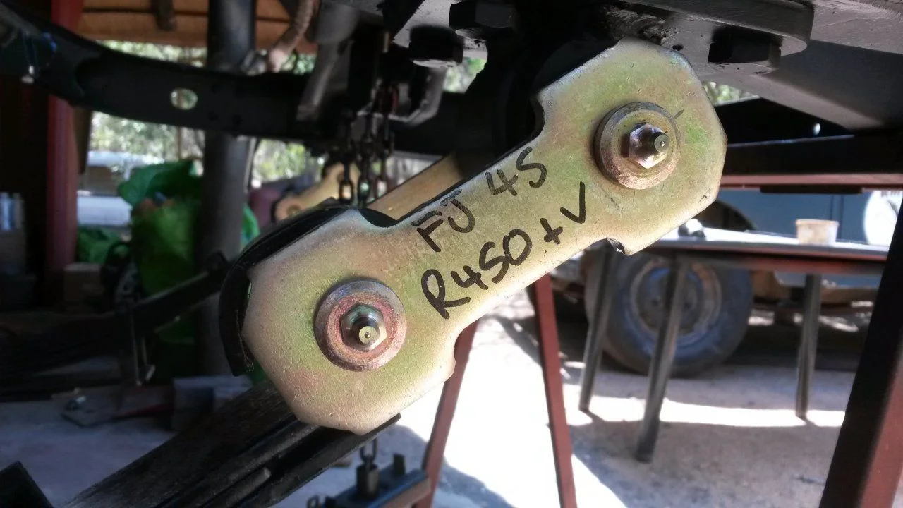

When it came to fitting the springs I got a bit of a surprise. The refurbed springs I got a few months ago were too "short".
FRONT AXLE
REAR AXLE
The springs were very bowed and fortunately I had to go to Nelspruit the day after (yesterday) so was able to drop them off to be flattened a bit. Put them back this morning. The shackles still have about 20 degrees slant but I'm fairly confident that will be cured once it is on its wheels.

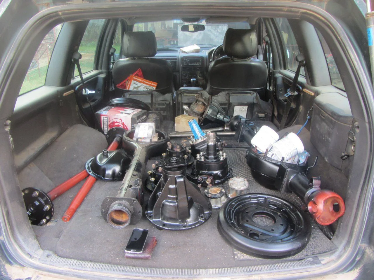

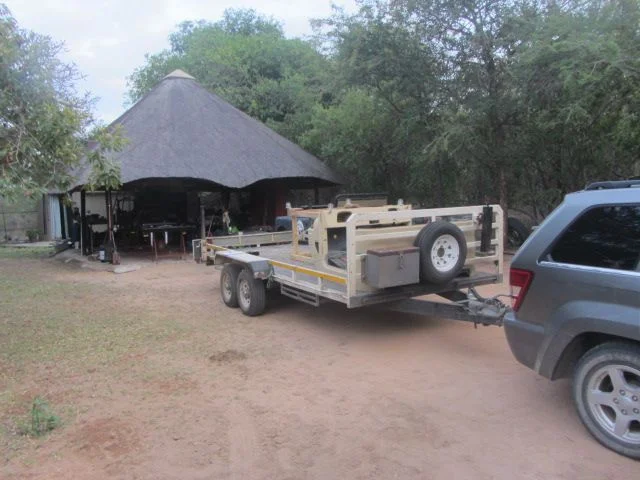

The real mission yesterday was to drop off all the body parts excepting the cab top and back panel and the load bed with Kobus at CK Customs for final finish and paint . He has just moved premises and is still busy reassembling his spray booth. There are several Alfa Romeos, a 1952 Citroen, a 1950 something Mercedes Limousine and a V12 E Type ahead of Dagha Boy, so no chance of getting it before I return from the States in mid June. Too bad, but I am assured of a good job. Probably better than I want.
HEY HO. AND OFF SHE GOES
Luhan the diff guy has promised the diffs back on Monday. I'm hoping for next week some time or maybe even the week after. There is no rush in Africa. Once I've got them I can finish off the brakes and get the chassis on wheels. Then put the engine back in and take the whole thing on an a bar to get the engine sorted out. That has to go before 8 April when I leave so it's ready for the body when I get back.
If all goes well and given a bit of luck, the Dagha Boy could be back on the road and saleable by end of July...
Well, I couldn't wait so tried today for the diffs... Not done yet. Damn! That's how my morning started, but then it unexpectedly got better.

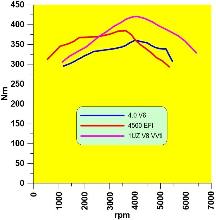

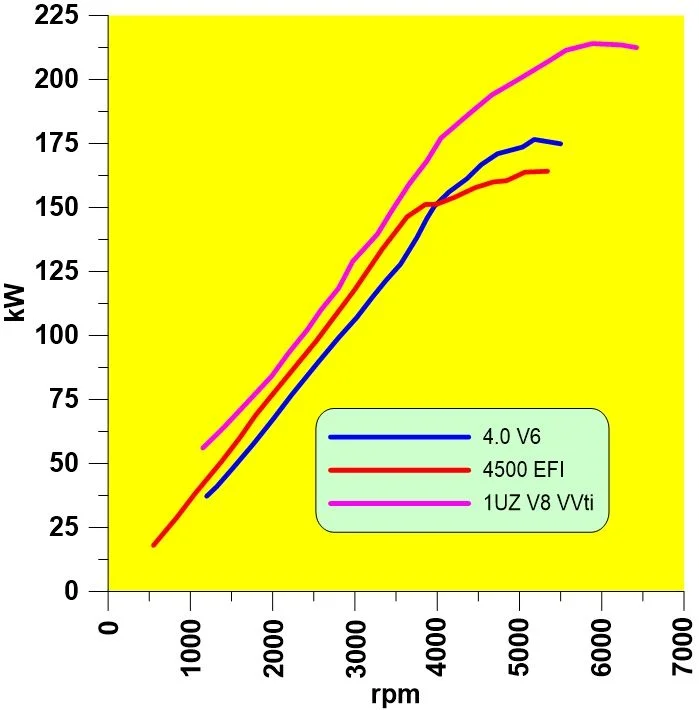

On top of it, I have been thinking of doing a Lexus conversion on the next one anyway, because the spares for the old F and H engines are getting so scarce and expensive.
The Lexus conversion is very popular here for Toyota Hi-Lux pick-ups. The engines come from Japan and are far cheaper than to overhaul existing.
I am a bit concerned about the high revs for optimum output. But in my ignorance I think it will be OK for mainly high way driving, and if it gets hairy off road there is always low range. Or am I missing something?
The 4500 EFI is the engine the new Cruisers are fitted with. I don't know which 4.0 V6 is used in the comparison, but it may be a GM motor.

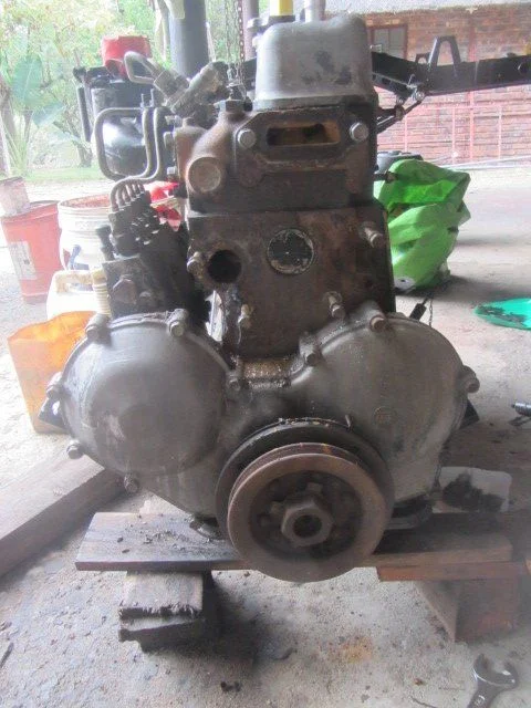

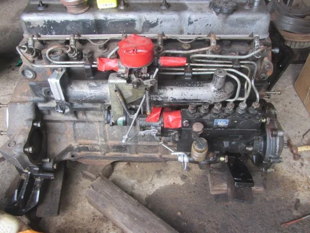

With the wait for the diff spares, I decided to start removing and refurbing all the bits and pieces on the engine.
The engine had been covered in oil and diesel and dust when I got it a year ago. Once I had removed the body I scraped off the worst of it and then hit it with some really powerful cleaner and a pressure gun. There was still some dirt left, but much of it inaccessible behind bolted on stuff. It has taken an entire day to remove and clean the water pump, the diesel filter and bracket, the inlet manifold and throttle body and various brackets, the oil filter housing and all the fuel lines and brackets.
All were dismantled as far as possible, wire brushed and degreased and sprayed with high temp silver paint. Most of the stuff was aluminium and had been sprayed over. It was just impossible to get it to a finish sufficiently nice to leave it bare, but the paint is pretty damn close to raw aluminium. Most of the pipes and brackets were originally yellow plated and I would have loved to replate them, but it is such a drama getting the stuff to Johannesburg and then to actually get it all back without critical pieces going missing. So I did them all in the same silver. Good enough. I replaced all the fasteners with stainless steel.
The left hand side of the engine is bare, as is the back and can now be properly degreased and painted black. On the right hand side I still have the injector pump covering about half the side. That will have to come off tomorrow - after I have read the manual to see what I have to watch for wrt timing marks etc.
LEFT HAND SIDE
RHD SIDE
FRONT
Once that is done, some high temp black onto the block and I can start reassembling again.

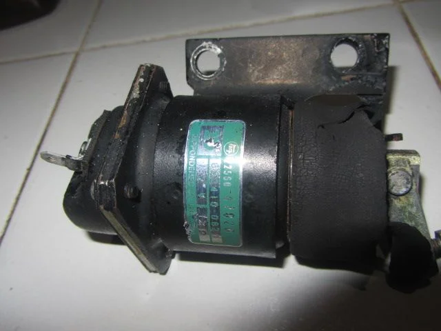

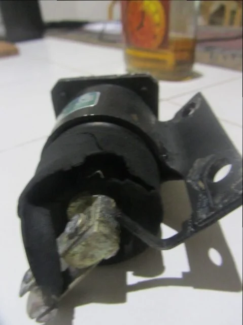

I found what I think is a solenoid stuck on the side of the engine between the starter and the injector pump. It has a wire running to the starter solenoid and is connected to the throttle (?) behind the pump. I think it holds the throttle open when the engine is being cranked.
THROTTLE SOLENOID?
One thing that is a bit worrying is that the rubber boot is dead. Judging by the very tight fit it is clearly meant to keep it very well sealed. It looks like the damage has been done on this one. When I connect the bracket to negative and put positive to the lug it sparks but nothing happens. Dead or just rusted up? I will try the dismantle route and if that fails try to get a new one.
This one you have to haul on a knob in the dash to kill the engine. no other way. I was also thinking that it may be a cold weather starting aid.
Just for interest's sake it has a nice high quality decal on it Nippondenso co ltd and teq logo with the following numbers: 22560-47020 and 053410-062 1 and 12V and 12P. The 12P and the 1 of the previous number are stamped into the decal.
I've looked on a few other HJs but none of them have it.
We're having a cold day here today, wind and just 24 degrees. Makes a nice change from the 40 plus we've been having for the past few months.
Thanks Diogenes, that solves the "mystery." I recall now that it takes its power from the starter solenoid via a short wire. That should have told me it operates when the engine is cranked.
I think I'll open it up and see if I can fix it, failing that I'll just put it back but not connect it. Ja, my experience with these engines is that they insist on a good glow before firing up.
