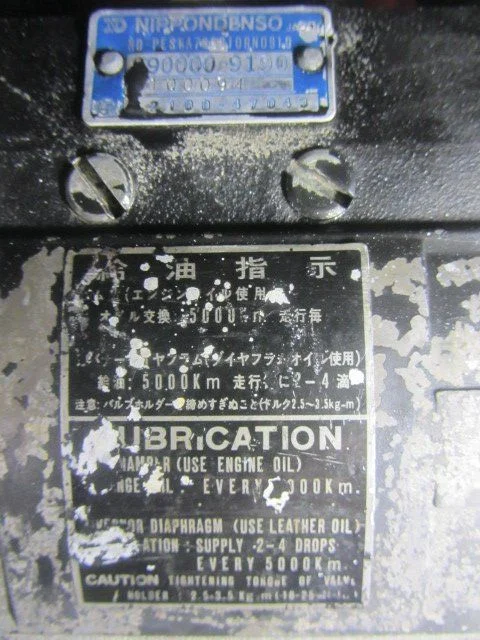

While cleaning it I found an old decal under the paint which is pealing off in patches.
INJECTOR PUMP DECAL
From that I gather that this thing must be almost like a little engine and apparently has a crankcase that needs its oil changed every "?000km" (I'm guessing 5000km from the Japanese part) I couldn't see any filler or drain plug. After some looking and fiddling I found a dipstick. Dipstick is dry... I always thought the diesel acted as lubricant.

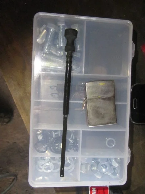

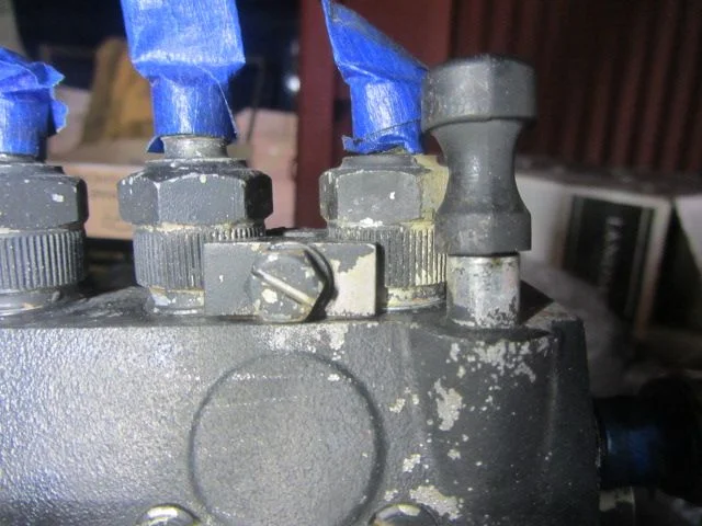

BLACK KNOB ON EXTREME RIGHT
DIPSTICK REMOVED

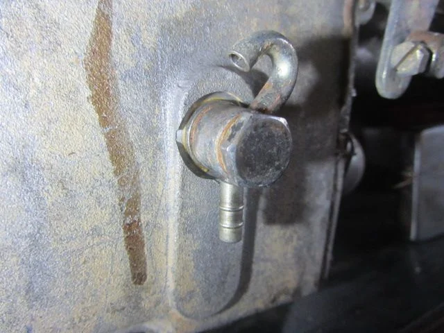

I still do not see a drain plug or filler plug, but came across a weird contraption at the back of the pump which may or may not have something to do with the lubrication system.
WEIRD CONTRAPTION
And then the bit about oiling the governor diaphragm every 5000km with "leather oil" What is that??? And "2 -4 drops." I've known a hell of a lot of these cruisers in my life, and they were lucky to see an oil change once in 2 or 3 years... "2-4 drops of leather oil" Not on your life!
I wish I could bet a replacement decal as I'll probably spray over it when I paint the pump.

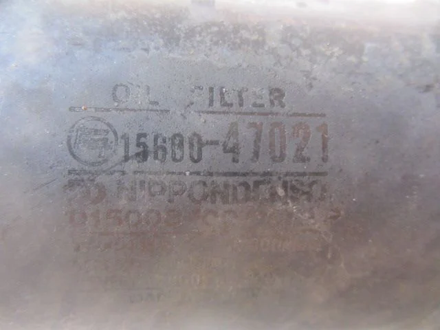

When I took the oil filter attachment off and cleaned that I found a service instruction decal on the canister too. Very faded and over-sprayed a bit but still legible if the light hits it at the right angle. I have not sprayed the canister becuse I'm trying to make up my mind whether to paint it or leave it to preserve the decal. Maybe I will try to cover both with masking tape and spray around them.
OIL FILTER CANISTER DECAL
Well, it's off to reading the FSM to learn about injector pumps.

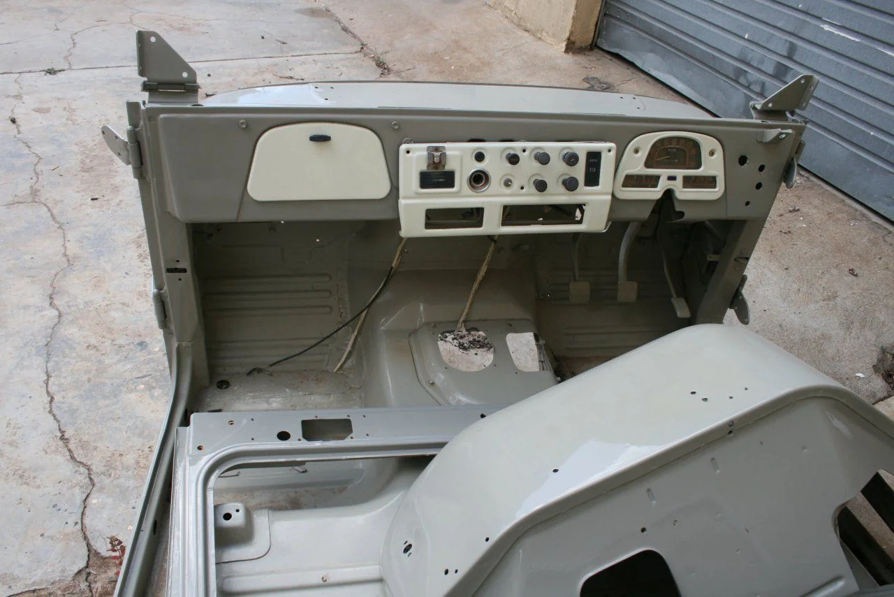

I had a bit of time to kill on Thursday so decided to go and take another look at the "barn find" now that the excitement has worn off a bit. A whole different story in the cold light of the morning I'm afraid to say.
At first glance the body work looks really good.

The panels were all sandblasted and then painted, but it is obvious that insufficient care was taken. The body panels have been outside in the weather for more than a year and in this spot you can see clearly that the paint has cracked and the water got in underneath. Not a big area, but the big question for me is how much more of this is there that hasn't become evident yet but will in a year or so...

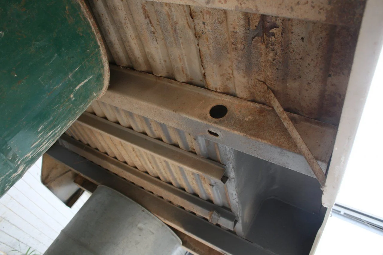

UNDERNEATH
CROSS BRACE WITH ORIGINAL MUD STILL IN PLACE.
No man!!! They did not bother to sand blast or even properly clean the underside. This is bad, bad prep. Shows me that whoever did it was either intent on taking short cuts or simply didn't care. The doubts grow.

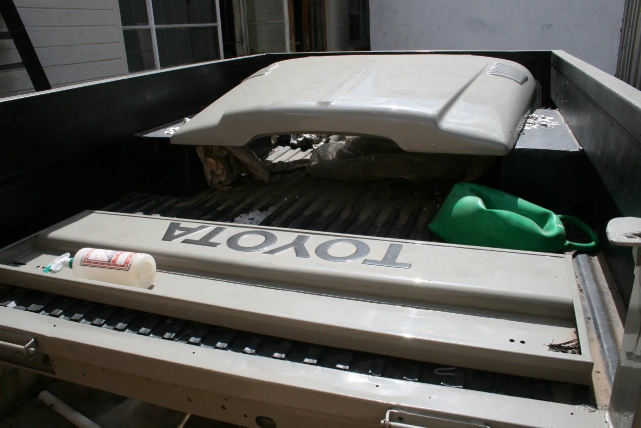

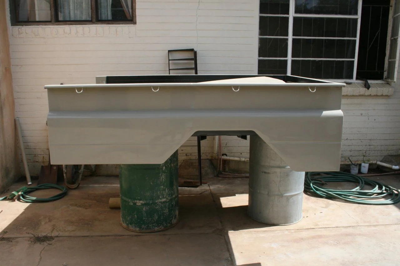

Now to the tub and doors...
THE TUB AND DOORS.
Looks reasonable at a distance. Only one fender though and that has not even had the dent taken out where the corner light was attached. The windshield hinges left in place. There IS rust under there. I know. It's OEM rust from Toyota taking short cuts and not painting before fitting the hinges.
The dash board trim?? Was that just put back like that temporarily or wasn't it even taken off properly? Who knows and to top it, it hs thick looks like hand brushed paint on it. Fuel filler left in and just sprayed over. How did they sand blast this thing with all that in place?
Left side floor/transmission hump. Two patches there. I'm no metal worker and until a few months ago had never worked on sheet metal. If my work had looked like that I would have taken it elsewhere to be done. You can't see it in the picture, but they did not even use a grinder to smooth it a bit. I can only assume they did not bother to clean the welds before painting.
MORE TUB
Pieces of the wiring harness and the pedals left in place and all heavily sprayed over. Where the dash was hacked the hole was not closed but simply left rough and bent. Rusting Mic holder bracket left in place on dash cover. Gauges rusted - you can even see it on the pic. One door retainer left and partially sprayed over - the other one is gone.

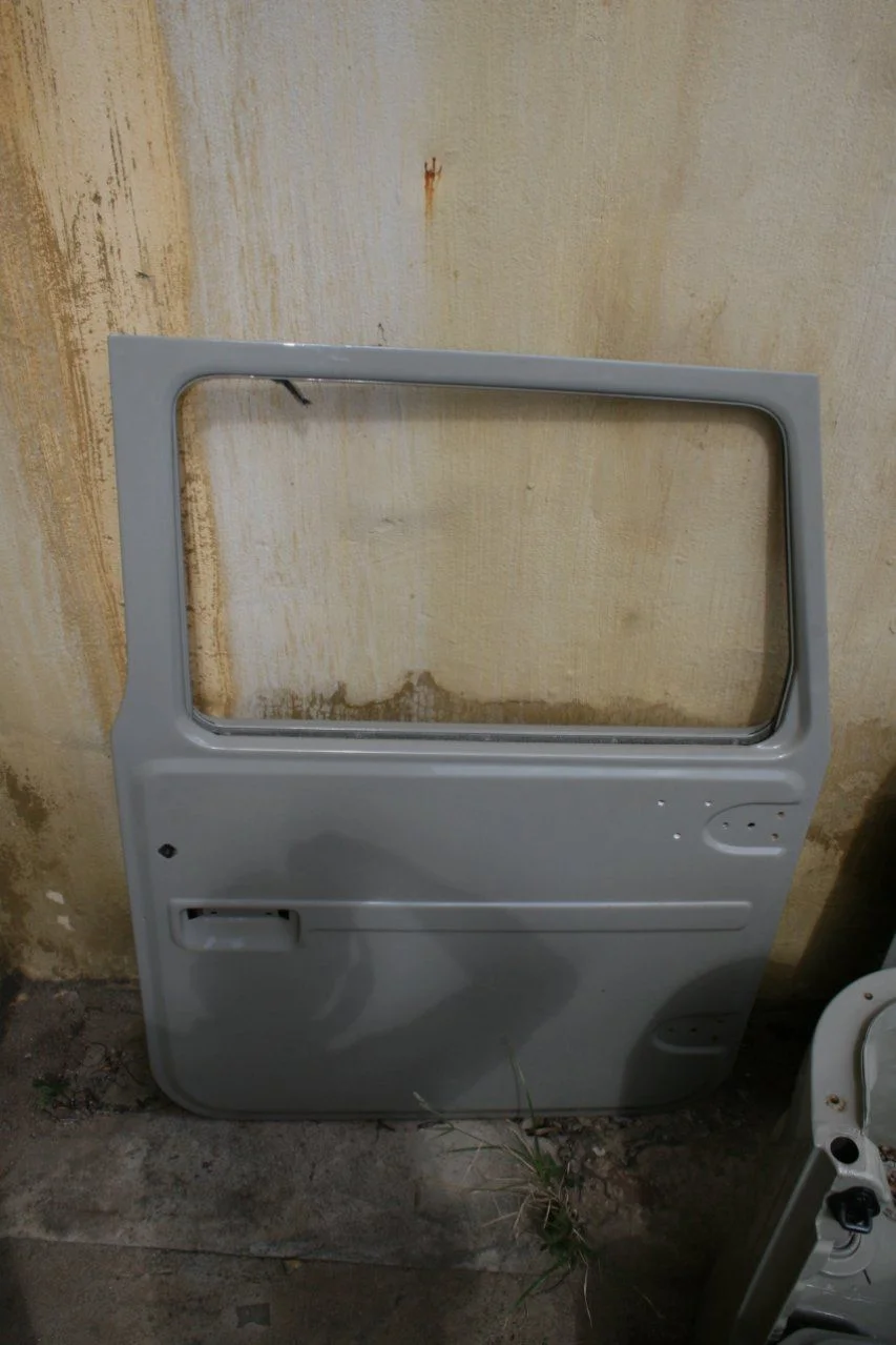

THE DOORS
The doors looked reasonable from the outside... but the insides are raw with surface rust, dirt, dust etc, large parts of which have been covered in overspray. I was getting weepy at this point so did not take pics of that. There is no indication that the doors were ever rusted through and repaired or are deeply rusted but they do need to be properly sand blasted sealed and painted. They may have been sandblasted on the outside, but certainly not on the inside...
The underside of the tub has been left muddy and rust speckled just like the load bed.
Not "just for assembling" as I had originally thought in my initial excitement.
My estimation is that the body parts are good and solid. But will have to be properly disassembled and sand blast all over. Bad workmanship will have to be cut out, and a total proper undercoat up applied. New fender and everything for the doors. I could not find a roof and sides and no glass. No parts for the doors either. Everything is needed new...

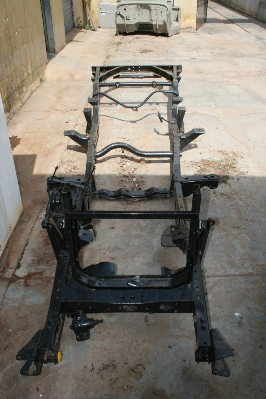

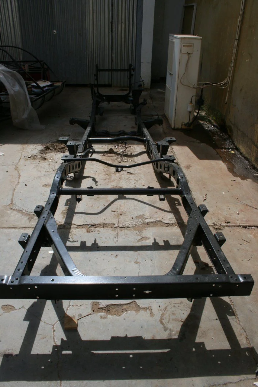

CHASSIS FRAME. (REAR)
The frame is a thing of great beauty. Heavily powder coated. Really nice, but for an ugly tow bar (?) bracket welded to the back of the frame. You can't see it clearly on the photo, but you can see its shadow. That will have to be cut off which will screw up the powder coating. How stupid can you be? Radiator support frame was also left in place -WHY???? I could not find the radiator and fan shroud...
CHASSIS FRAME (FRONT)
Centre arm hanging by one bolt. Powder coated all over... Left had side bumper bracket needs repair - more powder coat damage...
Bottom line, lots missing and a hell of a lot of work to get that frame to what it should be...

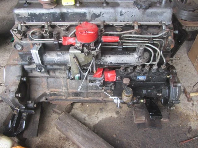

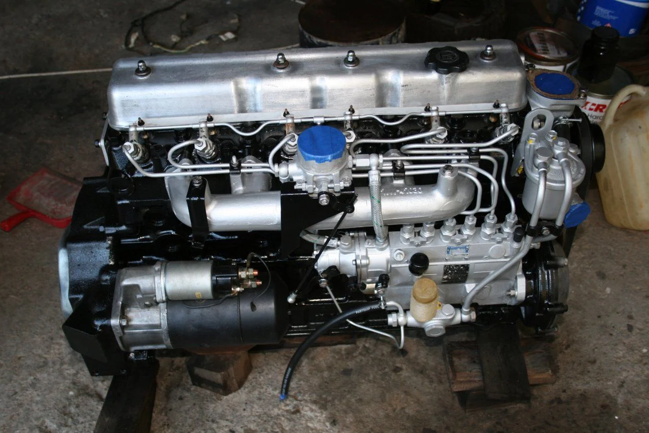

All the engine parts have been cleaned, painted and put back loosely. It needs a new oil pump and new rings, so I'll strip all the outside stuff off again before that is done.
ENGINE BEFORE
ENGINE AFTER

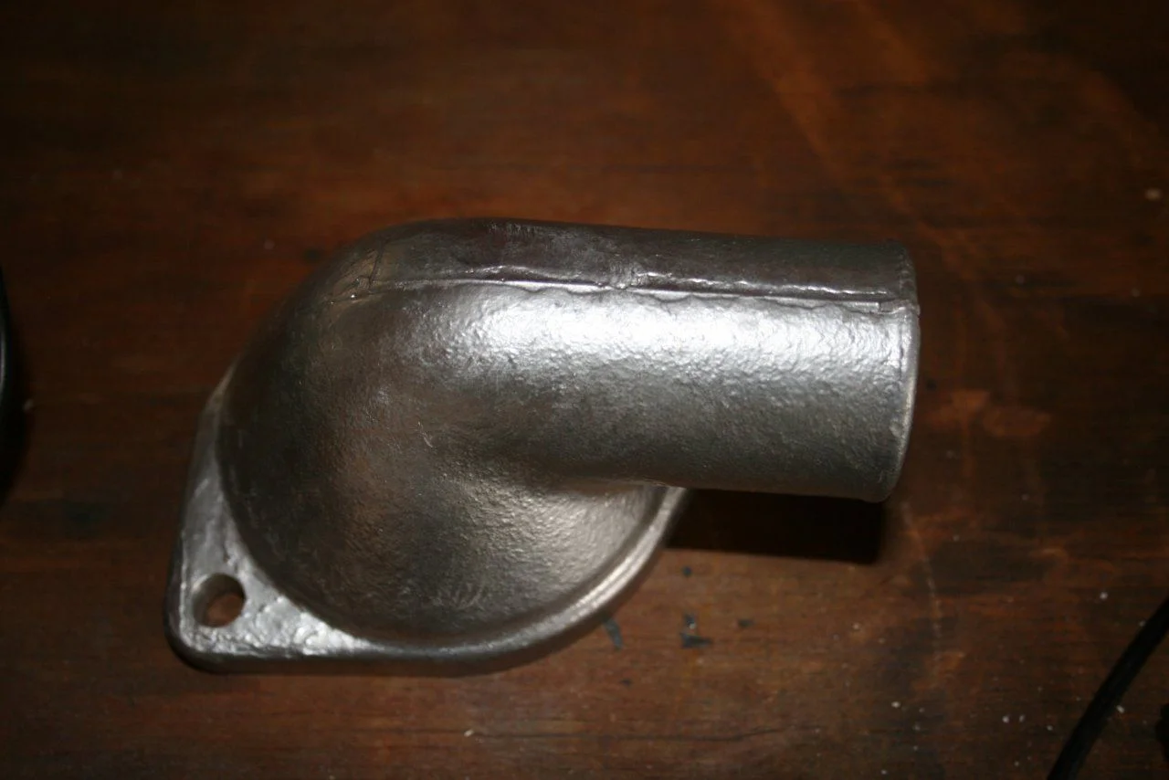

New top for thermostat housing. This was also surprisingly reasonably priced @ R300 about USD $19. I was expecting a not-so-nice aftermarket part, but surprise, surprise it appears to be a genuine Toyota part. When I pulled the supplier's label off, there was what appears to be a Toyota OEM parts sticker on it. A genuine Toyota part for less than $20! I didn't know such a thing existed.

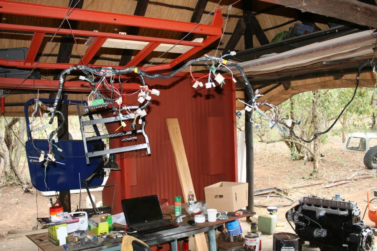

After reading Dave's post #251 above on Sunday, I decided to pull the wiring harness out of the box it had been sitting in since the middle of last year. My first impression had been that it was toast and would have to be completely redone. I took Dave's advice and started with the first project - clean it up so I can see what is what.
OUT OF THE BOX ONTO THE FLOOR. (TATTY BUT NOT TOO BAD)
Took lots of close up pictures of each branch and then I stripped of all the relays etc (I do not have a clue what any of them do)
Yesterday morning I gave it a good bath in some nice powerful cleaning stuff, rinsed it off well and then hung it out to dry. Wow, what a difference. The I got distracted having to take the MWFD to the airport, and to pick up the new parts at a local bushpub where it was to be dropped off. One thing led to another beer and I eventually got home merrily after dark. No thought given to the now very dry wiring harness hanging outside. The 22mm of rain overnight wet it down nicely again. I've hung it up in the carport and it drips gently on my back while I'm on the computer. Small price to pay for rain.
GENTLY DRIPPING
The harness is not too bad. Amazing what a good clean-up can do. Little bit of hacking over the years is present and at least the charge wire from the alternator shows signs (melted plastic) of burning. Plan is to take all the relays, regulator etc to be tested and identified, take the tattered binding off, visually inspect all the wiring and test for continuity and resistance, identify what needs replacing and get that from Coolerman next month. Shouldn't take too long to replace what needs to be replaced, rewrap it all and put it back in when I get back in June.

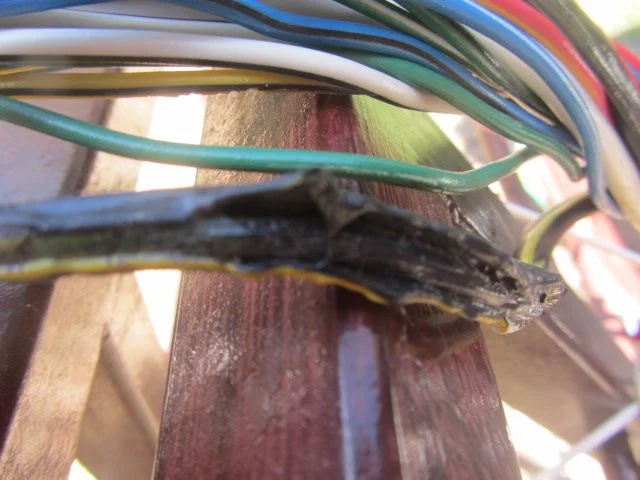

This ole wiring harness has turned out to be very nice still. Properly cleaned and dried I inspected it and found that only two of the heavy gauge wires connected to the Glow Plug relay had been melted. Not burned, but just melted. Although they had stuck to some of the other wires in the loom I was able to pull those free gently without causing any damage.
MELTED
COULD THIS BE THE CAUSE?

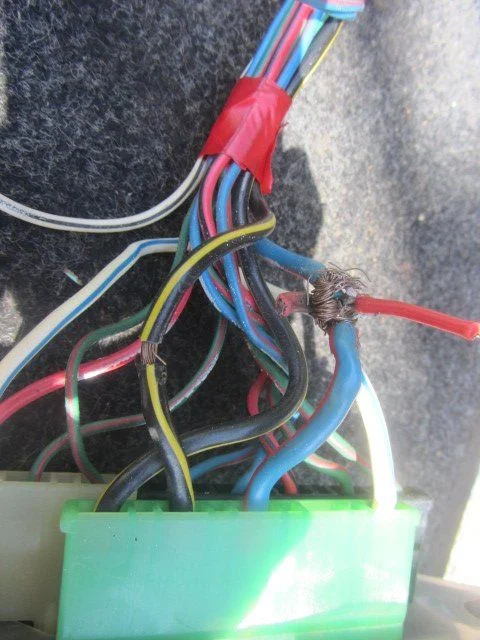

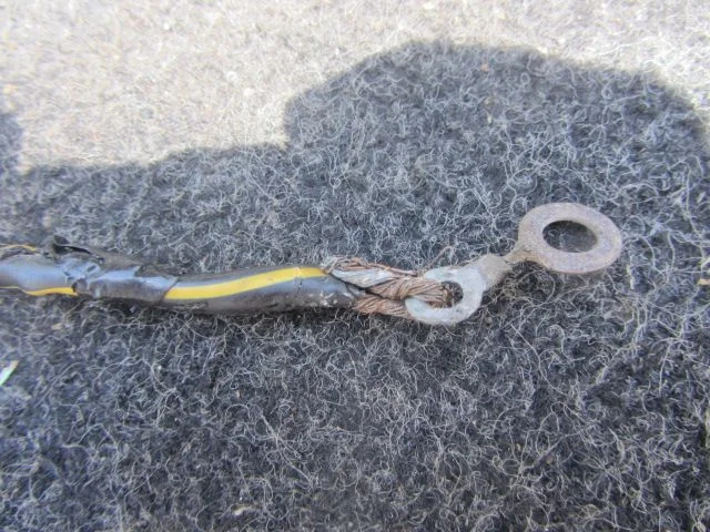

I tried to get replacement wire here but can't get the correct colours so will order from Coolerman. This harness is really soooo good, I must put the right stuff back.
The only other hassle with the harness is that I need to replace a few of the connectors, especially the bullet types to the front indicators/ fuel sender and the temp and oil pressure senders. The bullet types seem to be mud traps and rust. I have yet to inspect all connectors very carefully for corrosion/ loose wires but so far it looks really good.
Any advice on how to extract the "clips" from the plug body?

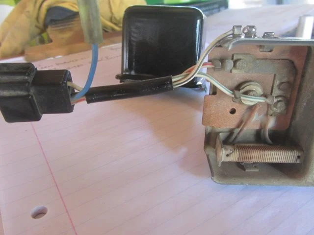

The only other problem is where somebody tapped into wires right at the fuse box. Not too bad. I'll get some of the correct wire from Coolerman, cut them further back to within the wrapped part so I have clean wire going from the wrap to the plug.

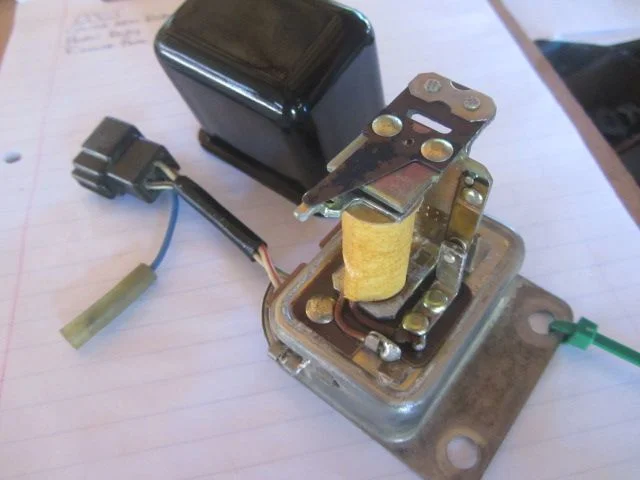

I'm not too clued up on auto elec, especially when it comes to all the little black boxes. I have however been able to identify all except one.
WHAT IS THIS?
I will take them all to my guy in town to test next week.
