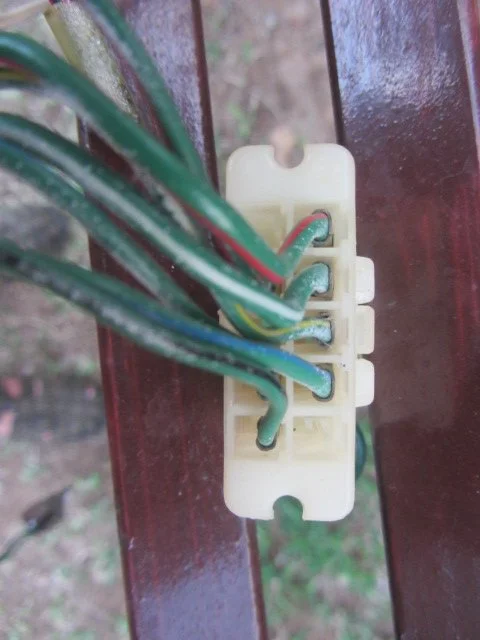

The only plug I can find on my harness that looks as if it will take that looks like this...

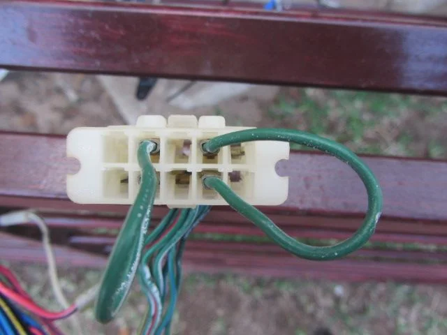

This weird contraption is situated right next to the wiper switch in the harness. I am wondering whether this is perhaps the wiring for the hazard switch that has just been bridged out like this by the factory. Predominantly green wires on both. It all looks very factory but at the same time very pointless bridged out as it is.

That contraption really puzzled me until I saw a pic of the switch.
