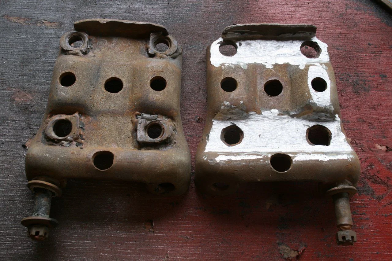

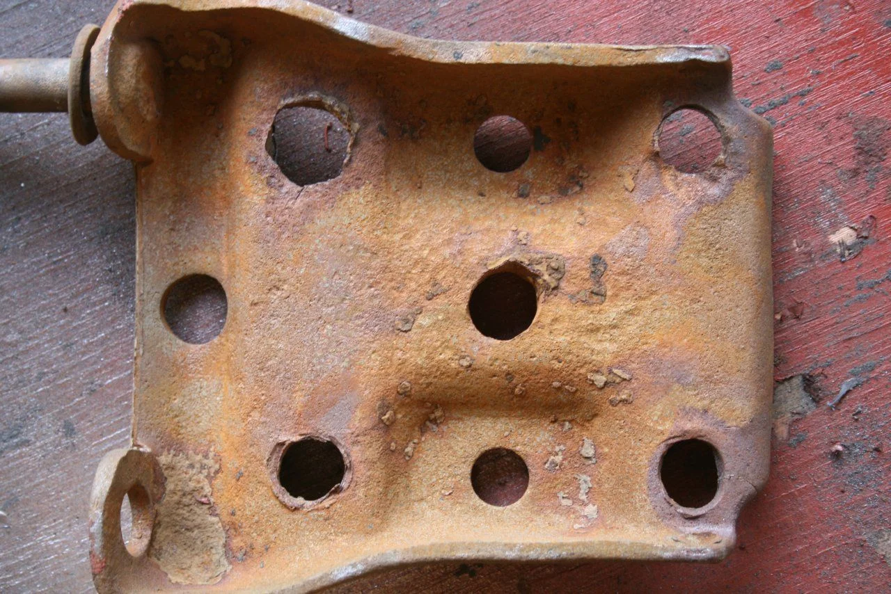

I spent quite a lot of time cleaning up the wheel cylinders in the hope of being able to refurbish them. Looks like I wasted my time. For starters, the rear brakes had 3 front brake cylinders - well, two in semi working condition and one carcass, but the latter's pieces were amongst the stuff that came out of the brace at the back of the cab together with shot gun shells, spent .22 cartridges, 30.06 shells, old glow plugs, assorted bolts, a set of tractor keys etc. Time wasted. You live and learn.

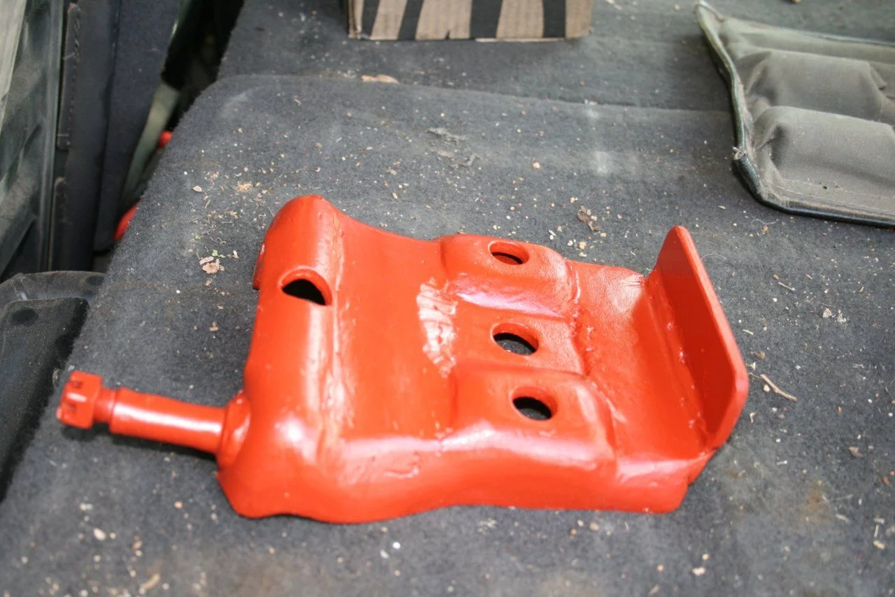

I've been trying to source new/2nd hand spring seat but have been unsuccessful, so decided to repair the old ones. The u-bolt holes and the centre bolt holes were horribly worn from loose and incorrect sized u-bolts.
SOMEWHAT WORN.
PO REPAIR EFFORT #1.
PO REPAIR EFFORT #2 (Note the piece of tin used to decrease the diameter. Same guy who "fixed" the spring hangers...?)
I removed all evidence of the old repairs.
ONE READY FOR REPAIR.
And then welded on some 20 x 6mm flat bar, welded on new protection plates and welded up the holes. I don't have drill press here so will get Koekies to do them for me tomorrow. The centre bolts on the "new" springs are bigger than the old ones, so the worn centre bolt holes didn't need closing up, they in fact have to be drilled out a bit.
READY FOR DRILLING.
I struggled a bit to do the welding with the Chinaman MIG. No matter how I set it, I just could not get any penetration and nice smooth flat welds. Eventually I gave up and used the old stick welder. That did the trick.

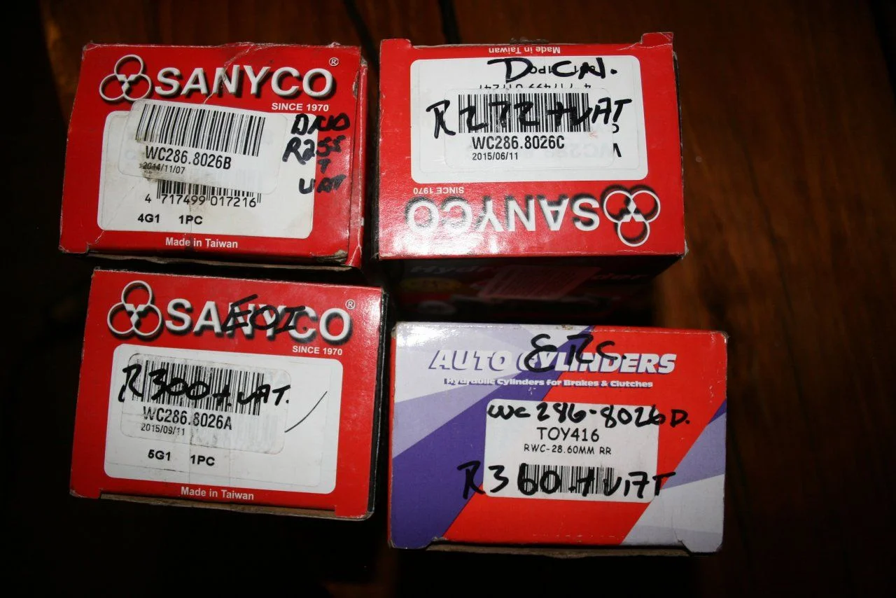

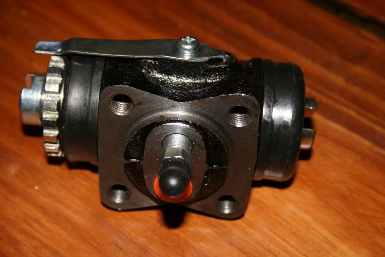

I felt Steve's quote on some of the stuff was a bit high, especially the brake parts, so I visited a specialist brake and clutch shop.
Nice surprise. They could supply most of it off the shelf at a very reasonable price. The front kit (4 cylinders) came to R 1162.80 or $81.31. Similar aftermarket kit from CCOT website is priced at $ 144.72.
NICE AND SHINEY NEW
We had to negotiate a price as the boxes were all marked with different prices, apparently having come from different orders at different times over the past year. The cheapest was marked R255 (Nov 2014) and the most expensive R360.(either Oct or Nov 2015) How do these guys manage to stay in business?
PRICE VARIATIONS
More than 40% increase over a year is a stark illustration of what happens when a country's economy is mismanaged. Our currency is becoming worthless and we as individuals are getting poorer and poorer by international measures. It sucks! Help! USAID... (We like southern fried chicken)

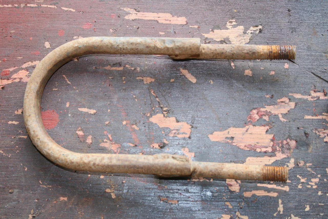

Also got new shackles, new U-bolts, a new spindle, bearings, seals, gaskets, bolts etc to assemble my axles and then finally to get them back under the frame.

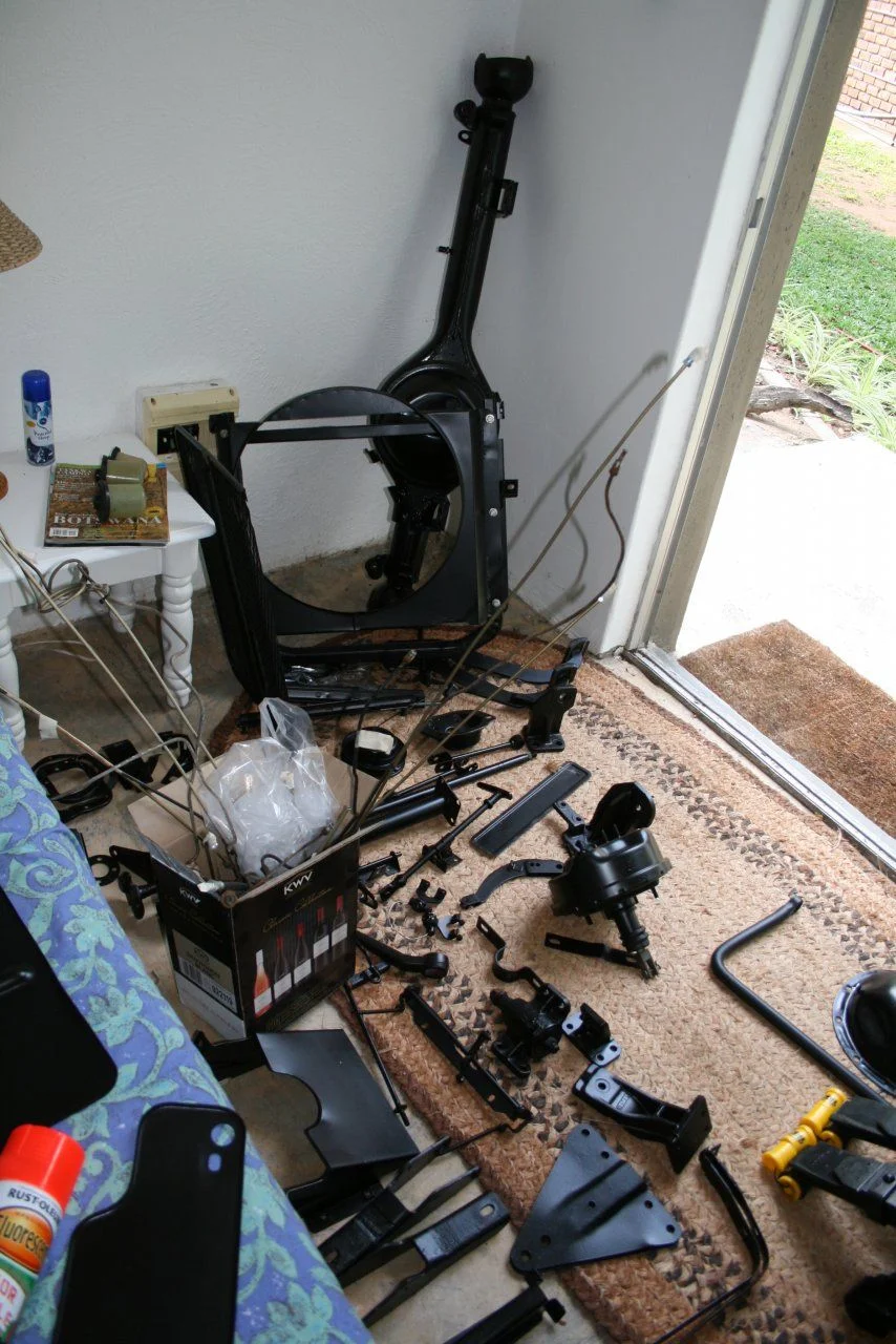

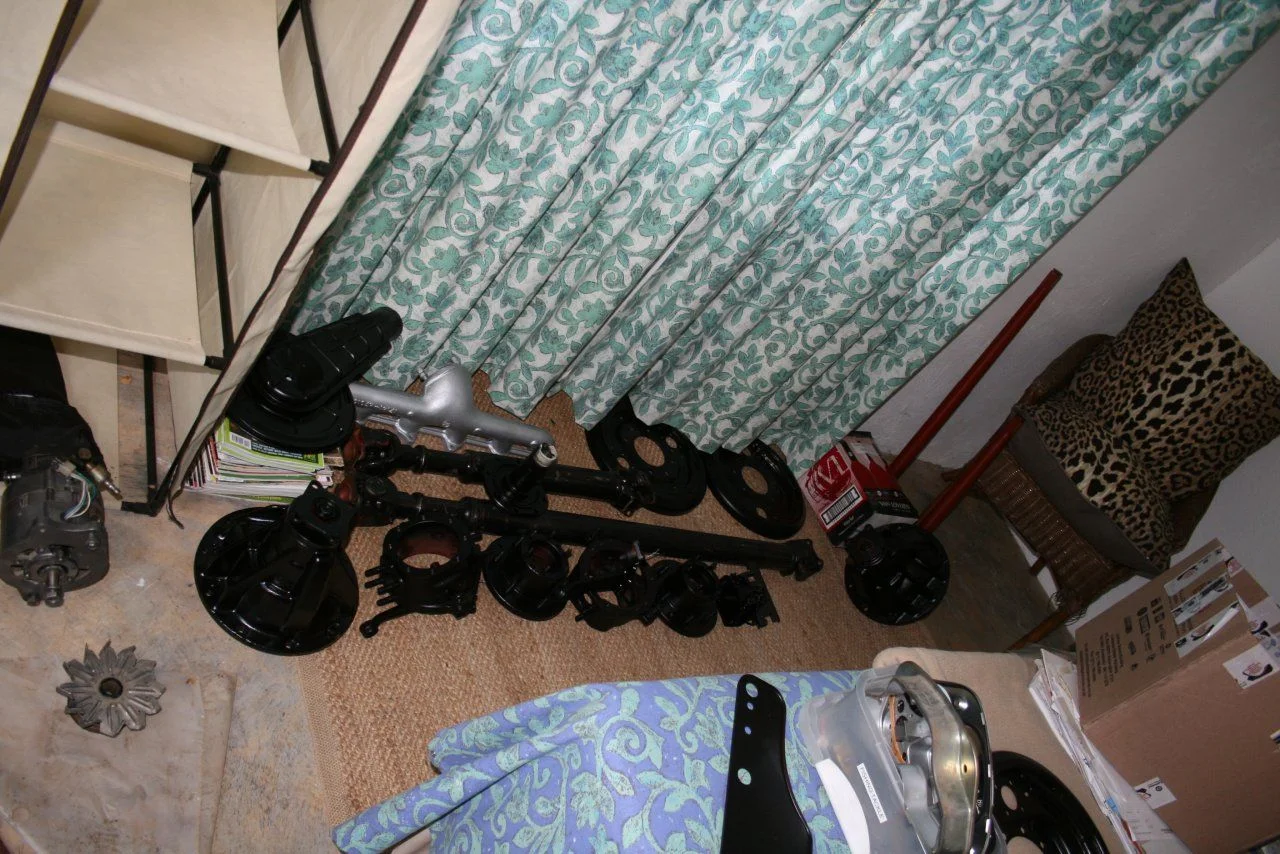

I've commandeered the "bachelors quarters" (and old store room converted into a sleeping spot for kids) as parts storage. Slowly but surely filling up with parts ready for assembly. A bit redneck I suppose, but it works well. At least I haven't got the engine on the dining room table...yet.
PARTS STORAGE. 1
PARTS STORAGE 2.
Ja, I know exactly where everything is. That is, until I need it. I have two nice big steel stationary cupboards that I have modified and use for all the ziplocks with the little parts. Only problem with that is that they have been colonized by Foam Nest Frogs and now I have to leave the doors open for them to get in and out. So much for keeping the dust out, but I can live with them as they keep the mozzies and other bugs under control. This time of the year they are all over. One has moved into the body tub but I can't find him, as they are very well camouflaged, can change colour like a chameleon and sit dead still during the day.

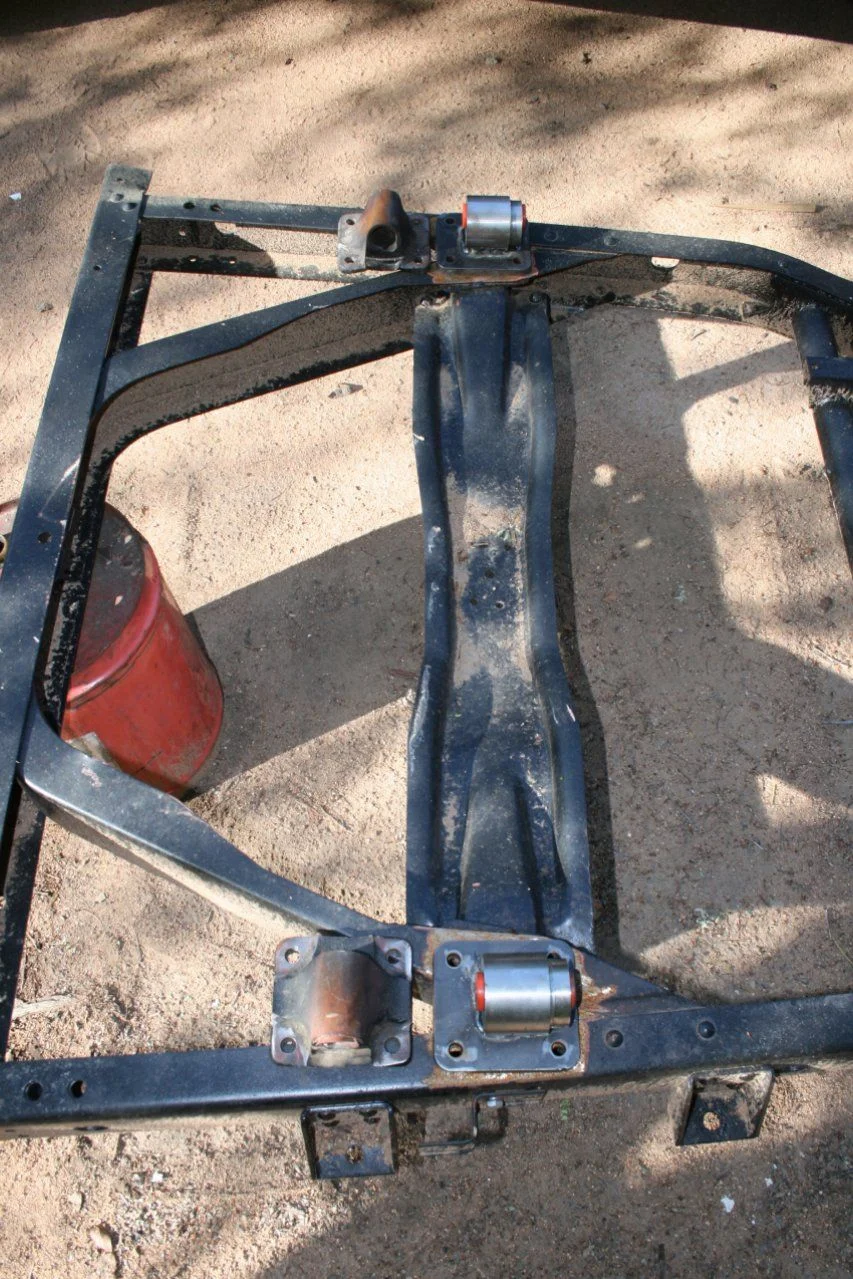

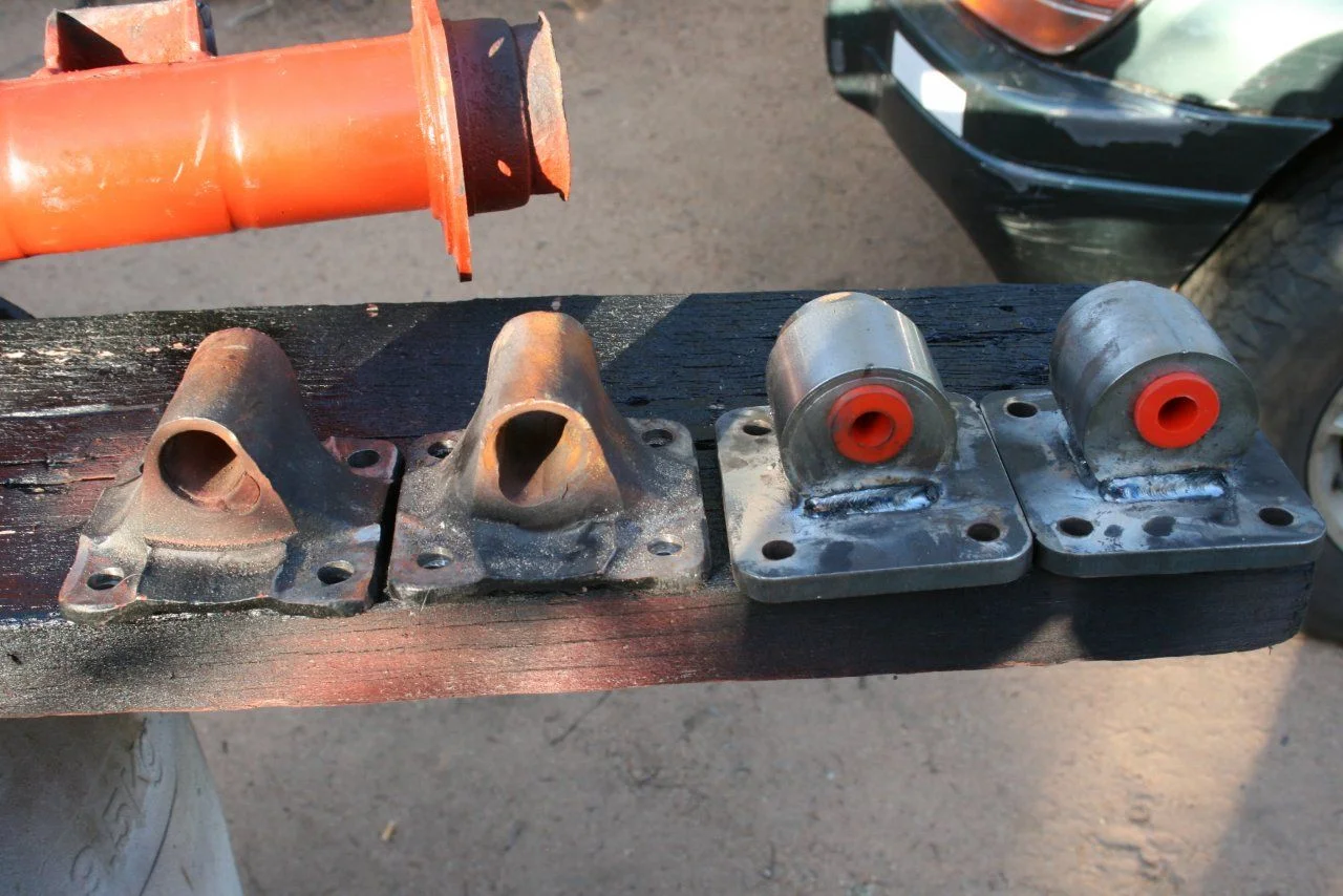

Got some parts back from Koekie yesterday.

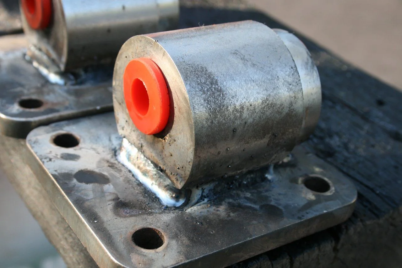

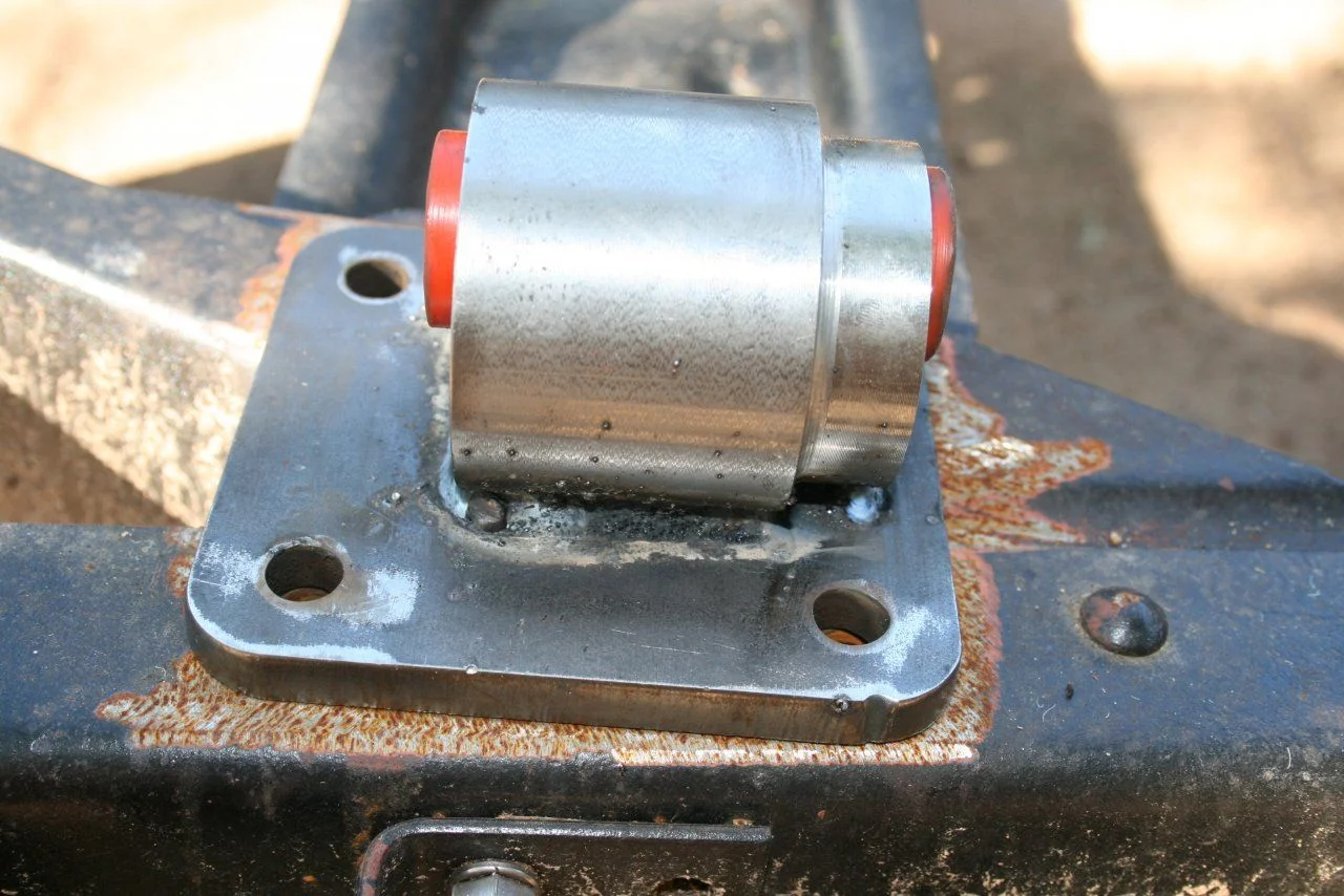

When I thought Mr Toyota's version of rear spring hangers for the 45s was overkill, I hadn't yet seen Koekies' interpretation. Judge for yourself...
THE OLD AND THE NEW
BREAK THAT, SUCKER.
