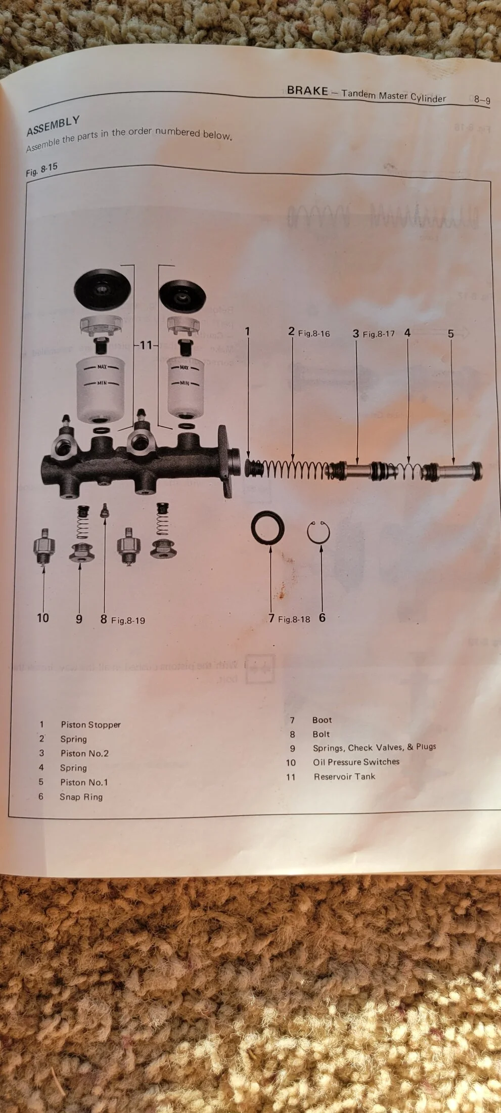

As @45Dougal said, it's drum master with frt discs. There should be a residual valve in both circuits, frt and rear for drums. The frt one should be removed with discs. #9.
If you still have rear drums, leave the valve in the circuit for the rear.
Typically you use an adjustable proportioning valve for the rear circuit if rear disc brakes are adapted.
So undo #9 and remove the spring and check valve?
What @Pighead said, Yes. It should be the frt reservoir, to be sure, follow the line and be sure it goes to the frt brakes. You should only have to bleed the front brake calipers when done. I'm not sure this will stop all the dragging or not. Take it for a test drive and then check to see if the hubs and rear brakes are not hot. Slightly Warm is ok, but not hot, unless youve been riding the brakes. As I mentioned earlier, if they're hot, jack up each hot hub/tire and check if they are dragging. I still suspect the adjustment rod maybe putting pressure on the newer master cylinder.

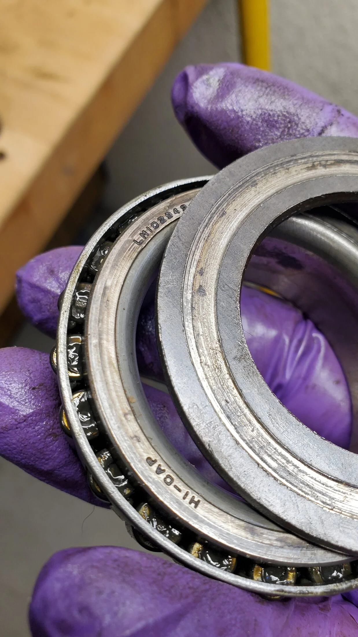

I'm interested in the wheel bearings at the moment.
I'd pull one and see if they have spun on the spindle. 2 beer job tops.

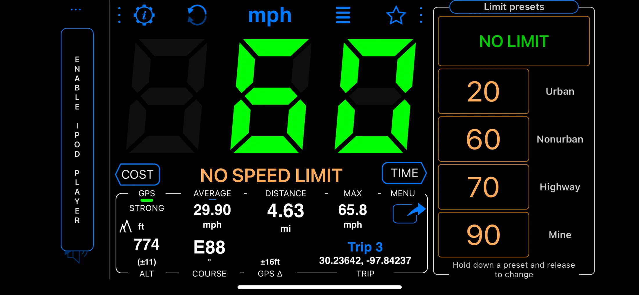

I pulled the valve from the front circuit and then blead the brakes and took it for a test drive.
Top speed was 65 MPH. Feels more nimble and certainly runs better in 3rd. In 3rd I can cruise at 40-45 at about 25-2800 RPM. In 4th I can hit 2800 RPM and cruise around 60, 65 if I am going down hill.
Hubs are still hot to the touch, but I don't think they are as hot as before.
I'll have a look at re-adjusting the push rod. I did take my time during installation and measure the depth of the push rod. May have cut it a bit too close.

Last time I was in my front axle I found signs of my wheel bearings spinning on the spindle. Most likely due to improper preload.

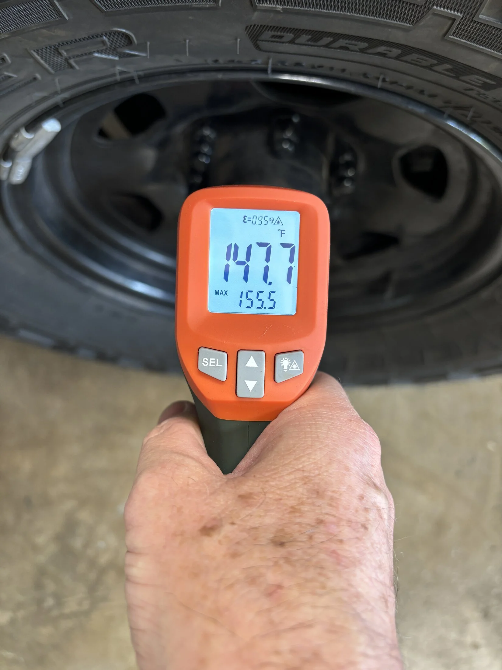

Now point it through the hole in your wheel at the disk. Is the disk the source of heat or not?
Did you measure temps on both front wheels? Rears? I'm just trying to figure out if it's 1 wheel or maybe more, so we can isolate thr problem. I think 147* is way too much.
