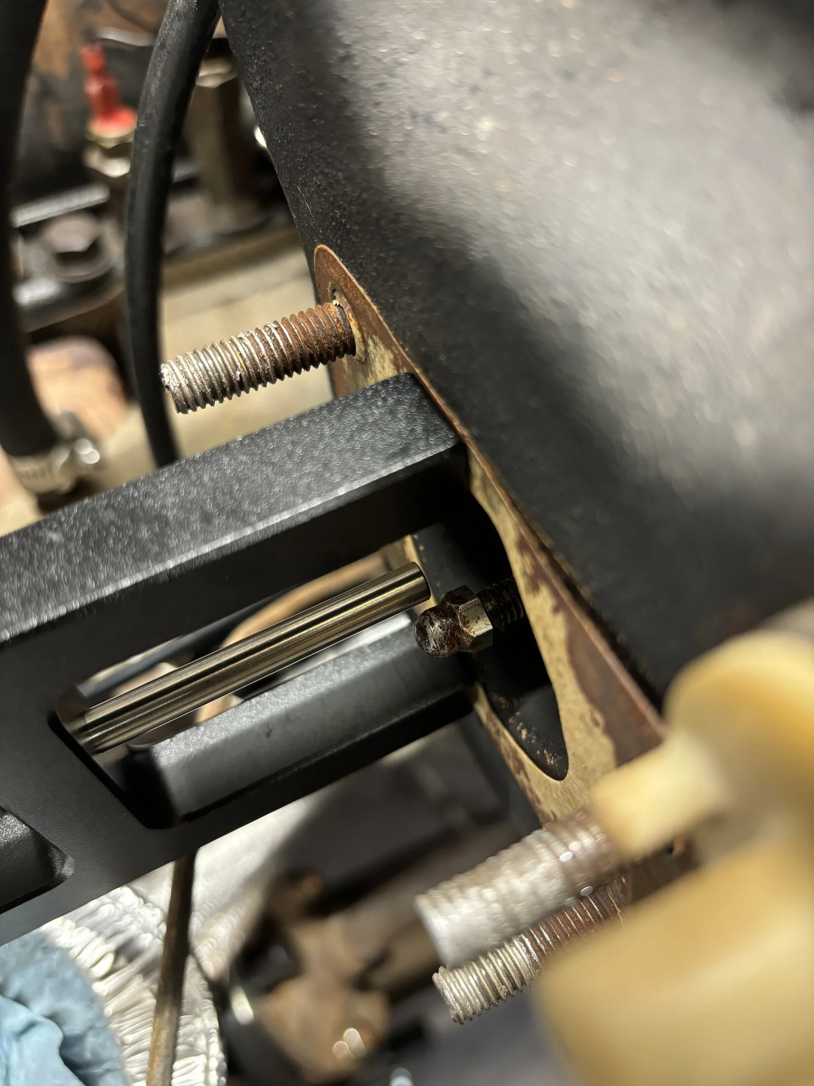

I think that the Amazon delivery algorithm looks at a tool you need and decides "10 pm delivery will be fine...". Anyway, it finally arrived, and I readjusted the booster. To say that it was out of adjustment is an understatement.
I adjusted the nut down to the rod height minus 0.6mm. Reinstalled the master cylinder and bled the system. Took a test drive and stopped to get more brake fluid. Checked the hubs and they were cool. ~90 degrees, same as the rears.
I got it up on the highway and hit 65 MPH at 2800 RPM. 🎉🥳👯‍♂️
I think we figured out the issue.
