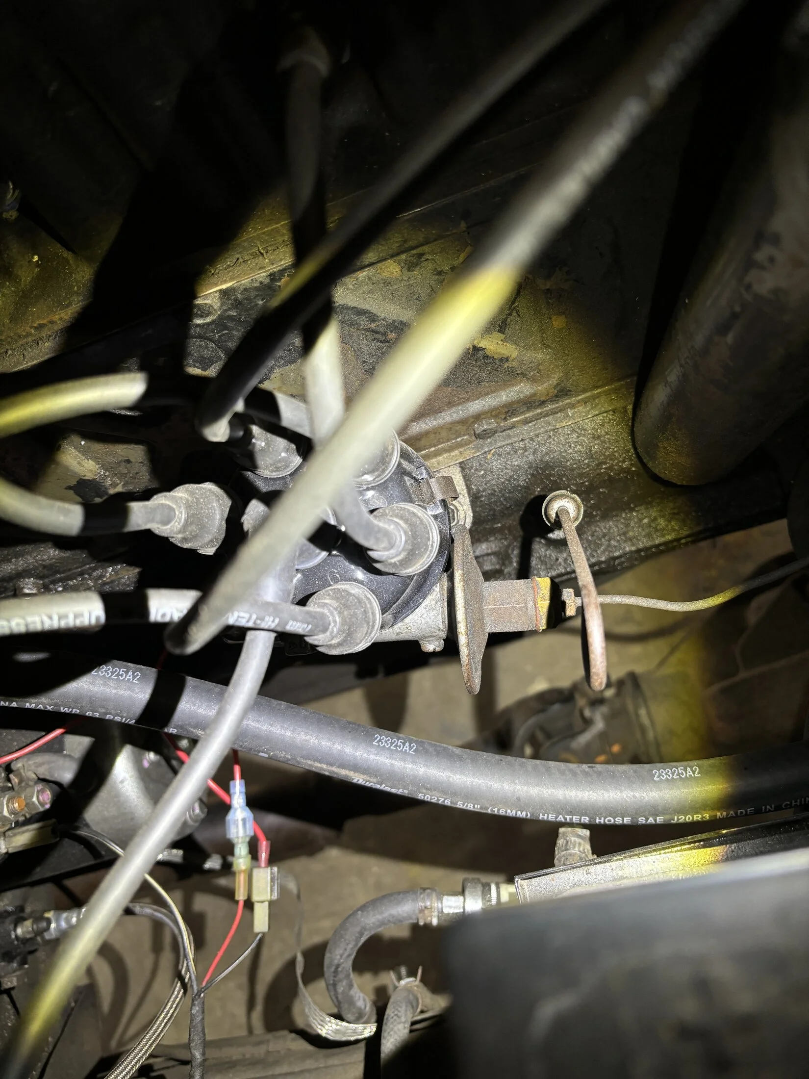

Vacuum advance on the distributor appears to work fine. At idle if I pull additional vacuum, it advances the timing noticeably. I pulled the plugs and they look amazing.

The vacuum advance on my distributor.

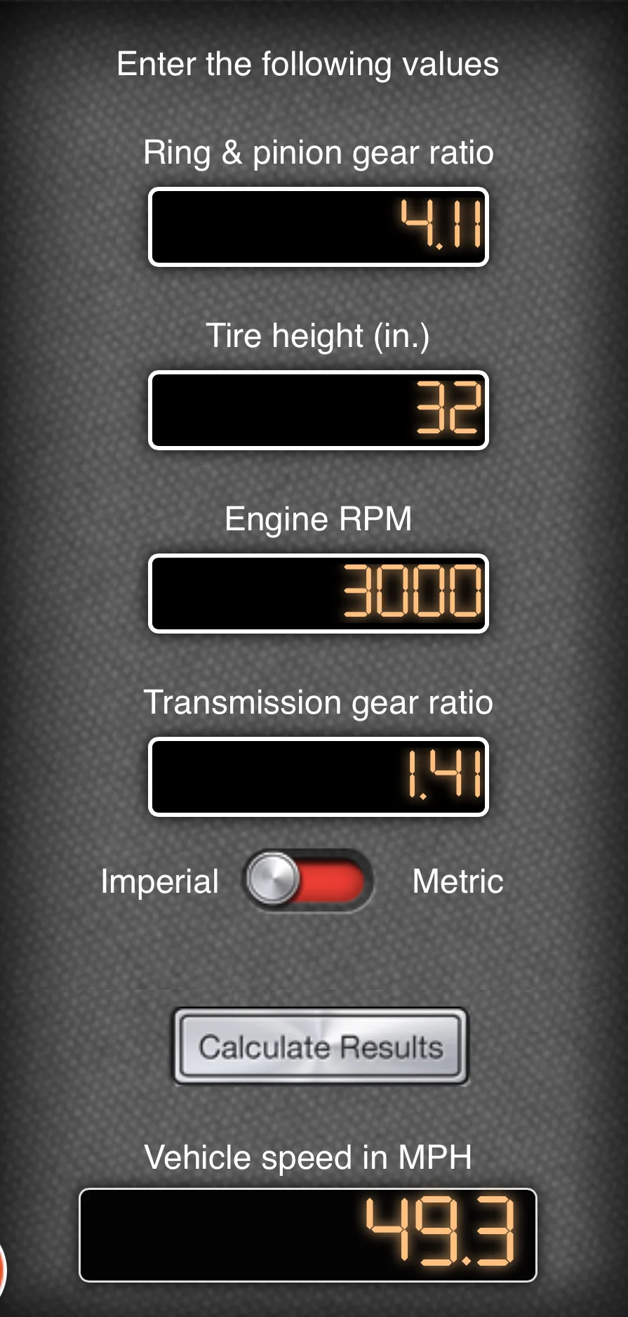

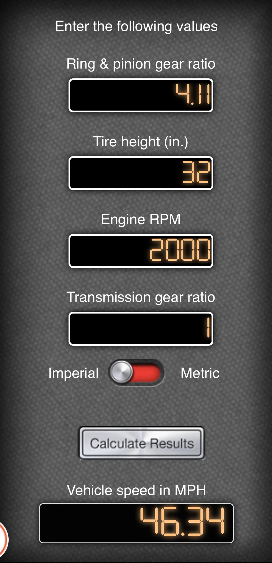

Looking at what @pb4ugo wrote: "If you enter these numbers into a calculator you will find your RPM's are going to be closer to 2600 using 4.11 diff gears, 32" tires, and going 60 mph" it appears that folks with 4.11 can get past 55 mph.
If your top is around 45, then you’re somewhere around 2000 rpm in 4th at that speed.
If you were shifting at 3000 rpm from 3rd to 4th, you’d be going almost 50 mph. Are you shifting at too low of an rpm?

These are the same numbers I came up with. Thanks for the confirmation.
My ear says I am shifting at the right time. Once I have the tach in (probably Saturday) I'll find out if my ear is calibrated correctly.
