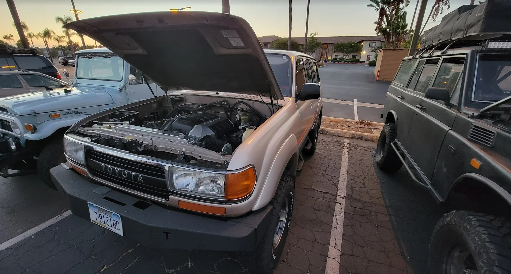

what bumper is this?

The bumper is from @TRAIL TAILOR here on the forum. He’s got options for hoops on it and recessed lighting as well. The fairlead is recessed into the bumper. It’s pretty freaking sweet!
