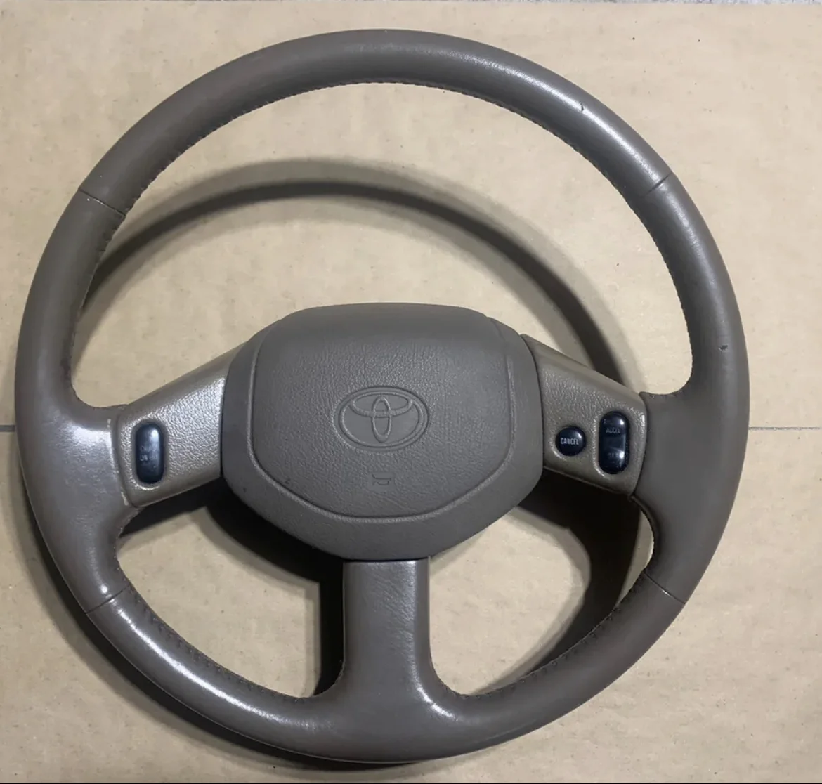

Another option for cruise control to keep it period correct and Toyota, the second gen 4Runner has a steering wheel with cruise buttons built into it. Wiring it will still need the relays in the cruise post, because they send a ground signal… but the wiring will be very similar and straight forward. It’s got all of the buttons on it too so no need for dash switch. Here’s a photo for an example.
If you prefer a leather steering wheel, the mk3 supra uses the same wheel but with leather.
Is this a bolt on solution? Splines the same? Also any idea what the diameter is compared to stock?
Its probably a bit smaller than stock. Id say probably slightly smaller than hte fj62 wheel too. The splines on every toyota vehicle from 1980-2000 seem to be the same. Ive had a AE86 wheel on my fj60, a 4runner wheel, and a camry wheel has been on there before too.

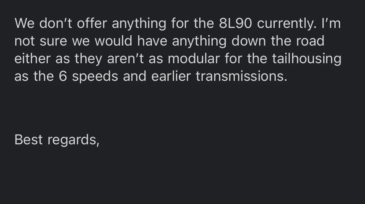

True, trouble is 3rd and 4th gens are going on 10-20 years old. Soon you won’t be able to find a donor with less than 200k miles
If I was only able to find a high mileage 3rd or 4th gen then I would get a 3rd or 4th and do a light rebuild. Have the bores honed, fresh rings, reuse the pistons, new oil pump, and put it back together. The pistons and bores seem to barely wear much. I dont like the oil control land oil drain design of the stock pistons though. If reusing i would drill some holes in the oil control lands for better drainage. Or I would go for glory if i had a bit more money and put a stroker kit in it with a truck norris cam. Turn a 6.0 to a 6.8. This is my biggest regret is that I didn't do a stroker kit in my motor. Stroker kits aren't too expensive at all compared to buying a crate motor. The power of the 5th gen would be cool too if its in the budget. It seems like its more expensive and more complicated. I think the 8 speed is over rated too. So many speeds may provide a very smooth driving experience, but it seems a little unnecessary. Usually that many speeds are used for small turbo motors like eco boost type engines that have narrow power bands. The LS has a large power band. I really don't think any more than 6 speeds is necessary. That's just my opinion though.
