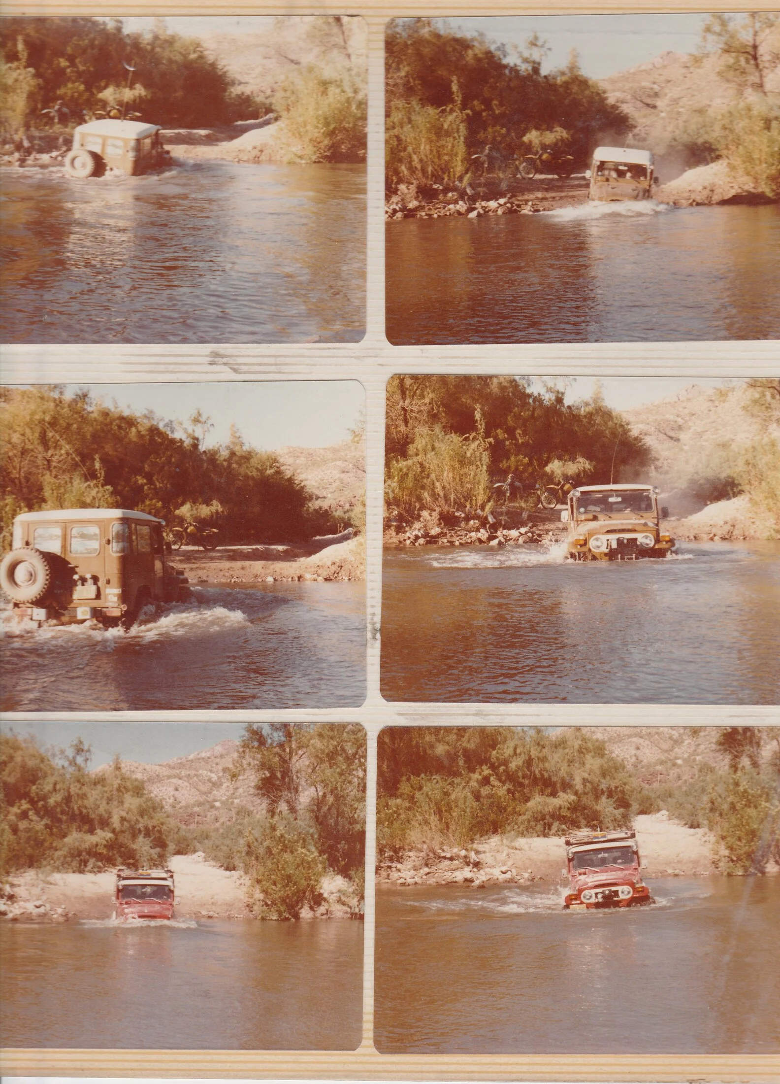

I have had water up to my front fenders and my turn signals looked like periscopes. When I saw that the guys in the old Bronco would not follow I turned around and went back.
Looking at the old hard copy pics above brings back memories of our various adventures now filed away in shoeboxes

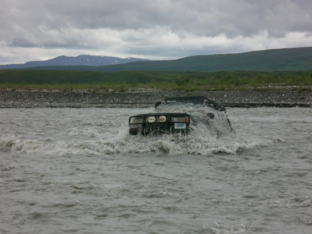

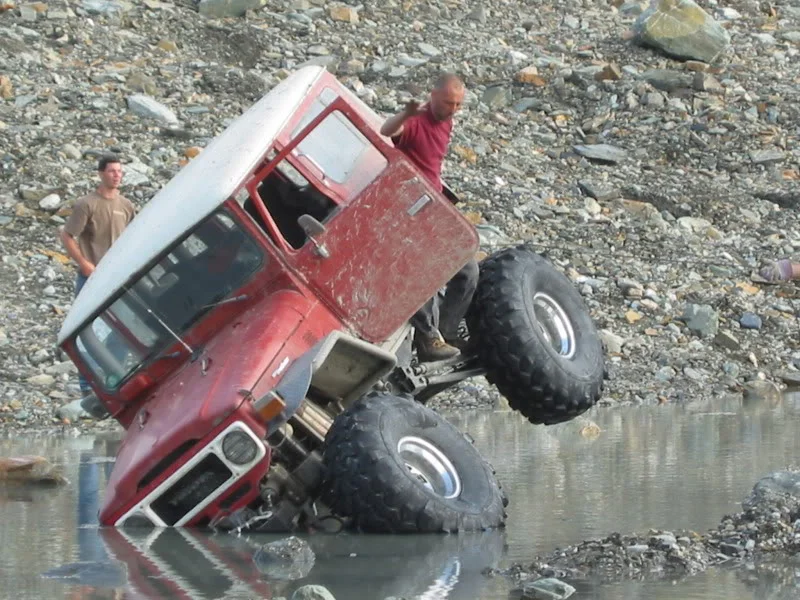

This is an example of how deep you can NOT go with a SOA '40 on 35s and a 350TBI. In moderate current too. Fortunately the rig wound up facing into the flow and in gear, and since the current was not fast, it stayed there until we made it back to the location a full 2 days later for the recovery. he got lucky. The Ford F250 that went in with him floated, drifted, rolled, tumbled and did not have a single body panel that was not crunched by the time it came to a stop a bit further downstream.
We did wind up rolling the '40 on it's side during the extraction. With the positioning, the direction we had to pull and the current, we expected that. After we re-rigged and completed the recovery, there was no damage from laying it on it's side. when all was said and done the ECU was replaced and so was the battery. No other damage or injury except to Jack's pride. ;)
We have had a few other guys earn "Honorary Submarine Commander status" since then. Including myself. But he was the first to go that big. He entered the river on the far side BTW. Almost made it... or so he thought. At that location, he never had a chance of crossing all the way. He still had a lot to learn back then. Hell, we all did. Still do I am sure.

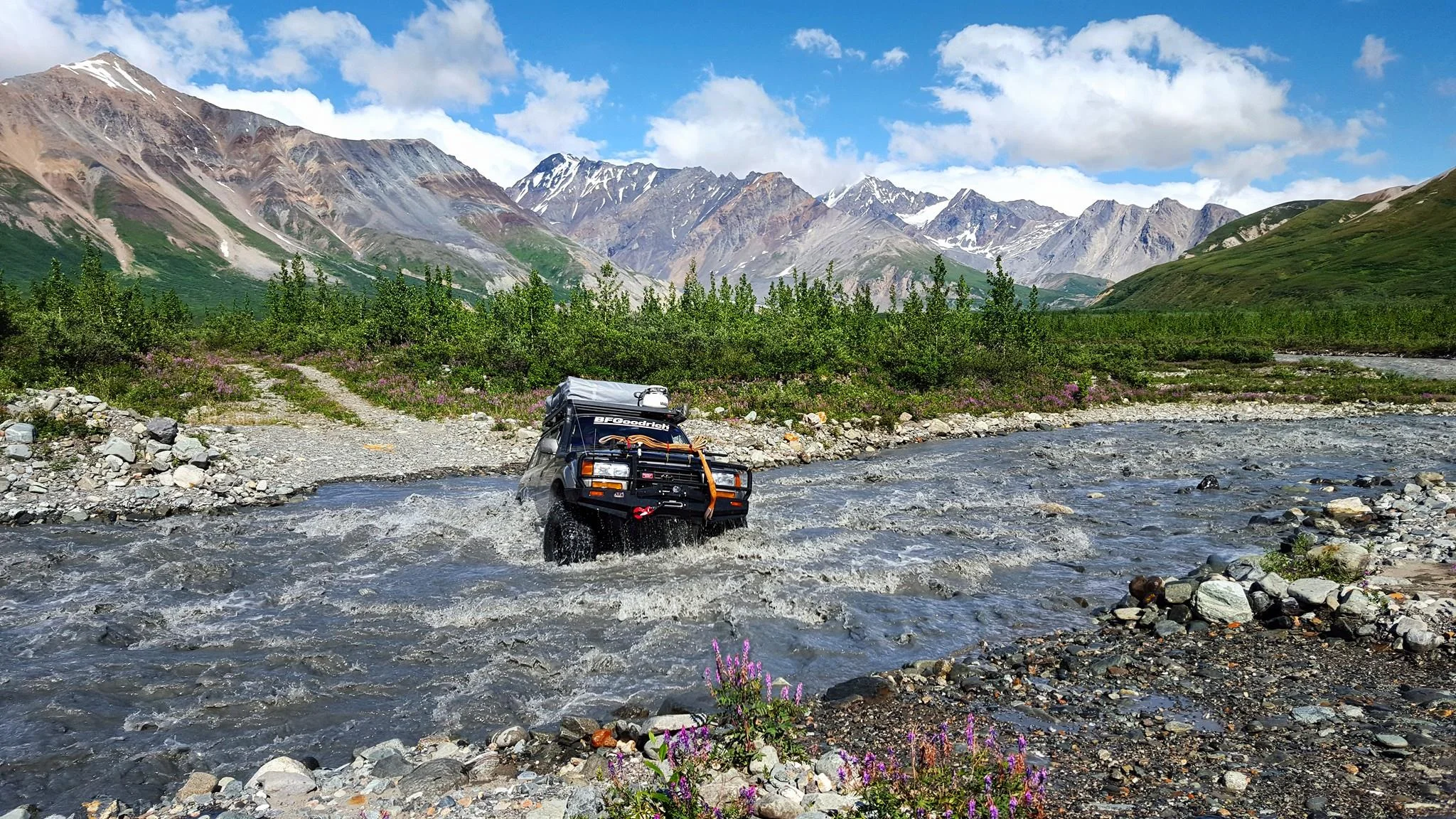

This next pic is a "very much not a big mistake" crossing. I forget whose rig this is. One of our visitors from the Alaska Cruiser Trek 2016. Crossing a tiny stream from one of the side lobes of the Chistochina Glacier, about 100 trail miles in. This was a *little* trickier than it seems in the pic. Narrow, but deeper than it looked as you started in. (The telephoto makes it look even narrower.) The water was washing over his hood until the front tires hit the submerged boulder. he was the last one through, so it had been figured out by then. A couple of the guys wound up dancing back and forth in the hole before they got up and one of them wound up deflecting the METAL blade of his Chevy clutch fan into the radiator. One of more than a couple field repairs on that outing.
