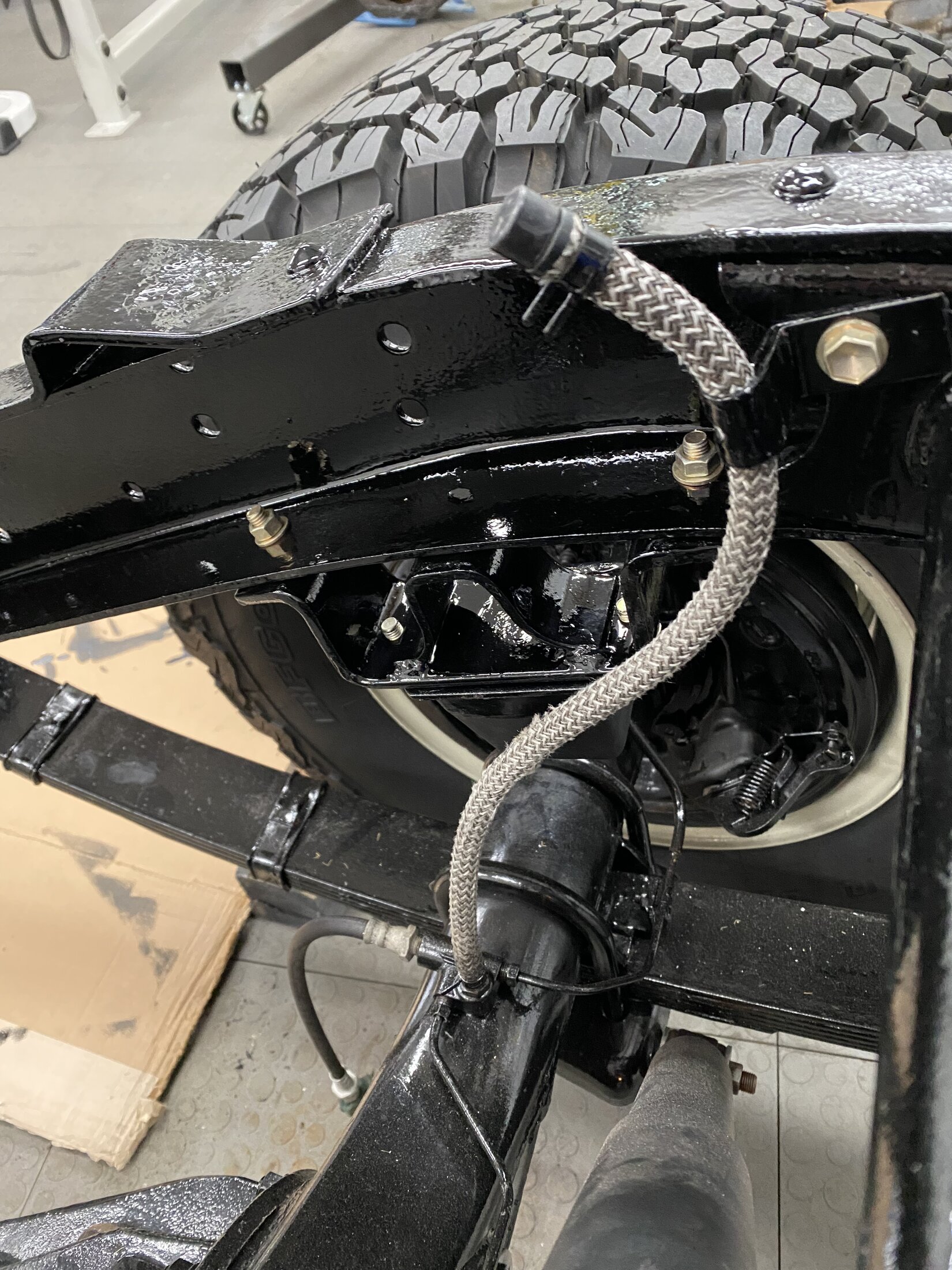

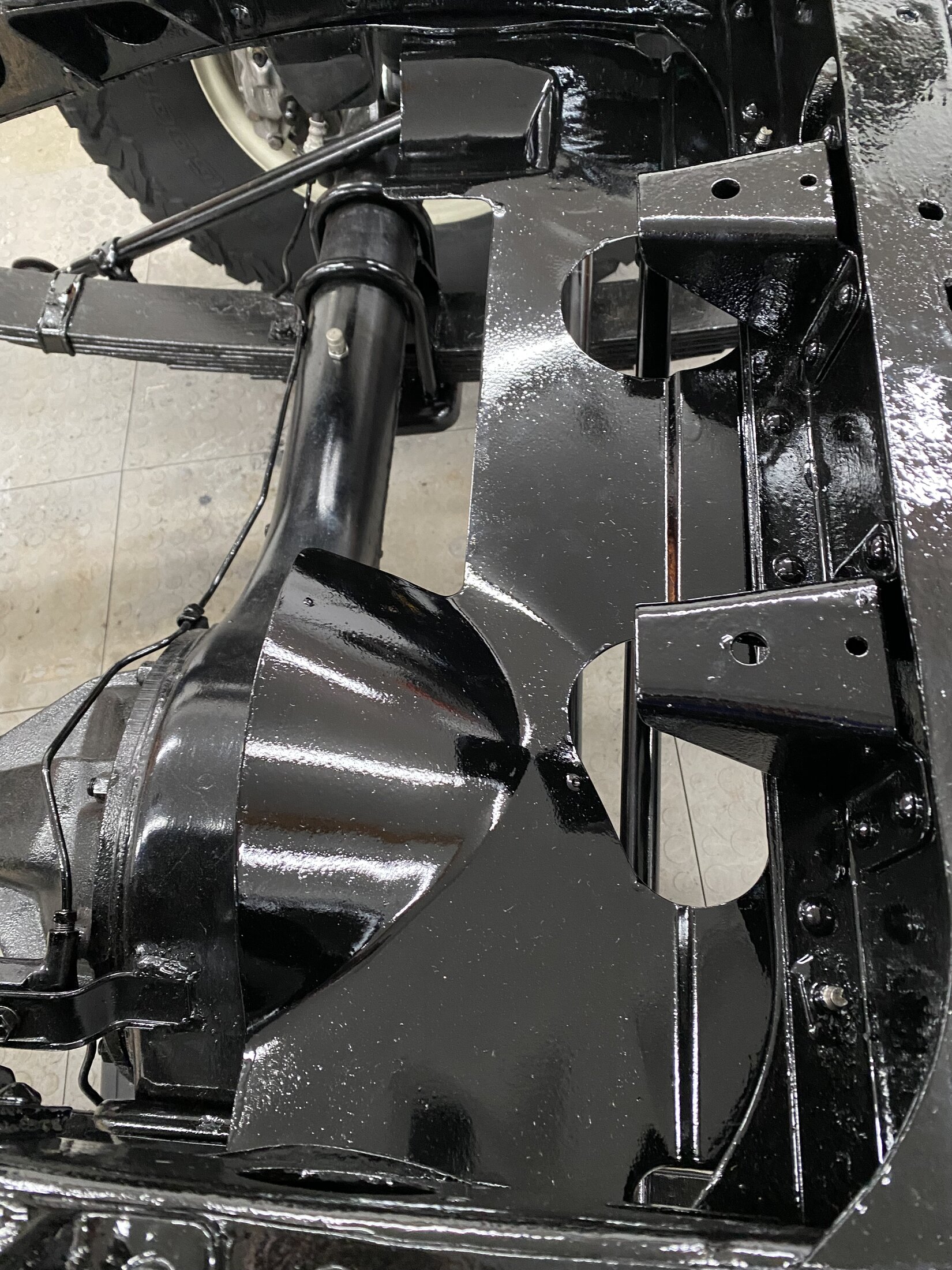

Speaking of axle vents. Anyone know why the rear axle has an elevated vent via a tube and the front just has the standard port on the housing? It’s this way on my 81
Here’s a pic of the rear vent.
And the front vent
