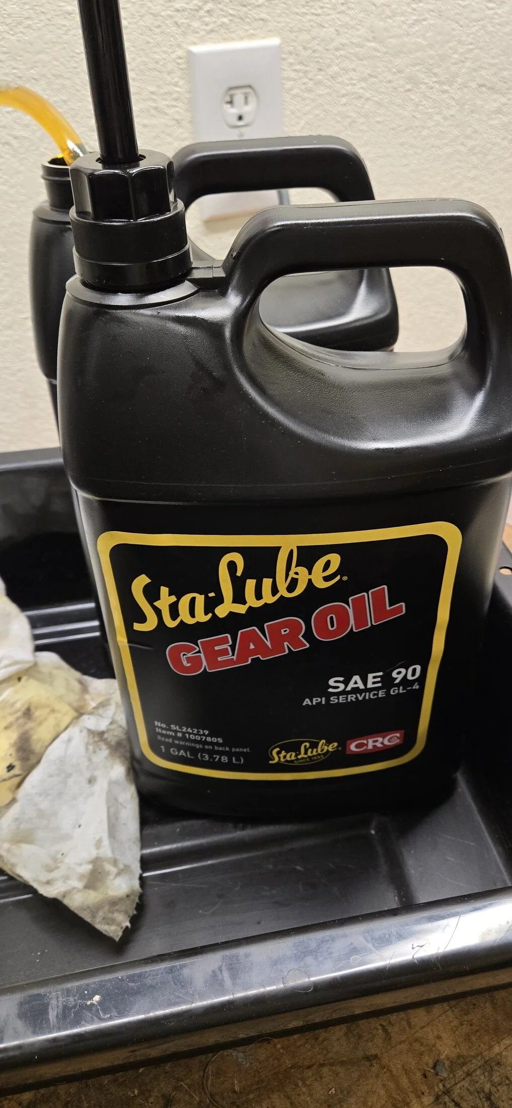

75w90 synthetic for the diffs,
Synthetic/ non synthetic, that's part of the great debate.
I personally don't use any synthetic lube in my rig, one thing I noticed when using synthetic was everything that could leak did leak. Paper gaskets weeped oil, rubber seals leaked, and there's talk that some of the metal inside don't like synthetic.
It's a gear drive tcase and tranny so it's going to whine a bit. How many miles are on it? The tranny should have gl4 in it, its compatible with the yellow parts that are in the tranny. When I approach the type of lube to use synthetic or dino, i look at what was available when these drivelines were designed and made.
Yeah, I've seen lots of threads, mostly elsewhere about synthetic vs dinosaur oils. I can't recall how I came to the synthetic decision for the gearing. I think it was GL4 vs GL5 for gearbox vs diffs. I seem to recall synthetic wasn't an issue for brass bearings, or something like that.
But, Rotella T6 15w40 for the engine was a combination of things; zinc content, multi viscosity for cold weather considerations, price, availability (I use it in my diesel tractor), but mostly it was its detergent qualities. Lots of burned buildup inside that engine I was hoping to "self-clean".
