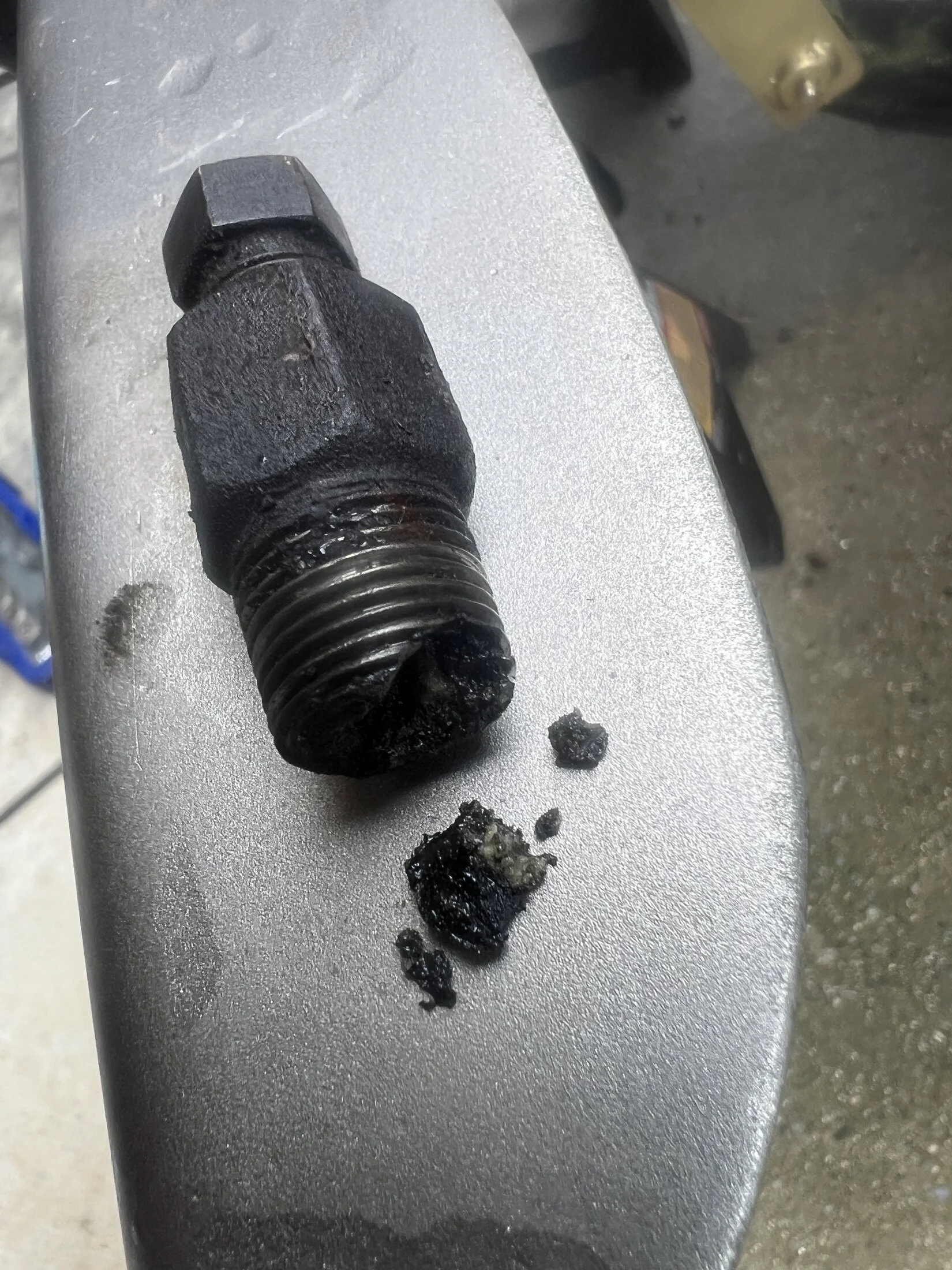

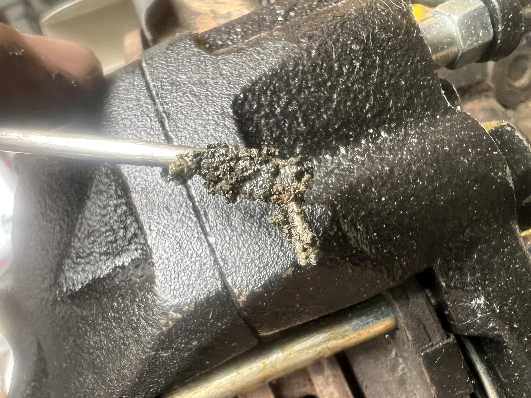

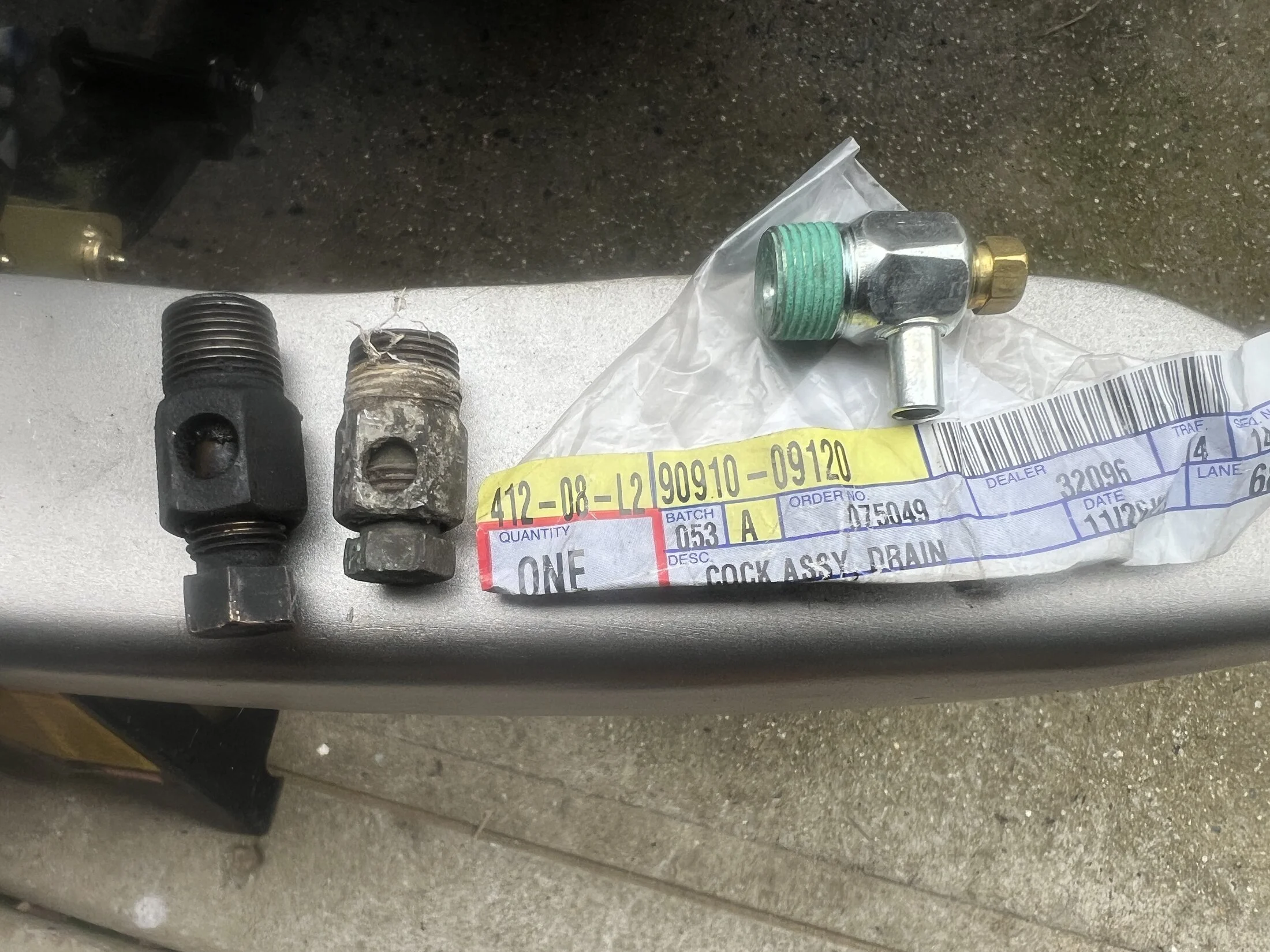

Pull that block drain too. Mine was clogged up and needed a screw driver to break it all free.
You likely have a lot of gunk in the cooling system if the temp is going up with increased load.
Here's some of what came out of my block drain and what I replaced the drain valve with. Hope that helps.

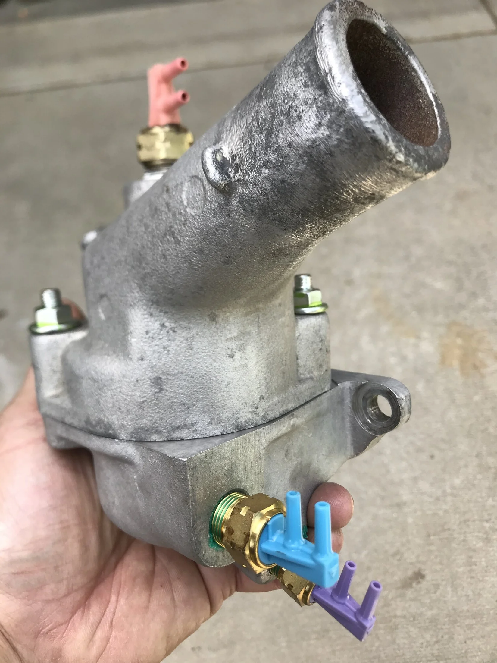

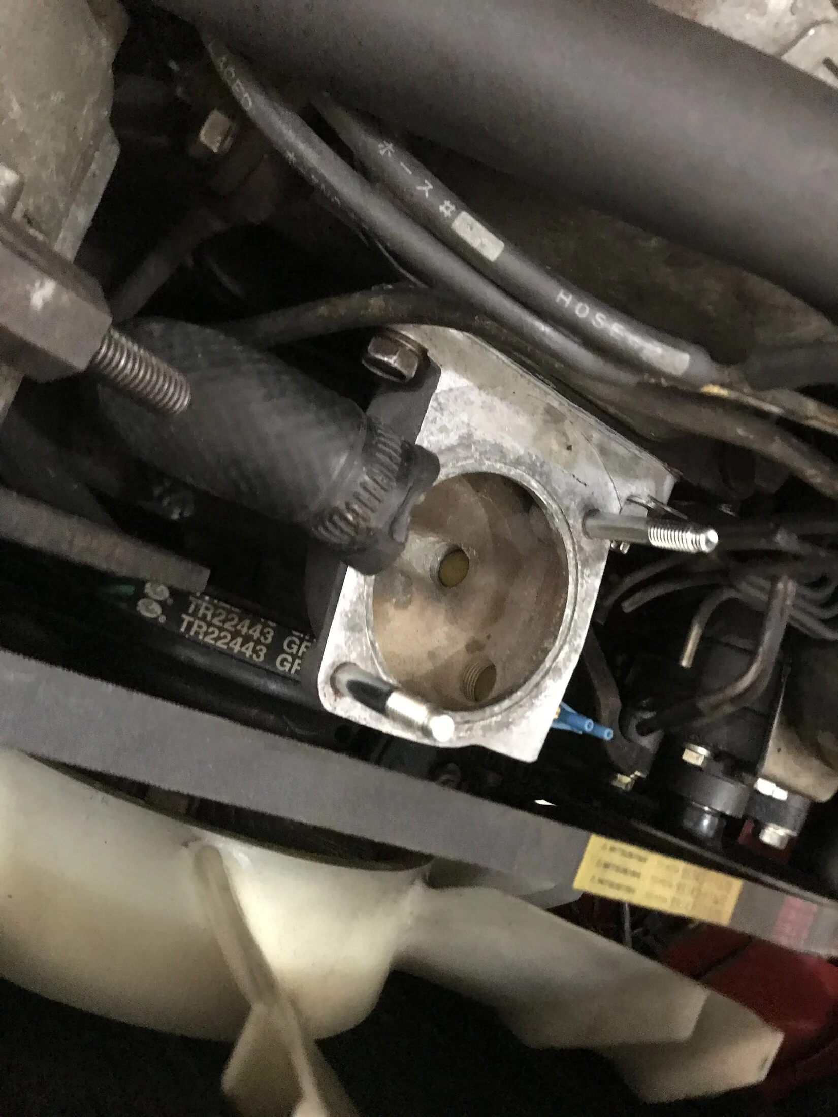

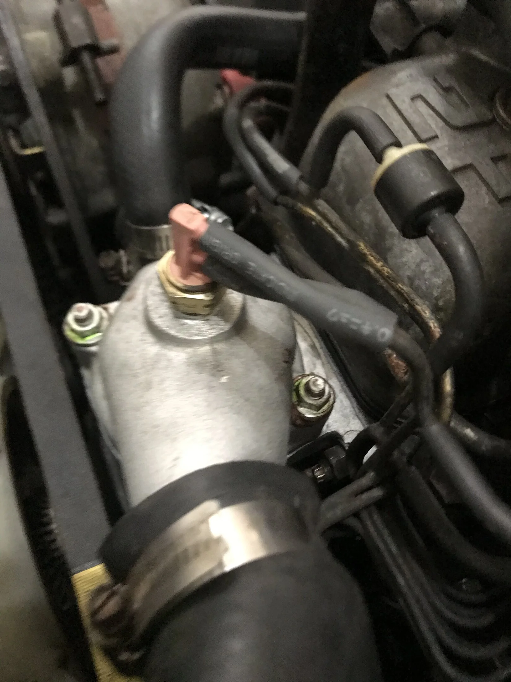

If you choose to open up the cooling system, be very careful with the thermostat housing. Several Heat and Kroil penetrating oil cycles will save you from breaking off a bolt and the water pumps are not made any more
If you choose to open up the cooling system, be very careful with the thermostat housing. Several Heat and Kroil penetrating oil cycles will save you from breaking off a bolt and the water pumps are not made any moreView attachment 3907500View attachment 3907501View attachment 3907502
Thanks for the suggestion and heads up. I've read about the block block drain and the risks of removing the thermostat housing. I have come to believe in Kroil and my Dewalt impact driver to loosen rusty, stuck bolts. Most of the time it actually works.
You could also use carb studs and nut for the thermostat housing. I did a few years ago and never have to worry about breaking a bolt off again.
