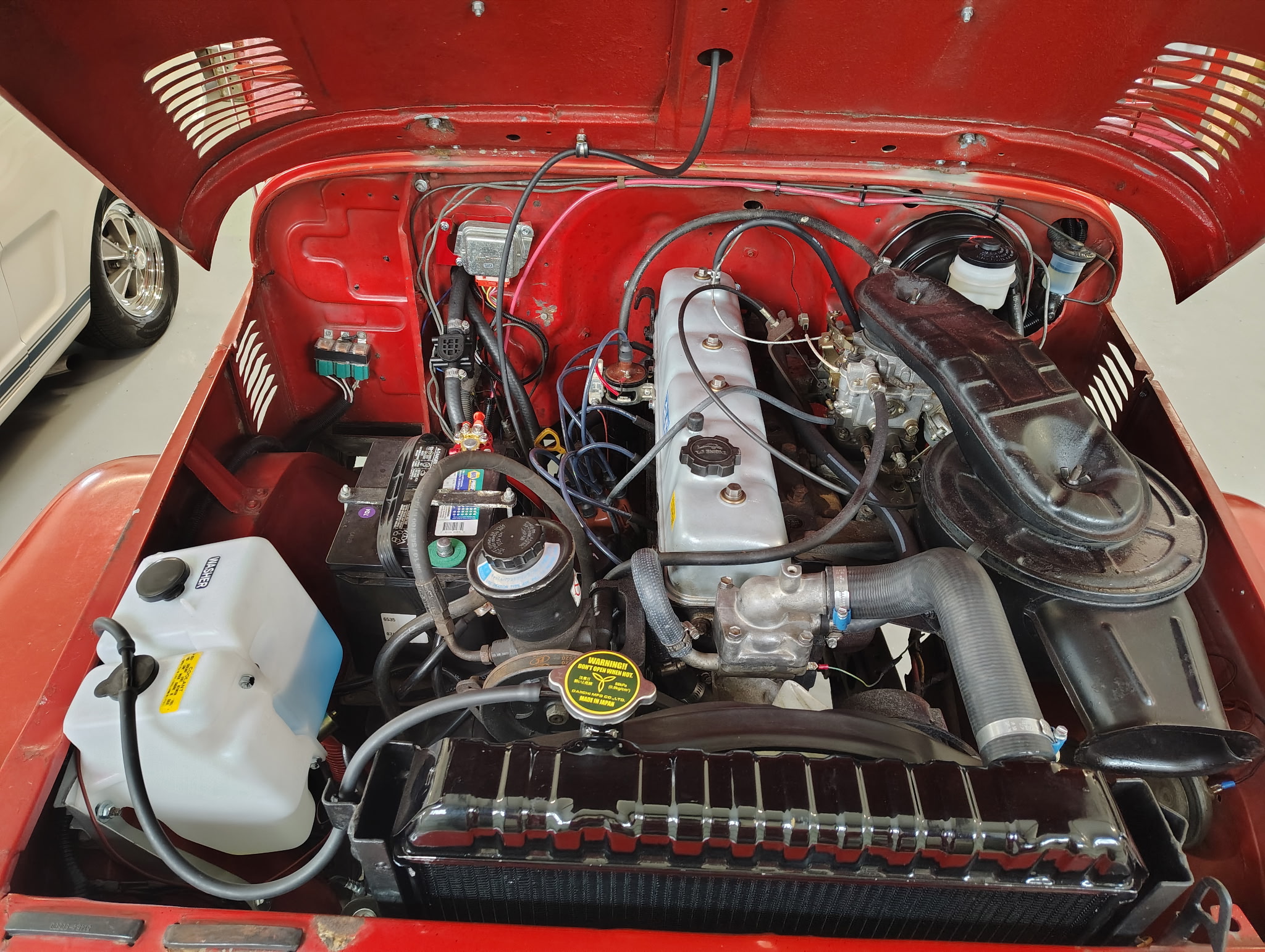

Looking at an SA spec FJ. 2F with good compression numbers all in the 140s. 5 speed tranny. Transfer case and locking hubs all there. Frame is good until this….
Looks like the front shock towers were cut off and replaced with hoops welded further back on the frame. The lower shocks are mounted by using the factory rear mounts.
Wiring has been sorted. Many new factory parts. Definitely diamond plated tub skim coated. A 15 footer if you willl.

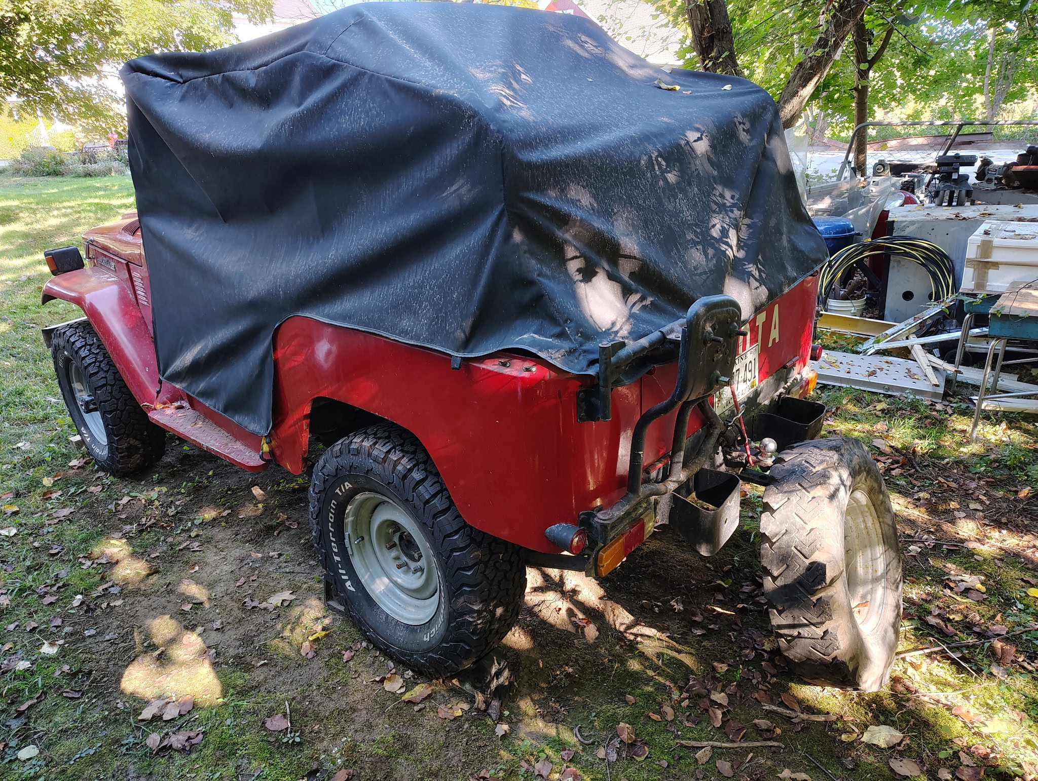

The seller bought it off a guy in their hometown, who had it covered in his yard for 4-5 years. I guess as the story goes it came to the NE from Florida.
This is the pic the seller showed me as it sat when he showed up to buy it.

Those shock hoops are butchery, the wallered out holes in the frame same, and the steering conversion could be ok. whomever got ahold of that thing may have done other less than stellar work. Its all the little things like wiring, knobs, seals, drivetrain, brakes, fuel system that will add a ton to the refurbish costs so inspection of that stuff is important- window cranks, handles, hinges, etc.... what carb is on it, exhaust ?
