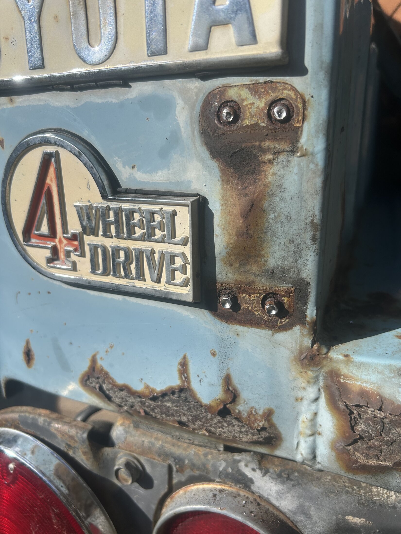

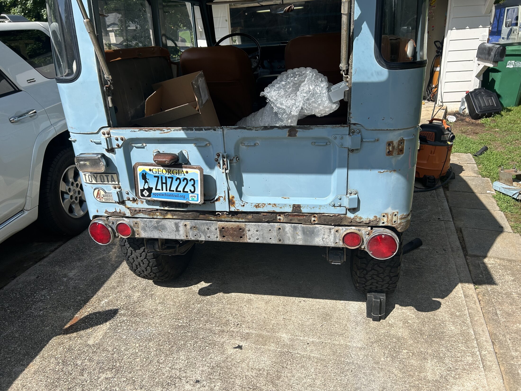

For those who are interested, this FJ40 belongs to @jesus888
Follow along with his build thread if you want to see all he does to it...

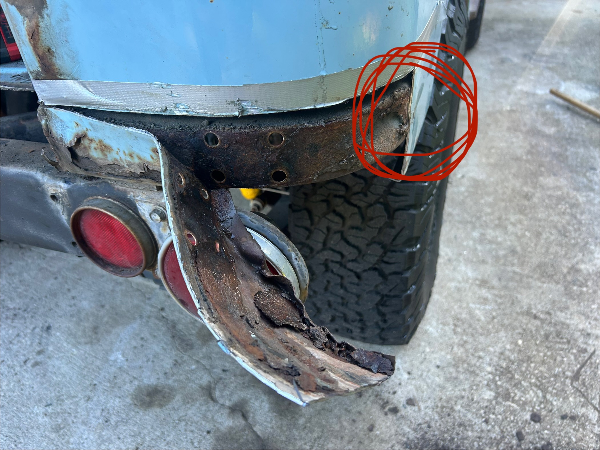

**Step 1**
Begin by removing any obstacles, such as the spare tire rack, bumperettes, rear doors, emblems, etc.
  • You will have to remove the spare tire rack because it is attached to the sill.
  • You do NOT have to remove the doors and the bumperettes, but it will make access easier, so I recommend it.
  • Keep in mind that the door screws may be rusted and difficult to remove. To help with this, use penetrating oil and a good Japanese Industrial Standards (JIS) screwdriver specifically designed for Toyota screws (Thanks @cruiserpatch - see below). It has a broader tip that fits the Toyota screws perfectly.
  • If the screws remain stuck, you can try using a vice grip. In some cases, my screws broke, and I had to drill them out and re-tap the holes.
You can get your JIS screwdrivers from @cruiserpatch. I recommend him highly!!

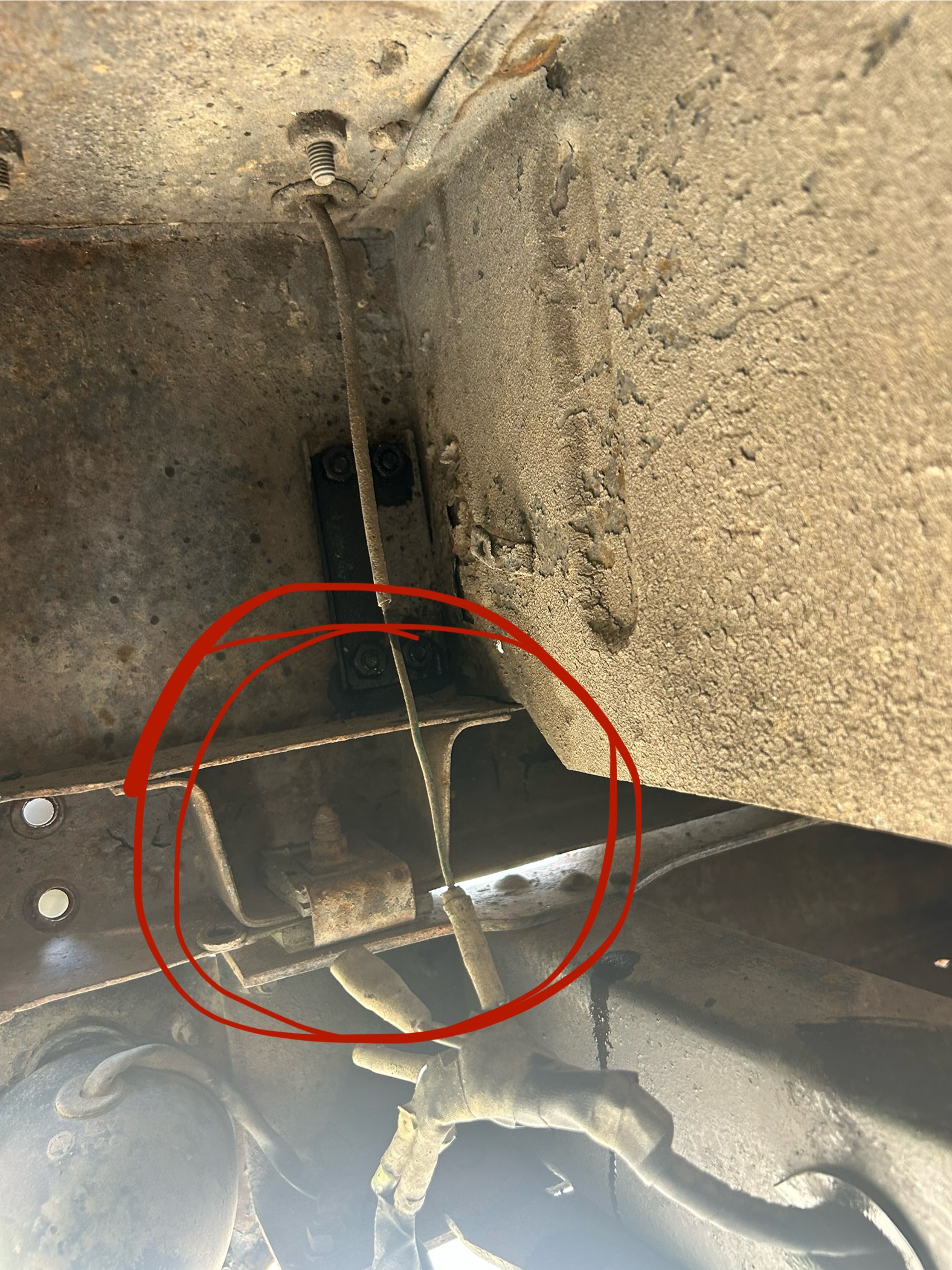

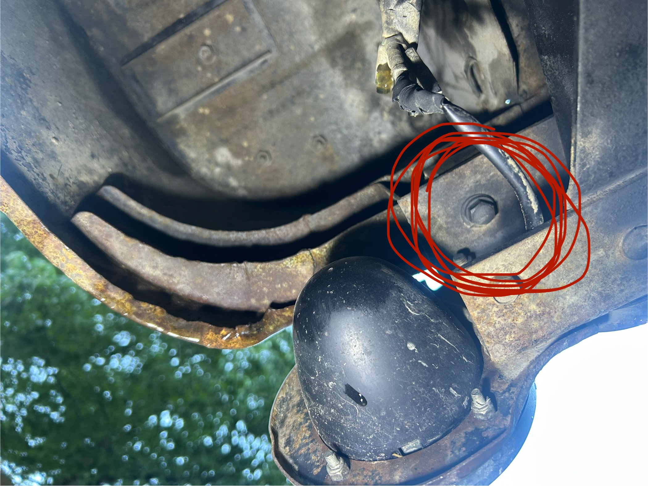

Next, remove the old body mounts located under the sill and attached to the frame. There are a total of four body mounts to take out.
- I recommend you hit the bolts and nuts with some penetrating oil to help break them loose
- Use a universal joint on a socket extension to get up in the odd angles.
- It is a 14 mm

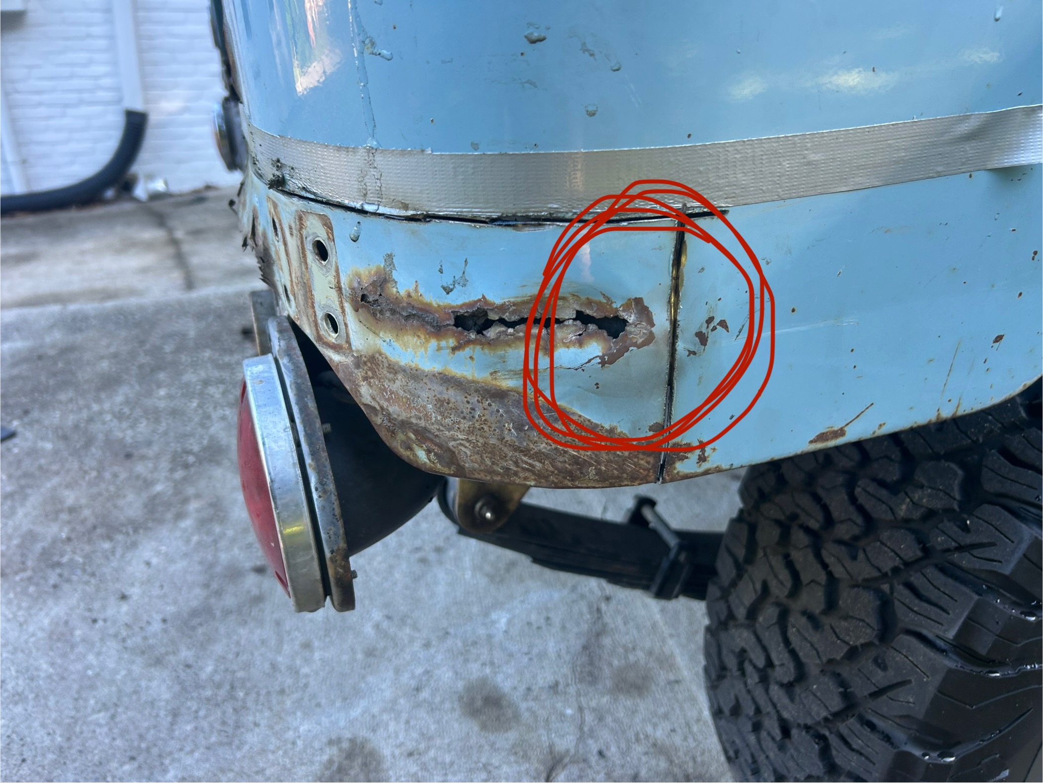

Remove the outer sheet metal sill cover. Take your time and cut it out piece by piece if necessary.
** Be careful not to cut into the bed floor or wheel wells **
**** Especially be careful NOT to cut the bed floor under the sheet metal. You will need to attach the sill and the sheet metal cover to the bed floor under the old sheet metal cover ***

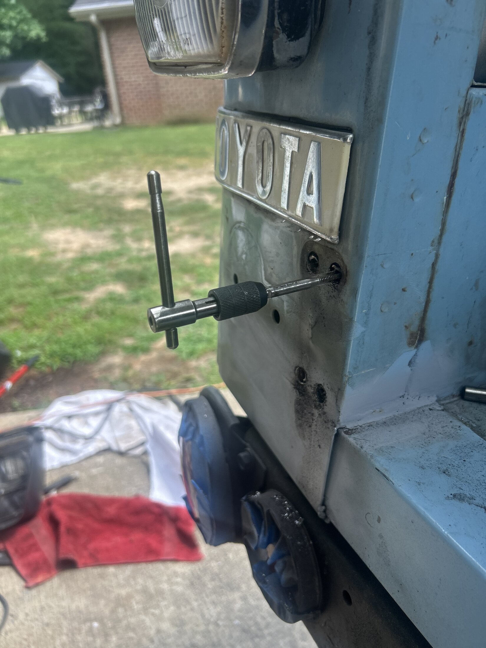

- Drill out the spot welds
- Make a small divot in the center of the spot weld with a tap, and then drill it out. They also make specific drill bits made to remove spot welds. These help make sure you don't drill into the metal underneath, but you can do it with a standard bit as well. Just be careful not to drill too far.

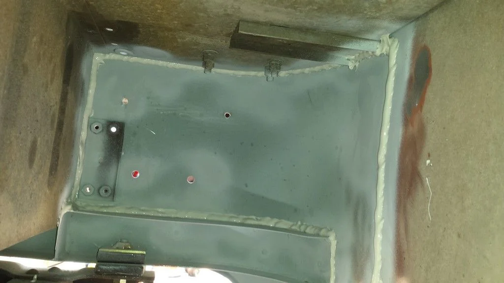

Another note that @Living in the Past mentioned to me is that the orginal bed floor actually wraped around the rear sill (see pic below). Here is what he mentioned to me in a DM
"This picture is the best one I've seen that shows how Toyota assembled the rear sill. The rear floor was long enough to fold over the back of the rear sill. Besides strength it also helped keep the floor flat with a 90° bend. The vertical section was offset for the floor. Below the offset is wedge channels. Believe there was three of these with the wide part at the top. Not clear if these were suppose to be drains or something else. They match the depth of the offset on the top half. Because the floor was just stitched weld it allowed dirt and moisture to get in. To my knowledge, no one has ever built a replacement rear sill with the offset of the factory rear sill."

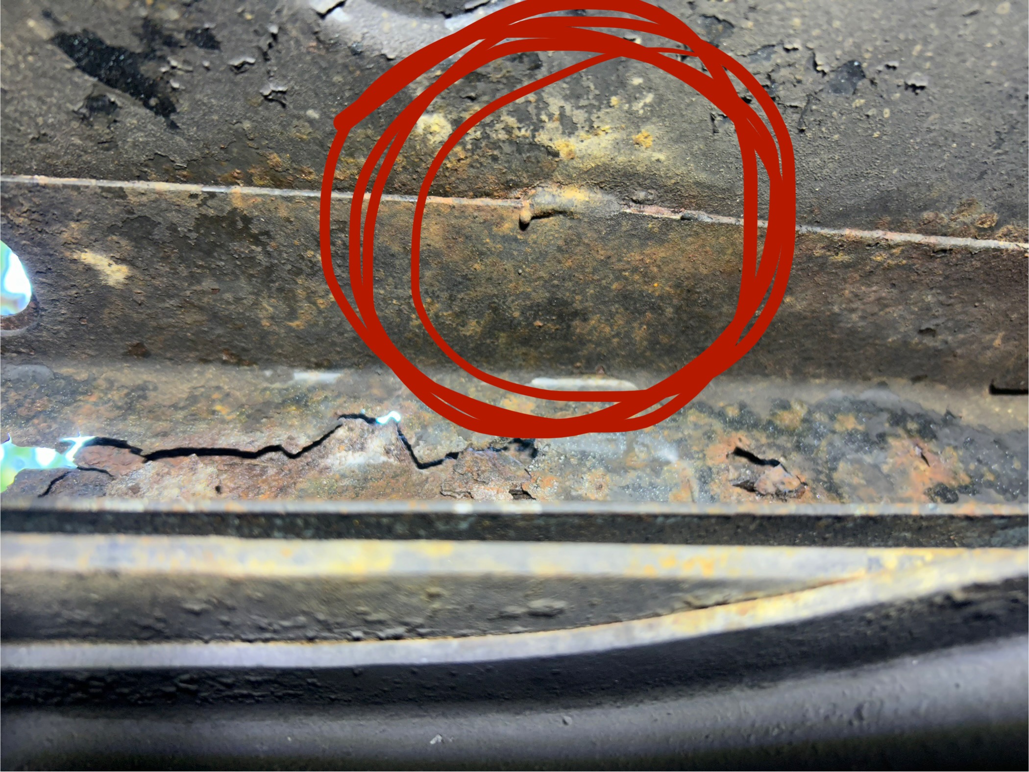

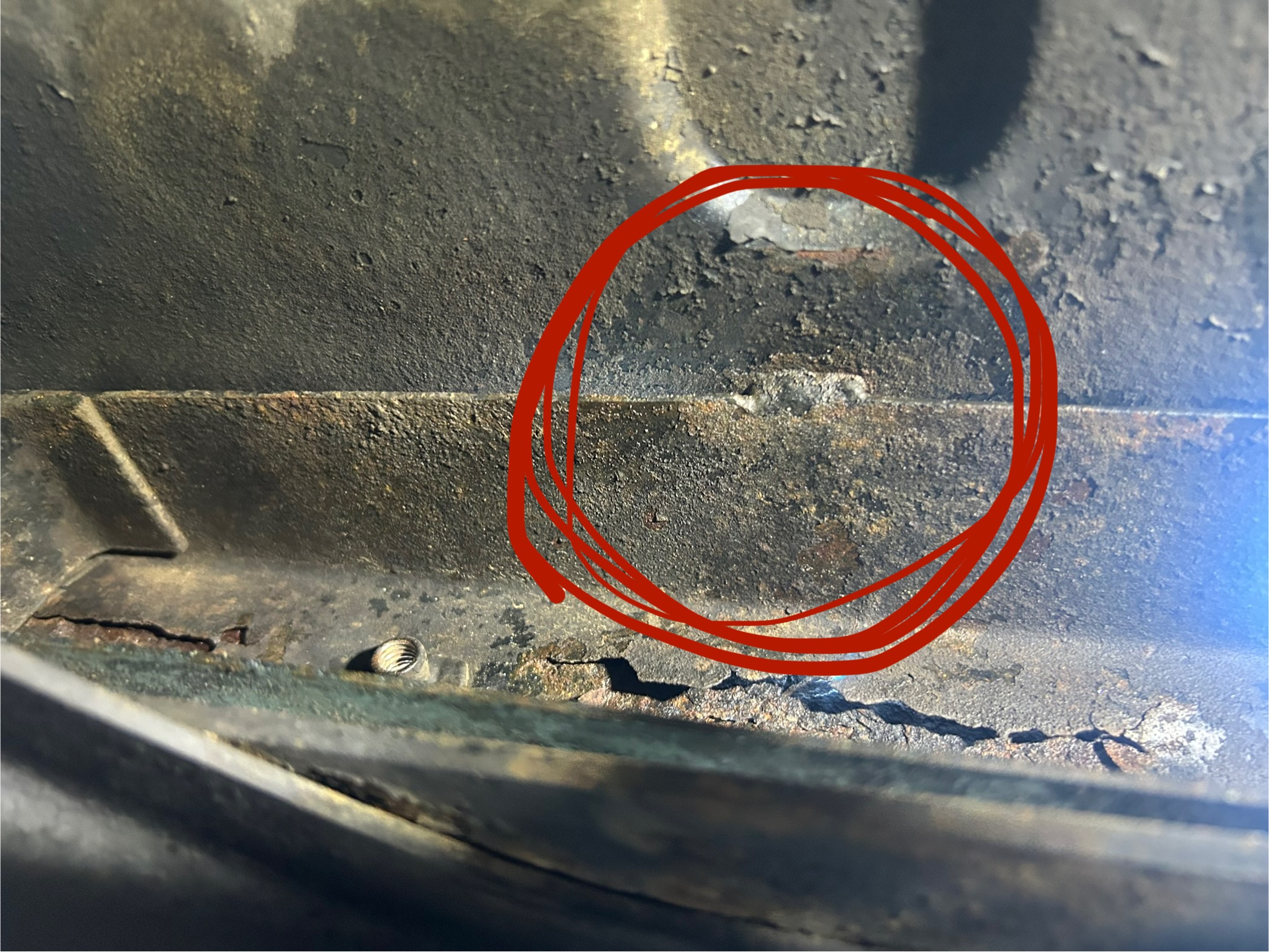

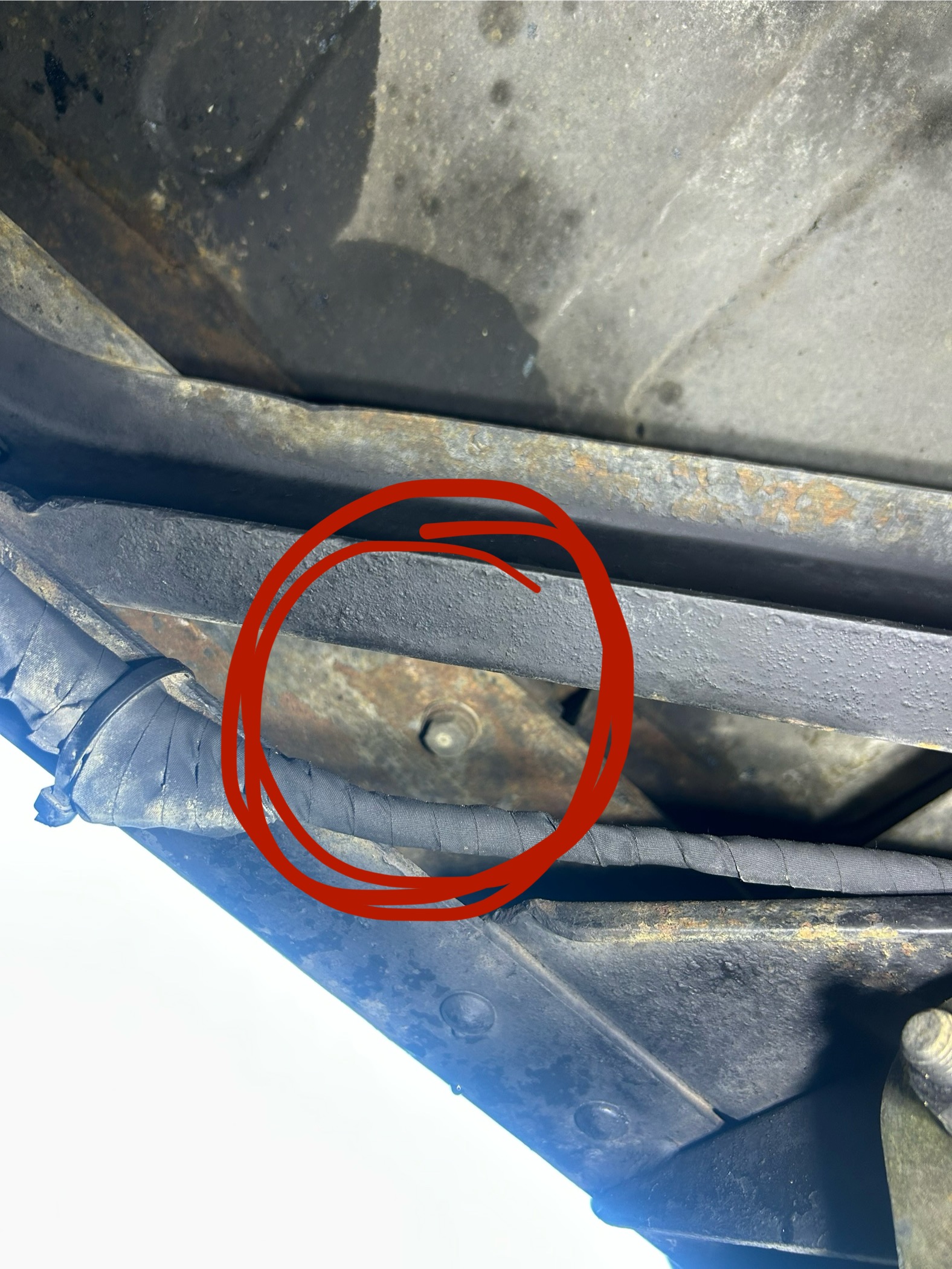

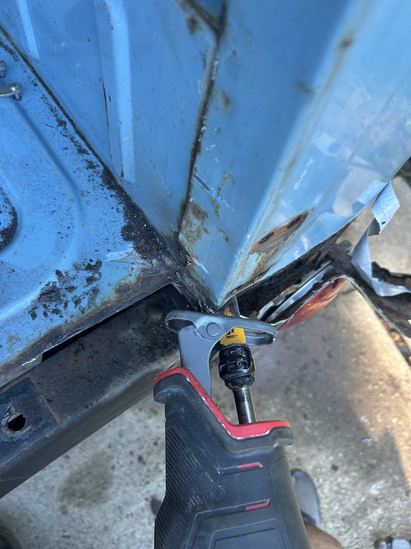

- The sill is "stitch welded" to the bed floor underneath the FJ40 (see pictures). It was probably spot welded or stich welded on top under the cover as well but it usualy rusts so badly under the sill cover that it is hard to tell once the cover is removed how it actually was attached.
- The easiest way to detach it is with a reciprocating saw. Take your time, go slowly, and be careful not to damage the bed floor or wheel wells.

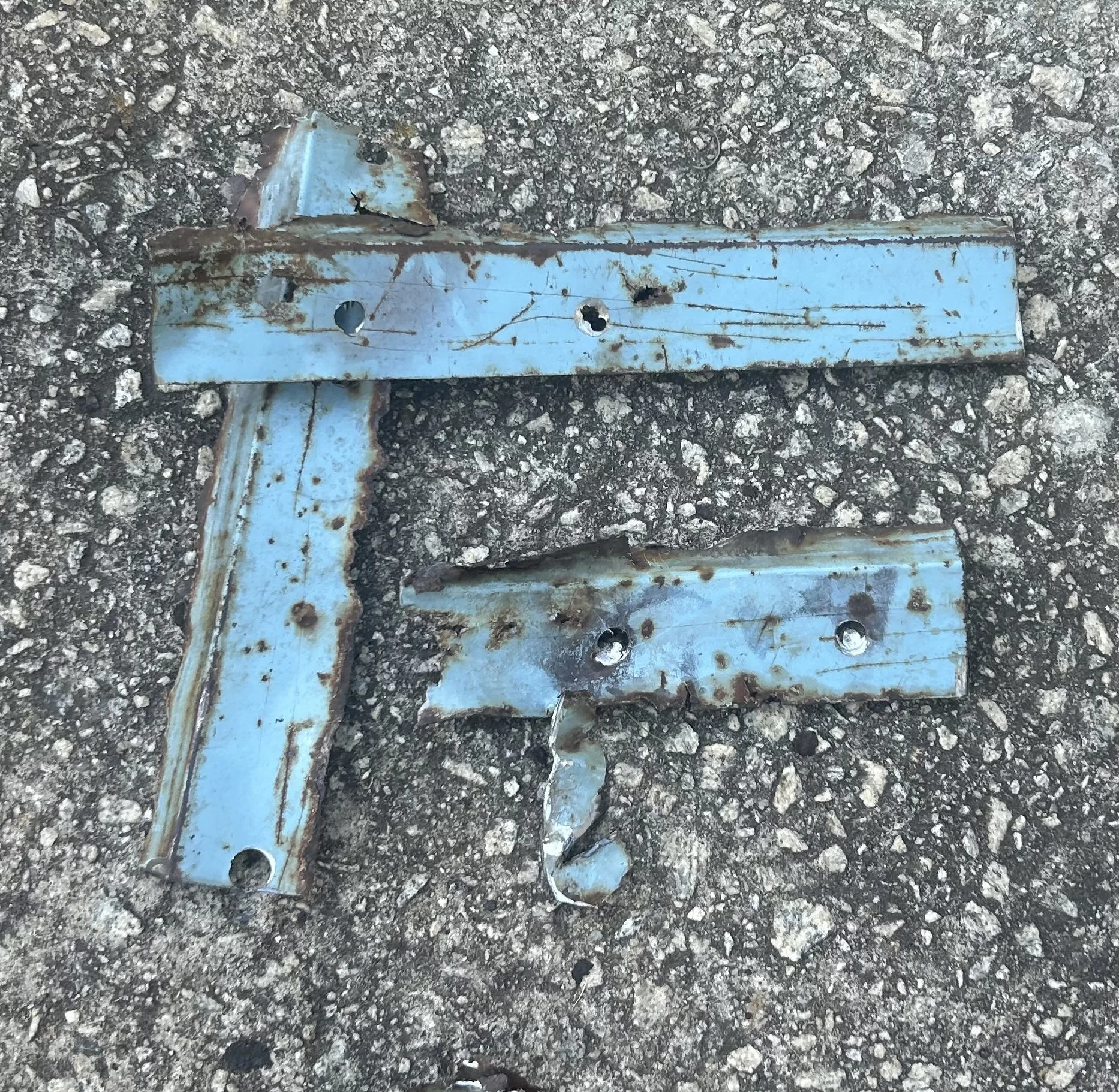

- Once you cut out the quarter panel sheet metal attached to the wings, the sill wings should come out easily. You may have to do a little persuasion to get them out.
Note: The wings are attached with a spot weld or two (see pic below). You may need to drill out the welds.

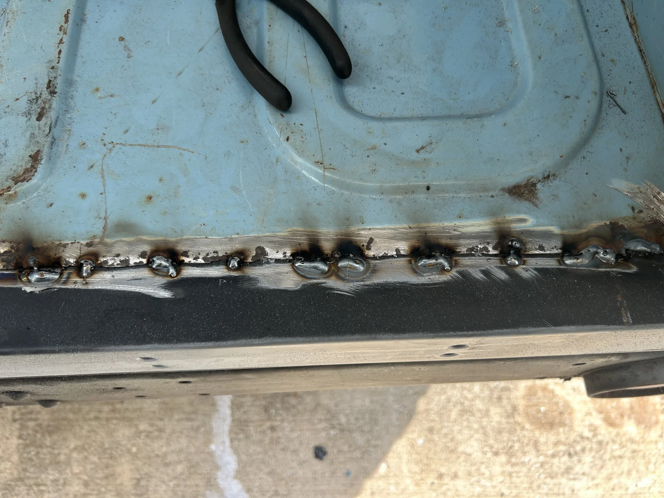

*** Step 9 ***
Permanently install the sill by stitch-welding the bed floor to the new sill.
- Once you have it lined up correctly and fitting well, stitch-weld the bed floor to the new sill.
- While you can completely weld it to make it watertight, this is not necessary. If you do, be careful to go slowly and take breaks to avoid warping the metal.
- You might also consider climbing underneath to add a few stitch welds, though this is not absolutely necessary.
- After stitch-welding, grind down the welds so that the sheet metal sill cover lies flat over it.
- Be sure to prime and paint any bare metal to prevent future rust.
- You may want to seal it with some seam sealer, which I would recommend.
- It's a good idea to test fit the components several times and, using a hammer and dolly, ensure that the bed floor is nice and flat.

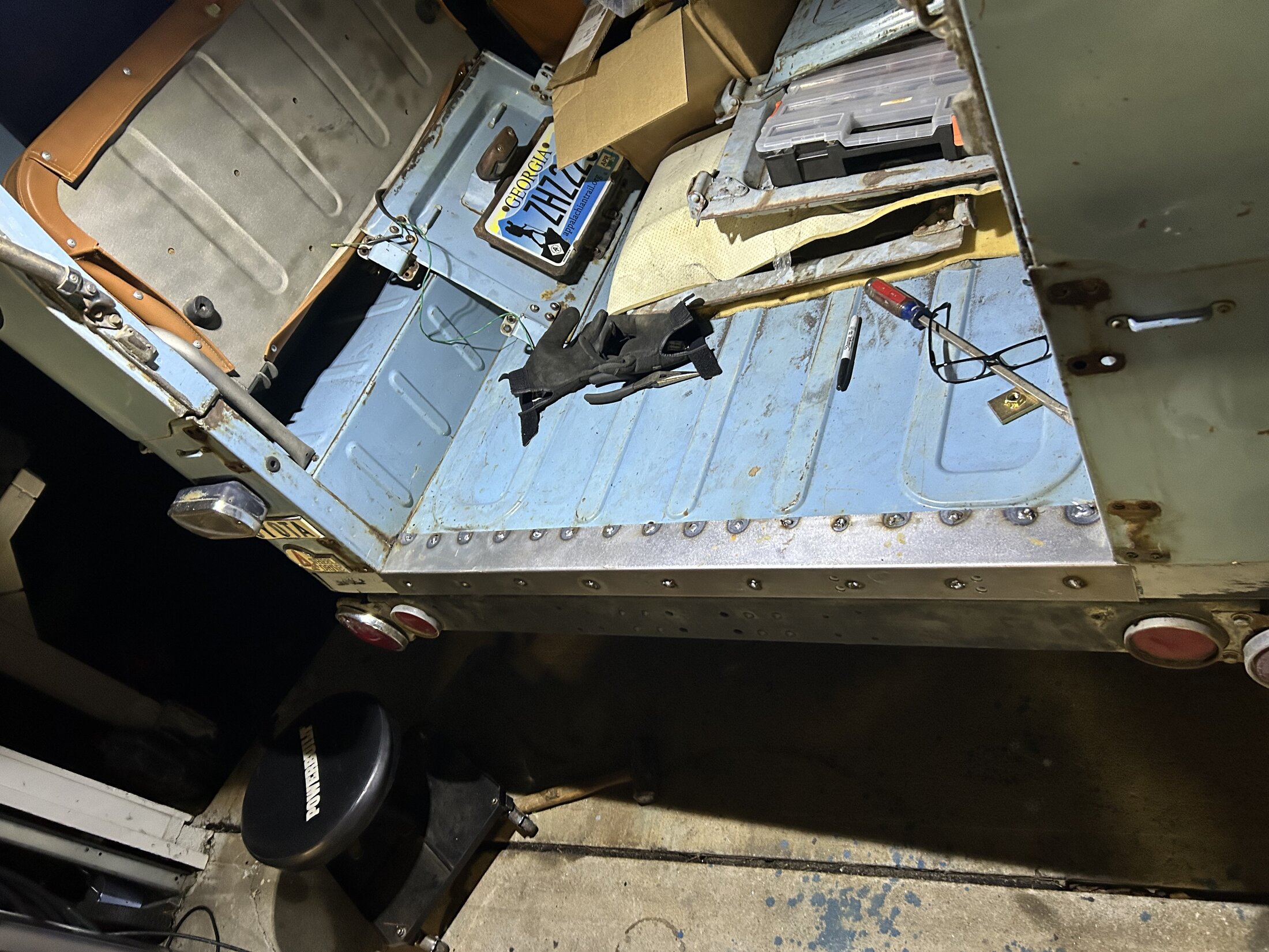

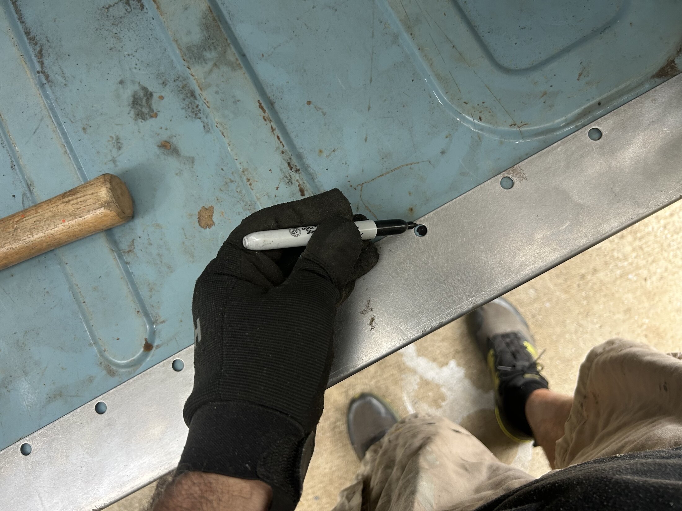

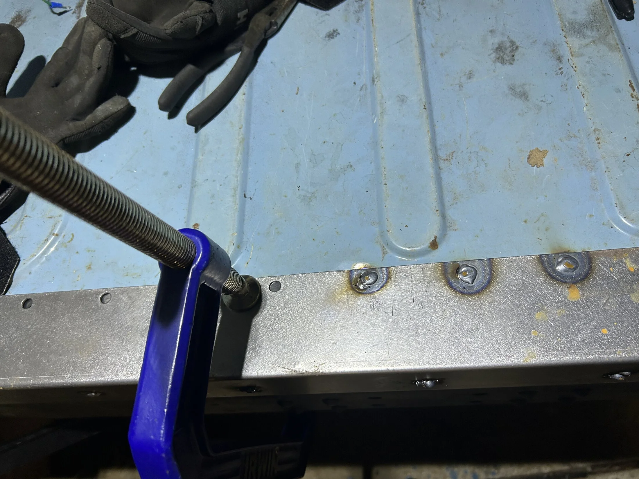

After ensuring the sill and the cover fit perfectly, clamp it down and "plug weld" the new sheet metal sill cover to the bed floor and the sill.
- Notice that there is plenty of good metal under the cover to attach to the bed floor.
- Mark all the locations of the holes in the cover for the plug welds so you can grind off the paint and create clean welds.
- Pay careful attention to ensure the holes for the tire carrier and latches line up properly.
- Using several sizes and types of C-clamps, secure the cover tightly in place and plug weld each hole. You can move the clamps around as you go.
- After plug welding all the holes, grind down each weld so that the area appears as one solid piece firmly attached to the sill.
- You may want to run a small bead of seam sealer along the edge of the cover and the bed floor to help prevent moisture from seeping in.

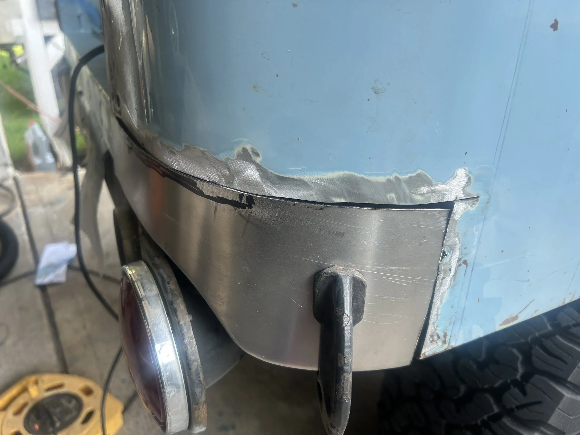

Fit new quarter panel pieces and weld in.
- I used the rear lower quarter third patch panel from CCOT, and again, it was great. Nice and thick metal that fits perfectly.
- Cut it to fit and weld it in. I added a couple of holes for "plug welds".
- You will most likely need to spend some time grinding and reinstalling the panel several times to make sure you have a good fit before you weld.
