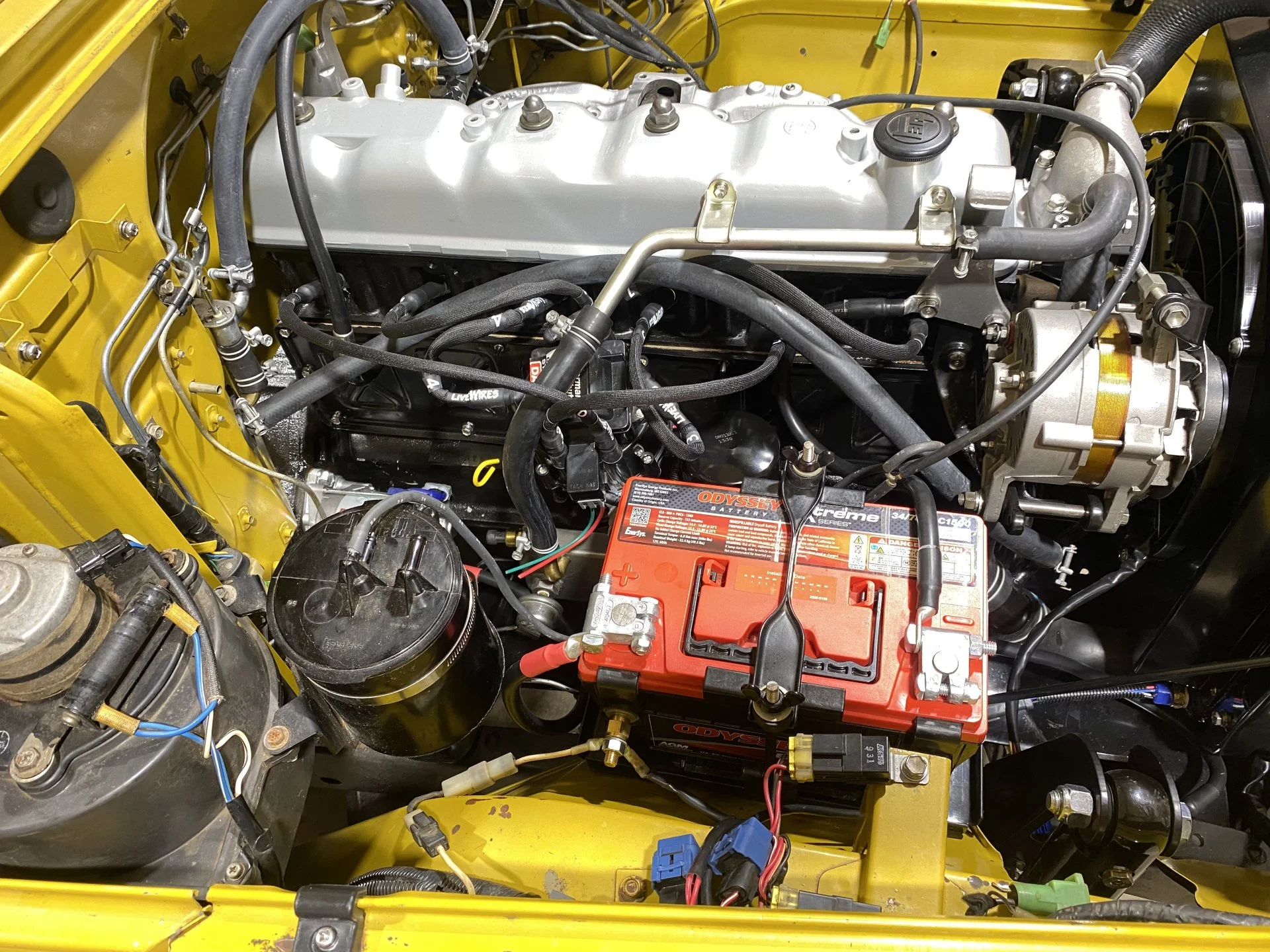

Reviving an old thread.... I will be replacing all of the hose clamps with double wire stainless from City Racer. I suppose that it is necessary to drain all of the coolant before tackling this job. But I would like confirmation. If I'm going to drain the coolant, might as well do a proper flush. Any suggestions on techniques? Also, it seems to me that I have read of various techniques for "burping" the system afterwards in order to get the air out. I'd appreciate any guidance on that.

I don't think you have to remove the hoses to get the City Racer clamps on but maybe someone else can confirm. If that's the case then it depends on what type of clamps you have to remove. Some clamps come apart and some don't. I guess you could always loosen and then cut the old clamps off if you're just going to toss them anyway (assuming they don't come apart).
Lot's of threads on flushing the coolant system. Never hurts to do that every 2 years or so.
I can confirm on this. Yes you have to remove the hoses to get the double-wire stainless clamps on. Unless you are more of a tavern-puzzle whiz than myself, I just don't see any other way to do it. One additional tip on this job, the largest size (58mm if I recall?) of the stainless double wire clamps does not work with aftermarket lower radiator hoses (i.e. Gates) that have a thinner wall thickness than OEM hoses. Do yourself a favor and source the OEM hoses all around. There is a noticeable difference between the two, at least in the large diameter lower hoses. Also, I like the results of using Sil-Glyde on all the coolant hose joints. It stays slick, kind of like vaseline, and allows for easy removal and repositioning of hoses.

Thanks. I ended up draining the system (most of it puked on our garage floor) This "quick little" project has turned into a bit of a worm hole venture. I started out just to replace a few tattered looking hose clamps with OEM-style. But the clamps that I ordered were bottoming out and not snugging up on the larger bottom hoses. So, I ended up going a different route ordering 1/2" solid band SS clamps (Sizes 10, 20, 24 1nd 28). Also, I ordered replacement hoses, thermostat & gasket. I decided too that ,while in the deep recesses of this worm hole, I might as well flush the radiator
