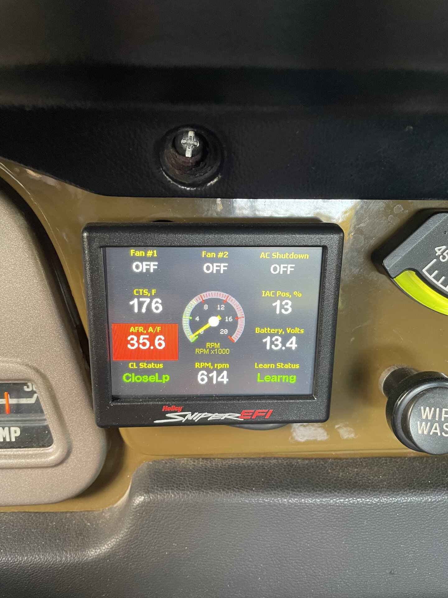

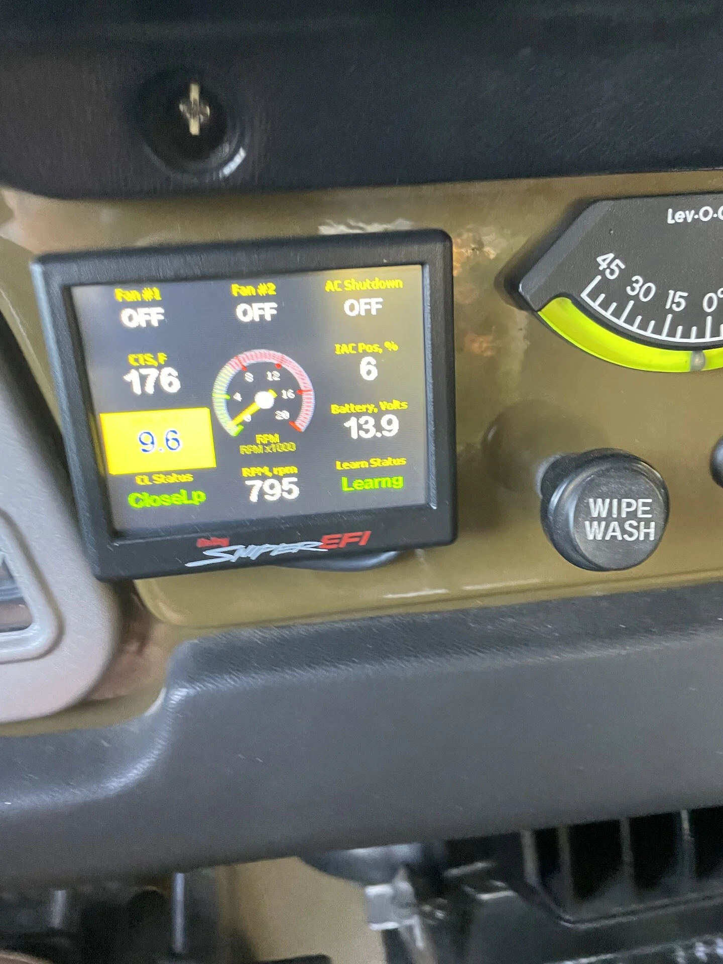

My 40 has been sitting for some time…. Just took it for a spin and when idle the AFR reads 9.6, then will spike to 35.6 every 30 seconds or so then catch its self with extra rpm to keep running. IAC at 4% but drifts as well…
When on the road it bogs down bad on acceleration.
She ain’t happy!

I have had my sniper for almost 2 years without problems. It started running rough especially under throttle two days ago. New O2 sensor ordered. Here are the numbers.
Try disabling the "Closed Loop". I believe it takes the O2 sensor out of the circuit and runs on the last settings. If it runs better, then it's probably a faulty O2 sensor and it can get you by till it's replaced.
Could your idle RPMs be dropping low enough that the system thinks it's in crank mode (where it opens the iac)?
Does sniper let you look at those settings?
Disabling closed loop made all of the difference.

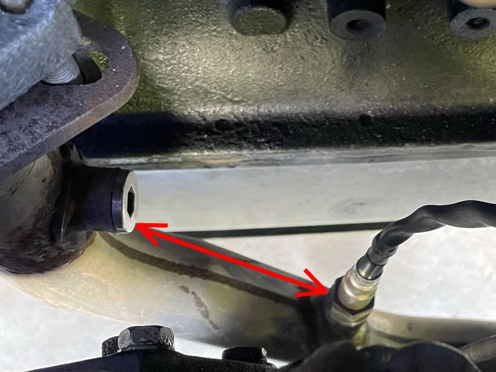

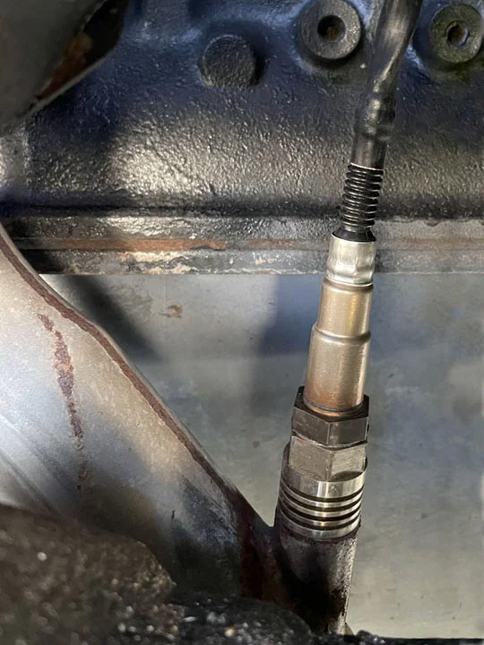

This will be o2 sensor #3…. I’ve got headers 3 into one with a Y pipe around the oil pan area. Sensor is placed just downstream. Could it be too far away from combustion?
Vacuum is on the low side 17”, but steady.
Looks like I have an exhaust leak at the y pipe. I’ll put some dope on it to see about a better seal.
Exhaust leaks upstream of the sensor is bad.
I think being too close can be an issue but not too far away. I’ve gone through quite a few sensors. I moved mine further downstream believing it was getting too hot. I used a 45 deg bung and added a bung extender. All my faulty ones were sooted up bad and I had poor luck in cleaning them. However, since the head was rebuilt, it’s been running great on the only one sensor I was able to clean. I do keep a spare sensor on board along with the wrench.

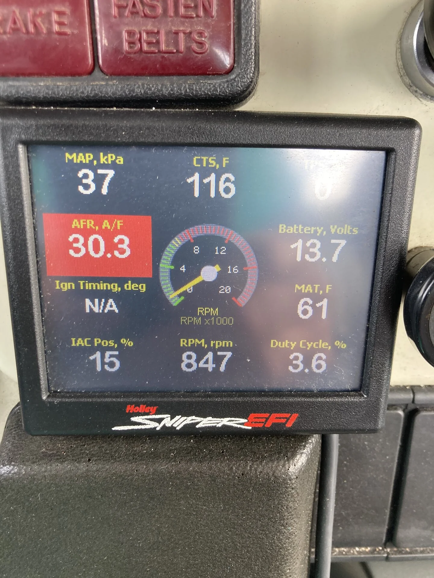

I started it this morning. Idles good. Solid, steady vacuum @18. Disabled Closed Loop and took it for a short drive. AFR remains around 30 and the IAC which normally sits at 3 or 4 is 11 to 14. Drives fine with no stumbling but I can definitely smell the unburned fuel. The soft top creates a Venturi which brings all the fumes into the cab.
(hence the catalytic converter in my future). We’ll see Monday evening when the new sensor arrives if that is the problem.
RE the post below. I did take the air cleaner off and noticed a nice even mist of fuel spraying in both barrels of the throttle body.

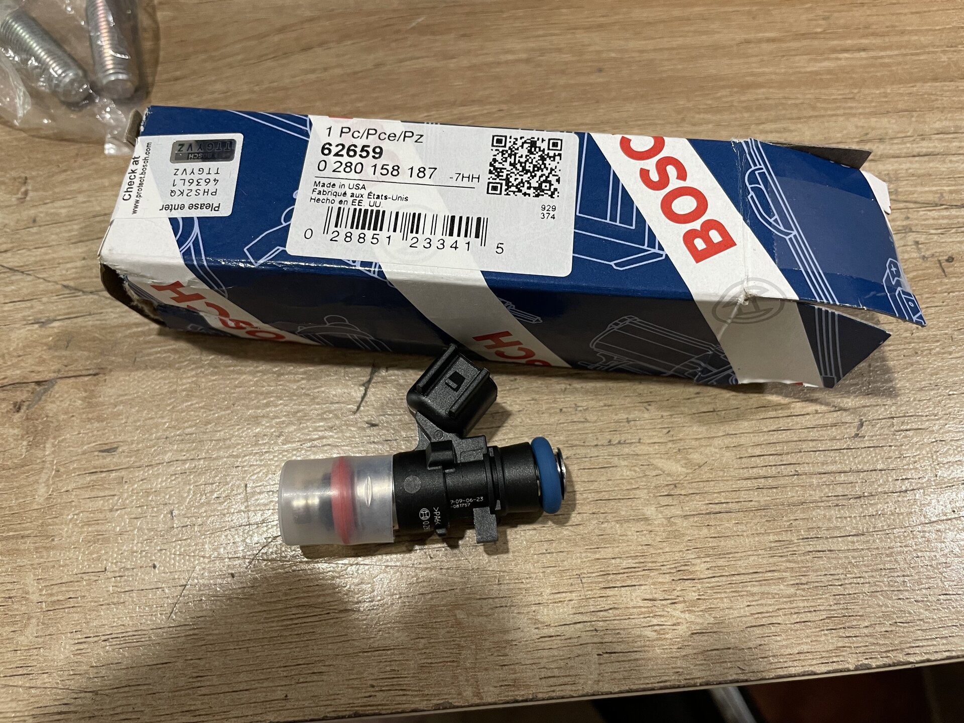

What I came with for a quick test. LSA injector, 60lb/hr. Should drop-in.
Will have 160lb/hr vs 200lb/hr total injector but that should be plenty for a F145, going to try it and see how it goes. Thr injector data in the tune will be off but closed loop should compensate enough. Will know in the next day or so.
Bosch 62659 available pretty quickly thru Rock Auto or Amazon for about $60

Good find Matt. Online sluthing found similar results for me. The only difference I can see is the O-Ring differences. Maybe carefully transfer the Holly O-rings to the replacement will resolve this?
It would be great to find an easy off the parts store shelf part that will be readily available for those of us that regularly do long haul trips in these old trucks. Please post up with your results.
Summit has the injectors. But normally the injectors are fine it’s the connector that comes loose. They redesigned all of this on the sniper 2 . Now I wonder🤔. If you could use the new sniper 2 injector and cut the old connector off and add the new style hmm
You can do whatever you want if you put the right injector data into your tune.
