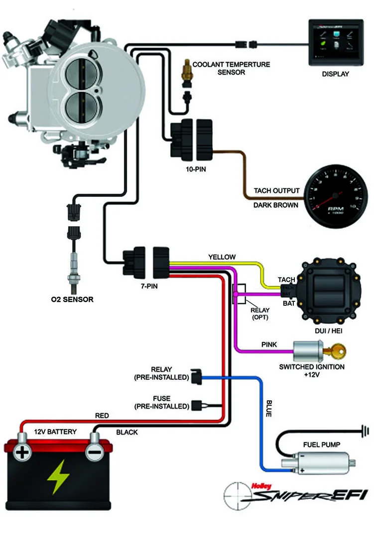

I need to put a fire under my butt and plan on trying to install the Holley Sniper EFI on to my 2F FJ40 after owning the Mosley kit with in tank fuel pump over a year now. The vehicle came with a Performance D.U.I. Distributor and a Weber Carb. Nothing wrong currently, it runs great but I love the fuel injection concept and must install it finally.
Has anyone used this combination and utilized the connection of the distributor to the EFI module? Any suggestions ?

I’ve been running the Sniper/DUI combo for 4-1/2 years. Wiring a DUI do a Sniper is quite easy. (without timing control) The pink wire from the Sniper simply ties into the wire from your ignition switch that goes to the “BAT” terminal on your DUI now. The yellow wire from the Sniper goes to the “TACH” terminal on the DUI.
Using Holley’s diagrams, I made a simplified diagram for a Sniper/DUI hookup.
Performance distributors (DUI) recommends using a relay to feed the DUI and I use one on mine. Several DUI users here have left that relay out without issue. That’s why I show it as “optional” in the drawing.
“Here”is a link to the Sniper PDF manual if you don’t have it already. I used pages 17 and 23 to make my diagram.
@Steamer great diagram. Too cool!! I have the manual and printed a copy of it to lean on the hood when I get to the actual installation. I well go check your copy to be sure the REVISIONS if any, are updated. I have not recollection but is there a part number on the relay?

Saved and printed your diagram 👍
Nice visual aid.!!!
