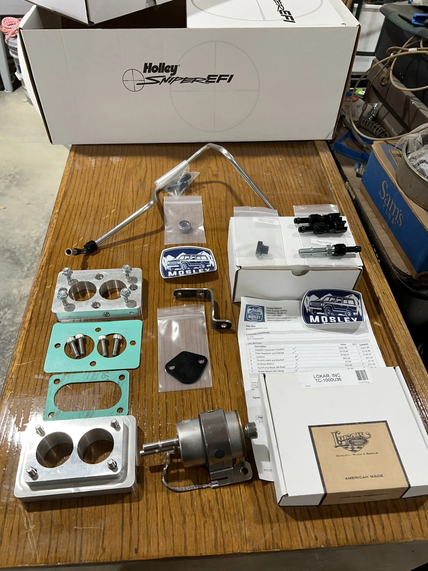

Holley Sniper 2GC to 2F Install using Mosley Motors adapter
Aug 25, 2007
223
3,667
Bowling Green, KY

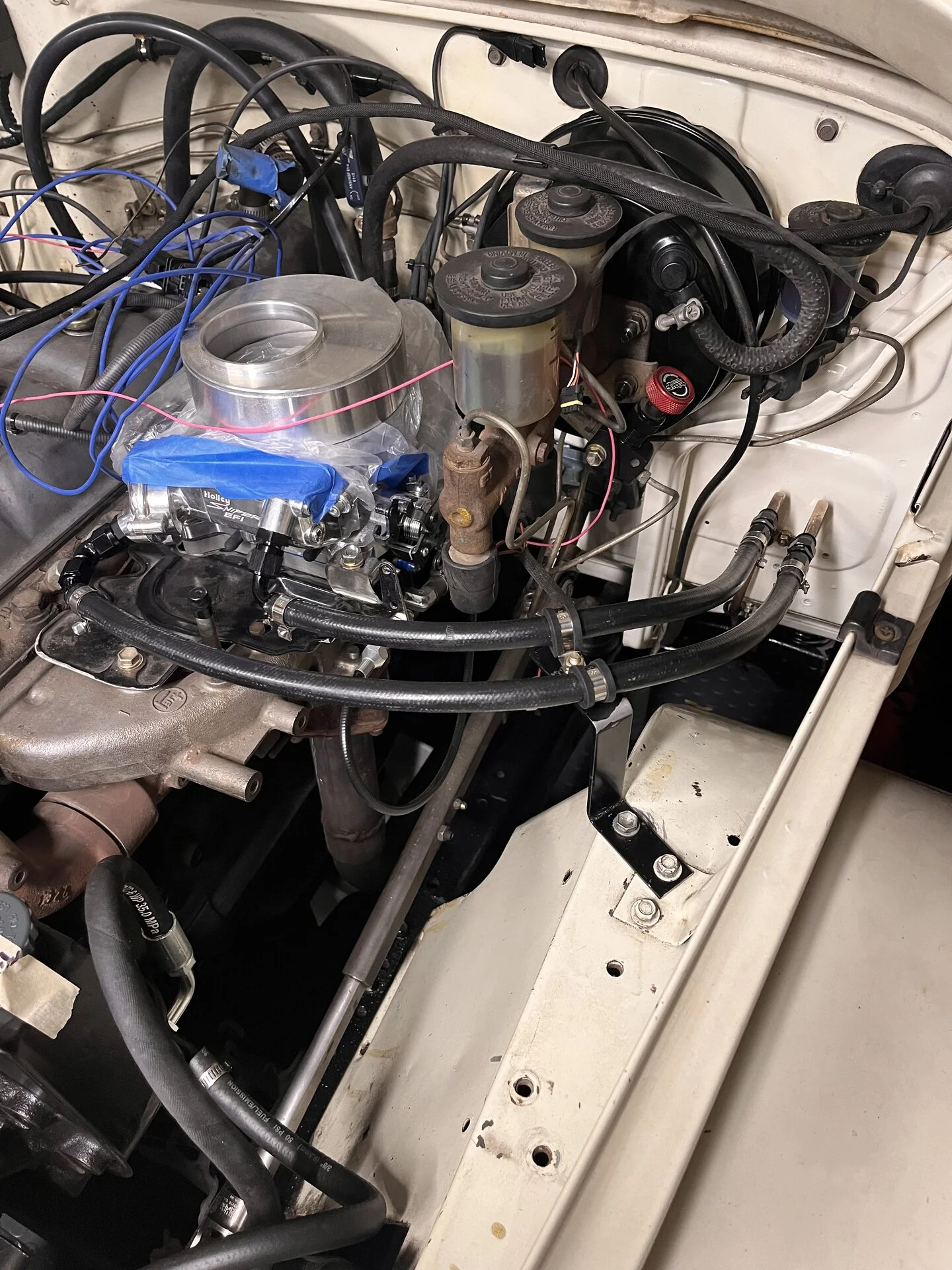

I’m going to start a thread to document the install of a Holley Sniper 2GC to 2F using an adapter I purchased from a vendor here on Mud.
I’m also hoping for some help / advice along the way.

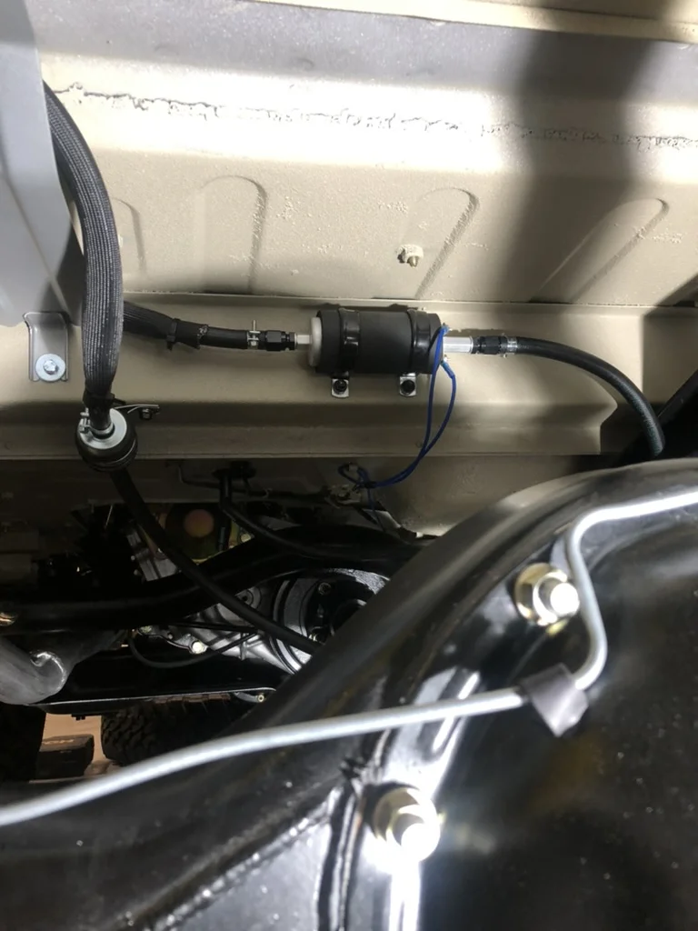

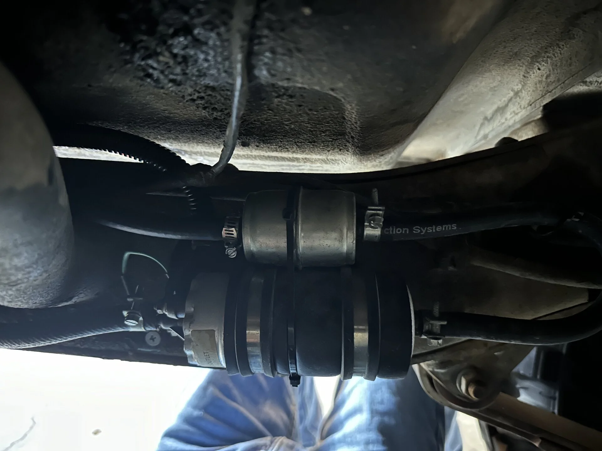

Mine sits on the right frame rail, basically inline with the fuel tank.
Note, I've since ditched the return hard line for a single run rubber line from the engine compartment to near the rear bulkhead location.
Also, when I get the notion, I'm going to find a better way of attaching it to the frame....but 4 years in, it still works just fine for my needs.

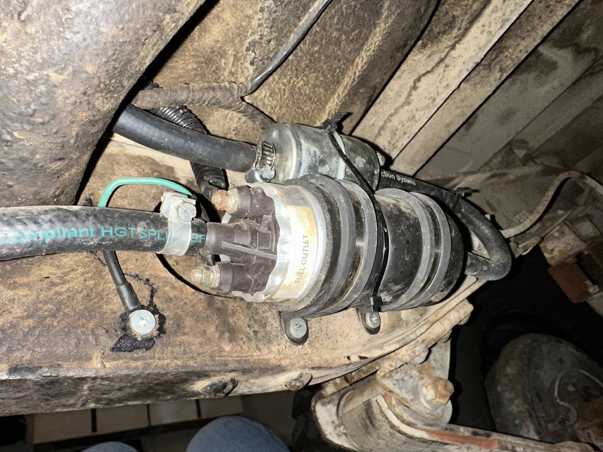

In the tank is best, if you can do the necessary mods. Otherwise, it's best* to mount it below the level of the fuel tank so the pump is never starved of fuel, which is also what cools the pump.
Mine is mounted in what I thought would be the worst possible place: on the outside of the frame in the passenger wheel well. It was temporary at first because I thought it would be exposed to stuff hitting it. But it became more or less permanent as there have been no probs with things hitting it, and it remains easily accessible for replacement when those crappy Bosch pumps fail, which they will if that's what you're using.
* Best ... in terms of cooling and avoiding fuel starvation. But know your tank will drain and create a serious fire hazard if your fuel lines are breached.

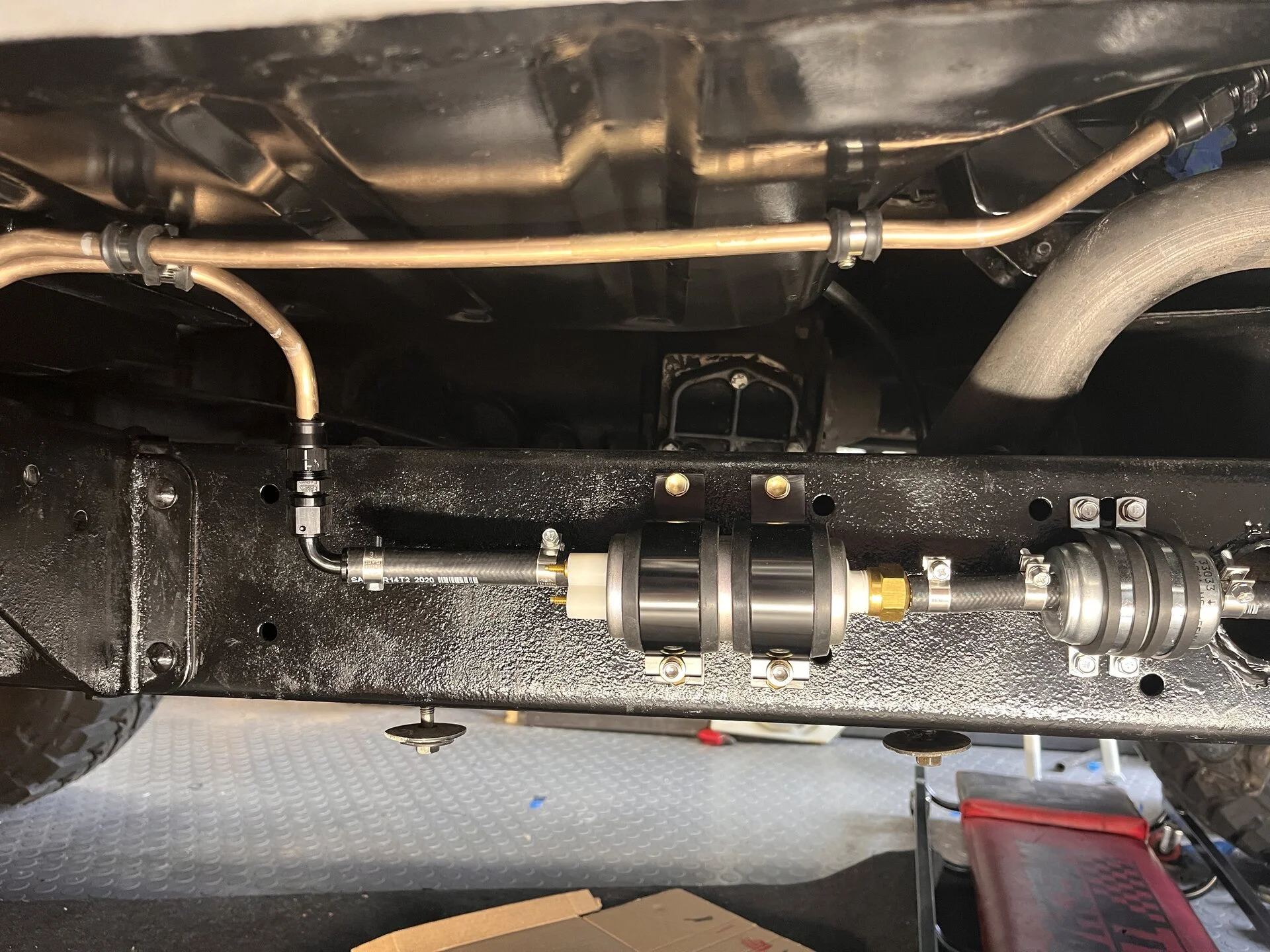

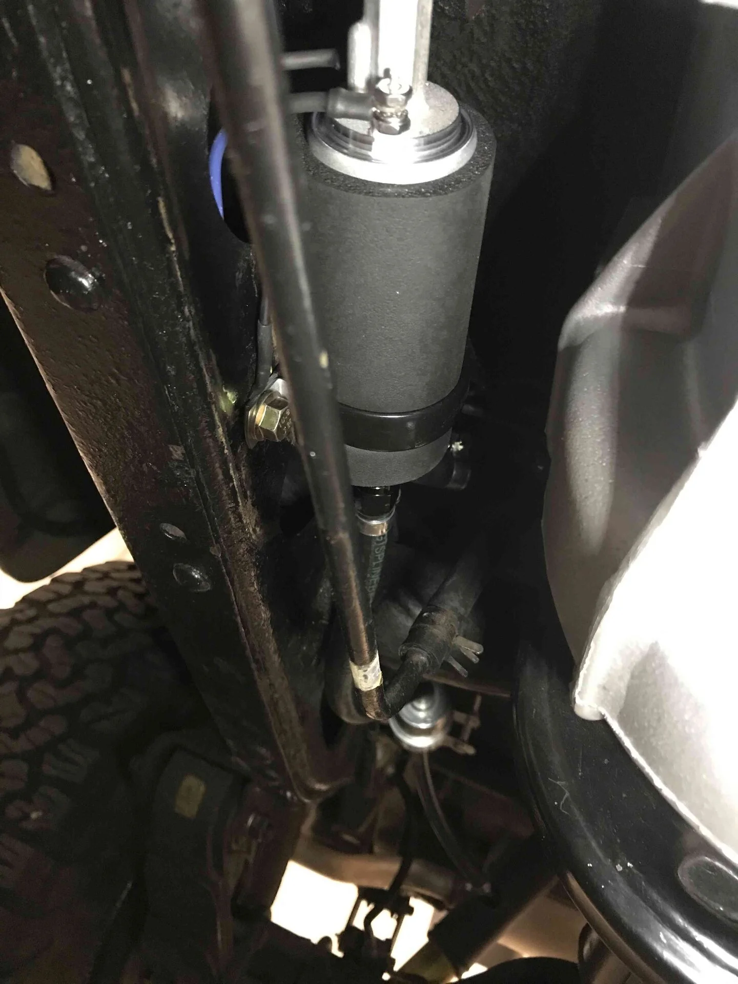

Here’s where I put mine on a 79. My exhaust is on the other side of the frame rail. I plan to extend my skid plate to provide some protection for it.
Thanks for your photo, this looks extremely clean.
Is this on the outside of DS or PS frame rail ?
It’s driver’s side. It’s a lot more direct on 79+ 40s to route along the driver’s side.
