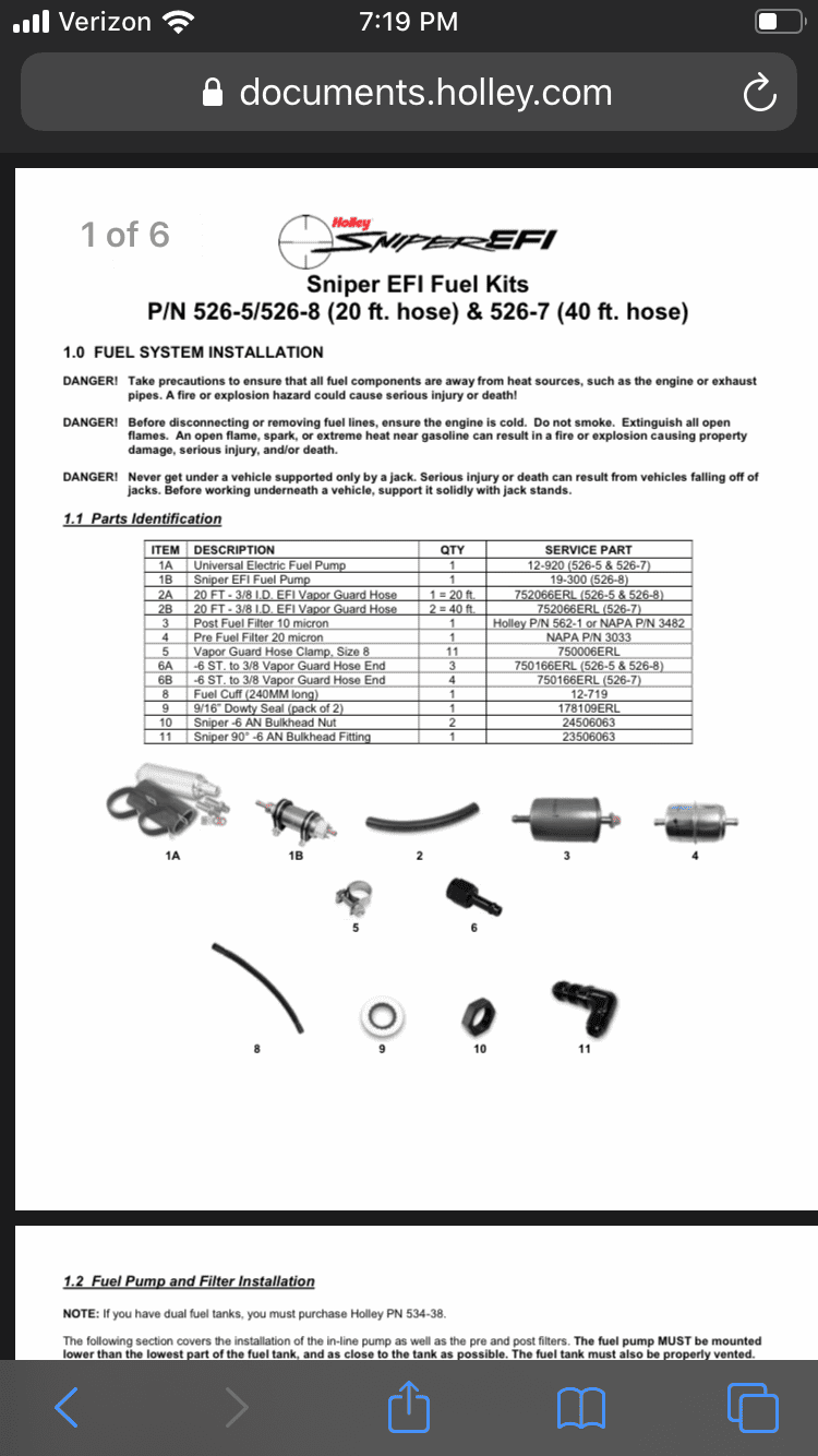

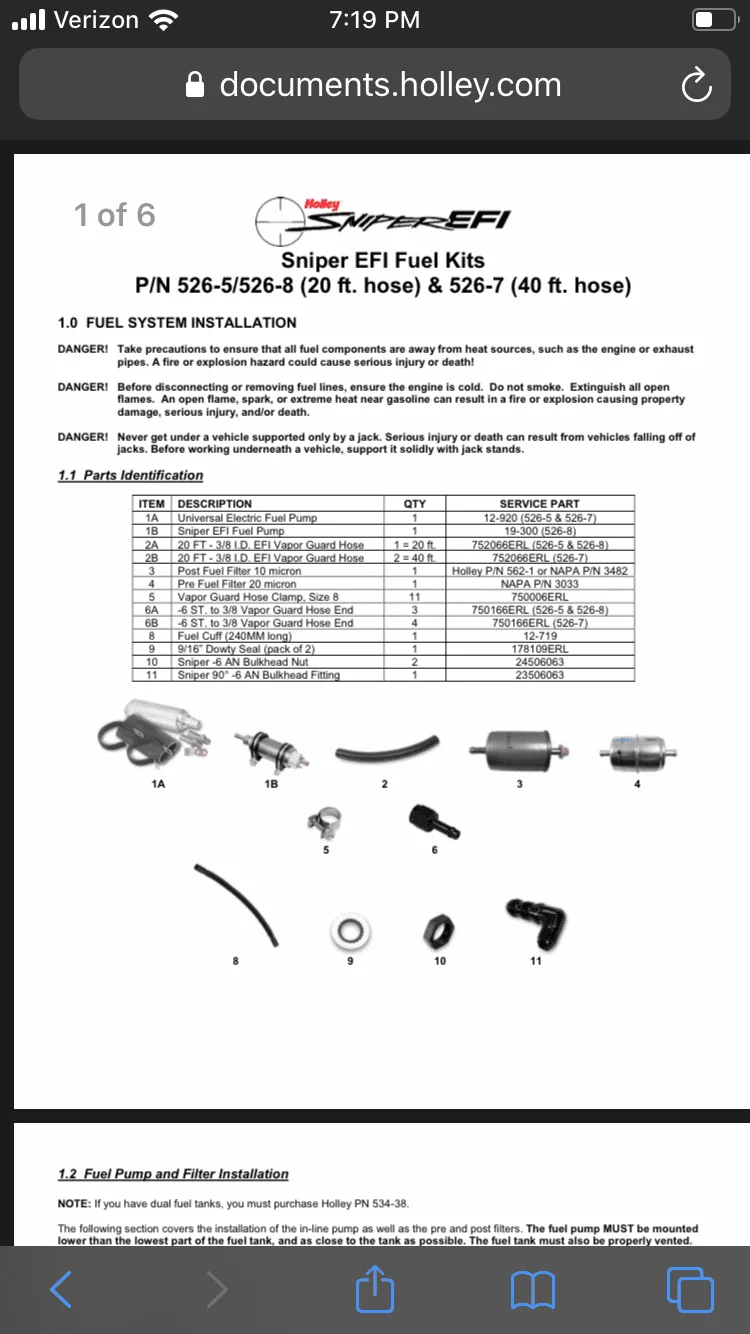

I picked up a sniper 2300 without the kit. I figured I’d piece together. Anyone with the kit have a list of parts included with the kit? I have a walbro fuel pump and some other odds and ends from other projects just want a list to get the rest. Any help appreciated.
I found this,
Holley Sniper EFI Master Kits include everything you will need to get your new Sniper EFI throttle body setup and running on any of your vehicles. Master Kits include 20 feet of 3/8" EFI fuel hose, in-line electric fuel pump, pre and post filters, return bulkhead, and all of the needed fuel fittings and hardware to get your system plumbed, wired up and running in no time.
Mine also came with the Clamp-on Oxygen Sensor Bung.

Thanks for the info. I found the list on Holley site.

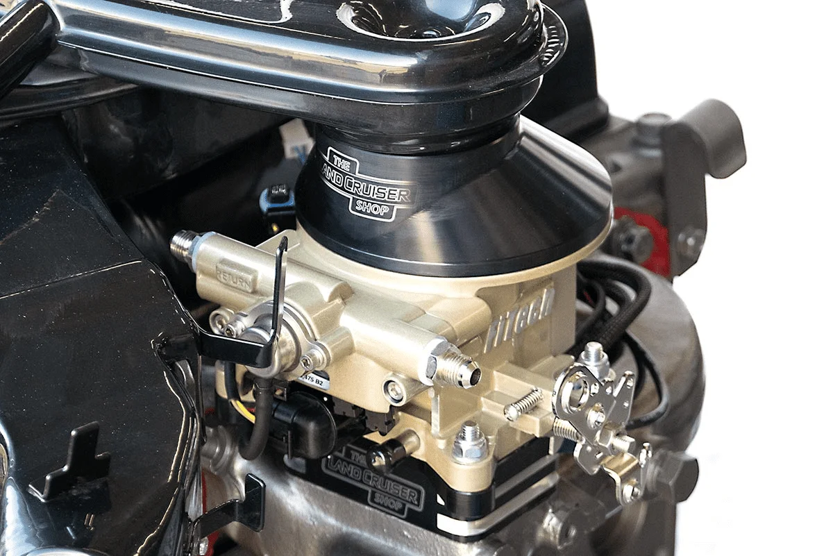

One issue with the sniper fuel kit is the fuel fittings. They don't work with the way the tbi sits in relation to the fuel line routing.
You will need to purchase two fittings.
One 45 degree and one 90 degree. You can also choose 2 45 degree fittings.
Otherwise the return fuel line kinks against the intake manifold.
The feed line is okay, but I prefer the 90 to get it looking good and in the right direction.
Also prepare to do some electrical work.

With the Sniper 2300 install, I've seen where the OEM carb base insulator is used and more photos of it not used. What is the general consensus on the use of the carb base insulator with this install? Maybe it depends on the year or setup?
I never had one to start with or I would have used one. it would not hurt with the heat that incurs at the base of the manifold. But I have had no problems with out it 2 years now.
JP
The carb base should be used.
Especially one with the insulator attached. It helps with placing the tb high enough to clear all possible interference issues like the accelerator linkage, fuel line routing, as well as getting it further away from the heat of the manifold.
Also, if you don't use one, the adapter will need to be ground down to clear the inner mounting bolt for the exhaust manifold that runs through the intake manifold.
My insulator has the hook up for pcv hose. Where does that hose go if no insulator?
