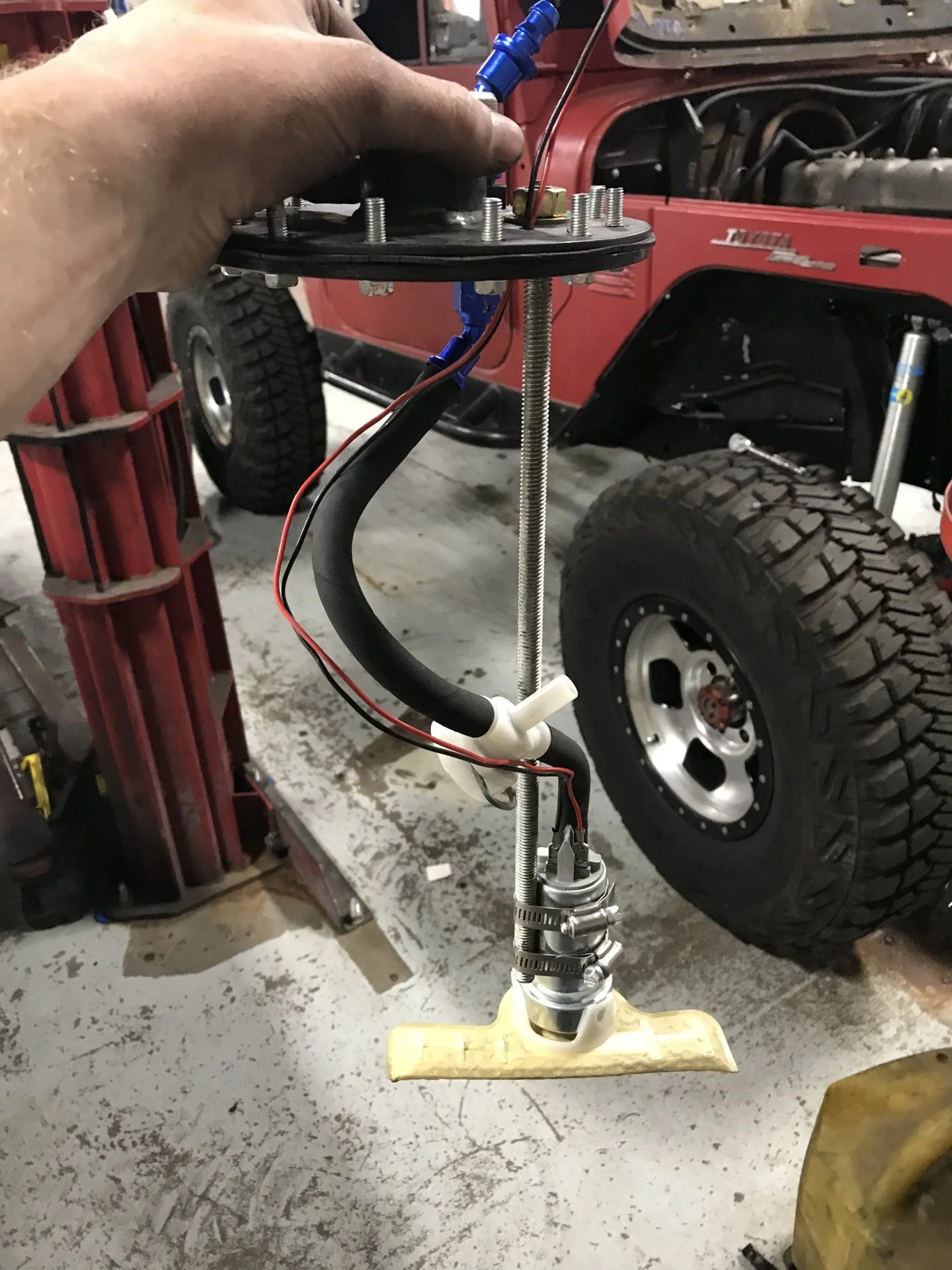

I am finally going to get my 72 fj40 running right. About 6 years ago i built a tbi setup and have never gotten it to run quite right. So I gave up and picked up a sniper kit.
Hoping to have it at least running by Friday. I built an in tank pump for my aftermarket fuel cell. I’ve had nothing but problems with in-line pumps.
I’ll be using my stock distributor with mechanical advance. Hope to upgrade to an fj60 distributor in the future ao I can set timing control up.
Nice. I have been waiting to see someone e use the new 2 barrel version. I have heard nothing but good things from others that have installed the 4 barrel one.
Make sure that hose is rated to be submersible.
Glad to hear that! I am looking forward to it. It is submersible -6 pushlock aeroquip line. I actually ended up using that throughout the fuel system.

How does the return clear on the outlet? Are you going to use the throttle body regulator or perhaps an upstream regulator and cap the throttle body return? I was looking at Holleys returnless in tank pump kit but that’s $500
Hey Ryan, it is the original F engine for my 72. That’s one of the reasons I wanted to post this because F engines don’t seem to get a ton of love.
I have to get the adapter and throttle body bolted up and see where everything lines up, it’s going to be a tight fit for all of it. I may have to built a spacer to raise the throttle body to make more clearance.
