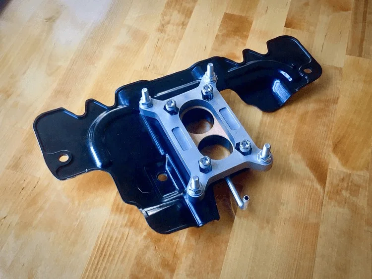

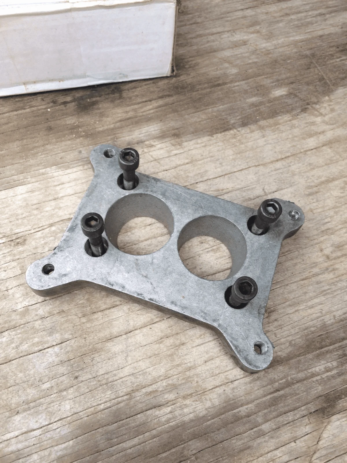

My question about the adapter & OEM base base insulator (post #176) was/is because of the thickness of these adapter plates:
Downey Plate? (use the OEM carb base insulator?)
Downey adapter: (use the carb base insulator)
Redline adapter: (doesn't use the base insulator?)
Mosley's adapter: (self exploratory)

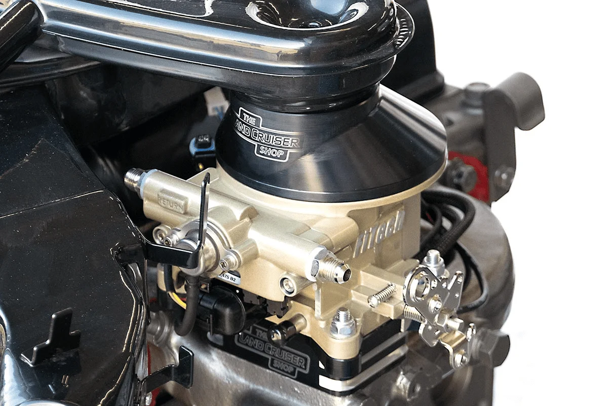

The Land Cruiser Shop's adapter: (self explanatory)
Based on the findings, the use of the OEM carb base insulator is determined by the adapter that one chooses to use?
Yes, you are correct...

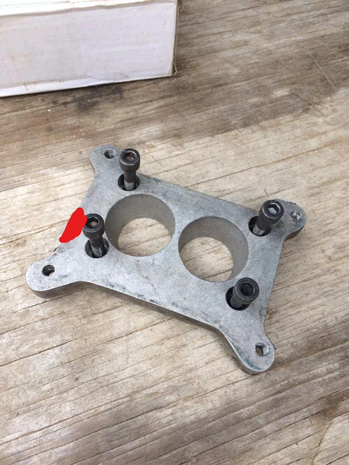

But if you choose to go with just an adapter bolted straight to the intake manifold, then you will need to modify the adapter plate by grinding off a small portion (SEE PIC). I also found that without using a spacer you WILL have clearance issues with fuel lines, throttle linkage. and heat from the exhaust manifold.
You can see why the custom options all include some sort of spacer.

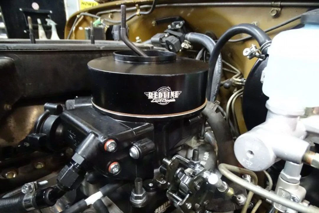

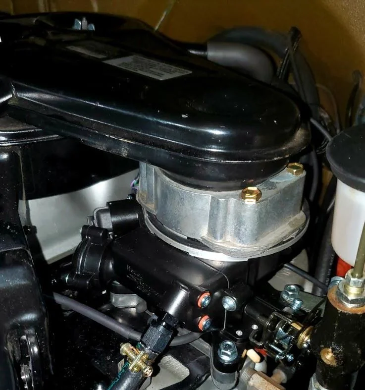

I did some creative thinking last night on what to use for an air cleaner adapter.
I tried making my own, but became flustered, it was going to be abs which is something I wanted to stay away from anyway, and I don't want to fork over big $$ just to have my stock air-cleaner.
So I started looking around my shop for anything that might work... Then I spotted an old aluminum redline Weber carb adapter designed to mount to the top of a Weber carb, and allow the stock aircleaner to work.
I grabbed it and started mocking it up, and to my f'n surprise it works!
I still need to paint it black (its cruddy looking now) but it works if you ad a gasket to the bottom end so you can get a seal between it and the top of the throttle body. I may even locate an aircleaner base plate and have that ad an extra surface to seal against. I also like the way it looks. Not just a smooth round object. (after paint it should really pop!)
It locates the aircleaner perfectly. So its, carb spacer, then adapter, then throttle body, then Weber adapter then aircleaner. This is on my 78 2F.
Here's a pic... And the best part they are about 40 bucks shipped from several retailers.
The part number is REDLINE 99010.743

Just curious a out the bolts on the top of adapter. What do they bolt to? Don’t think there are holes on the sniper for them? Wonder if this adapter will work on earlier 2F setup?
The bolts are there to seal up the 4 holes. I ran a 8mm tap into them and added the bolts. Otherwise air would sneak through them. Also for looks. :)
We decided not to design our adapter to be used with the insulator. Reason being that we were anticipating the same overall adapter to be used for the F and 2F. Also the inner flow design atomizes the fuel better with out any inner diameter step changes or shelf's. Also eliminates 2 extra area's of a gasket leak (Vacuum leak) , One being the mating gasket between the adapter and insulator and the side vac port. We have noticed that the vacuum cap plugs last 6 months before they start cracking.

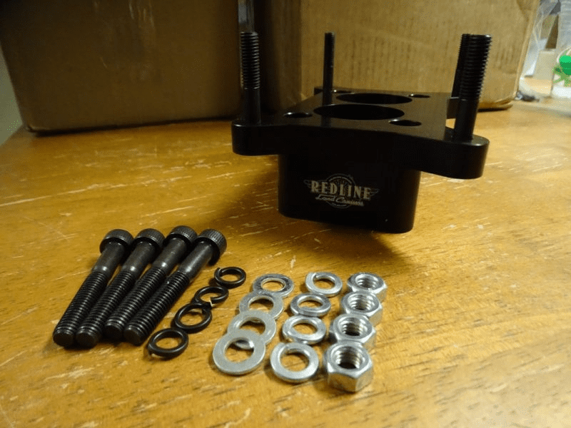

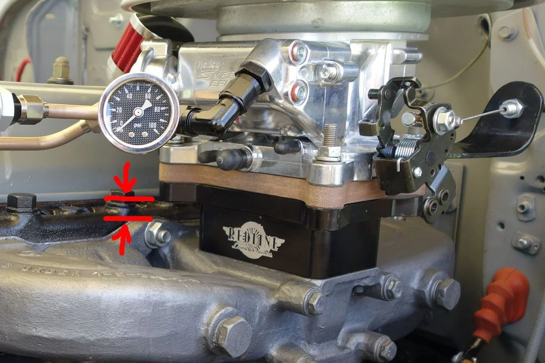

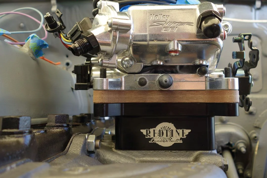

My biggest concern when selecting my setup, was heat getting to the Sniper. What I liked most about the Redline adapter was it’s 2” height. It gives nice clearance between the head and the larger Sniper base flange, (no grinding) and gets the Sniper further away from the heat source. The extra distance gave me plenty of room to install a homemade heat shield. I didn’t want to omit an insulator, so I used a ½” Holley patterned one between the Sniper and the adapter. My stock air cleaner is long gone so getting the Sniper higher worked fine with a simple aftermarket cleaner. I see Redline makes and adapter for the stock air cleaner that supposed to work with their base adapter. Probably wouldn’t work if adding an insulator.

That was a consideration when adding the insulator but didn't know how much it would affect it. Maybe I was over concerned about the heat but decided to play it safe. I guess time will tell. I can always pull it out.
Thanks Steamer !
You are correct on our air cleaner adapter. It was designed with our manifold adapter. So raising the sniper like you did would not allow our air-cleaner adapter to work with the intended 2F air cleaner. We did do some testing and found out that using a factory air cleaner, and air tube will drop the internal cyl temps by 40 degrees!
