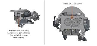

This sounds similar to an issue I had with my sniper in the beginning. May not be your problem but an easy check is look at the passenger side of the sniper, there’s a port with a plug in it. If your sniper is used in a boosted application, this plug is removed so a nipple can be installed to send a vacuum signal. Mine came out of the box with no nipple installed. AFR looked good but the more it ran it got worse. Basically way overcompensating for that big vacuum leak.
