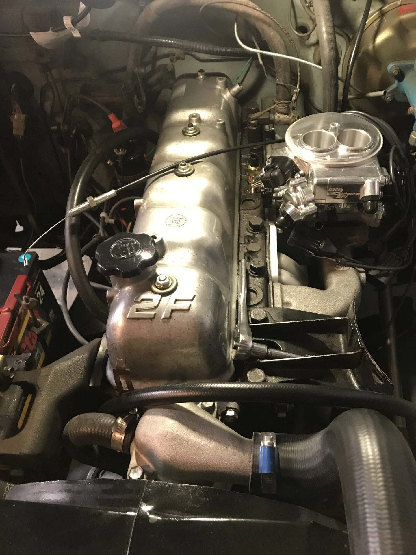

Even with out a header, Carb Insulator or cooling fan the Sniper EFI unit is an improvement to the old F engine. no more cold starting issues, hot starting issues, no more vapor locking and starts right up after sitting for 4 months.
JP
Bummer.....I don't have a set of headers, and there is not a source of good headers to be obtained.
Maybe I'll just stick to the OEM stuff that currently occupies the top of my 2F's intake manifold. ;)
We run the sor header. It fits and is coated. I wish the man free header was still around and didn’t hit the frame in a 40. Sor headers also get close to he oil pan. So wrapping is critical for us.
@RLMS, you ought consider building a header (tri-y, hint hint...) worthy of puting on these old Toyotas...just saying...
I wish I could. @Trollhole he’s used 3fe manifolds instead of headers. They flow way better than a 2f 1 piece manifold.

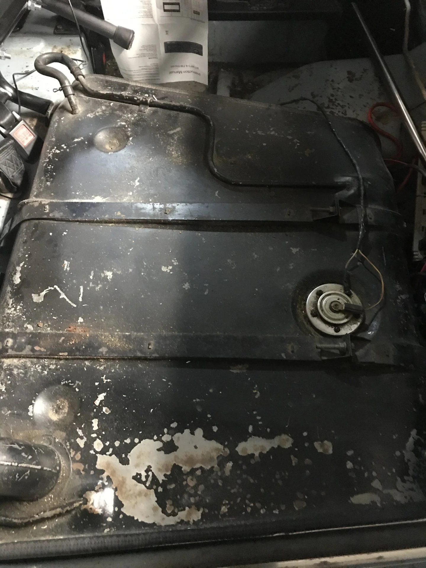

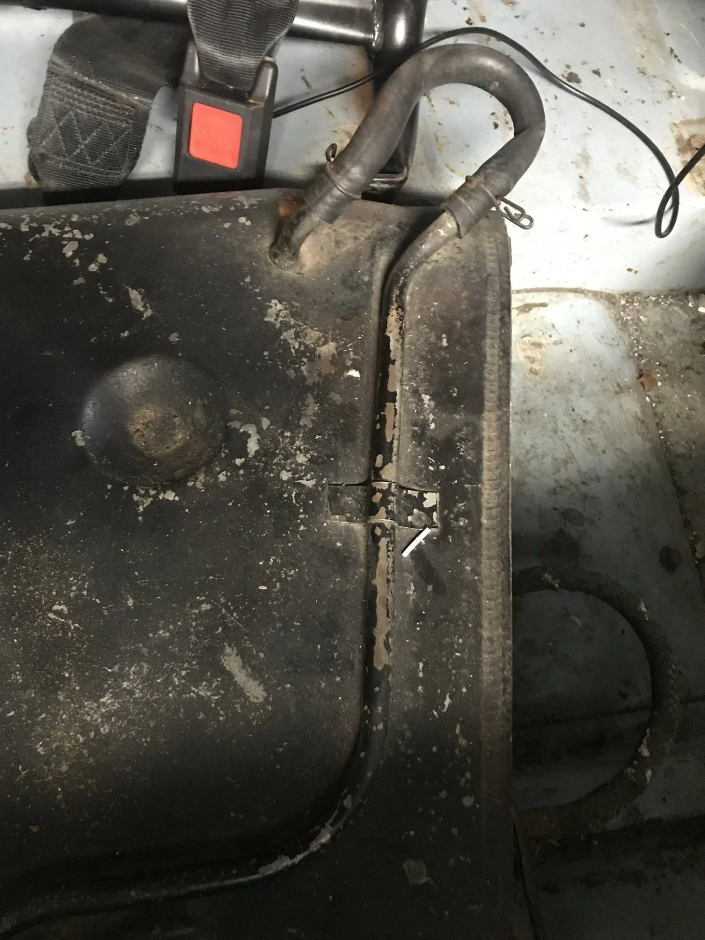

I’m looking to run a return line and since the previous owner seemed to cap the 2 lines on top, wondering which is the return? This is a 71’ with a 75’ 2F.
Those are the vent tubes for the vapor sep stuff. I would run a "in tank pump system". We have a diy kit. just for efi swaps. You would then have to set that up, .... then cap off the bottom factory inlet fuel supply tank side!
Justin
Remember Fuel pumps that sit in fuel last longer, stay cooler, less noise and won't create air bubbles in the fuel/pump.
Justin
Justin
does in tank fuel pump not need a return line? I need to figure out if any of the separator lines can be used for a fuel return. Currently 2 lines near filler neck run to separator. Charcoal canister has be removed by po. the 2 other capped separator lines I guess used to go thru original seats back to the lines that are currently being used. Just wondering if I can run a return to one line
In-tank pump modules will have a fitting for the return.
one port is an outlet another is a return, the bigger port is the electrical bulk head and the other gets plugged.
