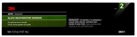

The adhesive I was using was the same 3M super black weather strip adhesive you see in the picture that everyone else is using.... so I believe it's the correct stuff but that's a really good point that the brake cleaner could be causing an issue! I do think I have a solution with the double sided tape though. Stay tuned, I'll be trying at least one door with the double sided tape today.
the weatherstripping glue I used was that worked perfectly was #8011. 3M
interesting and the one I used is slightly different. 3M black super weatherstrip and gasket adhesive part number 8008. I find it funny that they call it super because there’s absolutely nothing about it that is super! More like super sucky!!
I really think that's your problem. Also, clamps not needed. It will set up quickly , waited a couple hours and then I closed my doors for it to dry overnight. Worked perfectly.. Good luck and get rid of that other junk!

Details from the 3M website:
Overview
Details
Resources
Specifications
Customer Reviews
Product Support
3M(TM) Weatherstrip Adhesvie Black 08011
View Images
  • Formulated specifically for use with ethylene propylene diene M-class rubber (EPDM)
  • Forms flexible, waterproof bond
  • Easy to brush and spread right from the tube, saving time
  • Resists oil, grease and solvents for permanent repairs
View all details

Yep, I think I found the reason why it wouldn't stick. I used the 8008 which apparently doesn't stick to EPDM weatherstripping. I found a few other car restoring forums where they mention 8011 worked, but 8008 did exactly what it did for me.... pulled right away.
