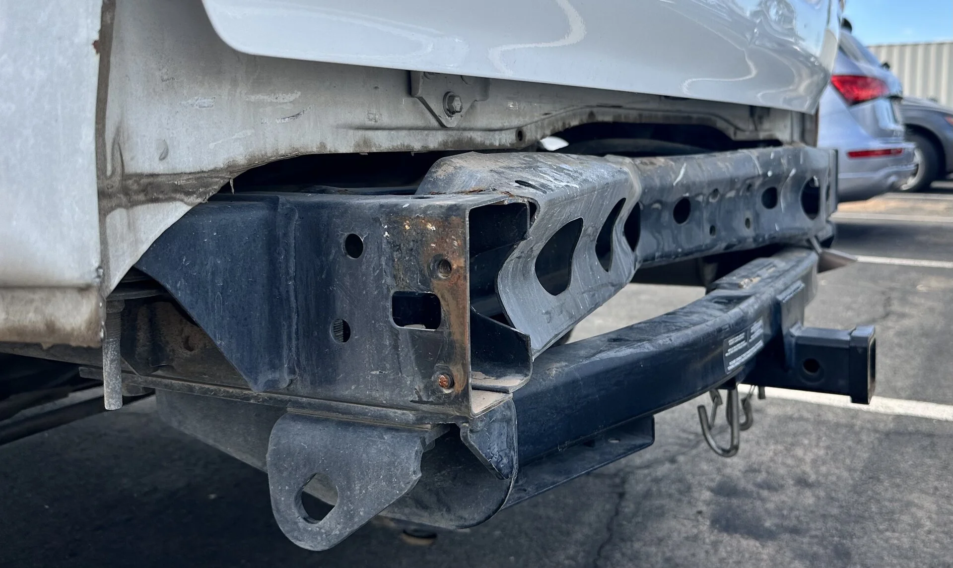

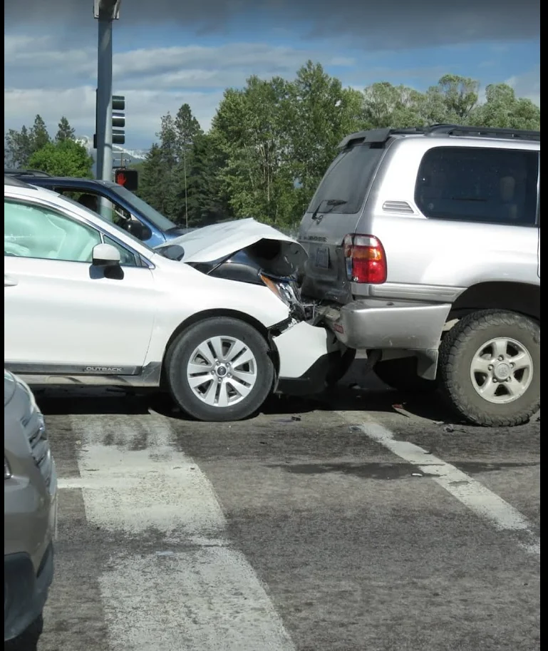

Brutal news: some %#*& hit me at a stop sign and jammed my bumper so hard it bent the frame. His insurance is calling it totaled. The body shop (reputable) said the frame was twisted in another spot.
I am so disappointed, but not sure what to do- other than sell it and try to pry my '07 470 from my wife (that wont be easy, she loves hers).
Maybe just fix the frame on the cheap and then make it a overlander? Curious any other angle I should explore.
From the photo I would say Yes this is repairable. Most aftermarket rear bumper makers require that part removed to make way to mount the steel/aluminum bumper.
You can remove that twisted crossmember frame piece and take measurements. If it is squared you are in luck.
The shop should have measured the frame, and provided that in the estimate. If they did, you can and should get that. It looks like they missed the hitch, which probably braces the frame rails and did not bow the rear frame area, but may have caused the midsection to bow out. Unless the current 100 is pristine, I would negotiate a high price and go get another.

Ask them to show the twisted area. I am sure they didn't even inspect the frame. From the impact, it looks like only the rear cross member is bent, and came off the weld so bending the main frame is unlikely. The rear frame is a box frame and pretty hard thick steel, so I doubt their claim.

Tell tale is the hitch receiver, it looks straight. It helped retain the form of the rear.
I'd want to see pics from more angles, from just the one it only looks like the crossmember, but it could have pulled both end rails inward and you just can't see it on that angle.

I went through the same thing except the body shop didn't tell me my frame was twisted.....New cross member, fancy bumper, and some other parts and she was good as new.

I was at a dead stop they hit me at like 60+ and pushed / bounced me a few feet forward. This was back in 2019. Spare tire + cross member took most of the abuse.
