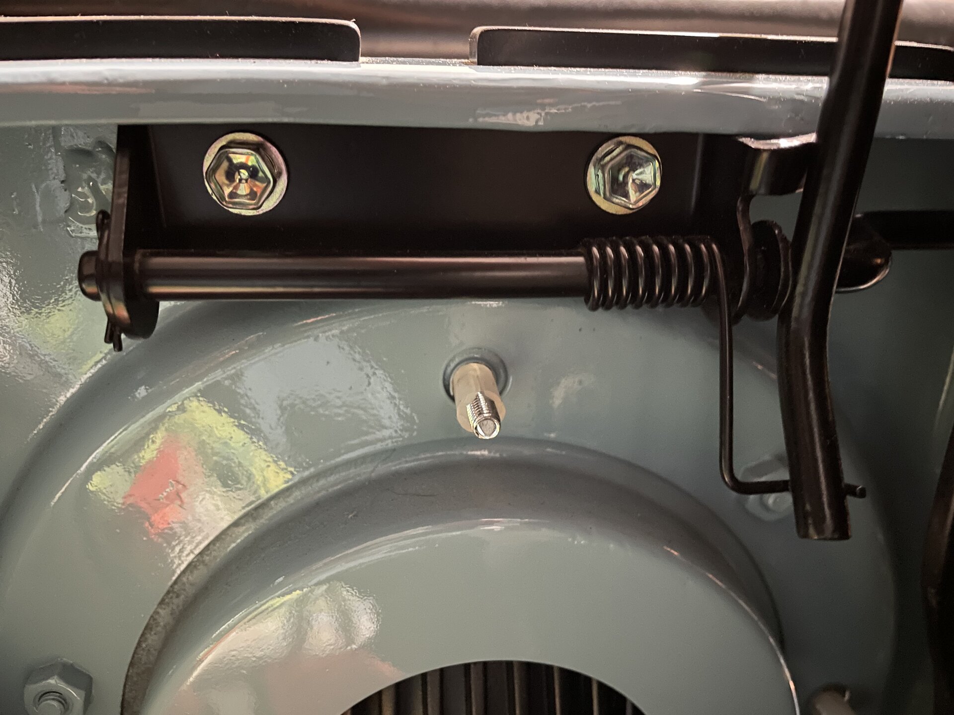

Would it be blasphemous if an FJ40 owner were to add an under hood latch to an earlier FJ40 from an 11/73 and up FJ40?……….Asking for a friend!!
It’s your cruiser, but if it was mine, I do it. F the purists.
Sure is nice having that extra layer of security.

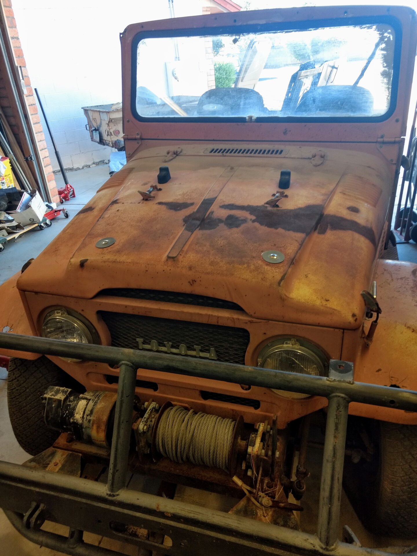

72 model the hood was one piece hood which is lighter that the previous two piece and more prone to flying open. That was 9/72. 11/73 the secondary safety latch was added. Here is my 2/73 which I bought as a future project back in 1994. It came this way.
I left the latches loose on my 68 once. Remember it lifting an inch and dropping. Pulled over and hooked the latches. Pretty sure I had already added one inch of duct insulation which makes the hood even a little heavier. I show 8/76 a change for the hood. Not sure if the is when the flange was added to arch in the middle up front to stiffen the hood if that help or not.
My cruiser is a 11/73 build and it didn’t have the bracket for the secondary latch for some reason and I believe it’s the original for the cruiser. I also looked at the breakdown on SOR’s sight a few years ago and noticed as you mentioned it was add in 11/73. Maybe they still had inventory of the previous product date.
