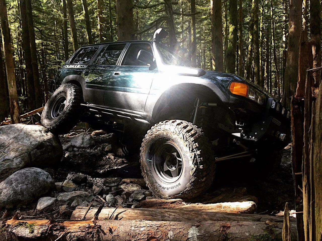

Below pics have the longer 28.5" front shocks which does drop out the coils & the tie rod contacts control arm. There is a couple ways to fix this... so for now the fix is 27" shocks to stop the above problems.

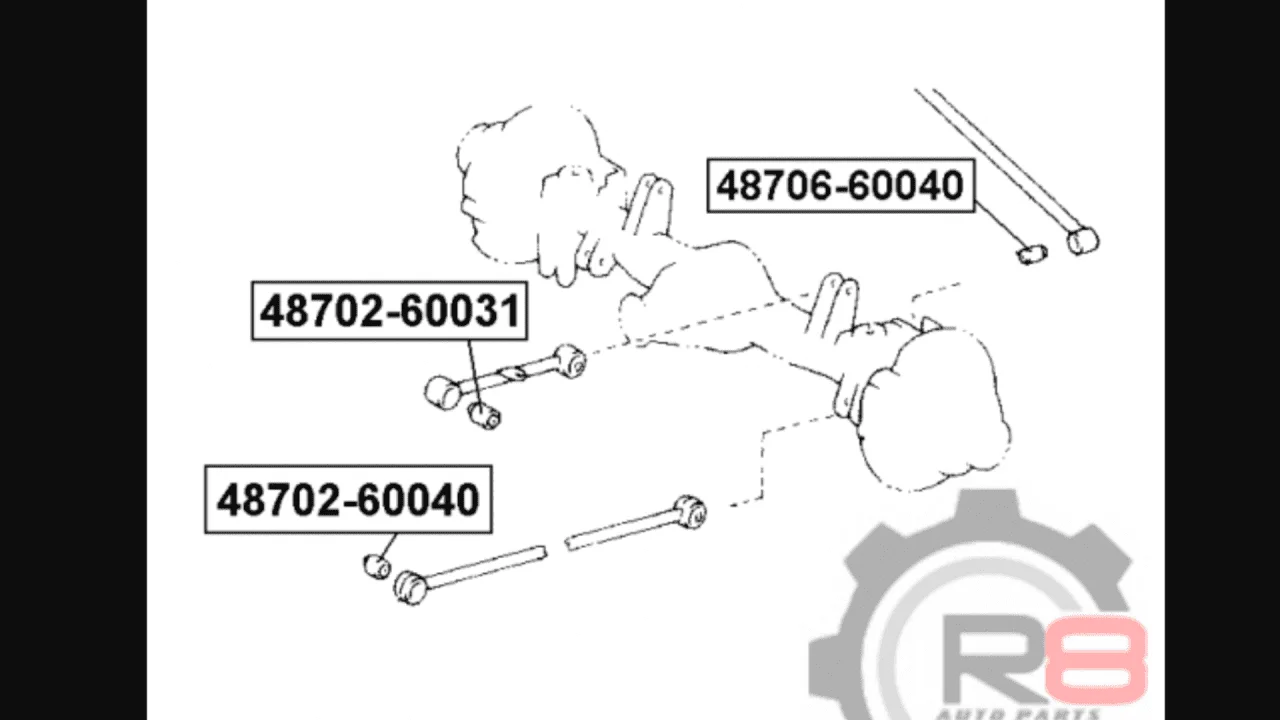

48702 60040 $23
48702 60031 $22

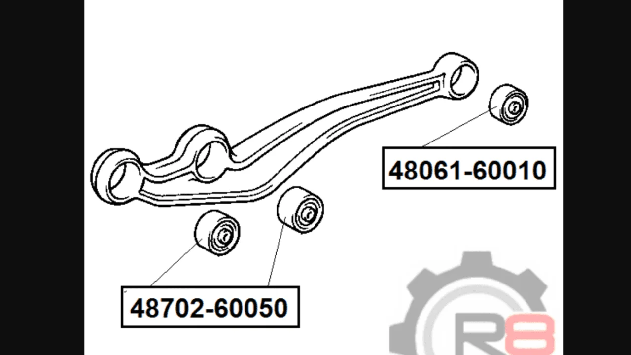

Upper control arm bushings
Search for Genuine Parts - Amayama Trading

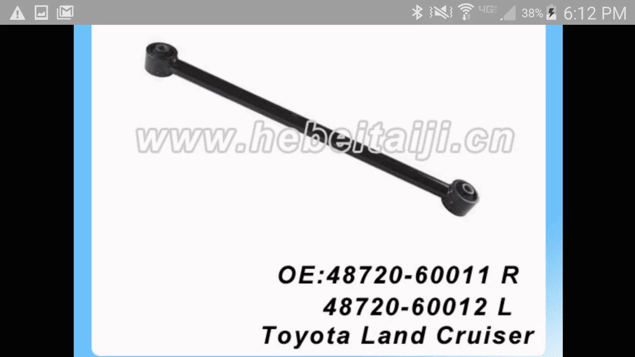

48720 60011 R $116
48720 60012 L $115
ARM ASSY, LOWER CONTROL

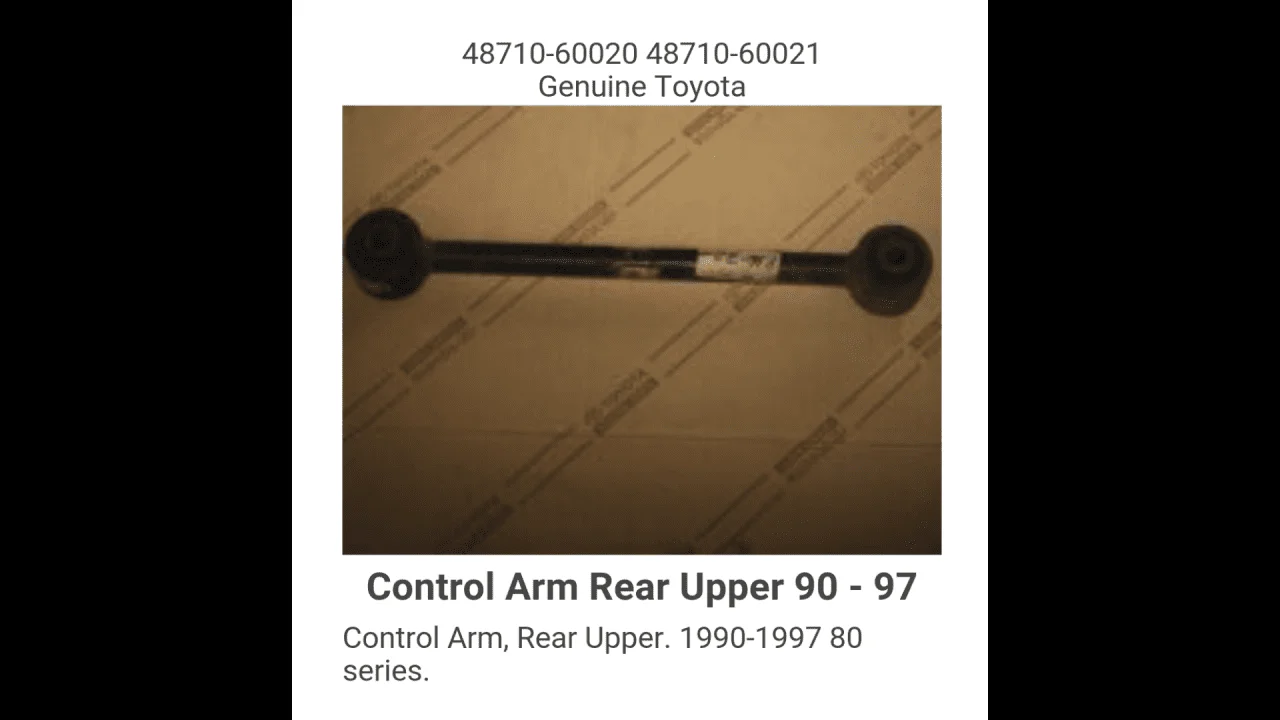

48710 60020 $75
48710 60021 Track rear Control Arm

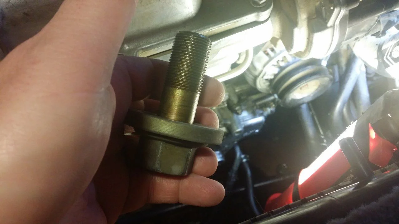

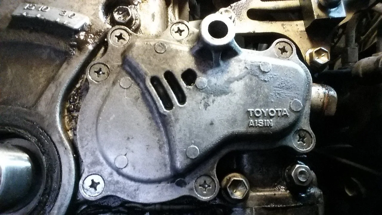

There has been a bunch of thread post on this leaking oil pump repairs going around lately. @1973Guppie is having probs with his crank bolt also. My guess is the changing to the colder weather this fall.
My oil pump just has been just a seap all summer, but now became an official leak once I saw my 1st drip in the driveway. :(

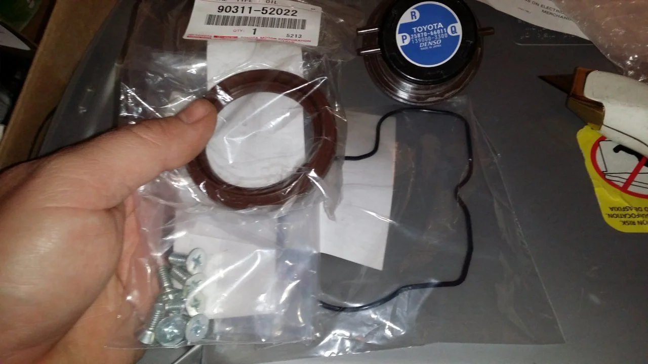

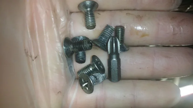

@jcardona1 sent me this awesome vid by @Texasknowhow & this is my next job on the list. I'm not looking forward to this...
Got the parts from CDan. Plus a blue modulator.
Well, one down 7 more to go... I used the starter trick like the video.
Praise the Lord!
I got the other 7... can you tell I was worried?
We are home free, it's down hill from here...
I Got it back on torqued screws to 8 in pounds, but had probs getting the main seal out. I finally got it with a J hook looking tool.
Lexi450 is now back to drive way status from getting kicked to the curb. No more leaks.

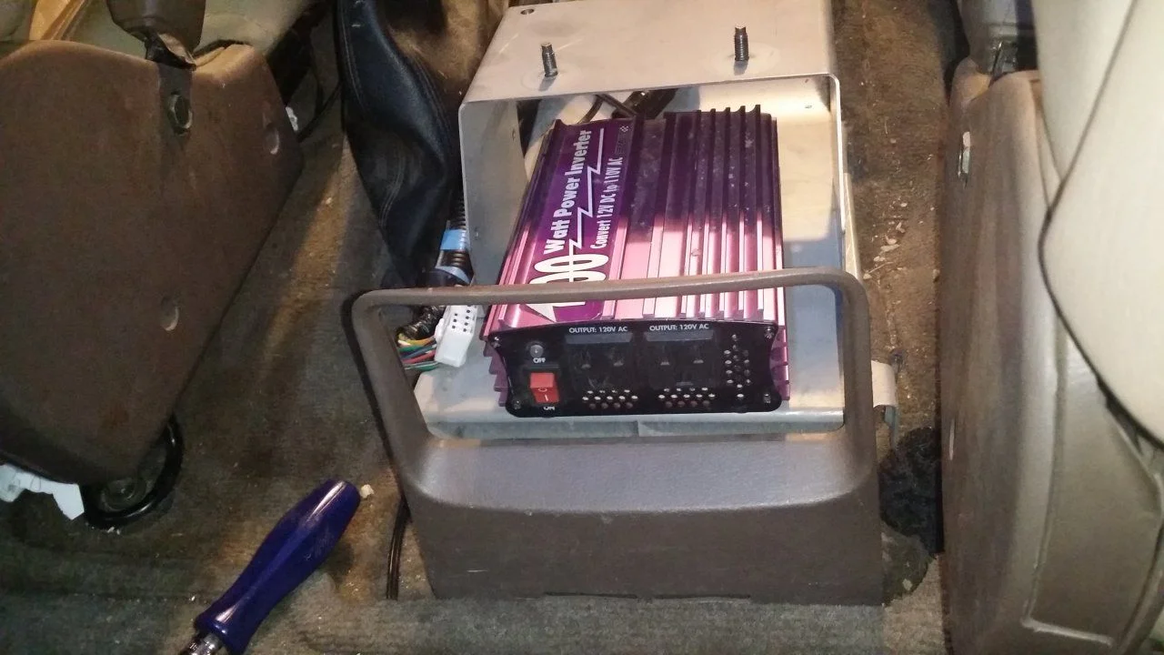

A while back I finally found time mount a 400 watt converter that I've had for years. I took out the Lexus CD player & sub.

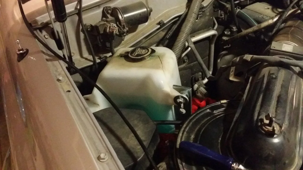

I also relocated my washer bottle getting ready for the dual battery install.

Did everything pull out of the center console pretty easily? i would love to do this mod. also where did you wire the converter too?
It wasn't difficult, about the biggest pain was having to unbolt the passenger seat to get to the last console screw.
taking out the stock CD changer & subwoofer is just a couple screws & those funny Toyota wire clips. As far as the power, I just have a 3 port extension thing for now hidden underneath. Its defiantly not a finished install.
There is a lot of wasted space under there to be used for storage etc... my imagination is the limiting factor.

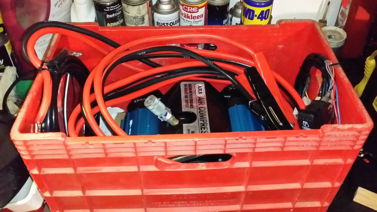

Air comp:
At the time I was researching for the best on board air compressor, there was three that stood out to be the best in my mind. The Puma, ARB twin & the wild card Air Zenith unit. All three where very impressive with destinctive advantages... The Puma is the most economical as a complete unit with 2cfm @40psi w/1.5gal. tank, it just needs wireing, but I just could not get past the fact it would be taking up very needed cargo area. The compact Air Zenith unit is 4.25cfm @30psi & 3.22cfm @40psi. Very impressive numbers for a compact single piston unit. The ARB twin was the most impressive with the highest rating of 4.68cfm @30psi. This was also the most expensive unit. Also I had seen a few threads on mud that several had mounted it behind the rear corner panel out of harms way & did not take any cargo space away.
Just at this time @socallove posted up 8 of the ARB twin units for a very fair price. So good that he sold all 8 within approx. 6 hours of posting. Well I was one of the 8 that got sucked into the feeding frenzy.
At this time I'm in the process of how exactly I'm going to mount it & wire it up. For now I have it set up as a make shift portable unit with a set of cheap jumper cables. It isn't pretty, but will work for now until I can properly get it mounted.

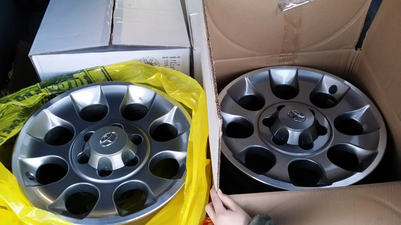

Just aquired these...
Thank you @supertrooper for buying my tires & wheels, your are really going to like them. Here they are ready to ship out at Fastenal.
Can't wait to try them on! 37's are going to look killer on your LX. What tires are you going with?

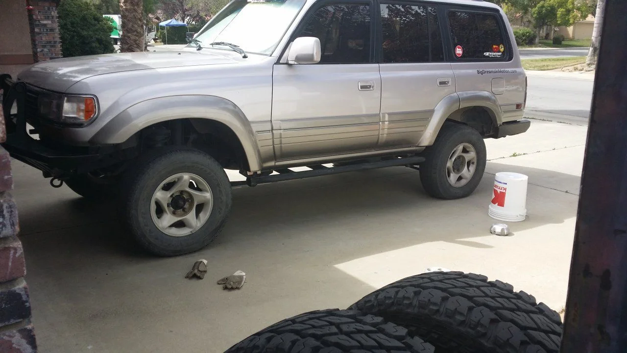

4Ds with J springs, so out of the BOX!
@Apounder it looks like you can reduce your rear bump stop by about an inch to gain a bit more up travel. What do you think?
