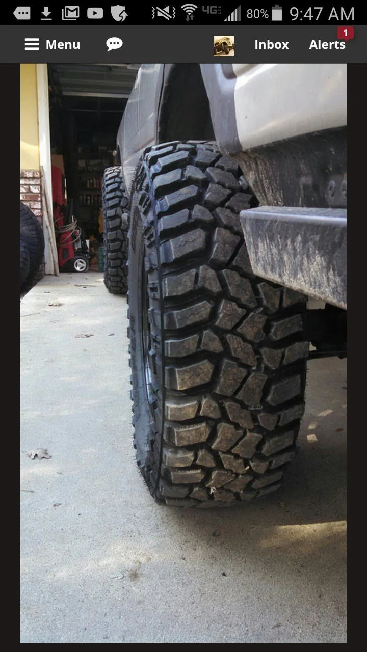

@Apounder it looks like you can reduce your rear bump stop by about an inch to gain a bit more up travel. What do you think?
Starting to get sunny! Negative on the bump stop tire will still come up another 2inches and stuff easily just didn't need the extra articulation in that spot!
Sorry for the photo bomb :D looks like your truck is coming a long! You will get more down travel with the 37s due to the weight if you have any issues not using all of your shocks now!
Photo Bomb any time... @Apounder

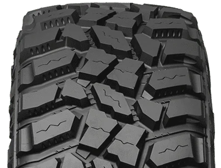

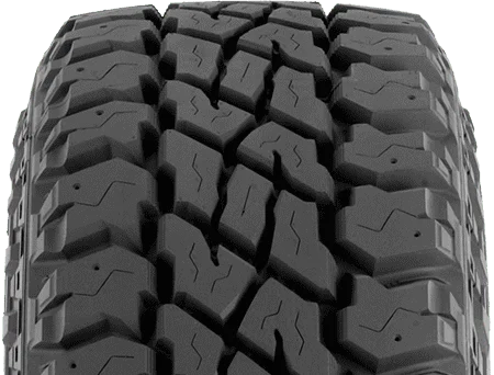

OK all, I need to decide between the Luved ST Maxx or the new STT Pro....
All specs are very similar but the Maxx .25" wider in tread. The rim will be 7.5" wide.
My daily drive is appox 20 miles per day 7,000 per year. My use is mall wheeling & granite rock trails here in the Sierra Nevada's.
The Maxx is a very square tire & in a 37 in might cause some rubbing issues...

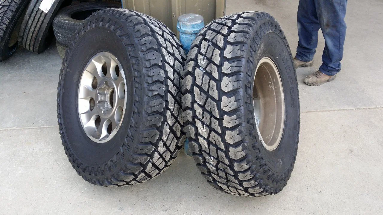

Got 37s?
I just did!

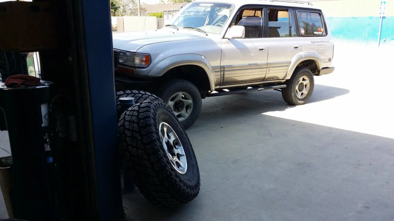

Finally, three sets of tires later in 1.5 years...
I really didn't think they would fit without major modification, so I went 315s.
Since I did a lot of reading here on IH8MUD and found that it was very possible. A shout goes out to all the people who did it before me & documented it here on IH8MUD. I went with the Arizona Boys method of fitment. Special thanks goes out to @Tools R Us & @richardlillard1 .
I choose to go with a 4.9"/125mm back space 4Runner wheel & 1" spacers. They do come very close to everything with some very slight rubbing. With some small tweaks I should be able to flex it out worry free.
I have 2.5" suspension lift with a 1" body lift.
Basically a 3.5" lift. Cooper ST MAXX tires spec out to be a tad taller than the STT Pro.
More info coming... let's go wheelin.

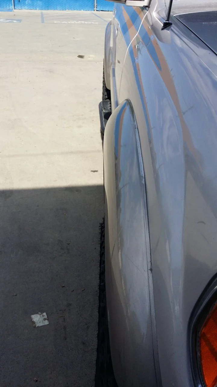

All I have to say is if it doesn't rub then it's about .25" away from doing so, EVERYWHERE!
These pics are with the sway bar on, it does flex much better with it off.
Way better.
At this point I dare not disco the sway until I cut the front fenders or better said, gut the insides of my front fenders. Yes, I will retain the front flares & clading.
Only one other rig I've seen has done this. Here are some poser shots.
Can you say one stuffed 37?
The side wall tread is completely in there.
My right rear (RR) only rubs the top of the fender.
The left rear (LR) is a different story... it rubs in three spots.

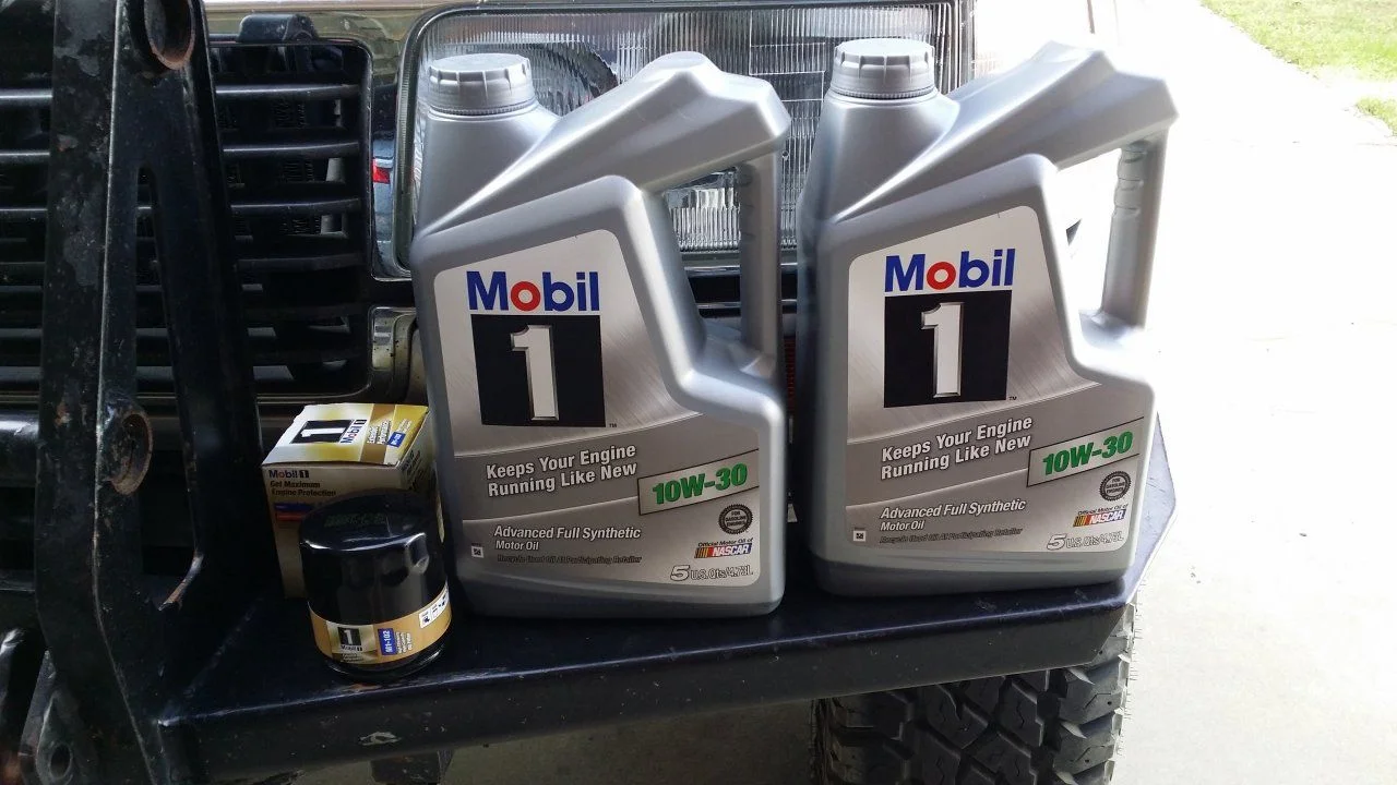

179,020 miles...
Went with the tried & true 10W-30 Mobil 1.
Even got the Mobil filter, it was on sale.
OK, got the front tires to clearance for now...
THIS IS TEMPORARY.
I had to put in some 1.5" front bump stop pucks & use a 3 pound hammer.
I now only have 3.5" of uptravel though, not liking this at all.
To get my uptravel back I will need to cut the fenders.
I'm finding out why the 4" lift is so popular for bigger tires. I would have 4.5" to 5" of uptravel if I had a taller lift. I don't want the taller lift so I will cut & remove the pucks later.
