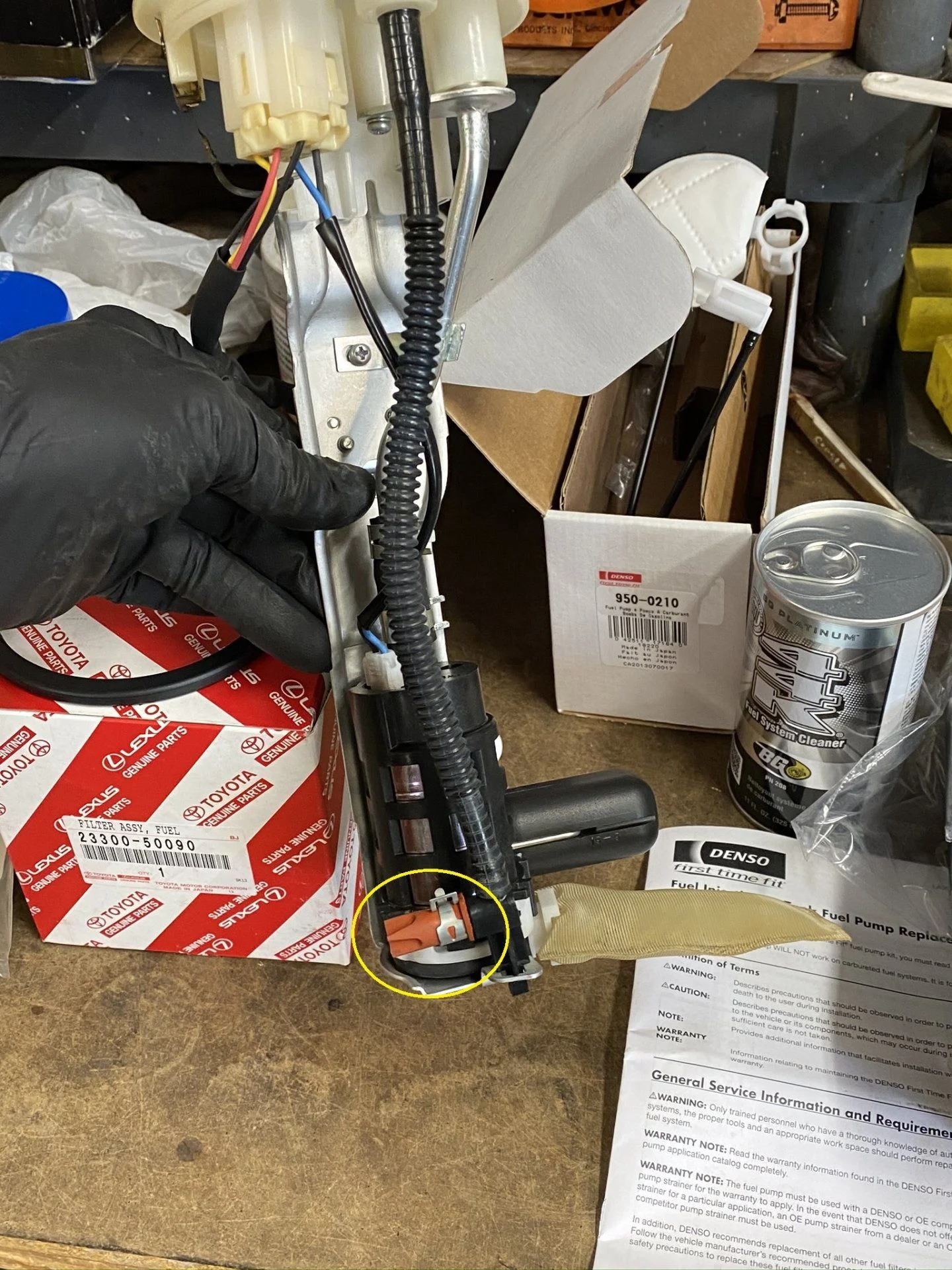

This could be the return tube. Perhaps your serpresor/anti-siphon boot fell off and sound is louder.

Yeah I don’t remember seeing that orange piece you circled in your photo... How bad is it to run without that orange piece?
IDK. It's just a soft rubber nipple, with a slit in the end. Seem like it to would allow fuel into tank easy, but make difficult to come out or rather back into the return line. It likely has effect of deadening sound, as fuel passes somewhat restricted into fuel tank.

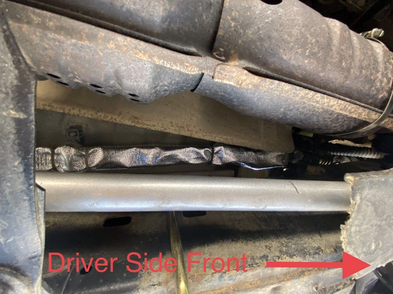

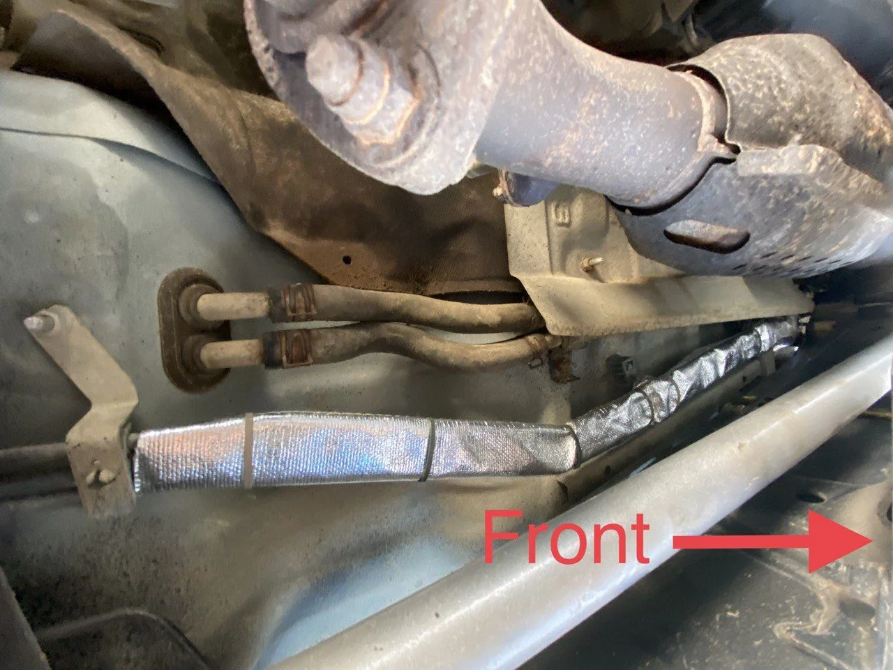

Thank you so much for documenting your progress addressing this issue. I've been following pretty closely and built a heatshield as well based off of your process. I tried drilling the last screw closest to the engine bay, but could not reach it. Did you just drop the heatshield and install the sheet metal off the truck? Also, correct me if I'm wrong, but aren't you just wrapping the AHC lines here? Arent the fuel lines running higher? Did you happen to take pictures of how you wrapped it? Thanks!
No, the lines shown in my photo are the fuel lines, the AHC lines are above and have a black coating on them already. I was able to drill all of the holes with everything in place on the truck. I used on of these super-handy 90 degree drills: https://www.amazon.com/Bare-Tool-Milwaukee-2415-20-12-Volt-Cordless/dp/B002SQK996/?tag=ihco-20

On my truck '05 LX, the fuel/vapor lines are higher & run next to each other. So 4 lines all next to each other (2 going 2 coming back).
It was easy to just take the original heat shield off & attach the new one & then just reinstall. Although I did mess up the holes alignment & drilled 8 holes where I only needed 2 ( Don't ask how, I have this knack).
I also applied heat shielding on the return lines in the engine bay, in the hopes on reducing heat to the tank.

That's what I thought - that the fuel lines are the 4 lines running in parallel with each other, because when I traced the two larger lines it routed to the AHC globes - same with the passenger side. Glad the heat shield was easy to take off, I was worried that if I took them off, it would be a PITA to put back on. Thanks for the info, did the shielding end up helping for you? I have yet to test at altitude

Photos of my poorly executed fuel line wrap:
