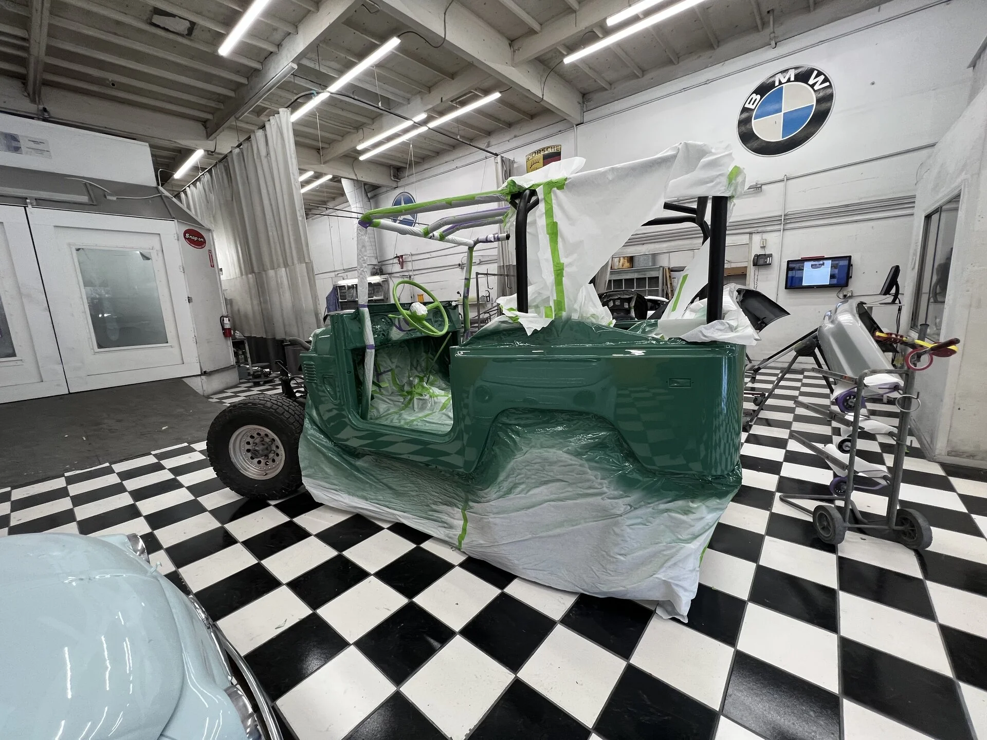

Hi there -
I've got aftermarket front fenders from CCOT and am having them painted along with the rest of my tub. The body is painted and the top of the fenders have been painted - and we are getting ready to handle the underside of the fenders.
Originally I was planning on having them painted to match the body - as was in my original scope and plan with the shop - but now the shop is telling me that with all the bracketry underneath they won't be able to get a 'clean' paintjob and that it will get chipped up and look s***ty after not that long on the road. They are pushing for undercoating - to effectively black out that area so it disappears when viewing the vehicle since it would blend with the black frame rails etc.
What are your thoughts on this?
I've gone with Judson Green - and am very happy with how their shade mixed up.
Toyota managed to do a decent job of painting the underside of the fenders, as have a whole lot of paint shops. I don't understand why your's can't seem to do what so many others have accomplished?
This is where my thoughts are currently residing. The shop has a great reputation and I've had other paint work done there with excellent results - but this if the first time they're working on my FJ40 and they haven't done too many of them. I think that they're simply 'over it' and wanting a cheaper/faster way to the finish line.
For those that have had their inner fenders painted (vs. undercoated) - how as it held up?
Thanks for any/all feedback/advice.

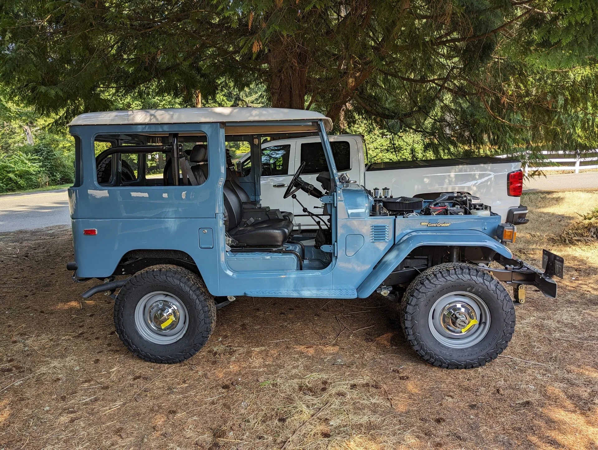

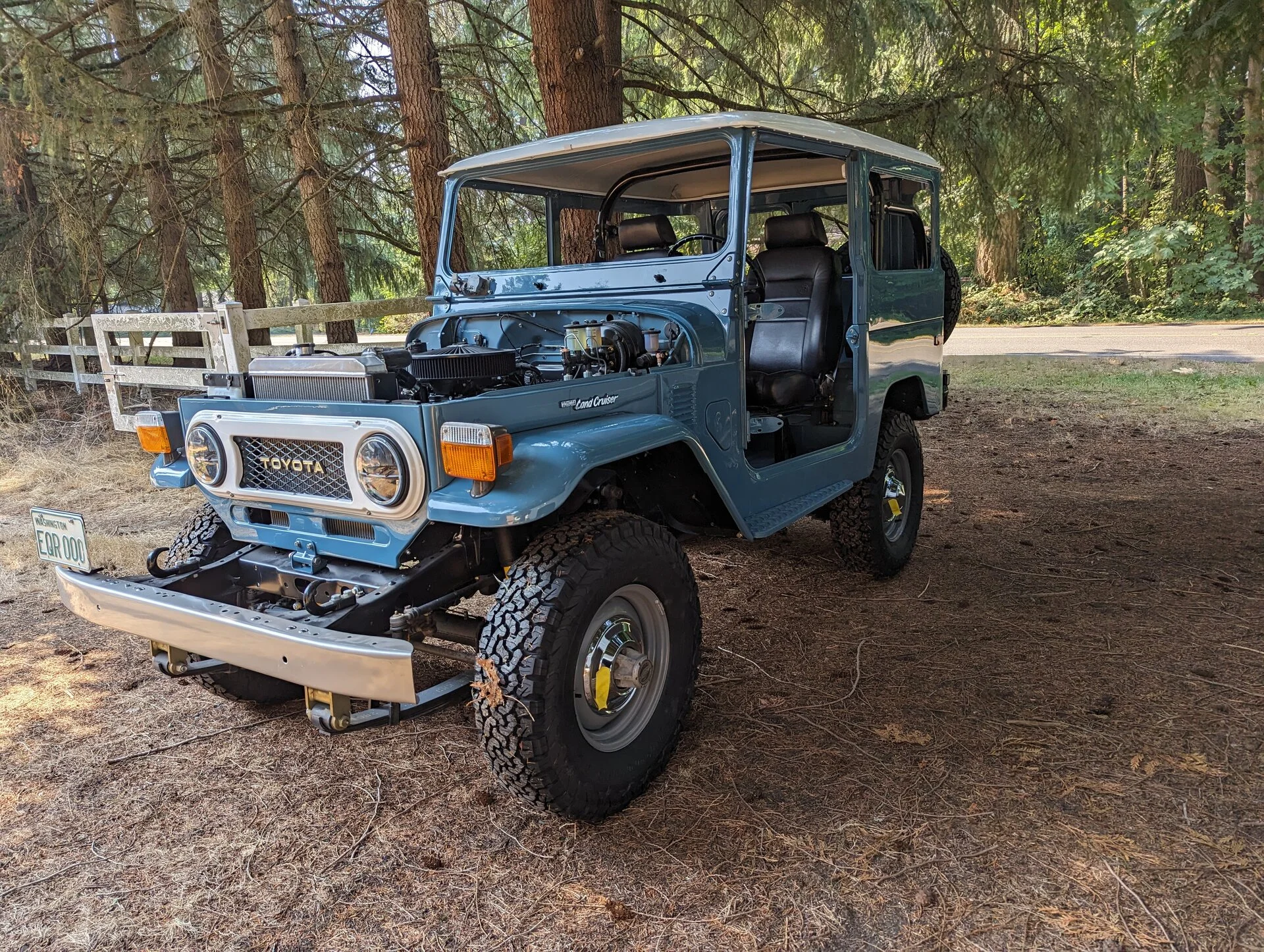

@Pierps said: "...clearly I'm in the minority here".​
A comment from a majority member: not original, for sure, great paint/restoration job though!
Guess the V8 conversion works great too...

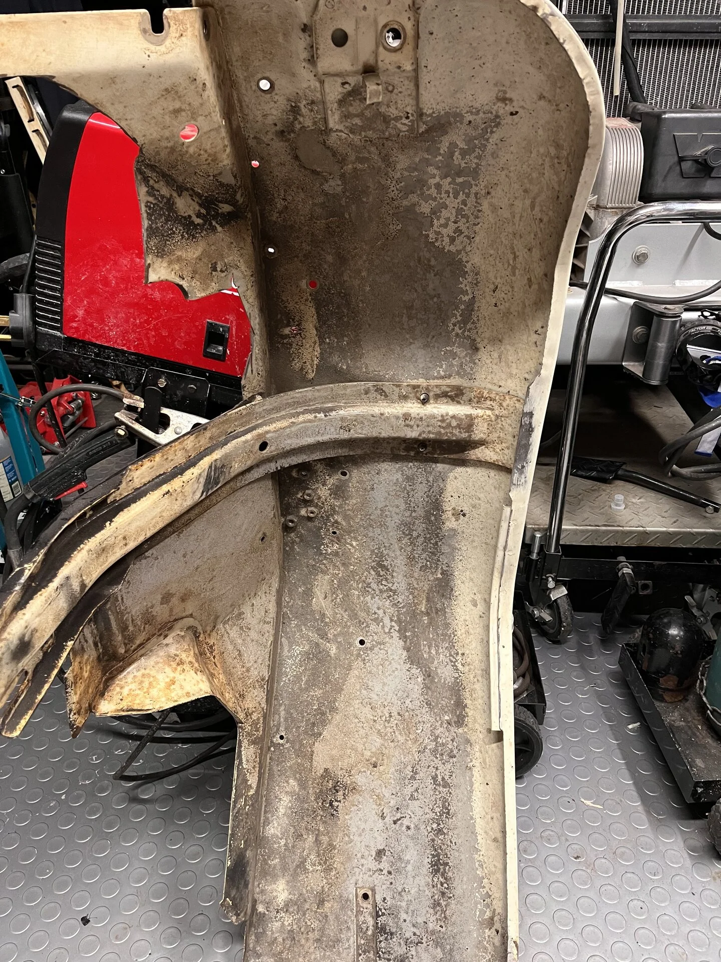

This is the underside of one of my stock fenders (‘79). Depending on what type of roads you drive on, it will get chipped up. I already refinished the passenger fender and went with black and when it gets chipped up from gravel roads I will spray it with some more black.
