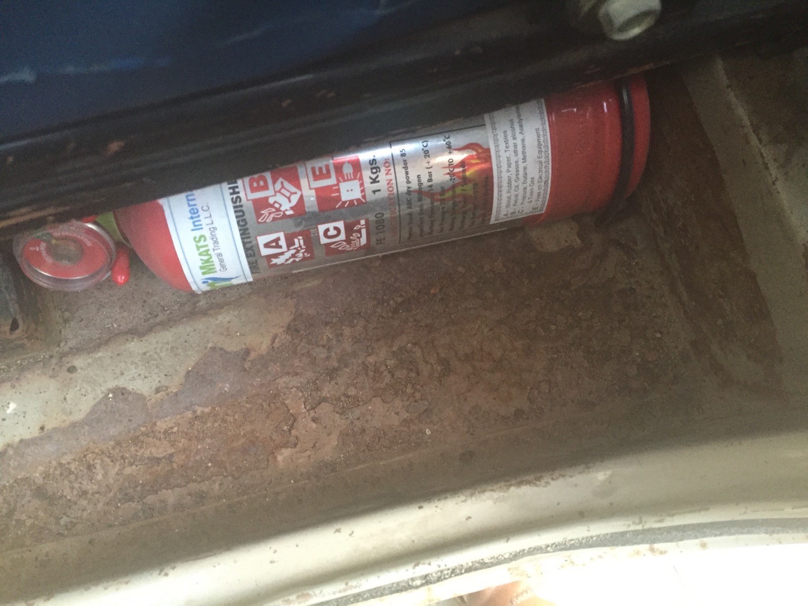

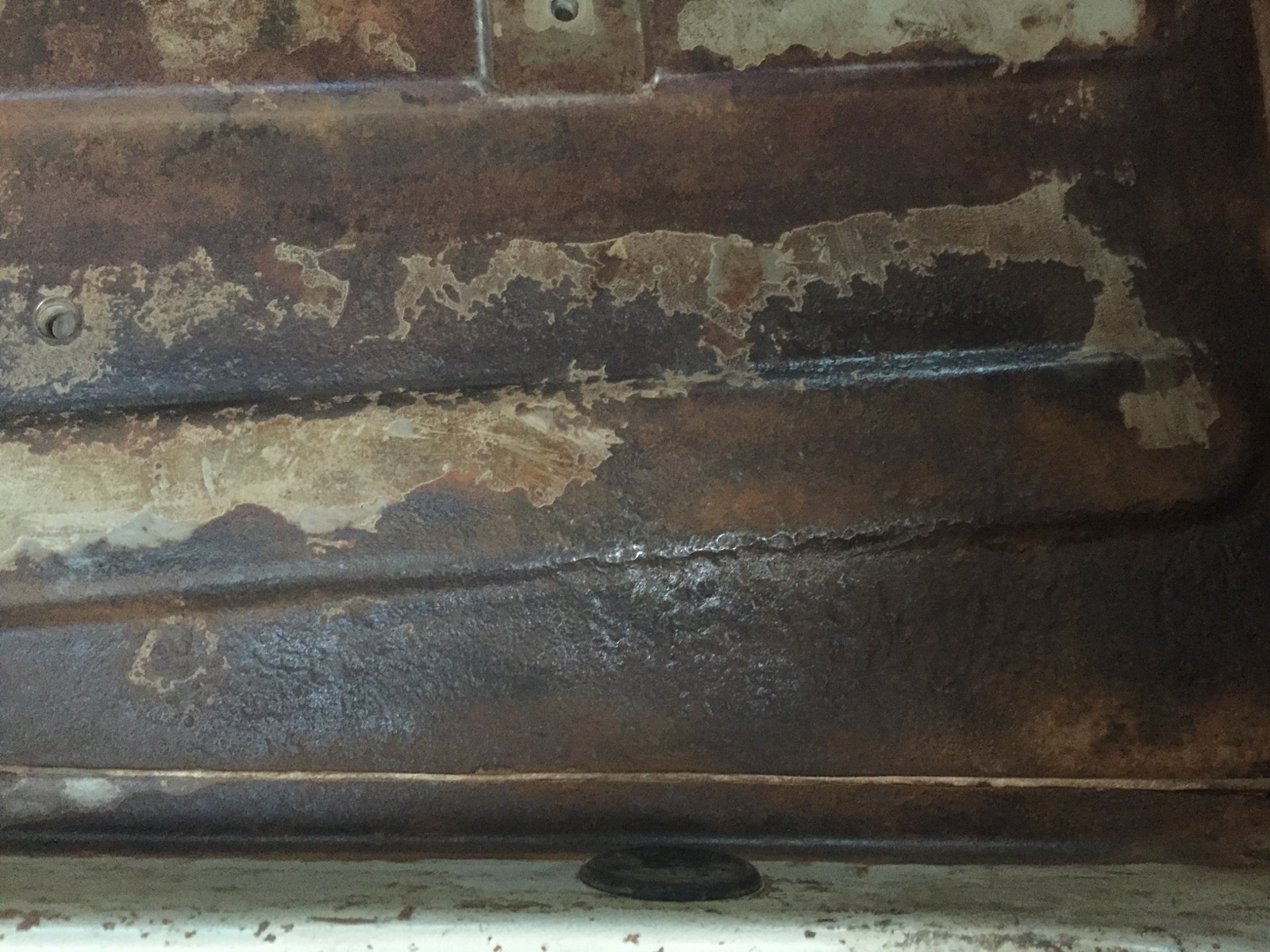

Funny you'd mention something like that. I've owned it a bit over a year now and it's time to button up the rust. Now that I've relocated this beauty from an arid desert to a coast desert the surface rust is much more aggressive... and I don't want it to get ahead of me. As it is there are two areas with problems. One is the rear-sill... it has a mild blistering starting on the drivers side. Easy fix.

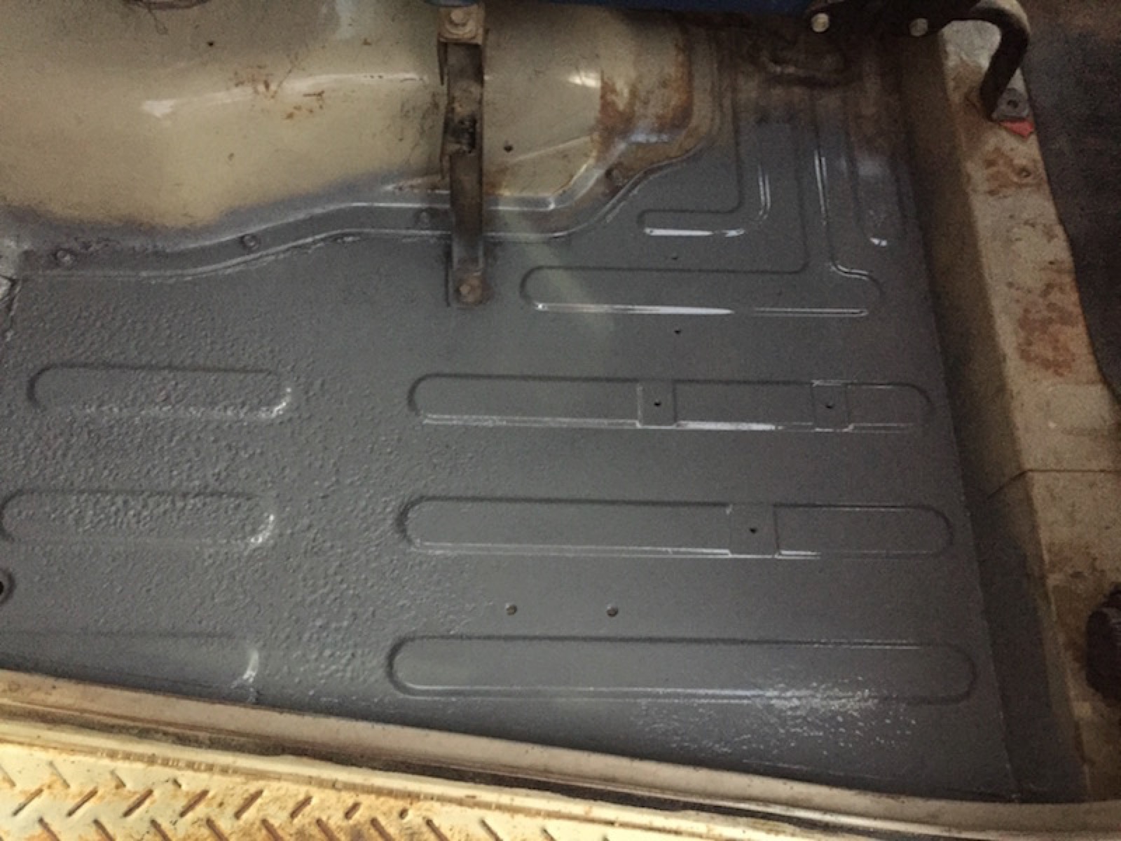

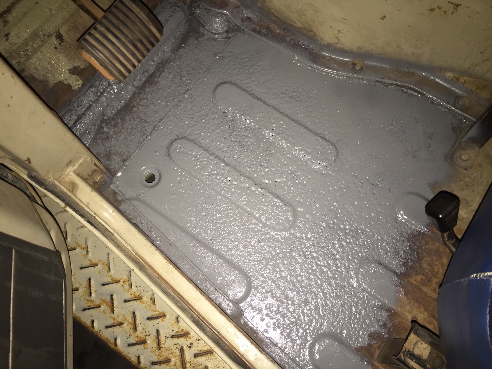

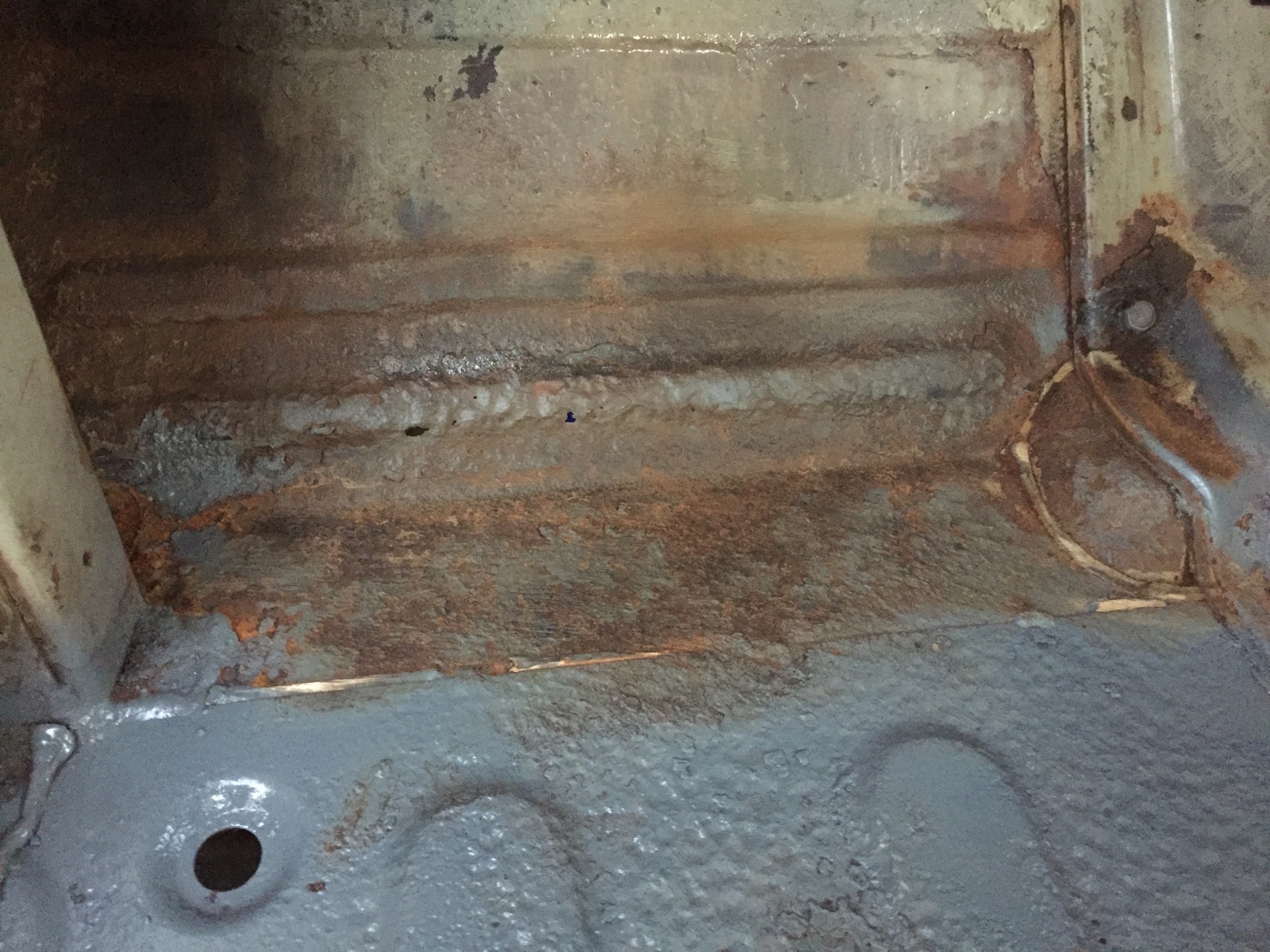

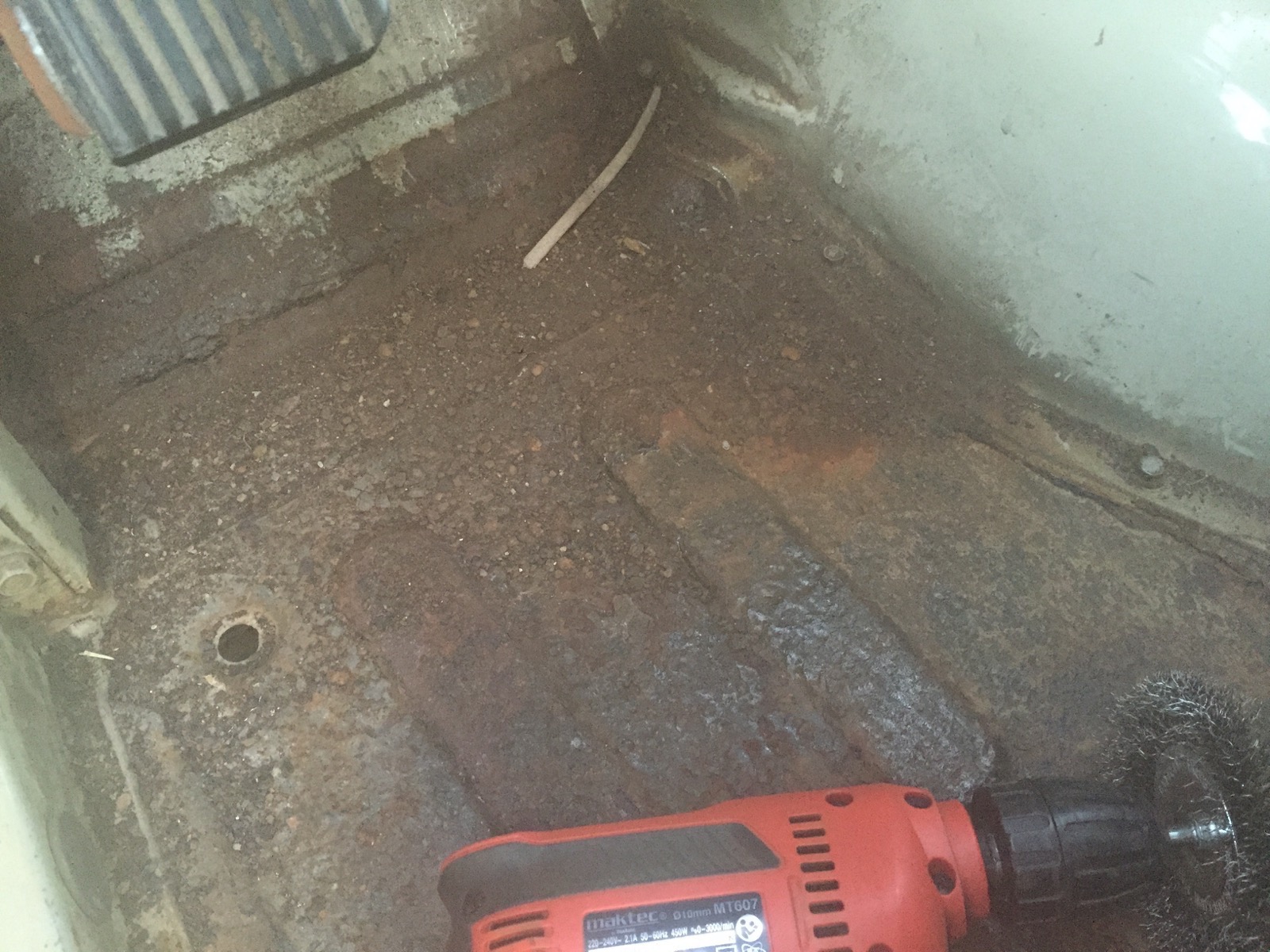

The other rust area is my front, drivers-side floor pan. When I bought the truck you could see the rust... it was clearly the result of some brake/clutch fluid leaking and eating through the paint. I looked under the truck and you couldn't see any of it peaking through so I figured it was just surface rust.
This past winter I did some wire-brushing to see just what I was dealing with...
Hmm... those holes aren't good.
But this isn't too bad.
Ugh... more pinholes.
I cleaned out all the dust/debris and primed it to protect it.

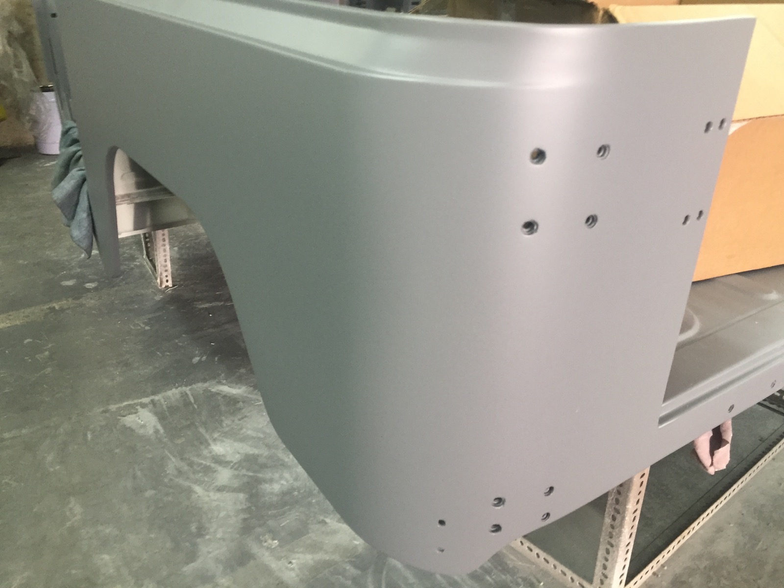

And here it is nearly completely in primer.

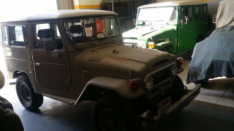

Loved your post and thanks for all the useful info. I also became an owner today of a BJ 40 back home and will receive it there in September/October once I visit. Most of the parts are available there locally but sometimes you don't get the quality you need. Was looking for sources in Dubai / Sharjah and stumbled upon your post. Read through all 6 Pages and ended up signing up for the website :). Please post some updates and photos of the progress. I wish to do a restore on mine over the next few years keeping it as close to the basics of Factory / Stock state
Take a look at my Rig in attached photo. It is a Diesel model obtained from Federal Government / Customs Auction in Pakistan.
Rig looks great man! I'm a bit envious of the diesel to be honest... though your steering wheel is on the wrong side. ;-)

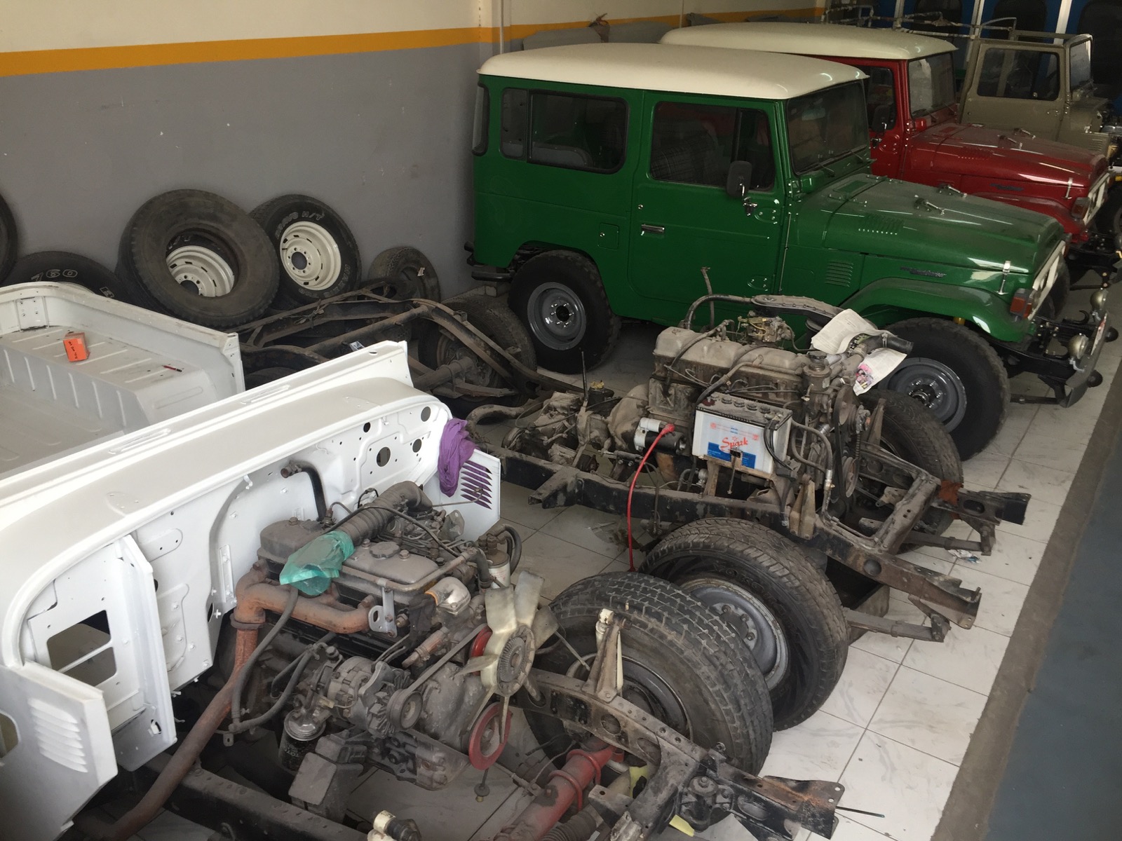

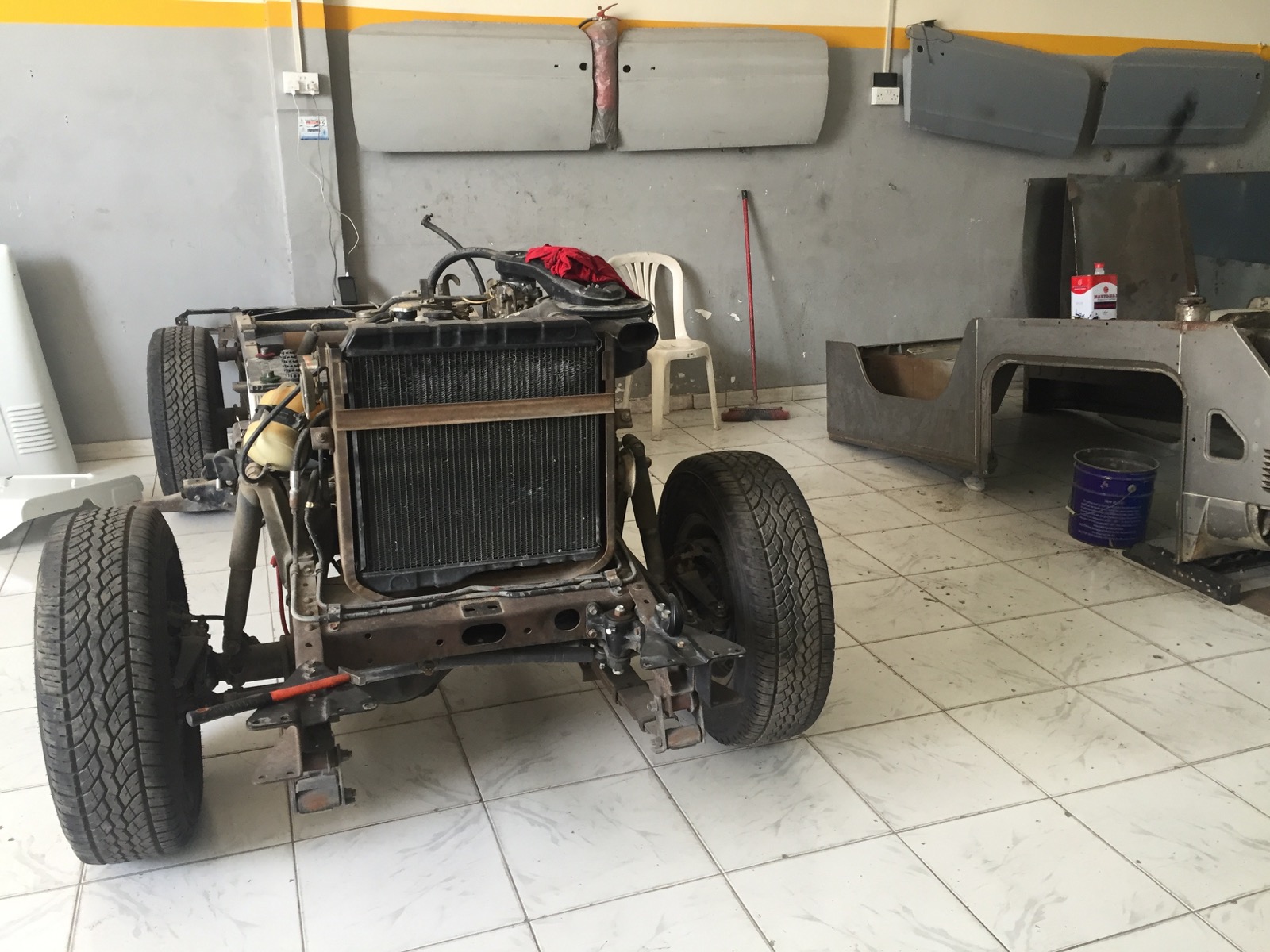

Well, the truck has been progressing. I visited to participate in some of the work this past week and this sight was waiting for me in the shop...
Mine is the naked chassis in front of the beautiful green one. That green and red one are amazing things to behold. Can't wait to see mine in that condition.

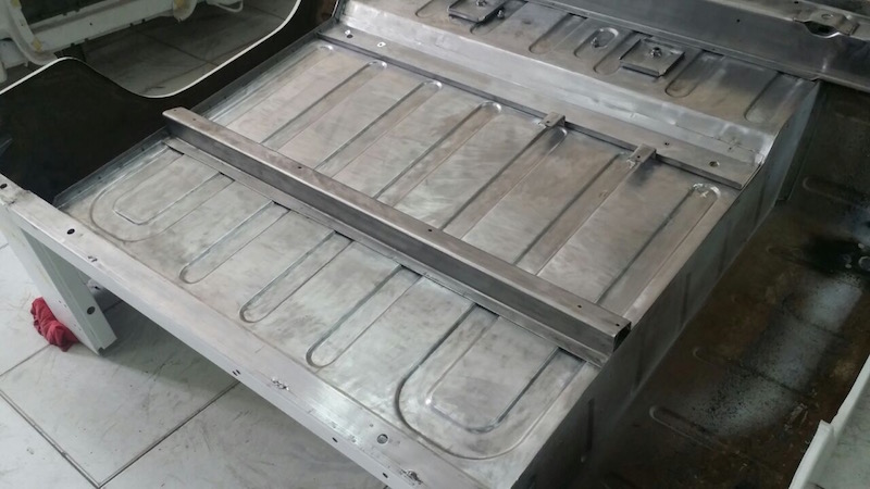

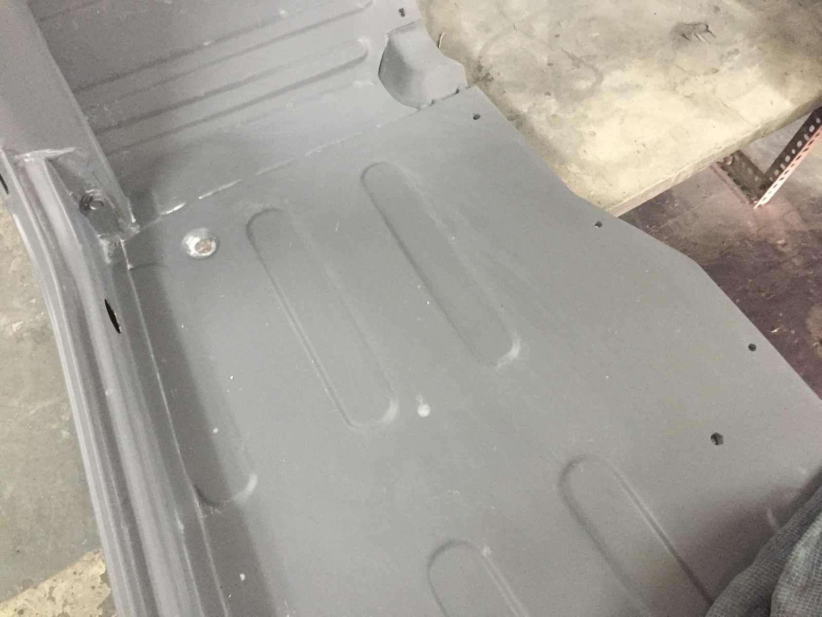

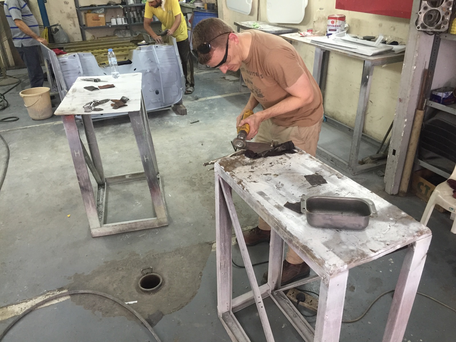

They've finished up repairs on my tub. Do you remember this problem rust area?
Well they hand-formed replacement panels and cut/patched accordingly.
And this corner used to have two dents in it.

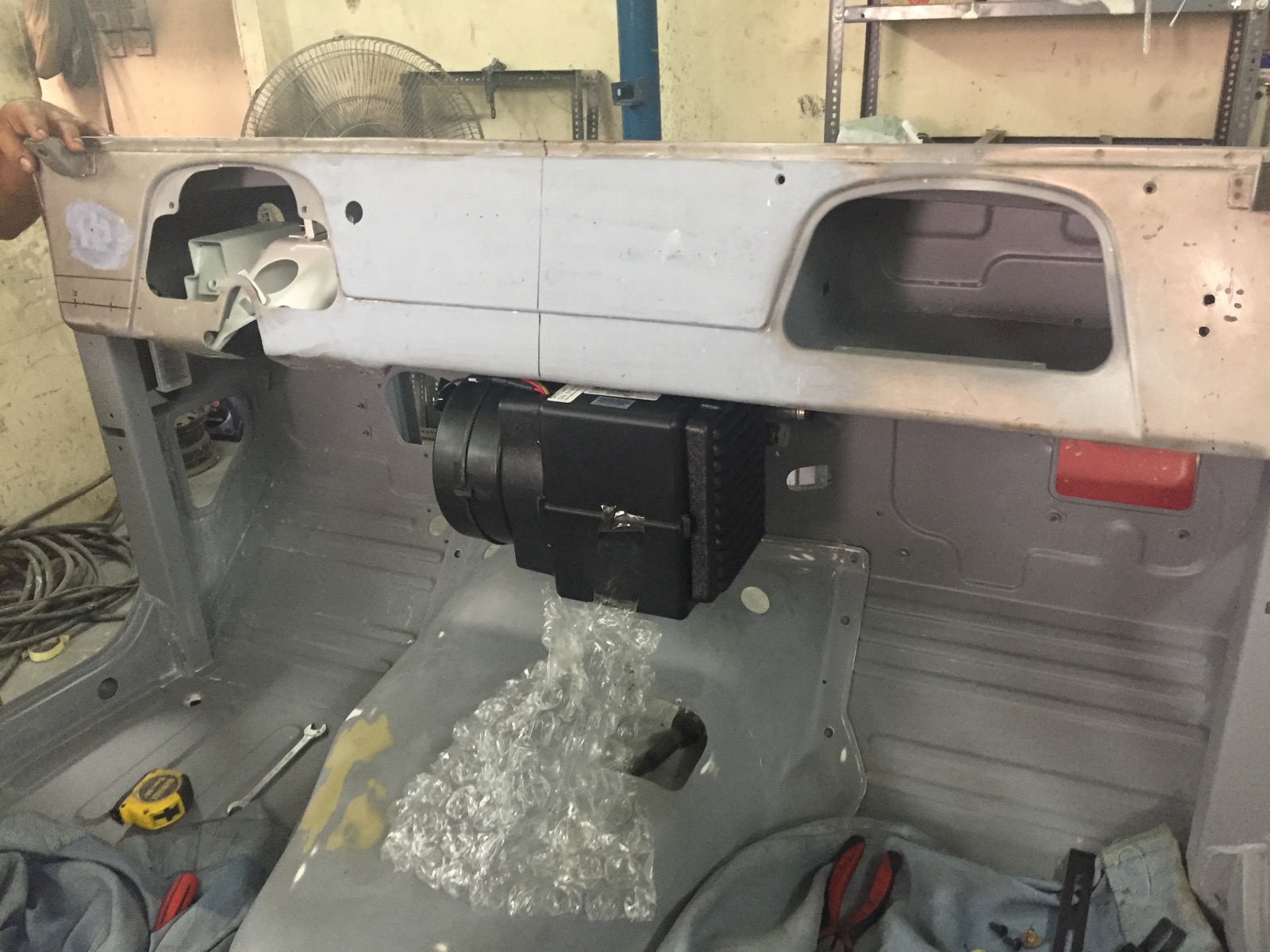

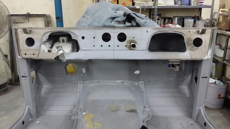

The last major item before they could wrap up the tub was mounting the AC unit and laying out the dash and cutting the holes for switches and AC vents.
Here's the AC mounted (I'll give more detail in my Hurricane install thread).

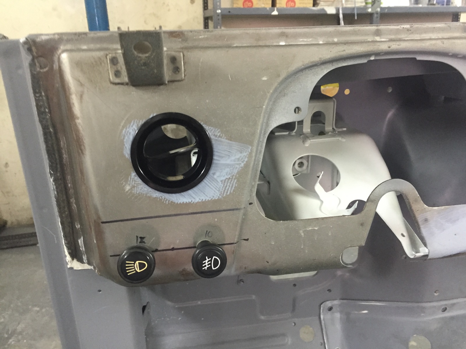

As you can see they completely blanked out my dash (except for the brake light) so we could cut new holes based on a design I put together. Design 1 ended up not being feasible... design 2 was nearly feasible but we had to work some of it out on the fly while test fitting ducting and switch depths behind the dash. The vent and light switches left of the steering wheel turned out slick I think.
And here's the final dash drilled out for all the switches. Each of the eight small holes surrounding the center vents is for a specific item (wiper, choke, AC fan, AC temp, defrost cable, heater cable, RAM mount ball, and 12V socket).

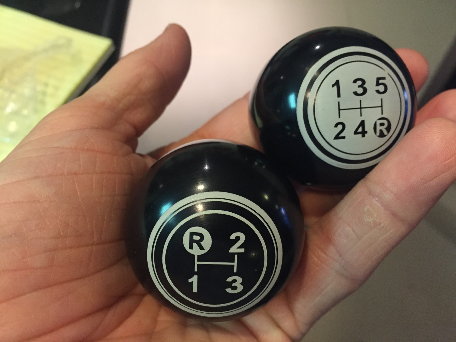

Almost forgot. I picked up a machined aluminum, black-anodized, laser-etched gear shift knob from @Diesel42. You can read up on these here. I grabbed a 3-speed knob as well as a 5-speed knob (gotta plan for the future). In any event these knobs are incredible...
162shiftknobs
I love how he matched the factor layout/lettering for these. He's gonna make transfer case knobs next... and eventually, possibly, dash knobs.

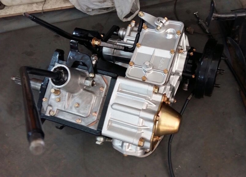

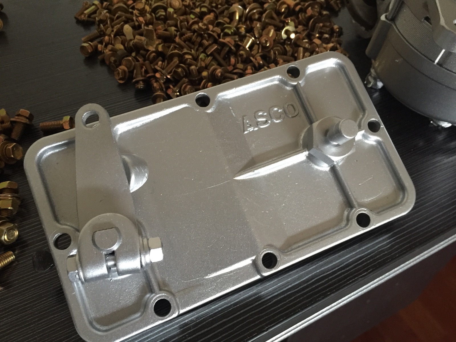

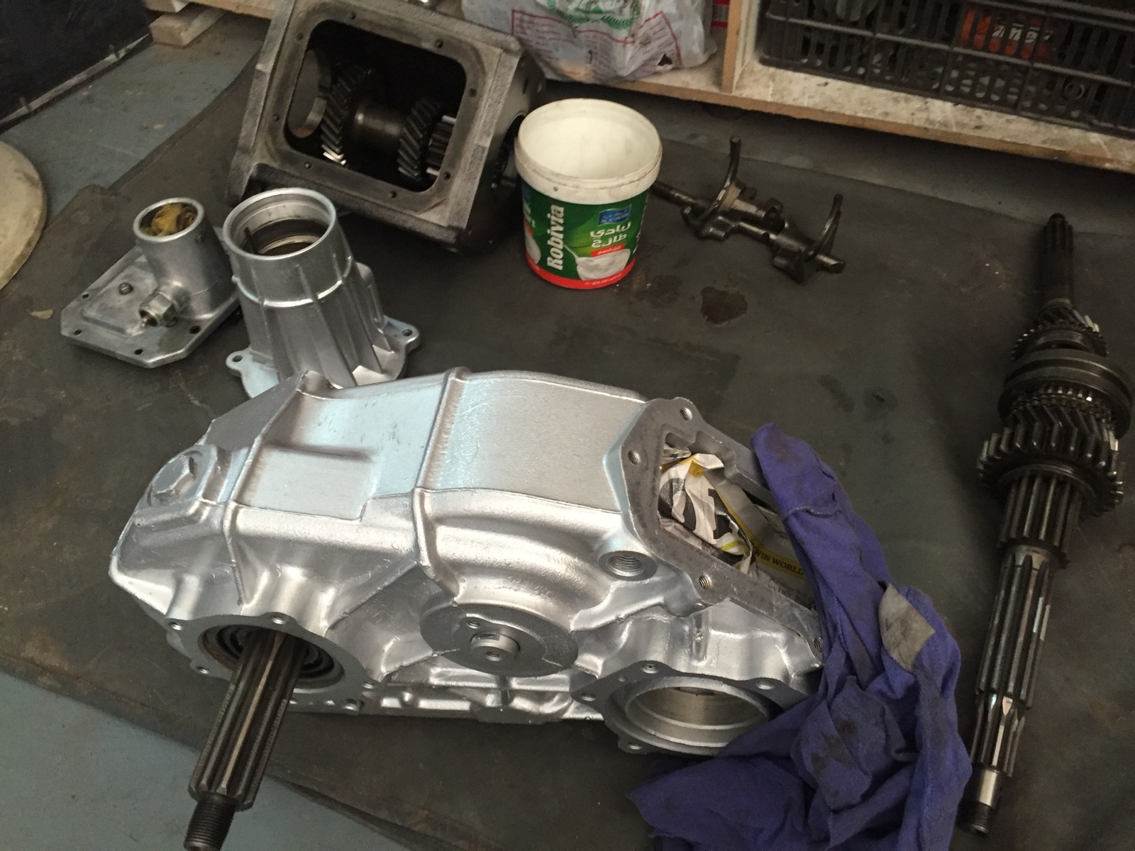

A few visits back I found them with the transfer case and transmission in pieces, mid-rebuild.
They tried to find all the bearings locally and couldn't so I ended up sourcing a transmission and transfer case rebuild kit from the States. Cruiser Outfitters had the transfer case in stock but I had to call four different places to find the transmission kit (finally found at CCOT). A lot of money/time spent on the 3-speed but I don't have all the parts needed for a 5-speed lined up yet.
It's done now...

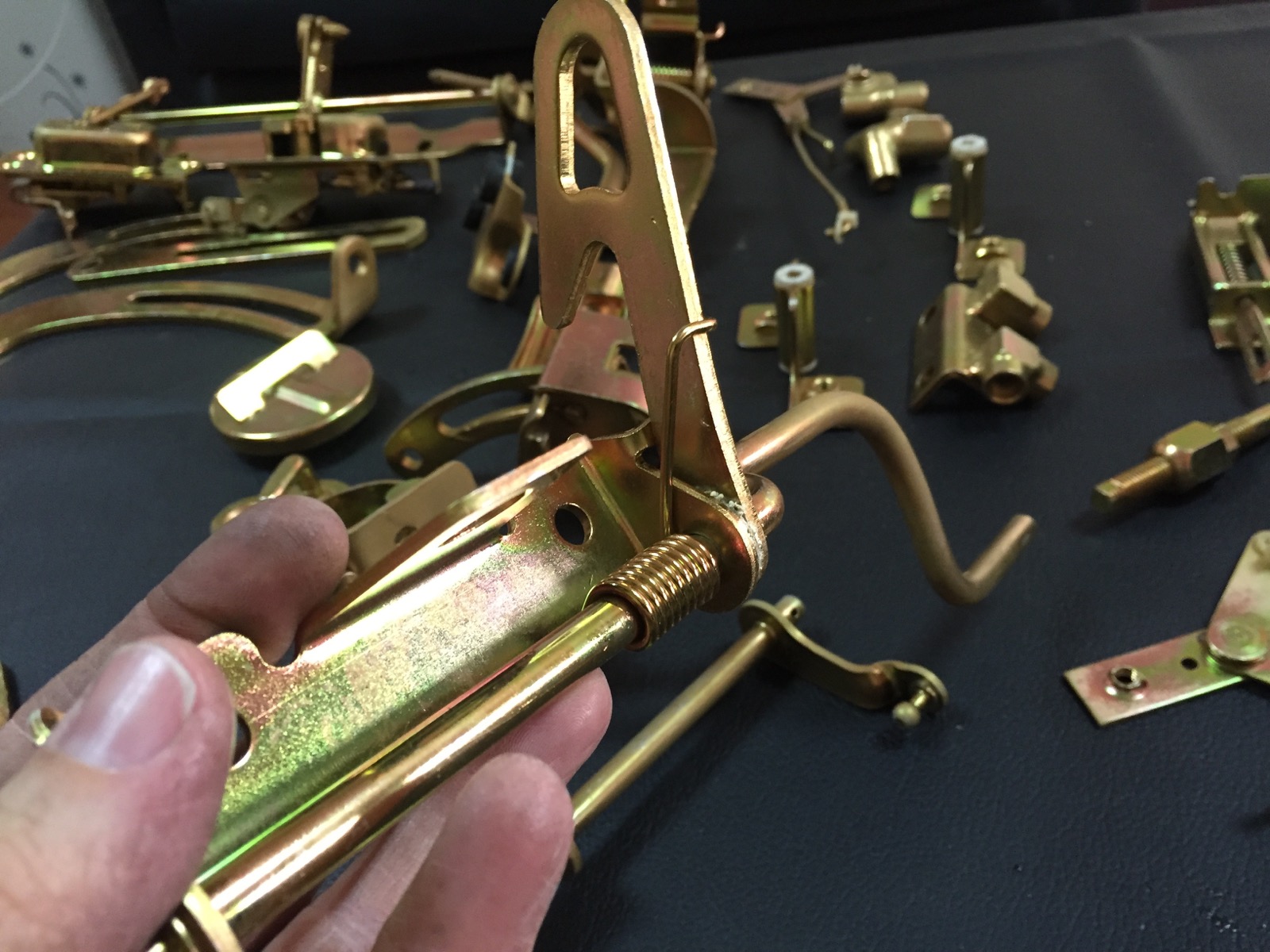

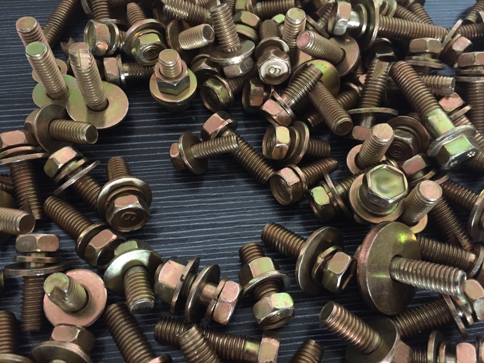

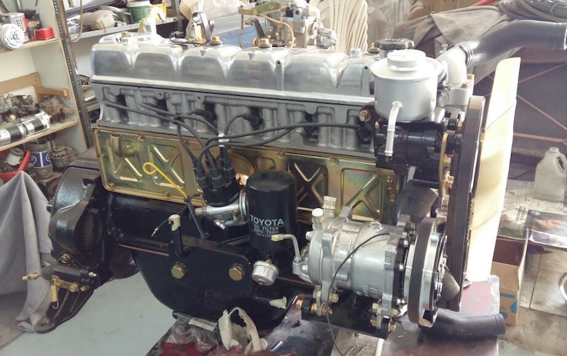

They've done beautiful work re-plating hardware and painting small pieces while dis-assembled.

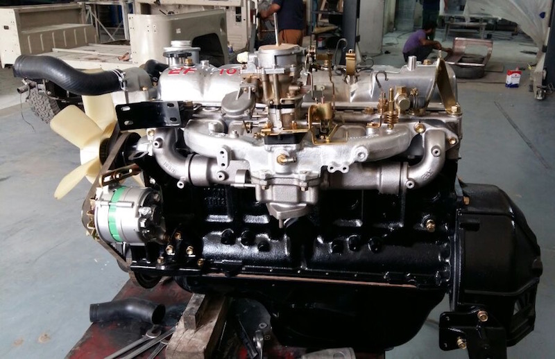

The motor looks gorgeous pieced back together...

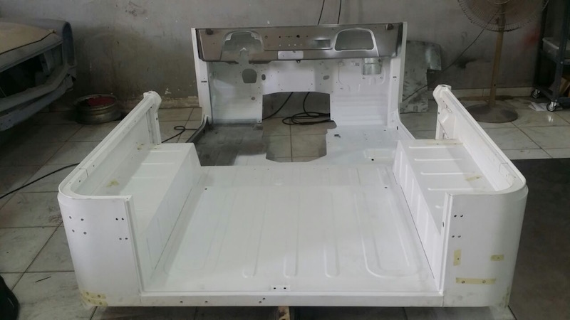

I went and visited the shop this past weekend. The chassis is complete... engine is back in and running (will have to download and post a video). So they've painted and polished the body. I took the boys with me and they wanted to pose with the tub...
