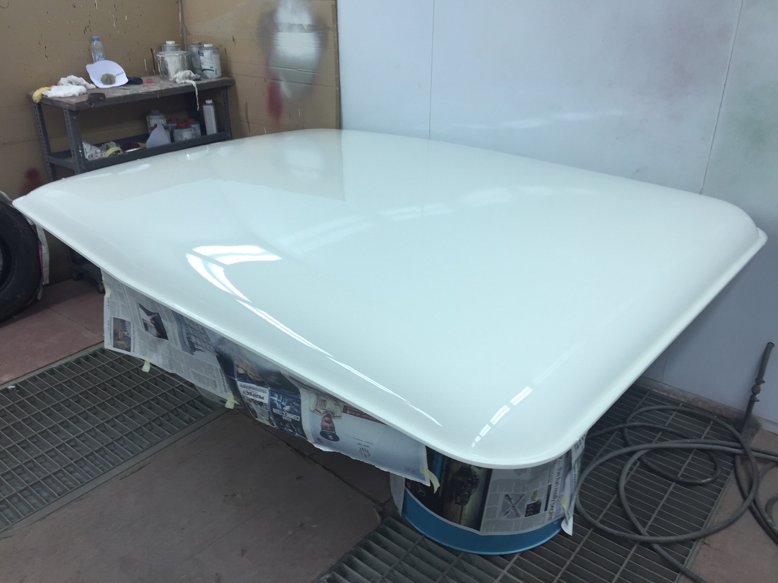

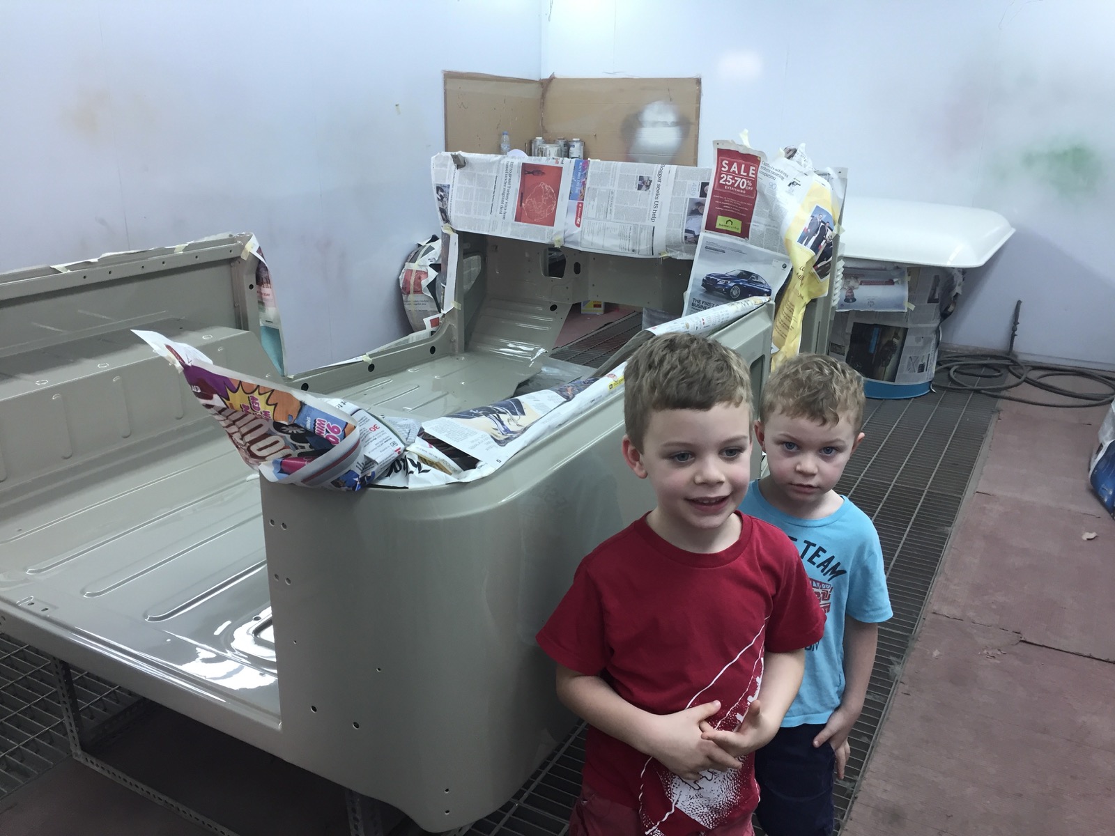

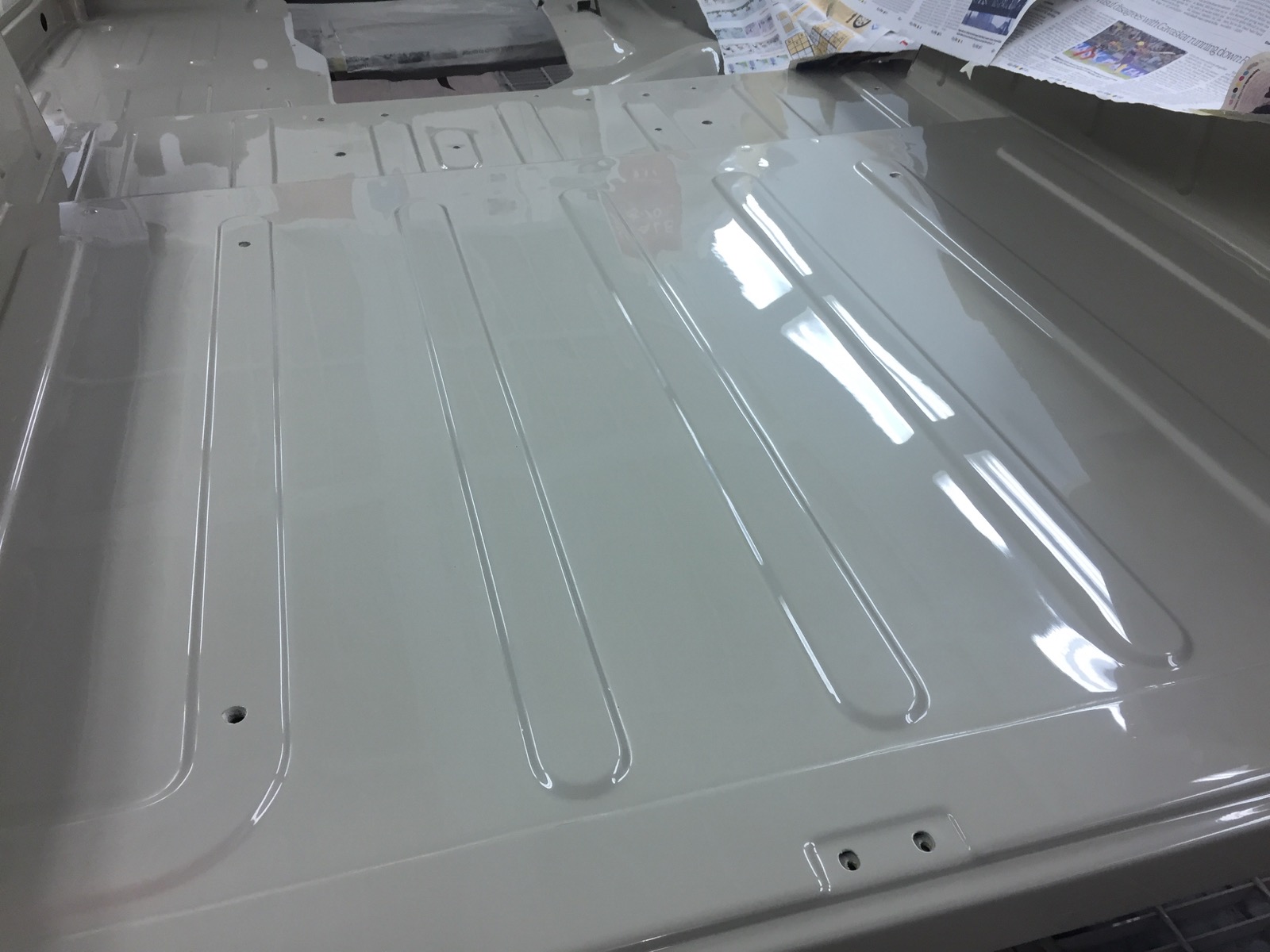

I went and visited the shop this past weekend. The chassis is complete... engine is back in and running (will have to download and post a video). So they've painted and polished the body. I took the boys with me and they wanted to pose with the tub...

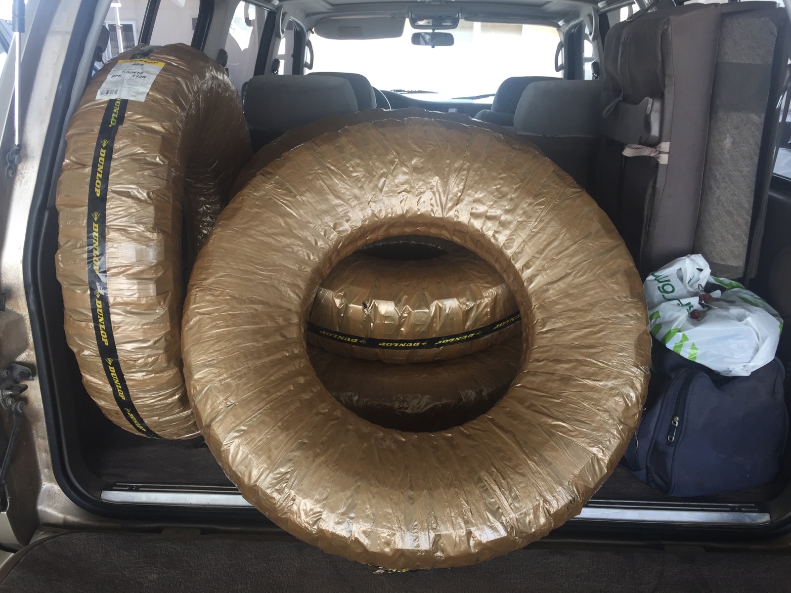

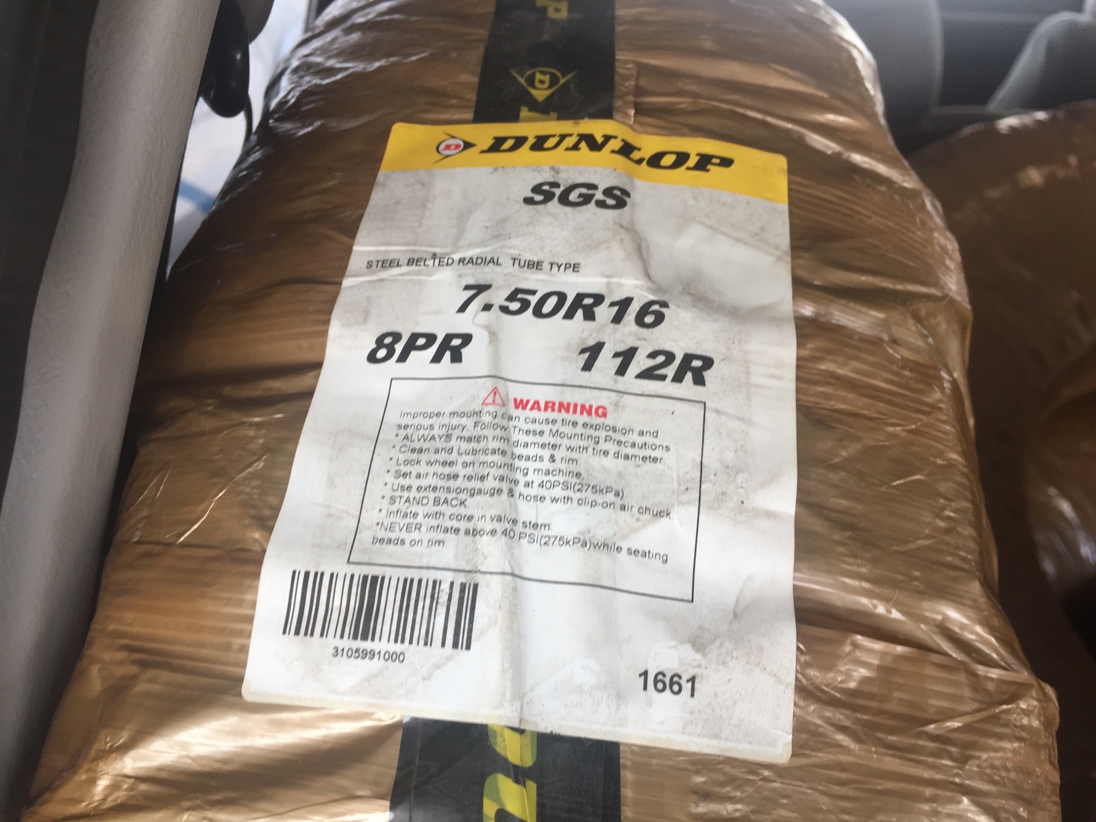

And today I picked up my new shoes... 7.50R16 tall and skinnies.

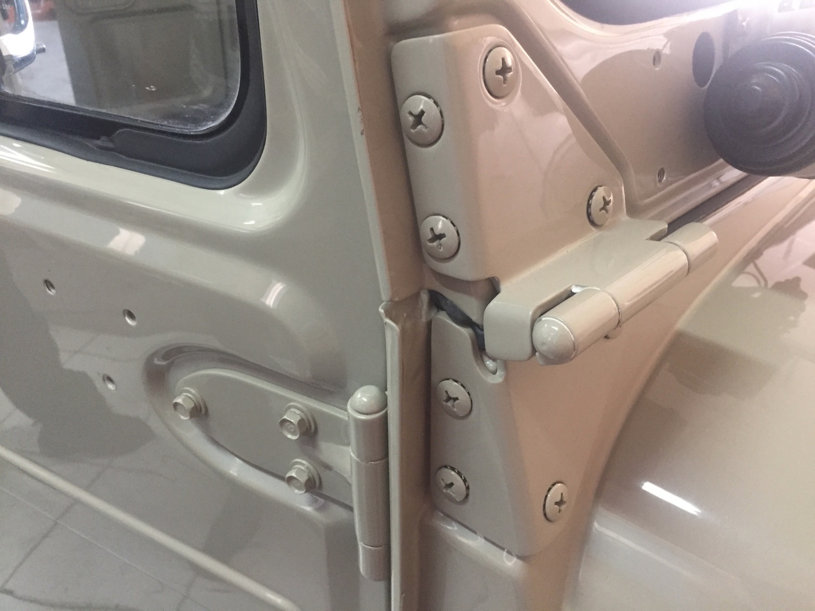

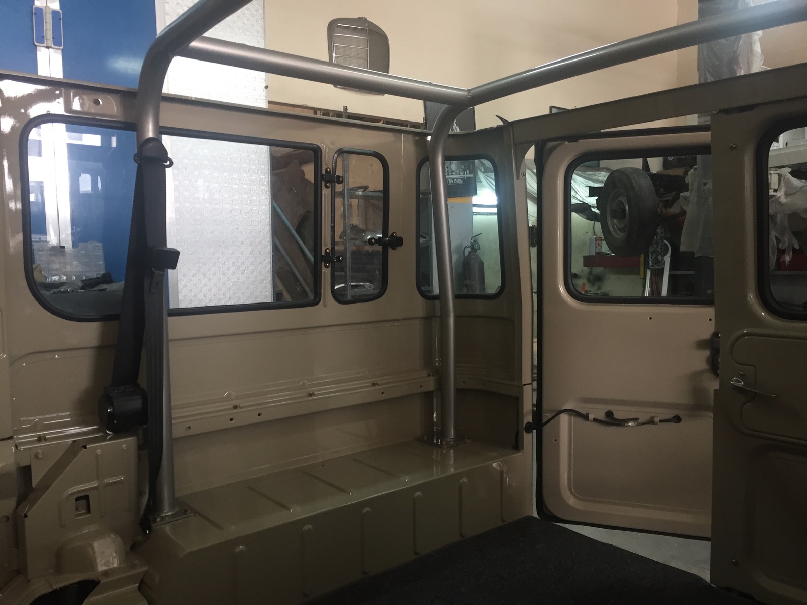

One thing I really wanted to capture was the painted hardware of the original trucks... I didn't want stainless or chromed hardware on the hinges and whatnot. The shop nailed it!
They also nailed the pewter colored roll cage.

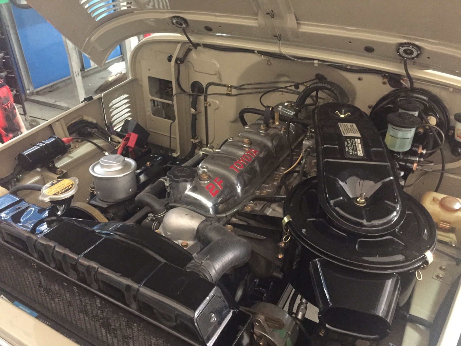

The engine bay looks so nice that my washer bottle and overflow bottles with their yellow discoloration kind of throw off the overall look.

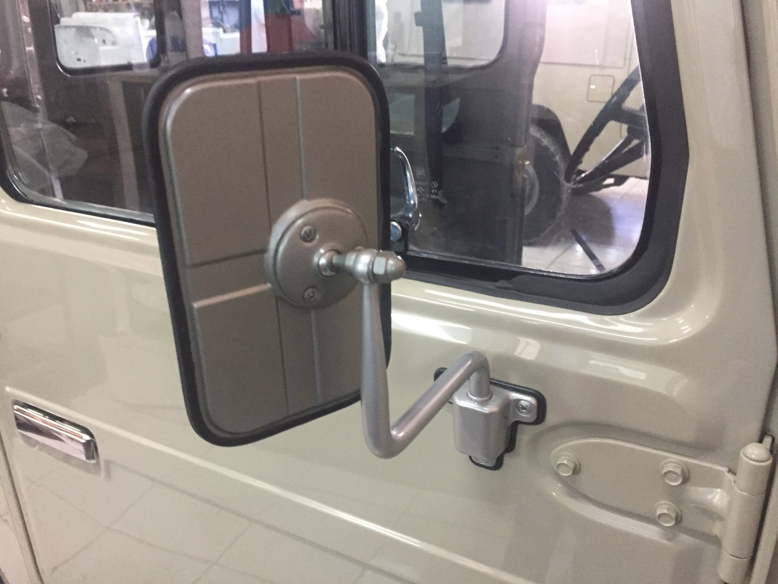

I hate the stock mirrors for the '77. That plastic mirror head just doesn't last long here in the heat. And since the driver's side arm is NLA, I decided to improvise a different approach based on the better mirror heads that @beno catalogued in his side-view mirror thread. I bought two of the passenger side arms, had the shop cut off the angled-top ball portion and weld a proper eyelet in place for bolting in the older style mirror heads. I love it!

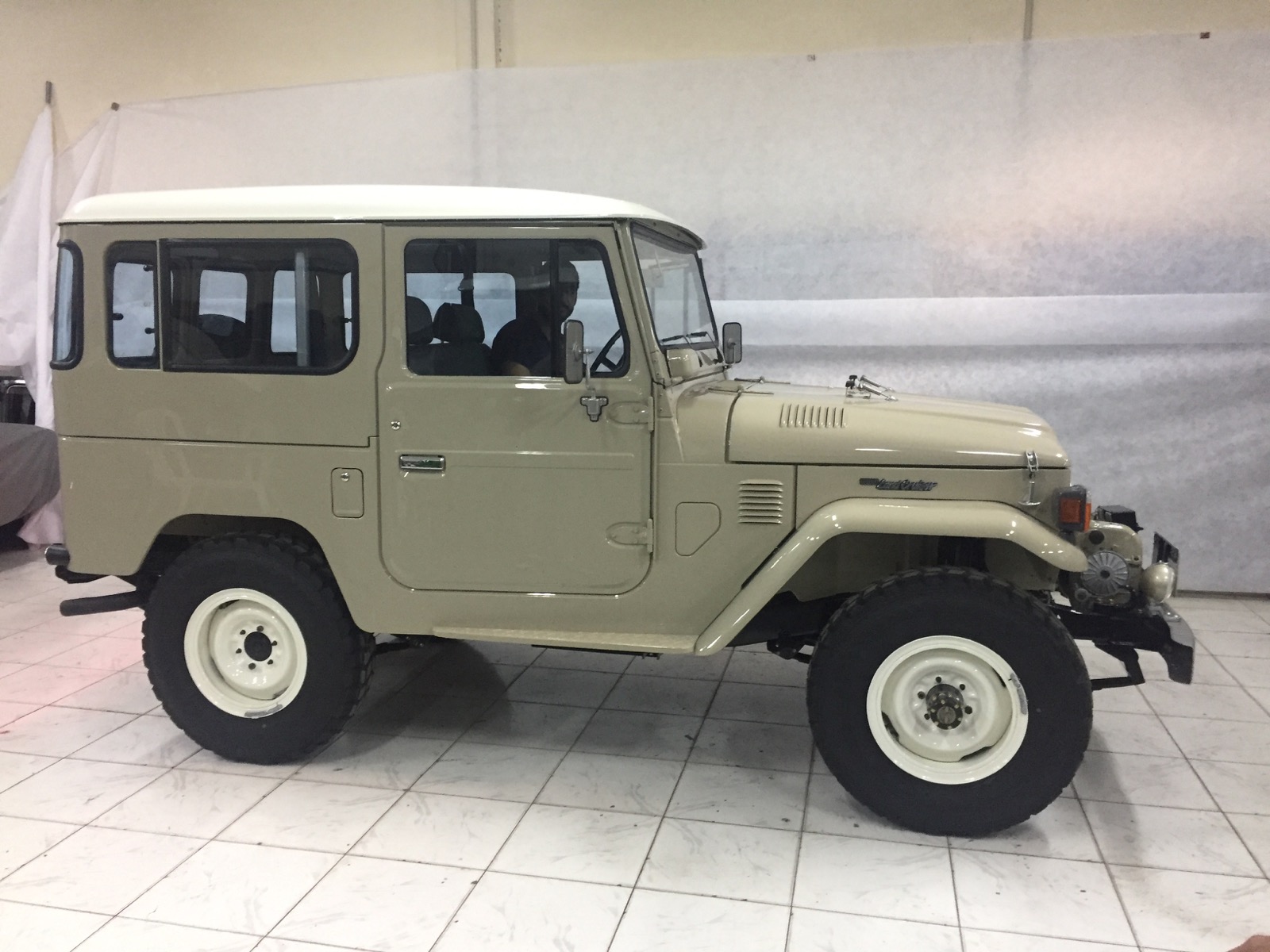

And finally, a profile shot...
