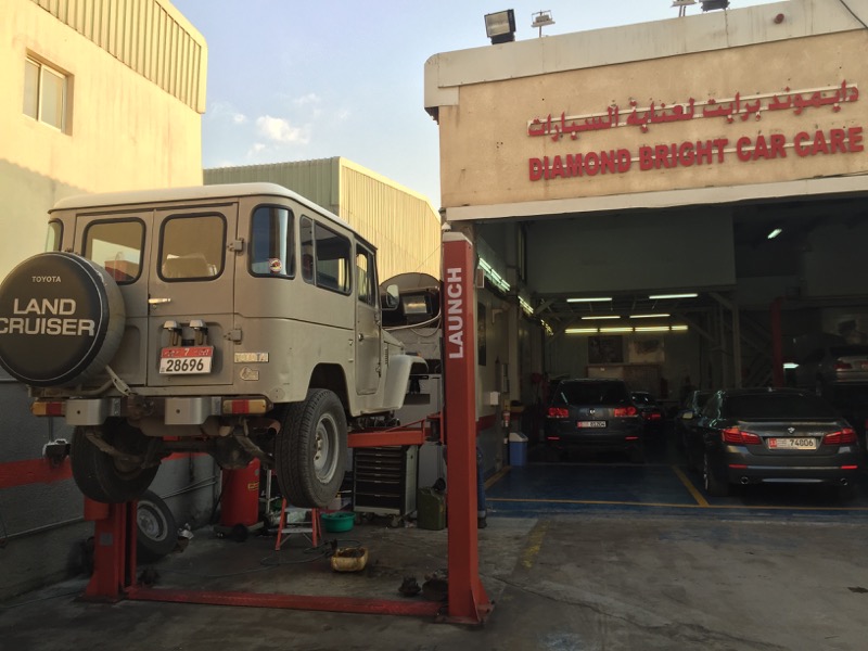

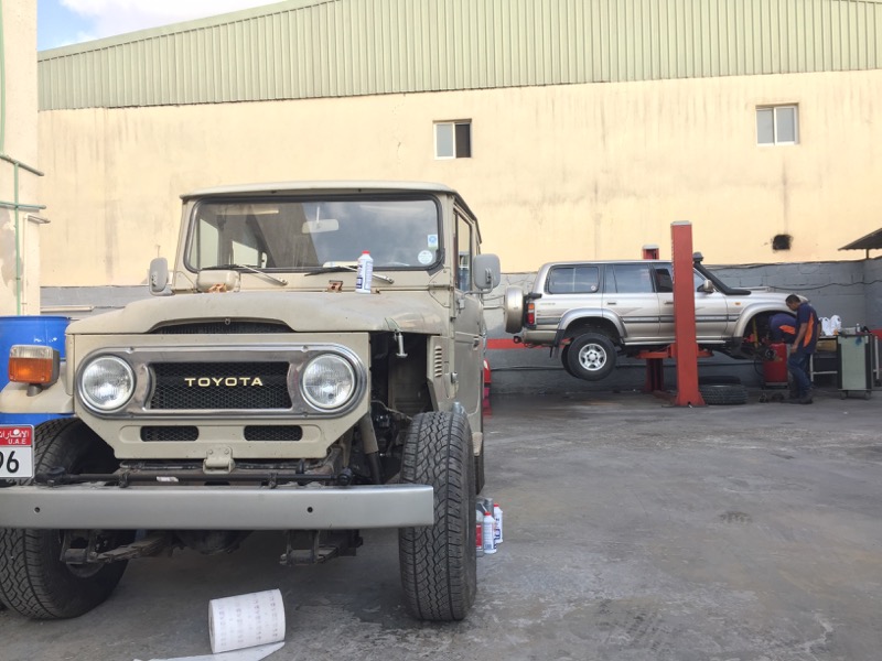

I had a nice holiday here for the Muslim holiday of Eid, so I loaded up the 40 with all my tools and the required parts and headed to the shop to start work.
They graciously let me use a lift. Heck, I actually had two helpers most of the day. It was nice!

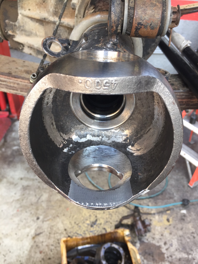

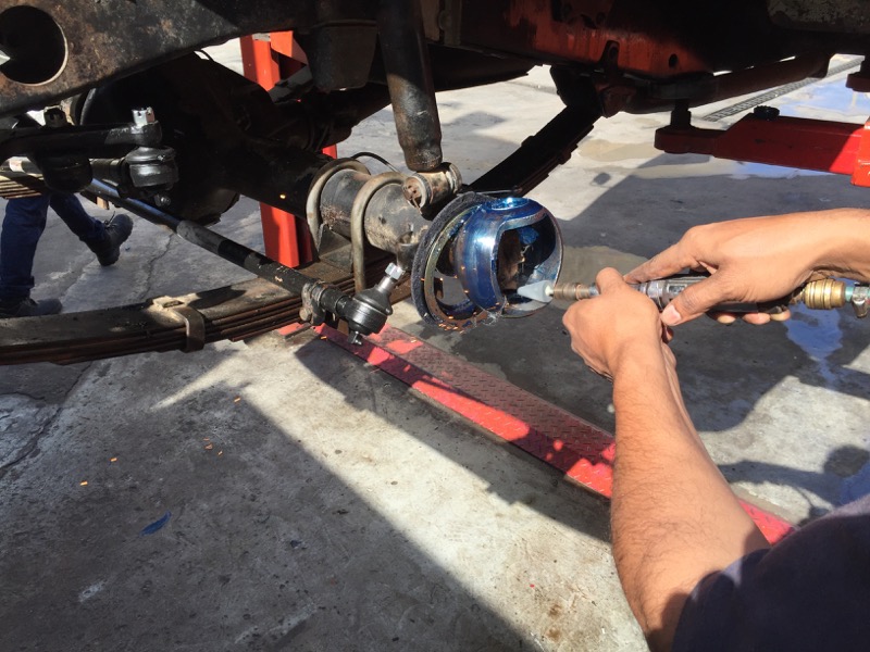

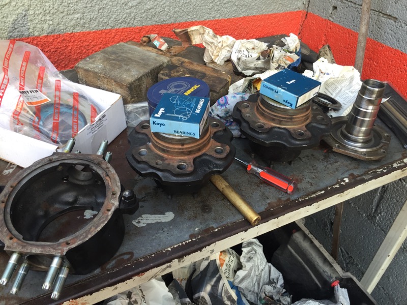

I already had fine splines and upon inspecting the ball I thought it looked already ground a bit.
However, they were the long fine-splines and I needed to swap in the shorter fine-splines that came off the 70-series axle. So we had to grind.
We removed all that grease and recleaned the whole ball after grinding.
We sent the hubs out to have the new bearings/seals pressed in.

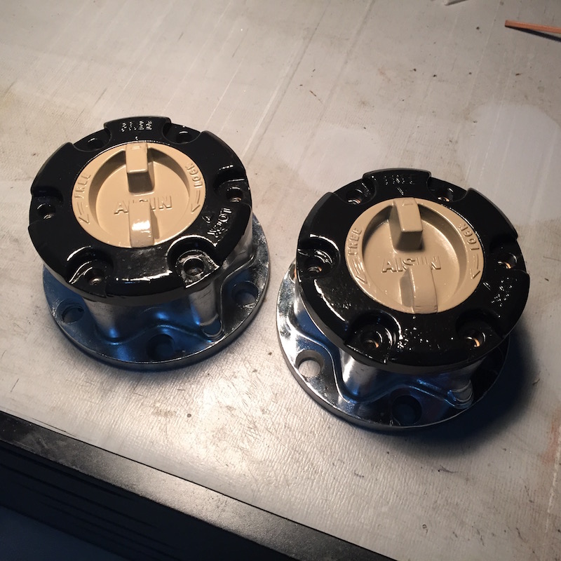

I’d previously rebuilt the Aisin locking hubs.

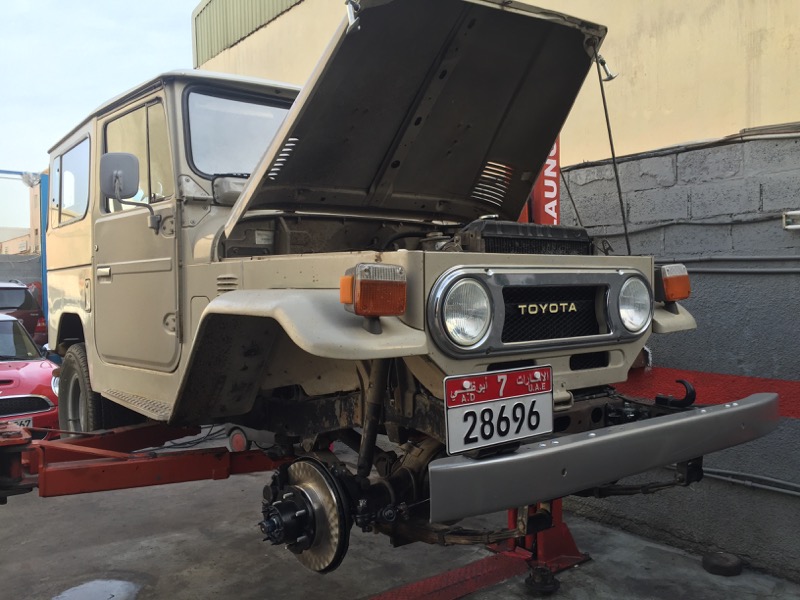

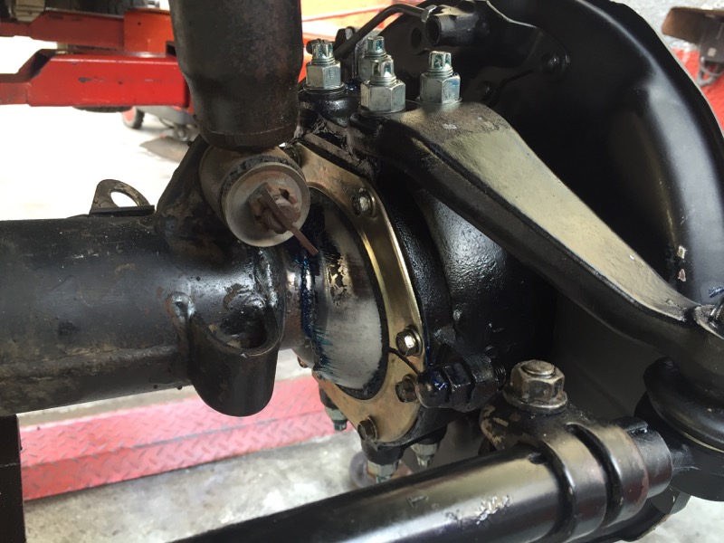

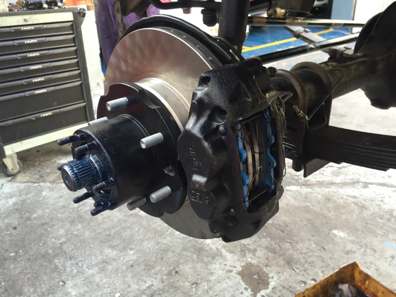

And here’s the nearly-finished product.

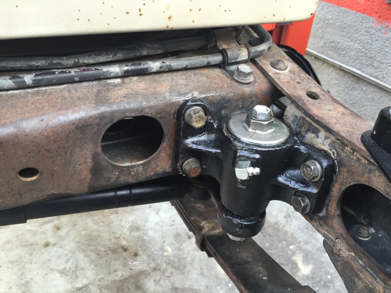

I put in all new studs and nuts for the steering arms and bearing plates. The calipers were rebuilt there in the shop by one of the guys. I bought the kit and he tore them down completely. He really did a great job. He also rebuild the centering arm for me.
Nearly there

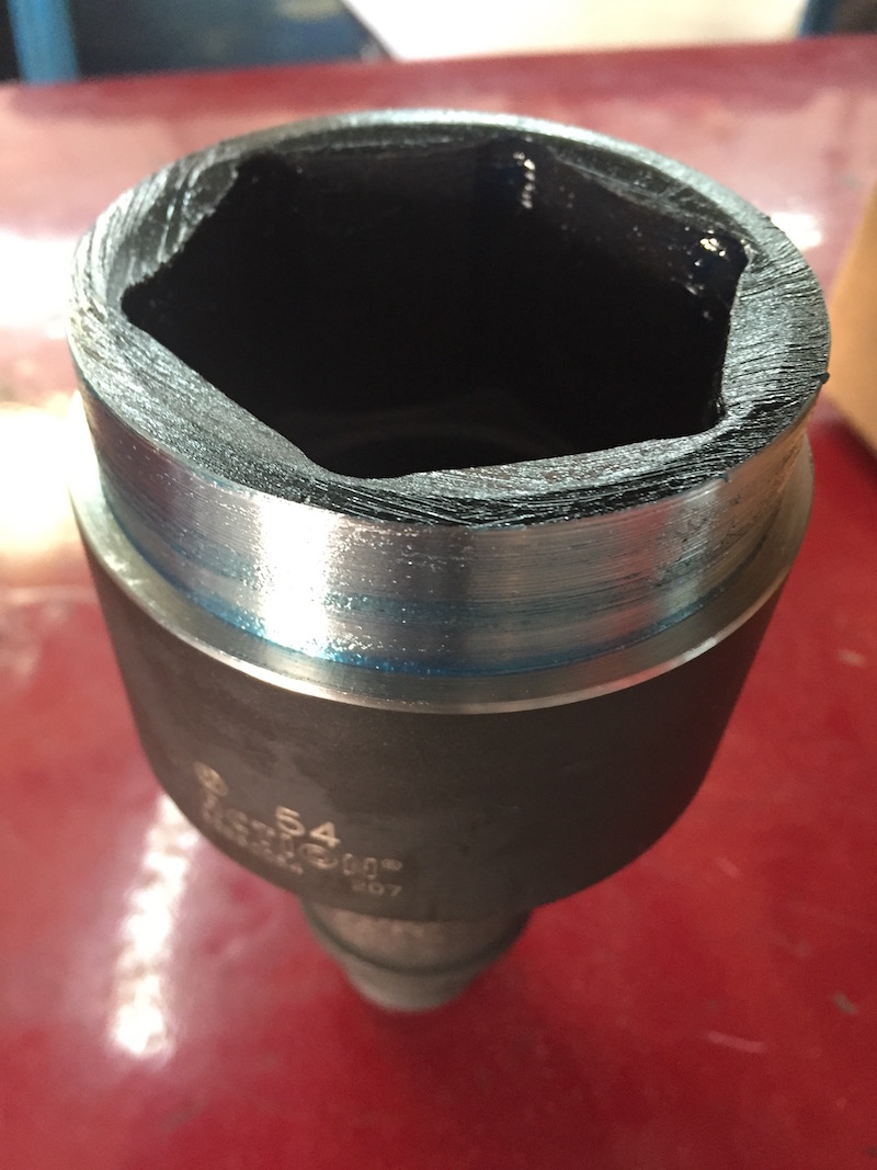

Only problem was sourcing a 54mm socket. They didn’t have one… and couldn’t find one. I ordered one off Amazon (next day shipped to my forwarding address). Typically I get items forwarded within 5 days. It got lost in the New York forwarding center and I was pressed for time. I managed to find a 54mm impact socket but it’s walls were too thick for the hub. And it was a 1-inch drive. I bought it… and a 1-inch to three-quarter adapter… and a three-quarter adapter to half-inch adapter. We sent it out for a quick machine job…
It worked like a champ.

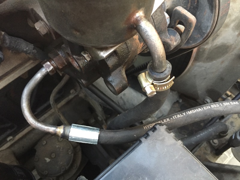

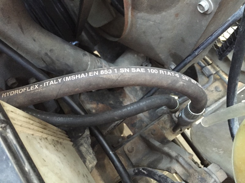

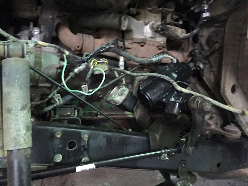

This ended up being a multi-day project. While we had it torn down I went ahead and had the power steering gearbox pulled so I could rebuild it. You can see more of that in the Power Steering thread I started.
Here it is installed.

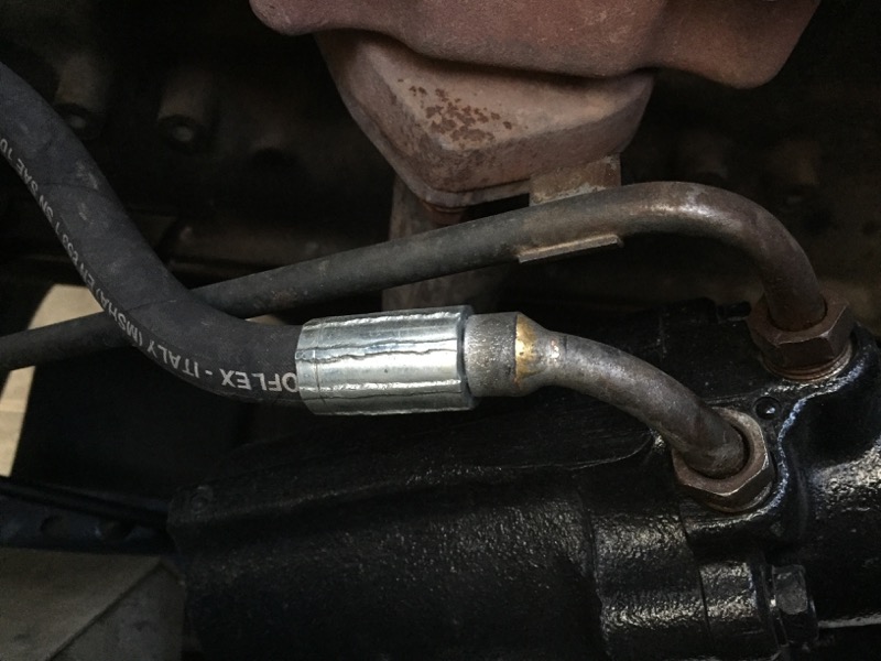

And with new softlines brazed onto the original fittings.

Here she is nearly wrapped up and with my 80-series on the lift in the background… getting a front axle overhaul as well.
It’s done now… and it’s driving a lot better. The new TRE’s have really tightened up the steering. No more ATF fluid on the driveway from the power steering box. I still have some brake proportioning issues to work out once the new master is installed.

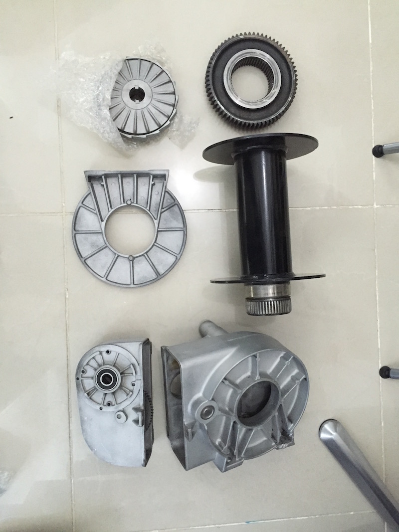

My folks visited the UAE for Christmas and brought me a treat. I picked up an old 8274 in need of a rebuild off Craigslist in the USA. Had a friend in Indy pick it up... and ship it to my dad. My dad dismantled it, bead-blasted it, and brought it over here in pieces in his bags. :hillbilly:
Dad even had the drum powdercoated black for me. Very excited to rebuild this and mount it up!

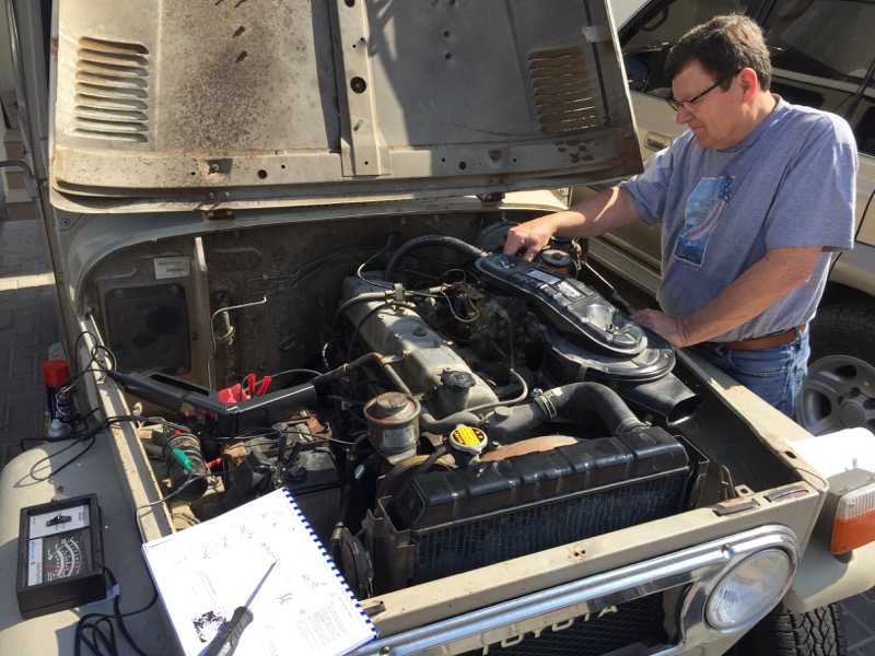

My folks visited us in Abu Dhabi for Christmas and of course my dad was quite interested to check out the 40. My dad is the one who taught me to work on cars. Some of my favorite memories growing up are from wrenching with dad. It's been a long time since I've helped him with a tune-up so I saved the tune-up of the 40 for his visit.

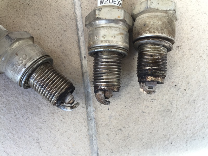

I gathered the parts: points, distributor cap, plug wires, plugs, rotor
I had previously gathered the tools: timing light, tach/dwell meter, gap feeler gauge
And off we went...
There were 3 different types of plugs in the truck... 2 Denso, 2 Bosch, and 2 different Bosch. A few of them looked way overdue.

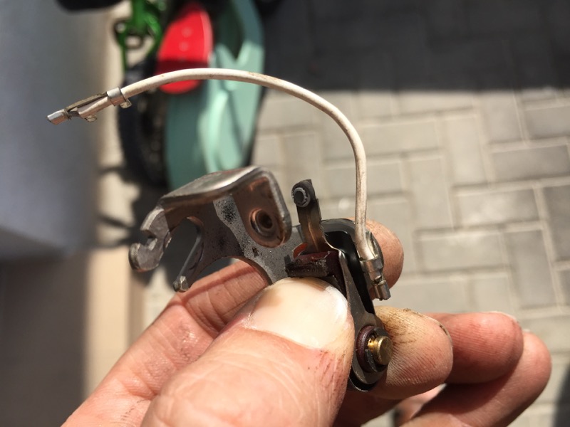

The points had quite a bit of oxidation on them.
Job done.
It runs much better now. Sooooo much better. Better idle, a bit better gas mileage, better acceleration. It was clear it'd not be done in a long time given how hard we had to search for the timing marks on the flywheel. We ended up using the rotor as an indication of where TDC should be and then scraping the flywheel to find the mark.
Working on an old truck with my dad. I love the memories this truck is giving me...

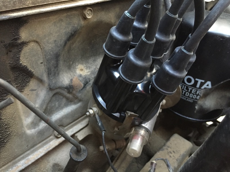

The points look like they may be arcing. You might want to replace the condensor unless you have the transistorized, semi-electronic ignitor. I think that type of distributor may use an external condensor, but maybe not. If not it will be inside under the cap.
This just confirms what my dad said about the points... and that I shoulda just done the condensor at the same time.
And as you say, the condensor is under the cap. It will be replaced soon (just have to pick up the part).

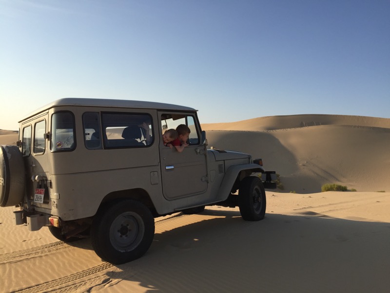

After the tuneup with my dad we took both Land Cruisers (the 40 and the 80) out to the desert so my folks could enjoy the dunes and we could take some photos of the family. Of course, some nice photos of the 40 ensued. The 40 handled the dunes like a dream. This was my first time to take it out for a nice proper run in the sand with the passenger rated tires. The old LT tires on it wouldn't deform with reduced pressure and as a result handled the sand quite poorly. The passenger tires I have now widen quite nicely at the bottom and she floated over the sand.

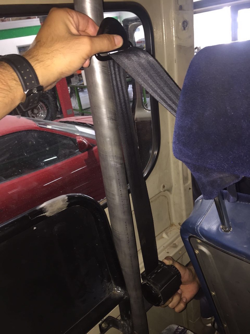

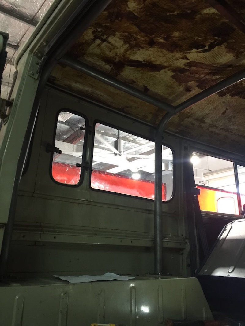

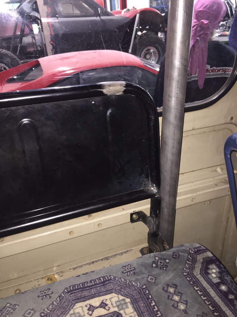

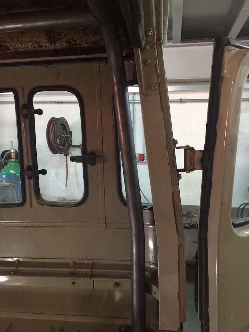

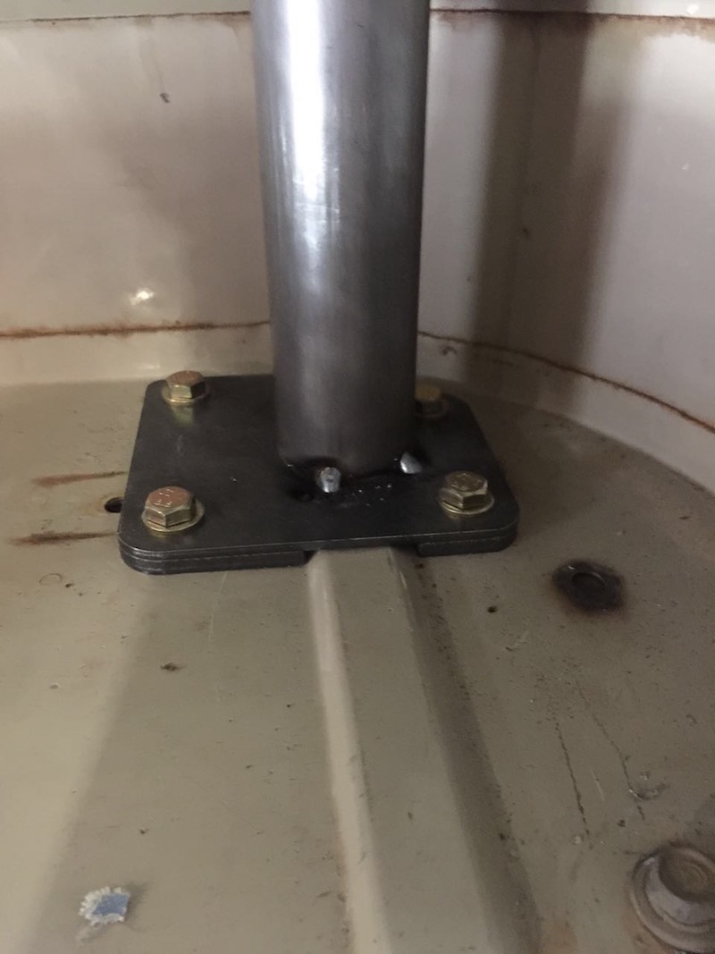

Progress on the roll bar. This isn't a full cage. It's designed to add safety in the event of a slow roll/tip.
I also want it to serve as an anchor point for seatbelt for the front and seatbelt for the jumpseats.

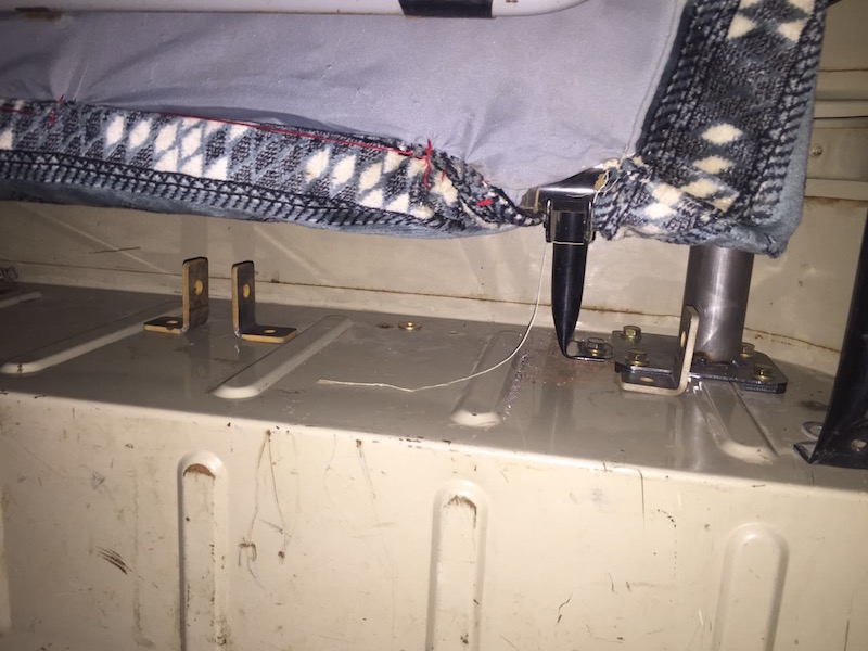

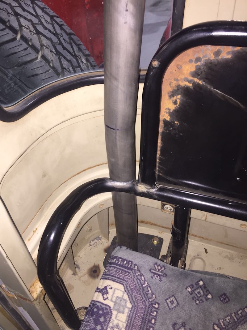

Had to modify the jumpseats just a tad. We shortened the back panels and put a kerf in the "arm rest".
