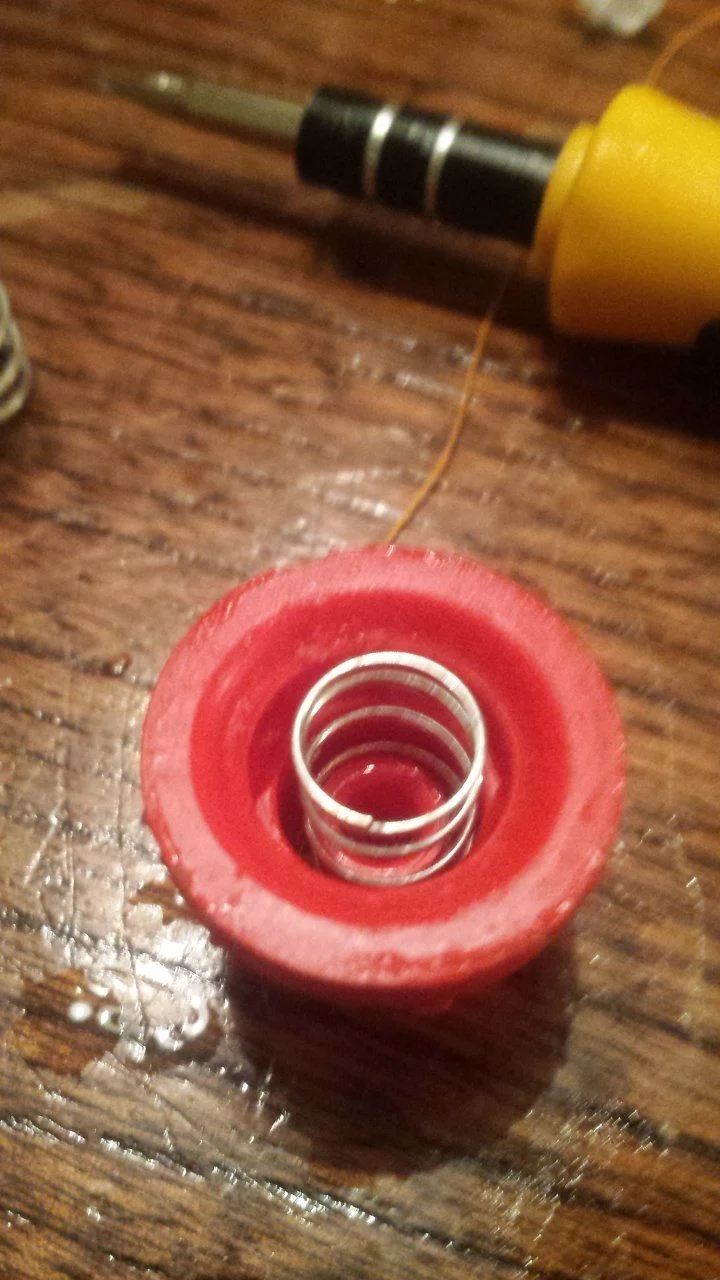

My headlight squirter had broken (like most everybodys) so i just threw a buncha parts together to make it work.
I bought a radiator reservoir that was universal and mounted it where my old reservoir was. I bought a water pump for windshield squirters and attached it at the bottom of the reservoir and wired it to the old original water pumps plug so it would function the same. I used silicone to seal the pump onto the reservoir. (can buy both of these at auto zone or oriellys i believe.)
I still had the old hoses so I cleaned them out and attached it to the water pump, where the old check valves were.

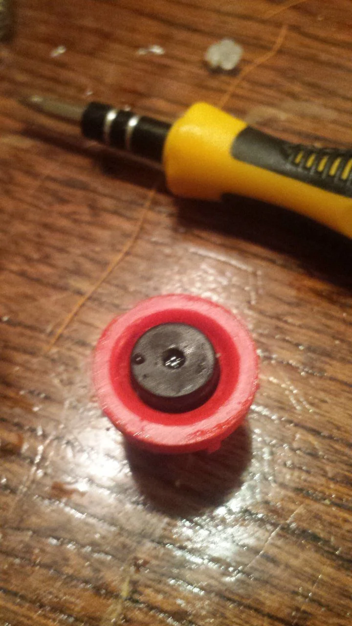

The check valves spring resistance was too strong so all i did was remove the black spring loaded cap with a flat head screw driver. replace the new weaker spring (3/8" x 5/8") spring was used), and re assemble. and to make the check valves fit i used an air compressor bit i had laying around to adapt it, the check valves dont leak and are strong enough to shoot over the hood with water!
You dont need silicone for the check valves i just had them in backwards :mad::doh:, havent had a chance to put them in the right way yet... should work without any problems

The check valves i had are either too tight or too loose. Stupidly sensitive, although they wernt made for my car XD. Once i get it i will rewrite the instructions so they're correct. This is killing me..

Most original check valves are pretty much crap, a 30+ year old piece that relies on a moving rubber gasket is done for by now. my reservoir broke so i made my own. and im trying to figure out how to replace the check valves for as cheap as I can. I still haven't done it. Yet. Time is hard to find

Hey i fixed the washers and tested them with some mud. Work flawlessly! They clean well and dont leak. I undid all of my weird mods and put in a weaker spring into the checkvalves I will post new instructions later tonight!
