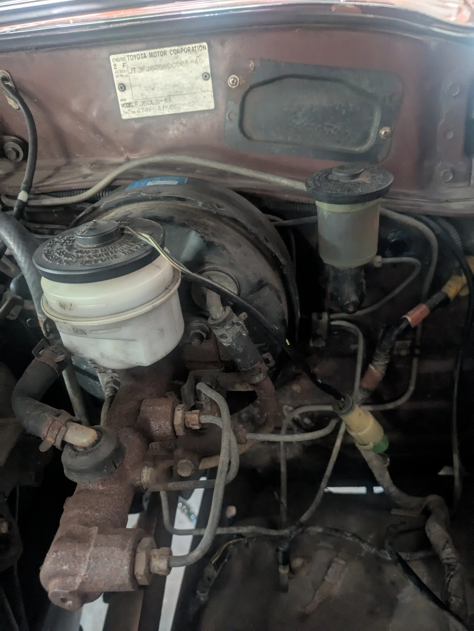

ok, so my emergency brake light will not go out. Without the engine started I can push the button underneath the emergency brake lever and it will go completely out so that is not the issue. With the engine started I can put the emergency bake down and it will go from bright to dim, but will not go out. The next thing I know will cause that is low brake fluid, so I checked it. I know because this because years ago when first got the truck and my rear wheel cylinders were leaking someone from this forum told me to add brake fluid and it shut off. I noticed the two lines coming out of the cap were cut and the plug was gone?? total mystery how that happened so I sourced a new one...see pic below. I checked it with an OHM meter to see if it worked sliding the float up and down and it seems to work. Anyway, I hooked it up and still have the same problem...dim emergency brake light after disengaging the emergency brake. Nothing that stops me from having a good time in my truck, but bothers me.
