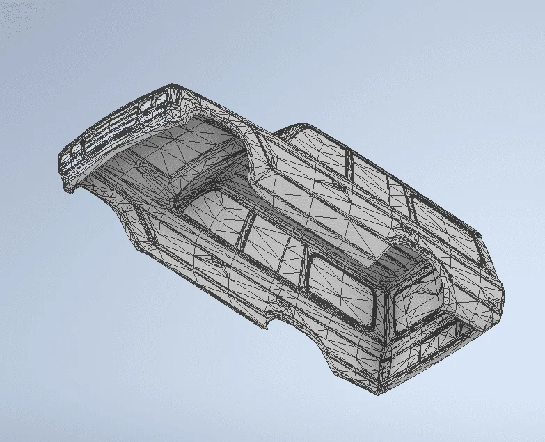

I opened that STL file you had above with solidworks, it doesn't have a bunch of resolution, the polygons are big (see photo below). I can try to refine the mesh in fusion, but I'm not sure the detail would suddenly appear.
Pretty expensive for an STL. It won't scale perfectly since it's not a mesh file so you'd be signing up to print it at that size, slightly larger or smaller.
Did you try importing at a finer mesh scale? Looks to me the large polygons are from the importing method not the actual part file.
Edit: Also when i did test prints the resolution turned out pretty good. Though i think the 3D printer software i use smooths out the edges. The issue i have been having is being able to covert it in Invetor to a model i can edit and thicken it. My goal is to put on body mounts so i can make a frame for it to sit on, but for some reason there are too many errors for me to do that.
No options in Solidworks for STL files to refine the mesh. An STL file by definition is a series of polygons, I have never seen a way to refine an STL file during opening. We would have to use a meshing program to refine it.
Maybe im thinking about the wrong thing. In inventor when you import a model you can select a high/medium/low resolution which effects the number of polygons generated.

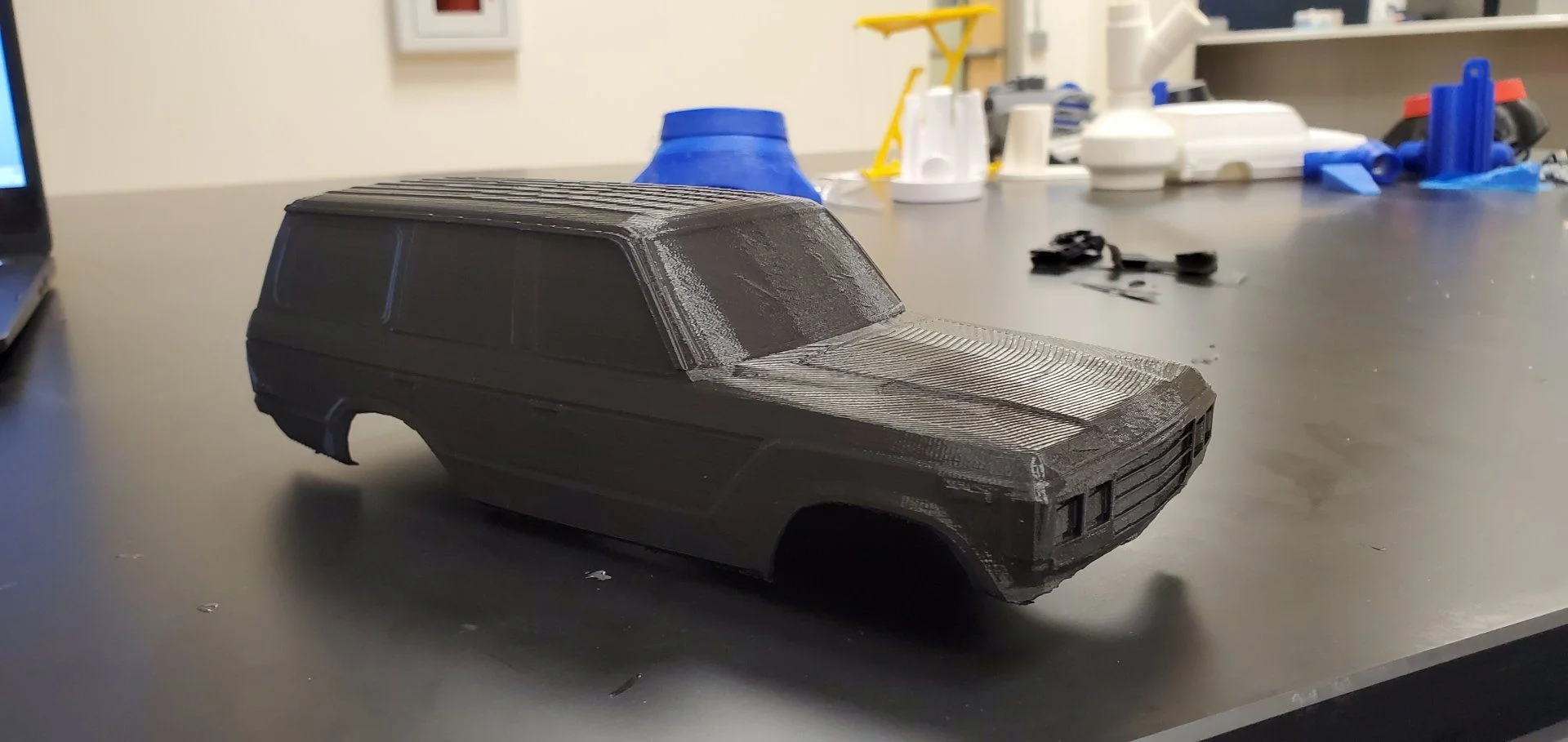

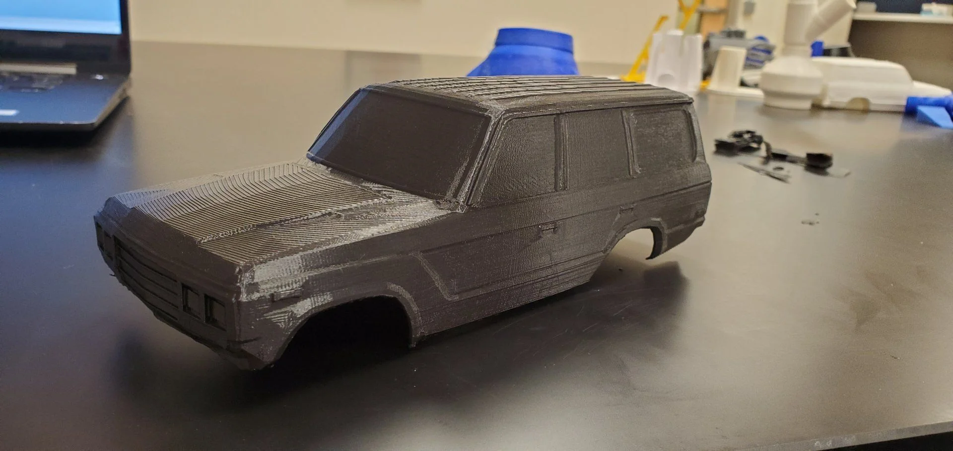

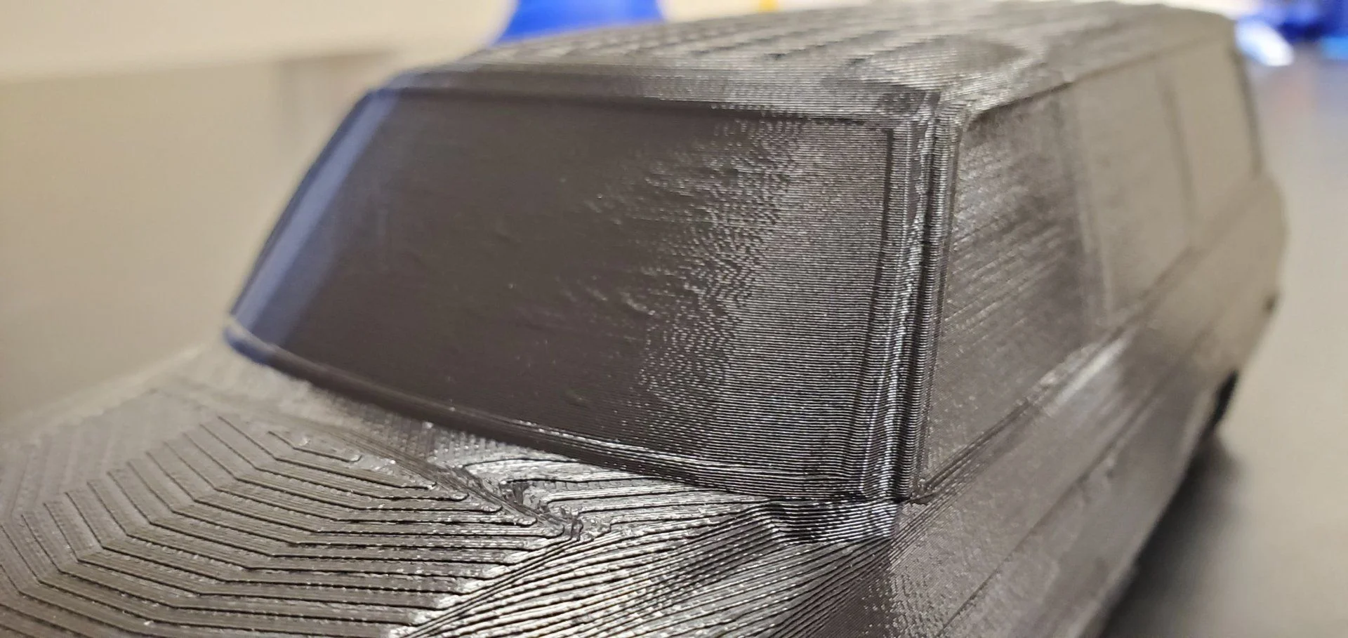

First test print finished. You can hardly see the edges of the polygons, overall im extremely impressed with the model and think apart from adding some groves to signify edges of body panels I think im ready to move onto designing the frame and bumpers.

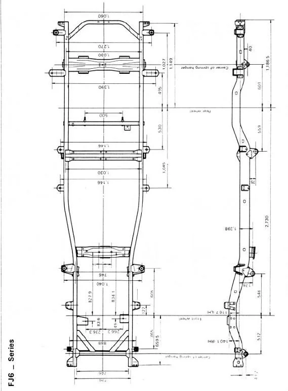

So im working on drawing a frame from my FJ62 model, i was able to find this which shows the dimensions of the mounting points. I was wondering if there was a version of this with dimensions for the actual rails or at the very least a version that is a little easier to read.
If anyone has any other dimensional drawings for the 60 series, mainly the exterior body, that would be a huge help. I would like to eventually get a fully detailed model, or as close to fully detailed as I can.
