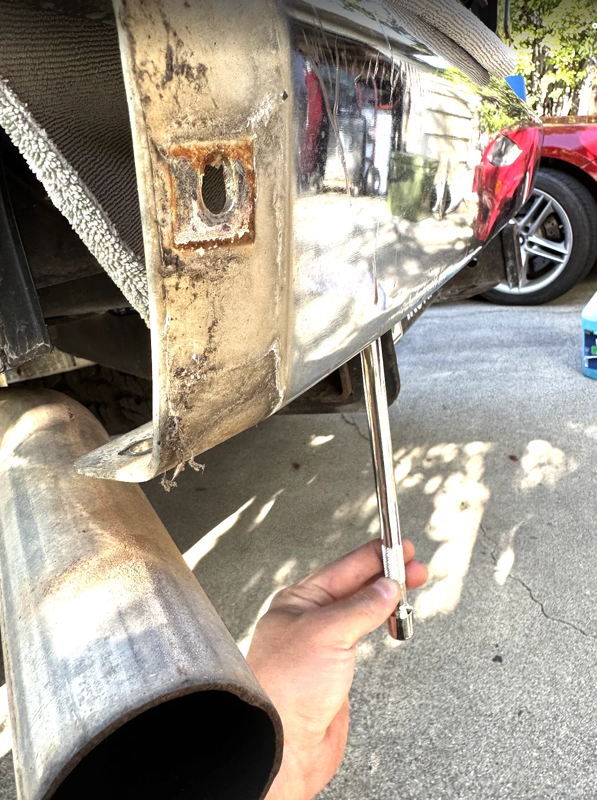

  3. Remove the 4x (2x on each side) 17mm bolts that are on the bottom of the bumper, closest to the end caps. I used an impact wrench for this. I've added a picture that points these out with red arrows.
  4. Once the bolts in #3 are out, you can thread a socket extension through those holes.
    1. First, put the extension up through the bottom holes, then while it's already in the bumper, put the 17mm socket on. Pic attached.

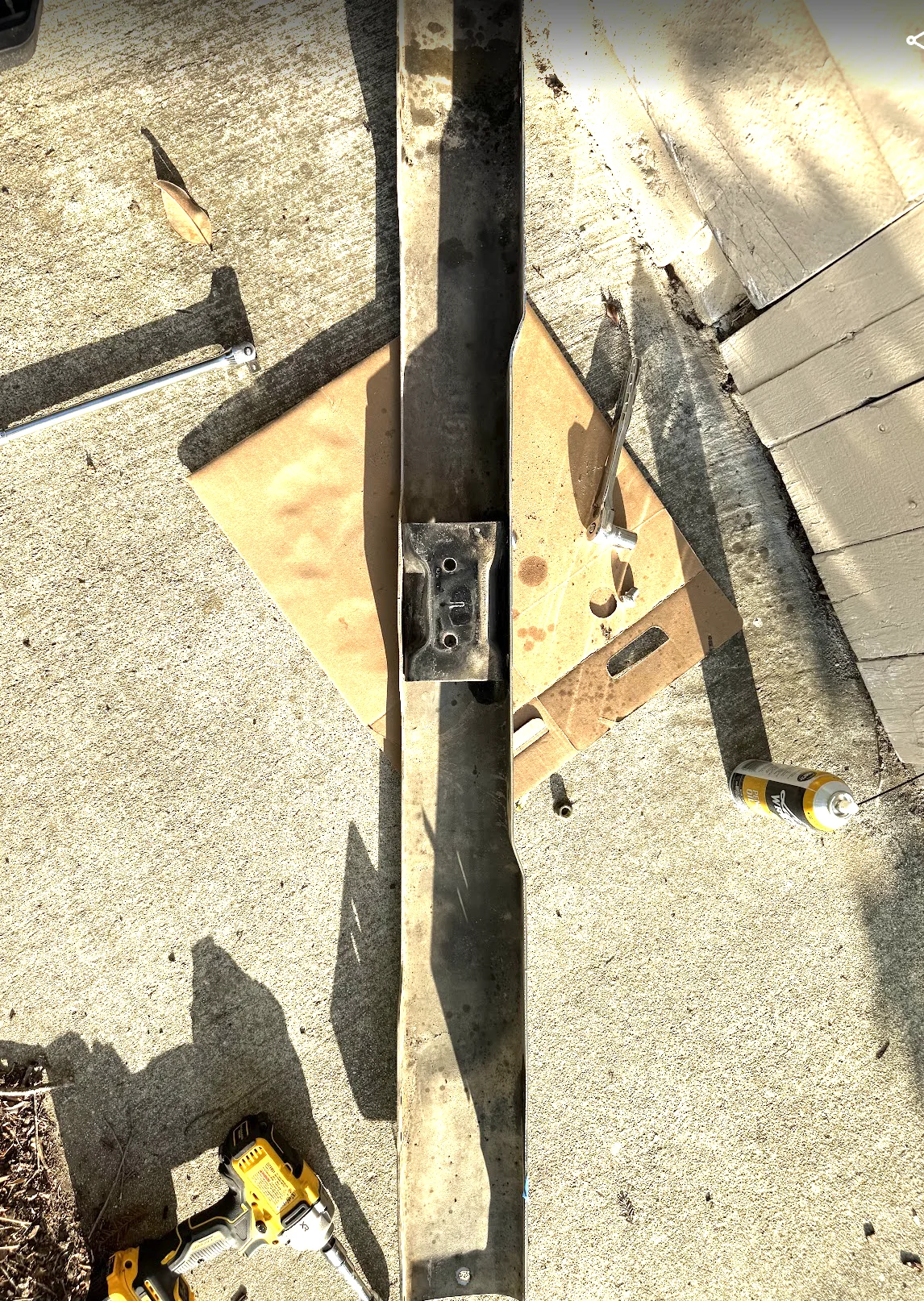

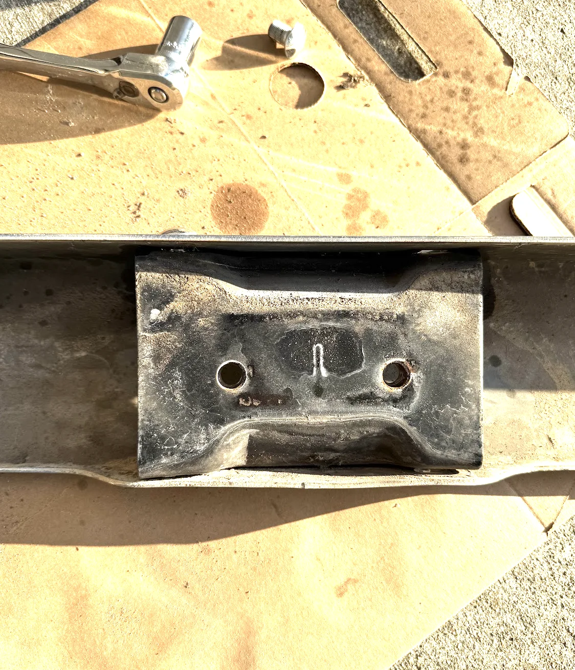

  5. The chromed bolts in the middle at the top are impossible to reach. The bumper is bolted with 4x bolts (2x bottom, 2x top chromed) to a metal mounting plate that then mounts to the frame above where the hitch is. This mounting plate is bolted to the frame with 2x 17mm bolts.
    1. Lower the spare
    2. Unbolt the 2x bolts, have someone lean against the bumper so it doesn't fall off
You're done with the rear!

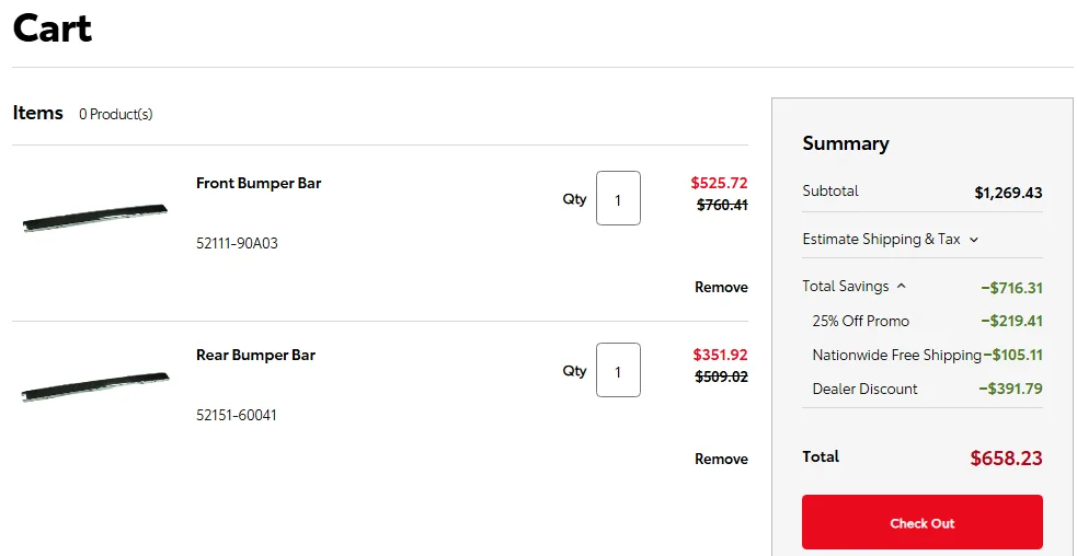

I think the most pertinent question is, where the hell did you get new bumpers from?
#envy
Guessing you being in Australia may be the joke here but for in the US these can still be purchased from Toyota. I like World Toyota in ATL site as their prices are the cheapest I have found and they have 25% off sales often (current one runs 3 more days). With the free shipping on $75 you can get the front and rear bumper bars for $660 delivered. I know when I bought mine a couple years back could also still get all the hardware and the end caps/extensions so that may still be the case.

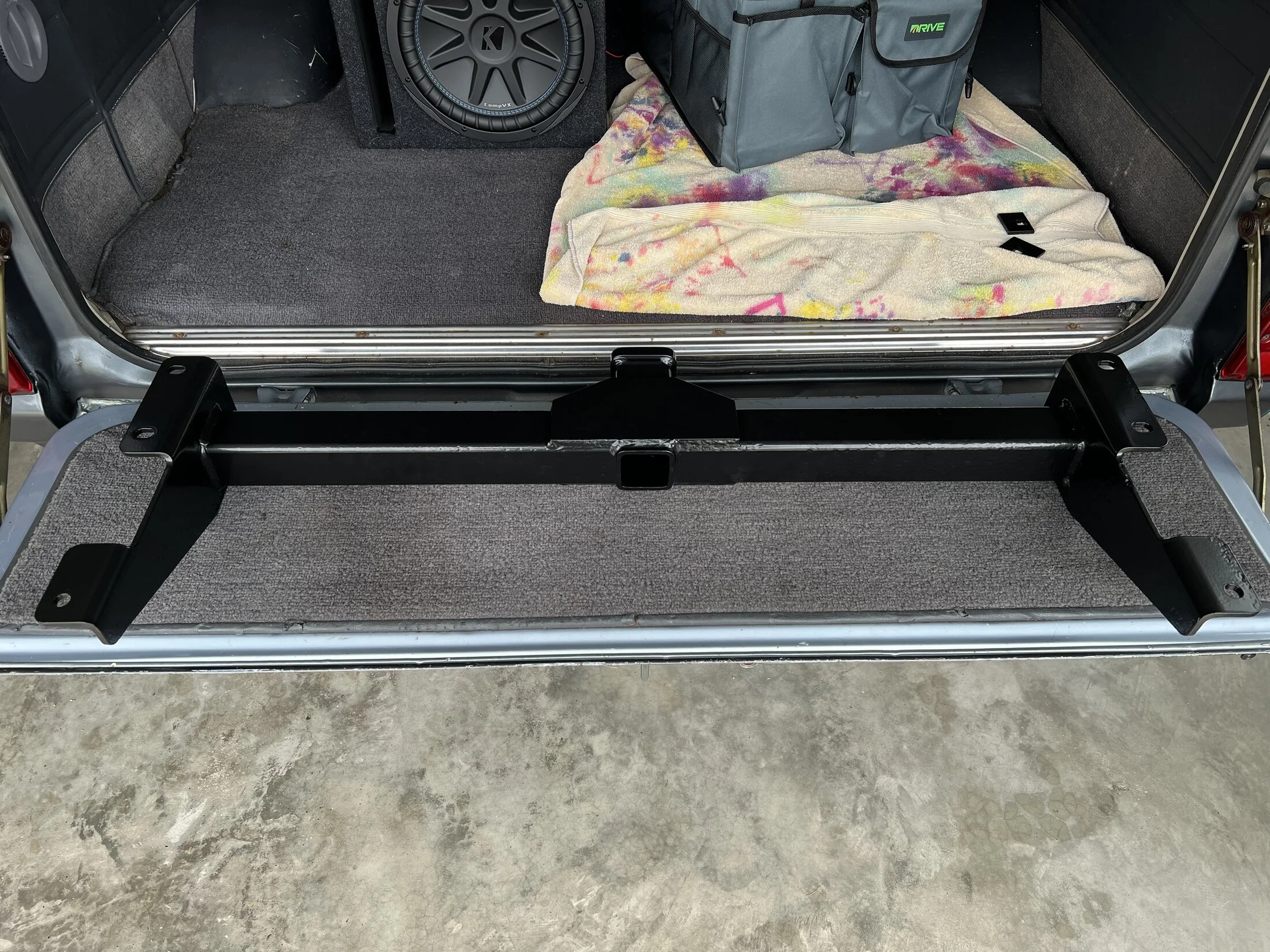

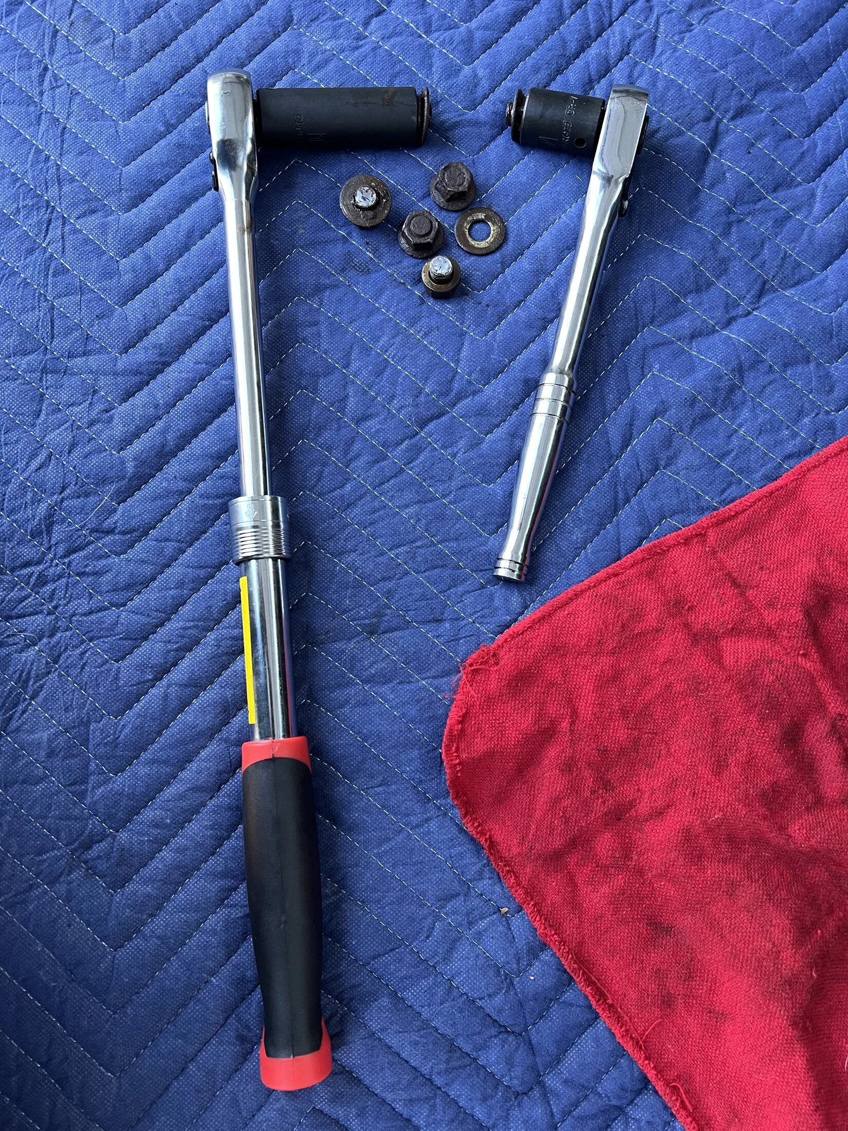

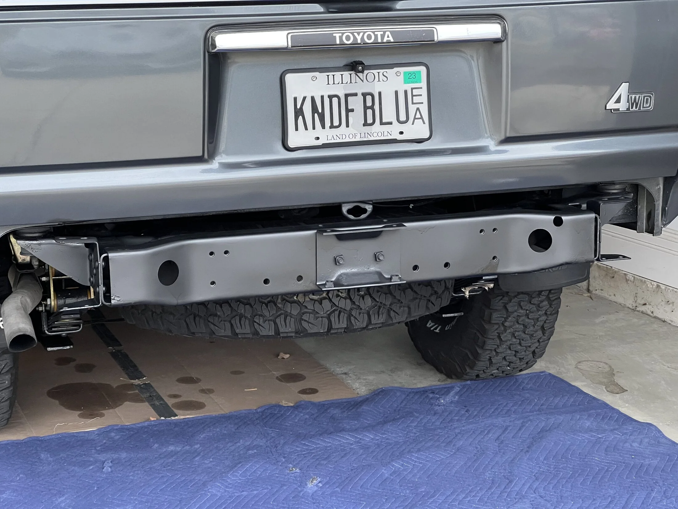

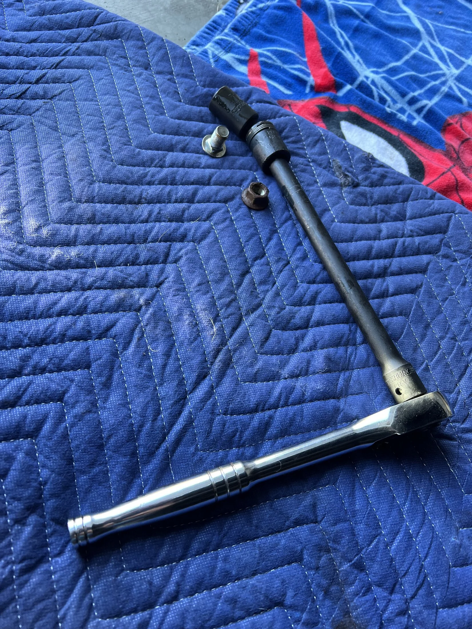

For those middle top ones in your #5 I was able to reach them without dropping spare and leaving bracket intact by using an extension and a swivel:

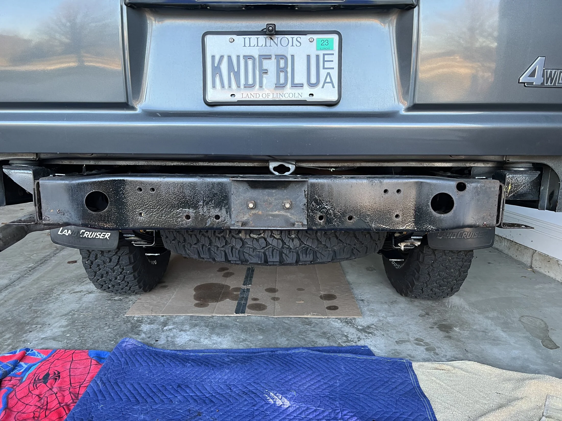

While I was under it I also removed my tow hitch and had it blasted and powder coated. Also wire-wheeled the rear frame when bumper was off and hit it with some rust converting spray paint.

I can't recall which paint for sure but think it was just Rustoleum Rust Reformer. Mine was in good shape so just cleaned the Fluid-film off it, wire wheeled and painted. Don't think you want to prime when using rust reformer type paints.

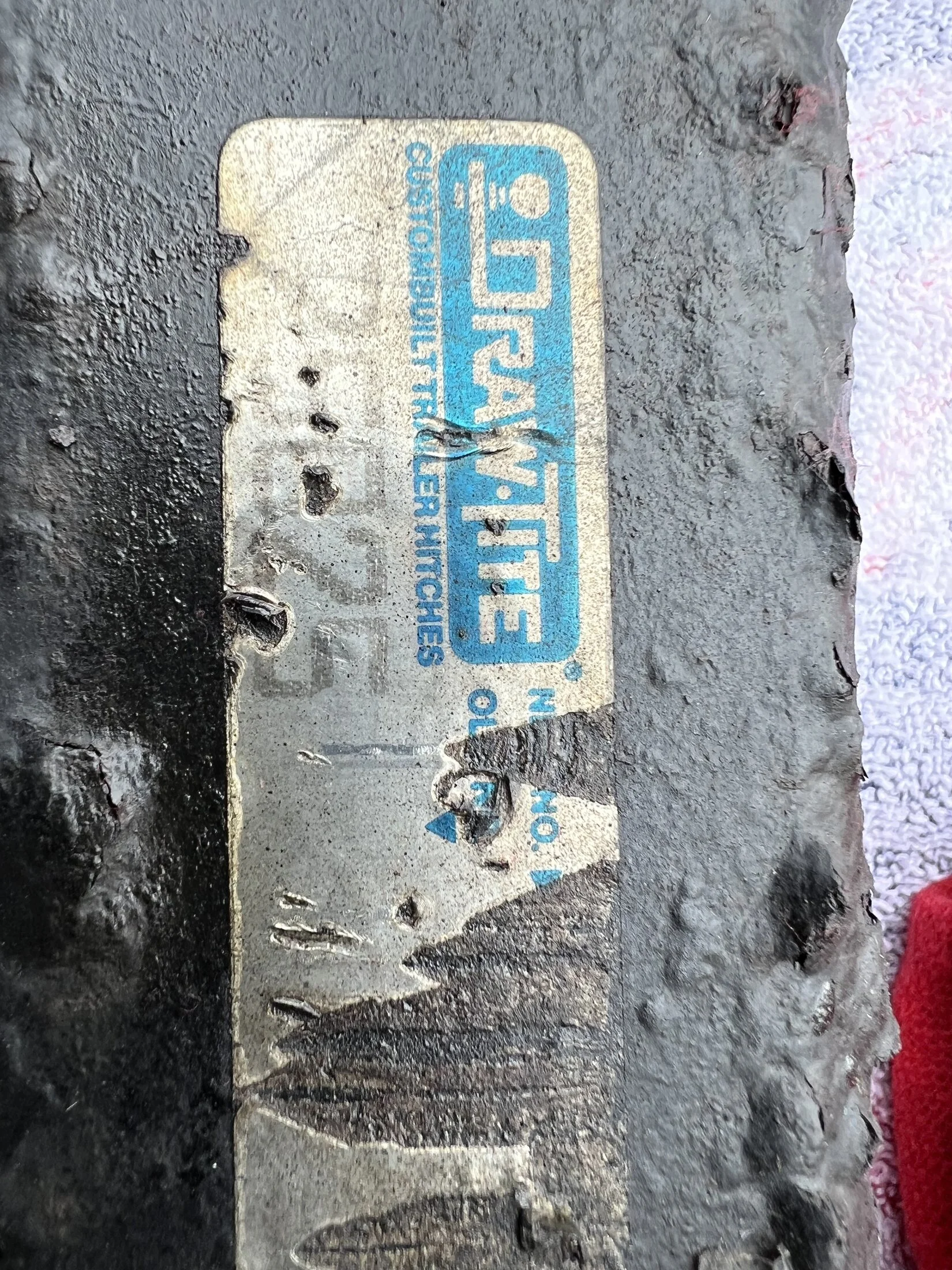

I reached out to a local powdercoating place that is luckily a few miles away. Paid $160 to have the tow hitch done. Also did my air cleaner housing and later my FJ40 wheels.
This is how both were before:
