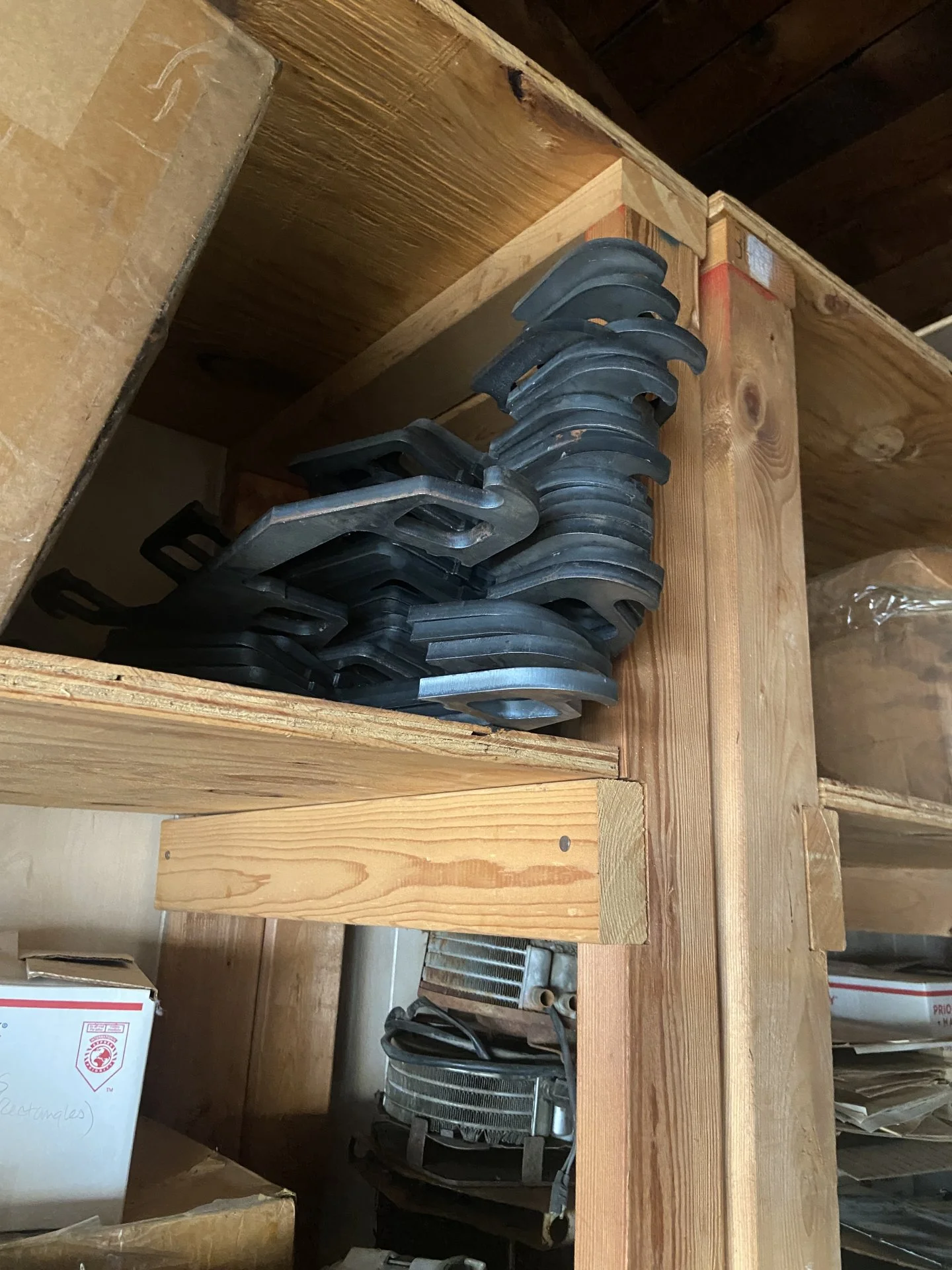

If anyone is interested in picking up the torch on this, I have approximately 30 new manifold flanges sitting on the shelf I had laser cut before I pulled back on production.
More like 20
how much for one or two of the flanges?
Seriously? If you are serious about taking this on, you should buy them all.

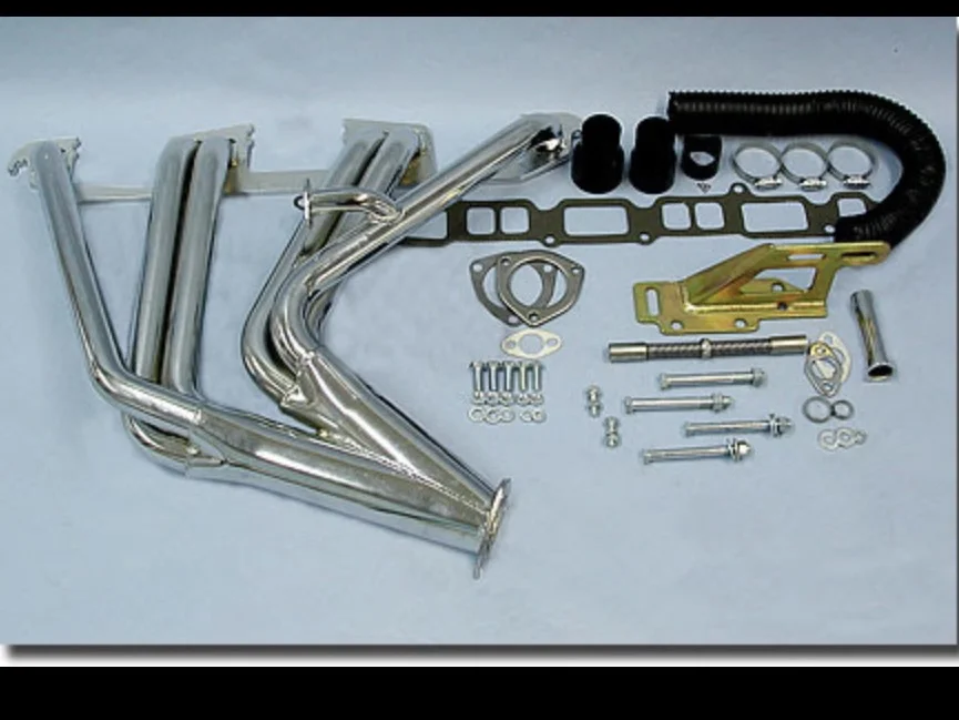

Then I just have to find a Downey header, and get a few prototypes done to work out the kinks and get it quoted.
Then the rest is working with Mark on getting the other pieces made. (Not clear if he makes them or I make them under license or what.)

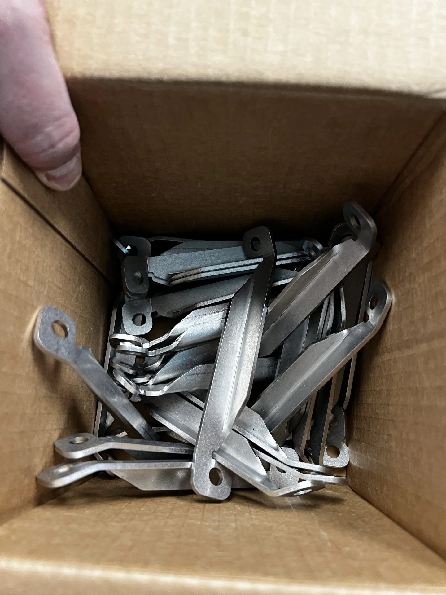

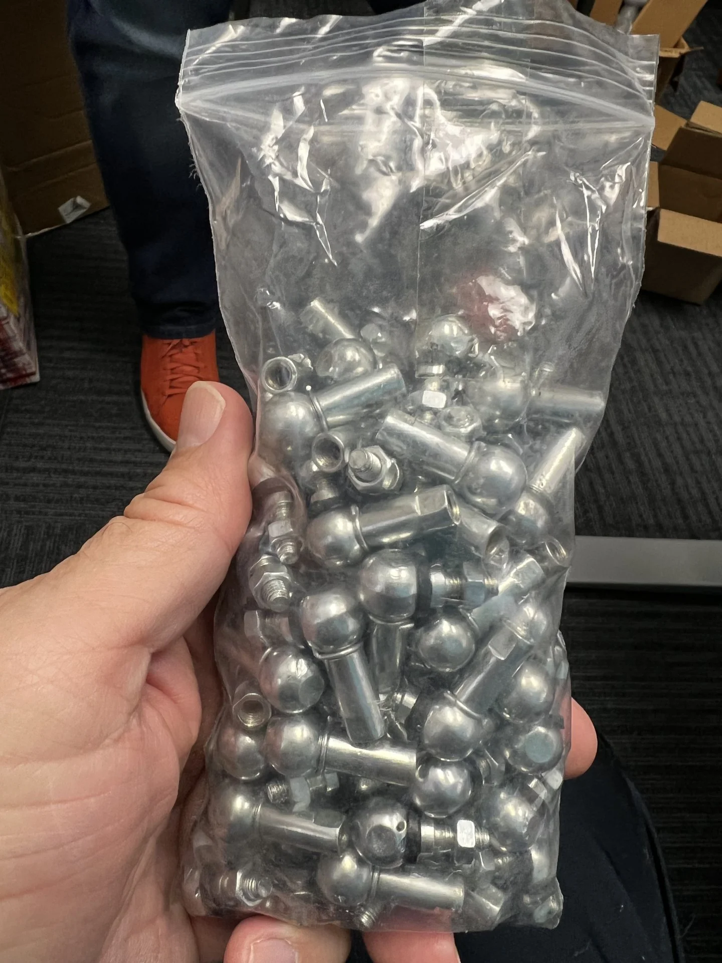

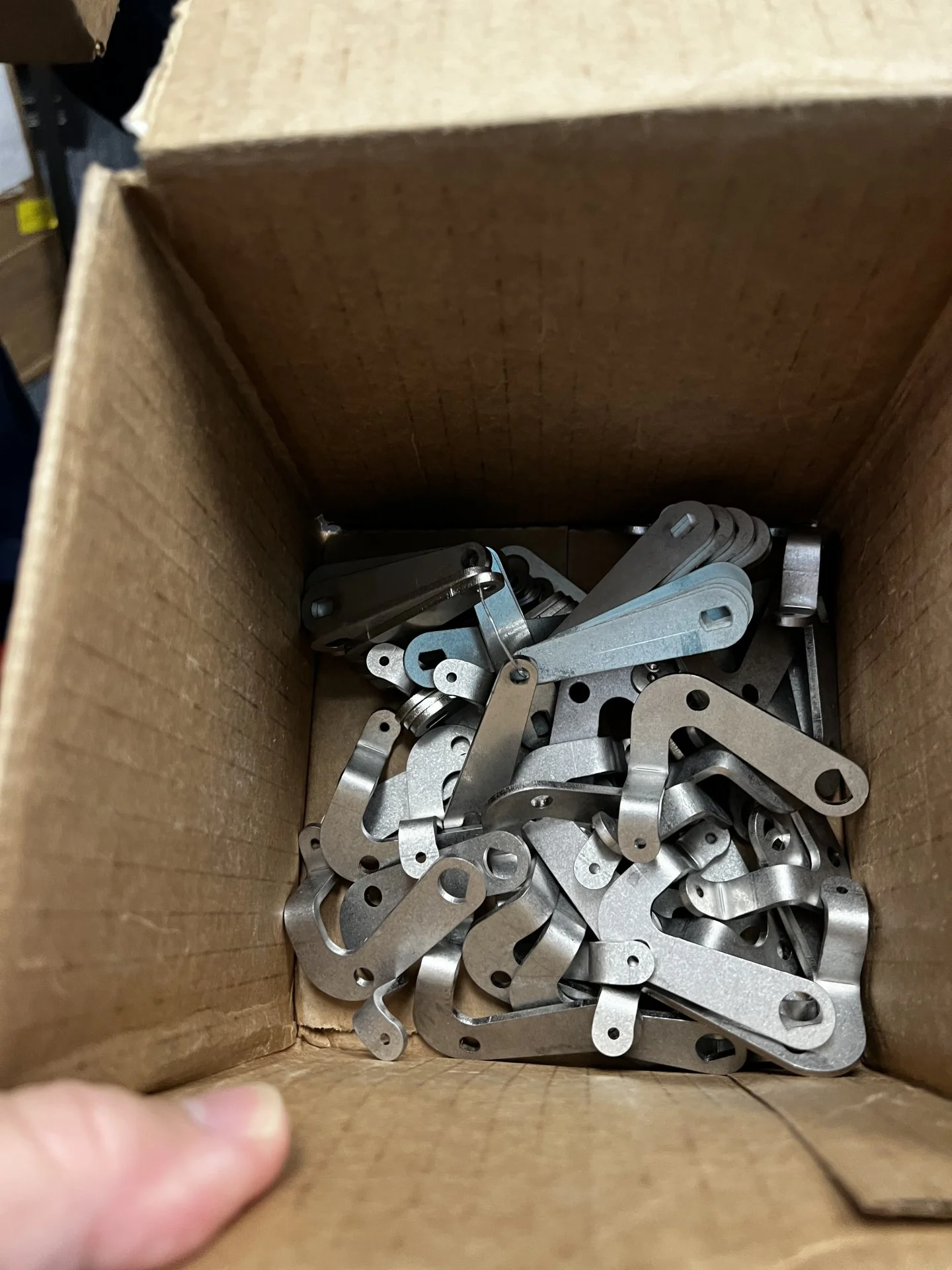

This is the most recent design to head to small volume production. It’s replacements for the NLA parts on an 80-series dual filler neck. Not shown: the machined shaft.

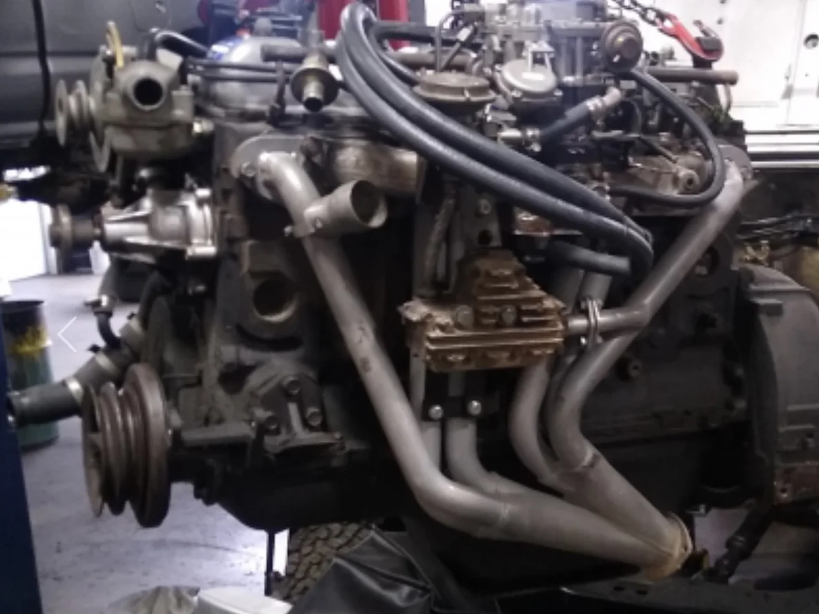

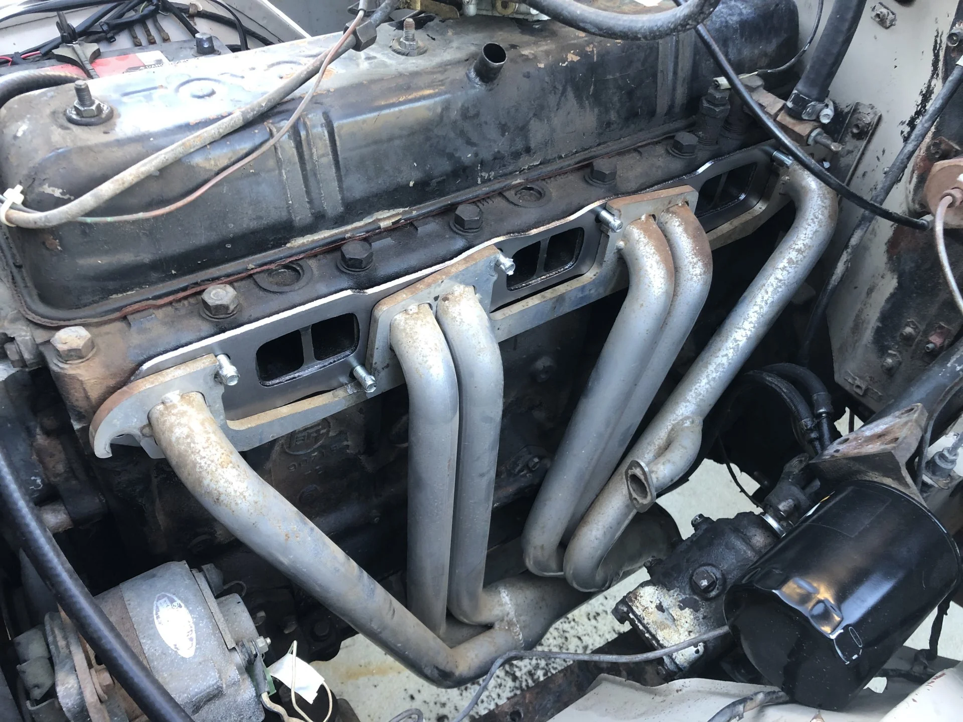

This is a Marks header on a 1970 F motor

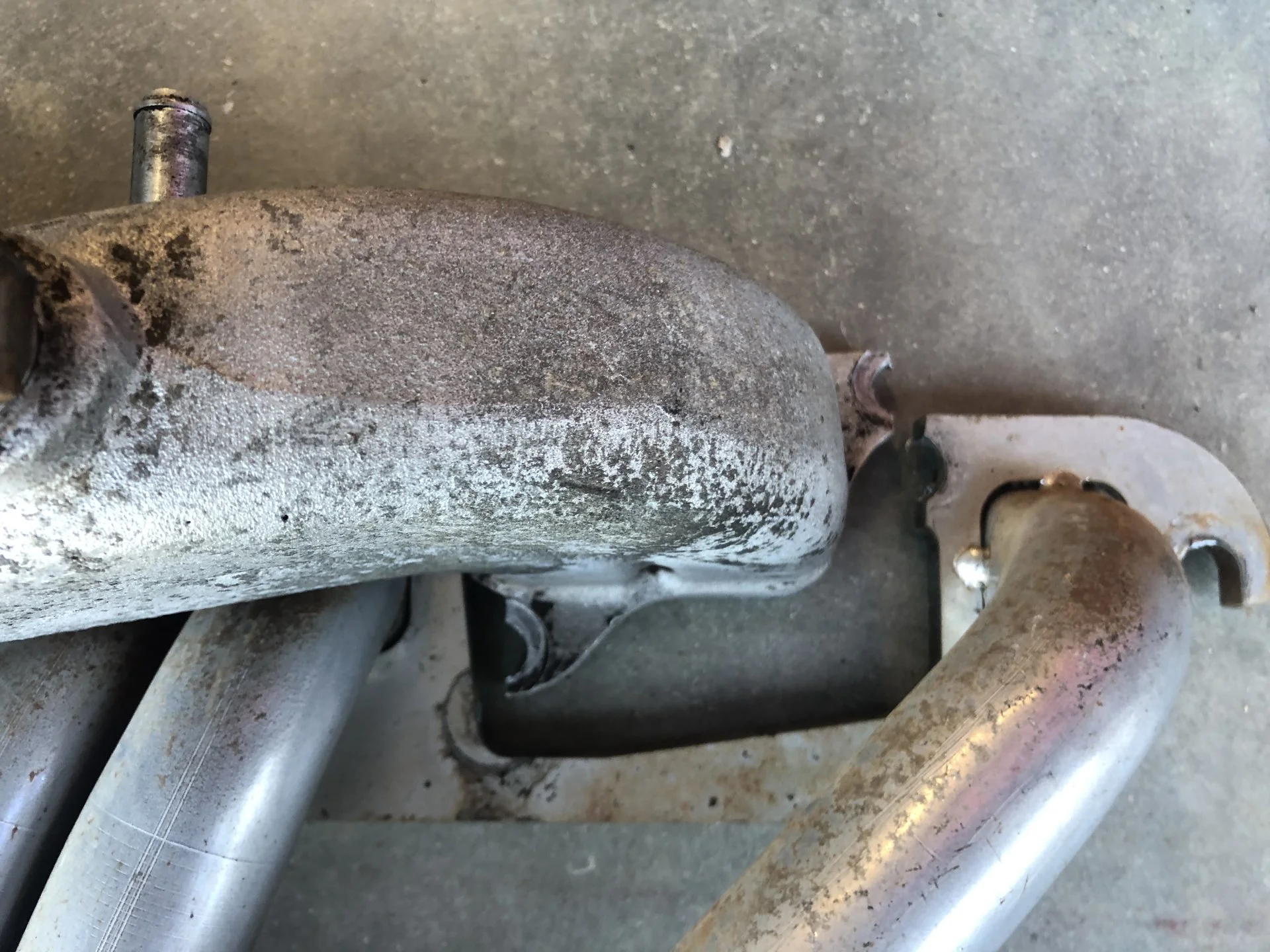

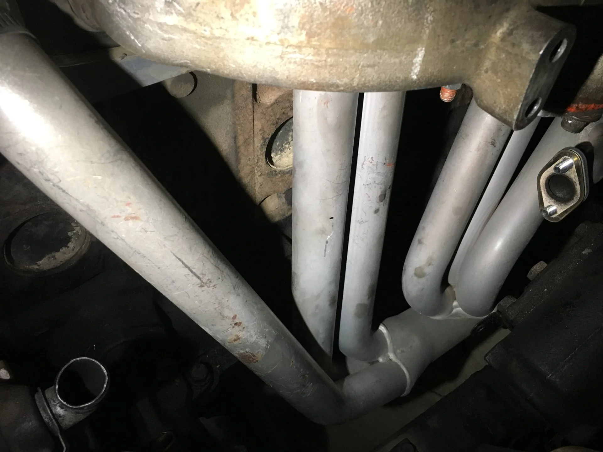

Im curious how you got your F intake to work with your marks header. I tried to install a used one on my ‘69 today and the intake interfered with the header tubes....
I had to use a 2f intake to make it work.

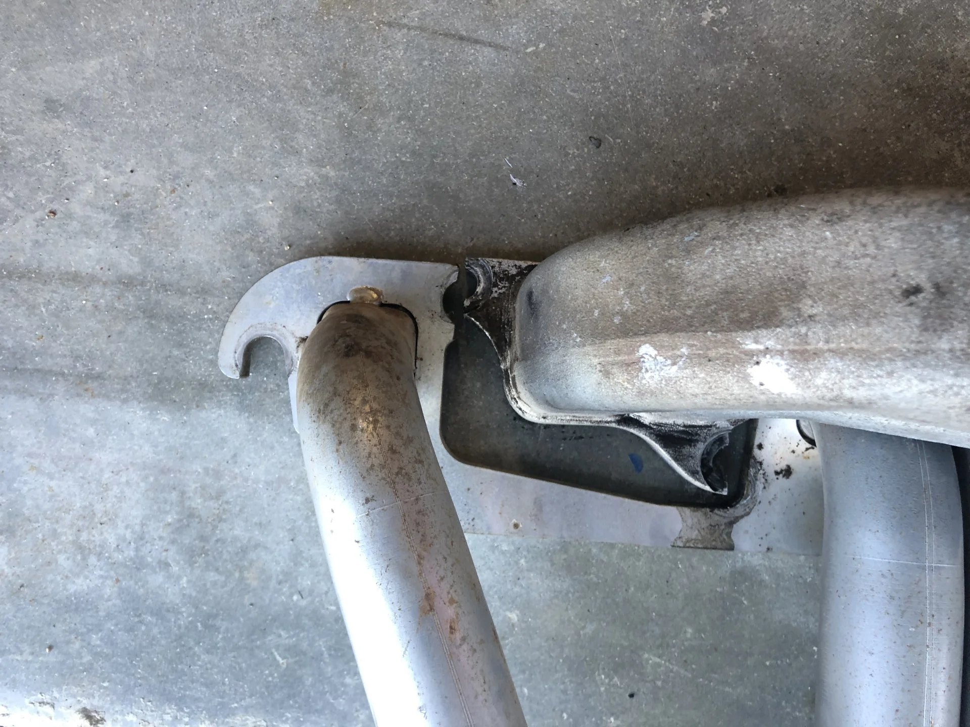

First pic shows where header tube hits F intake, next two pics show misalignment of holes due to interference, and last is just a photo of header mocked up setting on the fresh manifold studs.

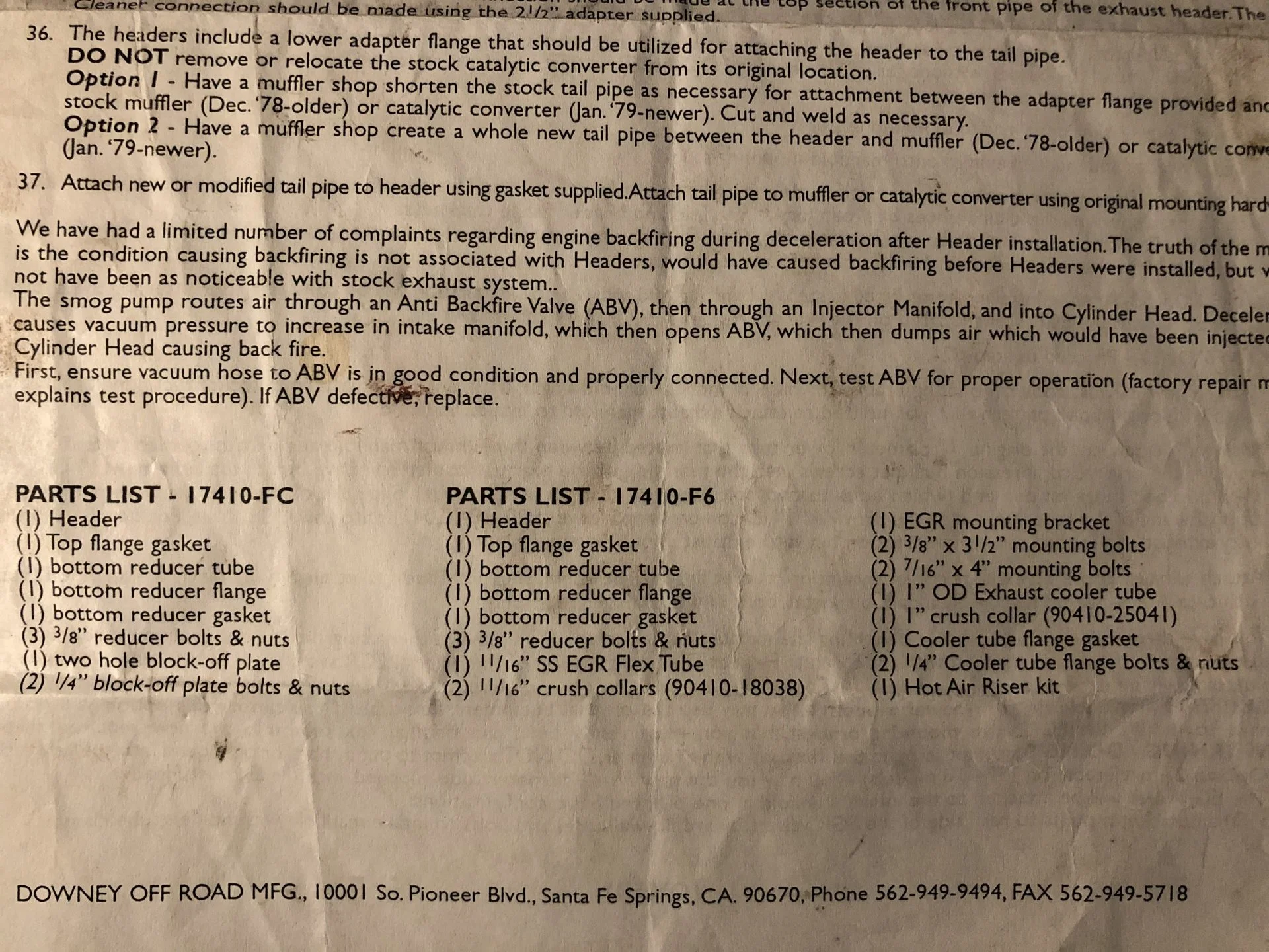

If someone can move forward with using their existing Downey Header as the pattern for a Header manufacturing shop, they then could buy Marks remaining top Header flanges to build the first batch, keeping in mind that many a stainless steel Header does NOT have a stainless steel top flange. Then Mark or I could develop the necessary kit/pieces (including the exemption decal) to make those Headers smog legal. Harder than finding a shop who is willing to build the Headers is finding a shop who is willing to build the Headers in smaller affordable batches.
I think the easy path to re-activating the CARB exception is going to require you or Mark to lend a hand, as it were.
See 6(c) on page 24 of https://ww3.arb.ca.gov/board/15day/ampts/proceduresfinal.pdf
I think the rest of this is now doable, and in-progress. (We can go PM or phone to discuss details.)
