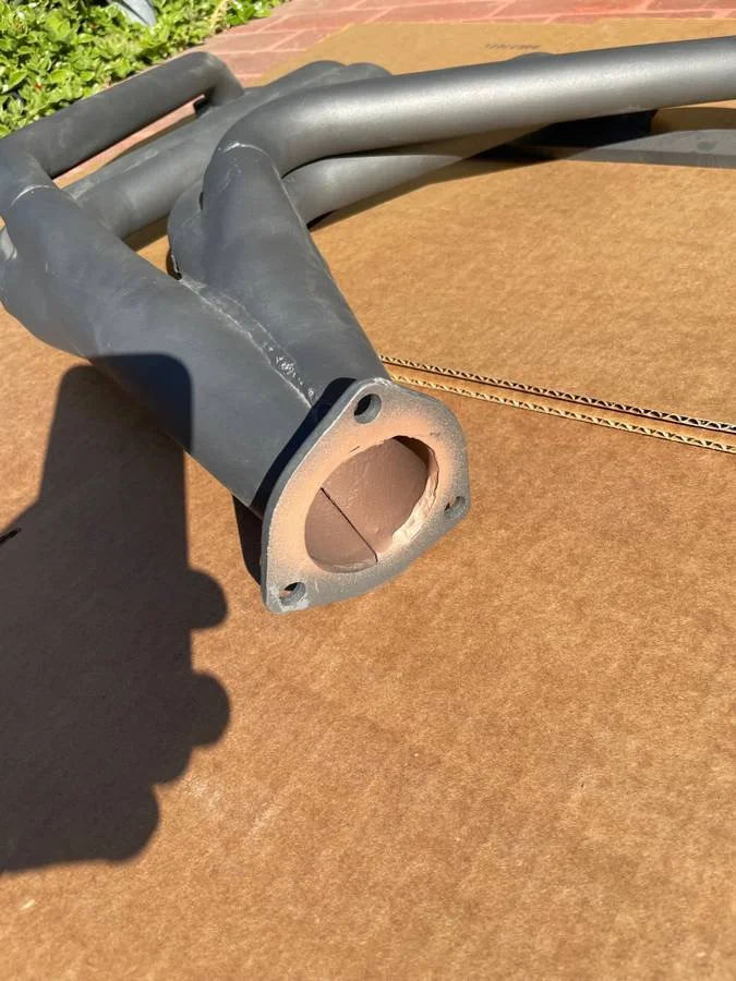

Is this a Mark’s/Downey header? Are the headers interchangeable between the F and 2F engine? I plan to install on an F engine.
Looks like a marks.
Yes interchangeable...some heads just do not use the front and last most fasteners

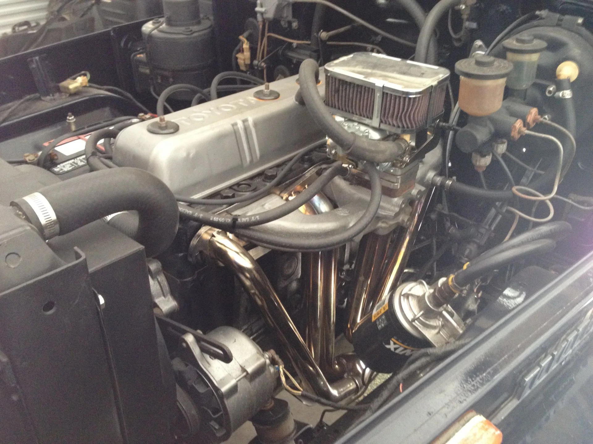

It will fit. I recently did this on a 72 F motor. I had mine ceramic coated also.
To make sure it sealed properly, I replaced all the studs/bolts with 12mm in a longer length. I also used matching thick washers and flange nuts for a better clamping force.
Relocated. Makes for easy filter change and I like the Wix filters

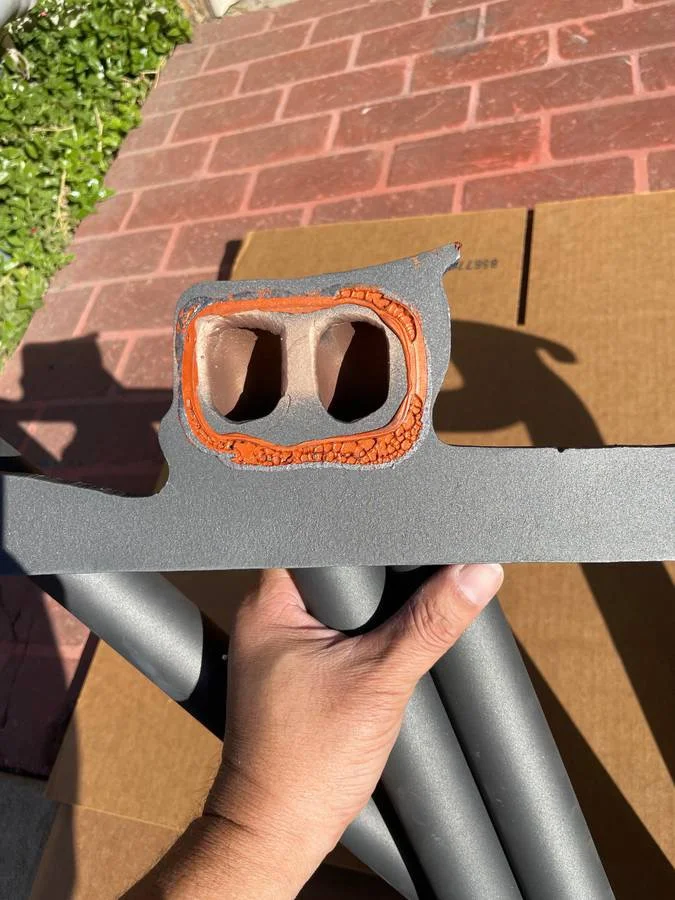

Bought the headers. Should I wrap them?
No, No, No, Headers literally melt inside thermal wrapping, they end up full of hair line cracks. Dragster guys wrap their Headers for 1/4 mile, then remove and rebuild engine before re-wrapping for another 1/4 mile.

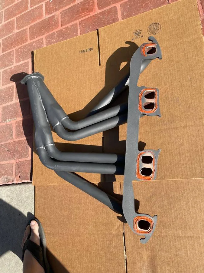

Is there anyone making headers for other straight-sixes? Like is the exhaust port pattern similar enough that the mandrel bending could be done on equipment intended for a Stove-Bolt? Then making the flange specific to an F/2F, etc.
Is my Downey/Mark's Off-Road header covered by proprietary intellect, or can someone emulate it? What would be a critical roster of shop equipment needed? Were there any CAD drawings produced that detail critical dimensions, and manufacturing specifications?
Is there a shop, looking to have rapport with the Land Cruiser community, that could do a rehab on my header? The PO did what was possible with ranch tools, and, at least it needs a new flange, and corrosion protection.
